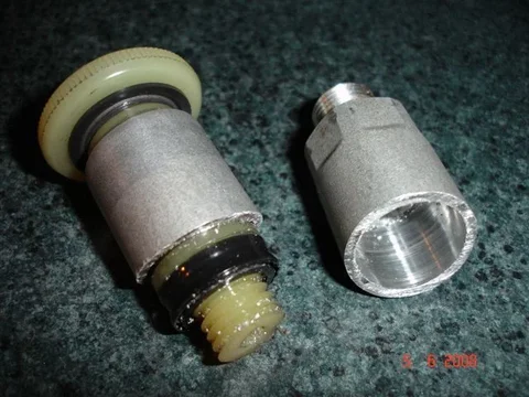

This is the construction of the OEM primer (hacksawed-open):
You can see the quality of the "seal" incorporated in it.

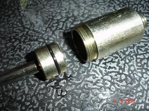

This is the construction of the cr@p I bought from a well-thought-of-seller on eBay:
You can see it has just a piddly O-ring for a seal. (No wonder it leaks readily!)

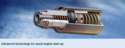

And this is the construction of a Bosch primer:

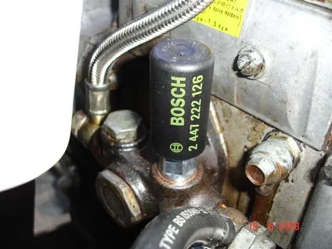

I also just recently replaced my OEM priming pump with the Bosch 2 447 222 126 pump and it works a treat. No leaks, no need to twist-lock it and it feels very sturdy while pumping.
...And i can still slide the OEM plastic cover over it to make it look stock. :cool:
