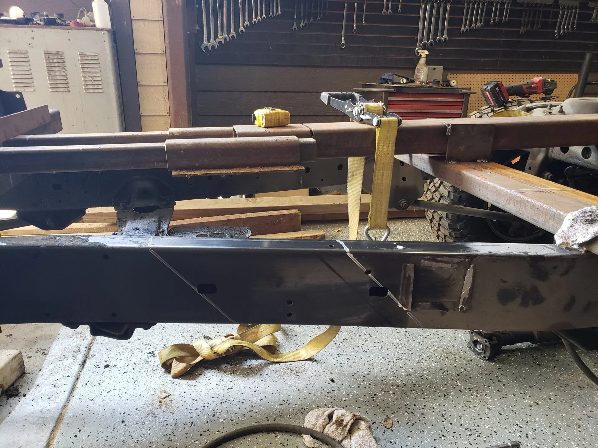

As per the wheel base decision we are taking 330 mm out of the wheel base and then whatever hangs out the rear end.
After looking at the chassis for a while I decided I would cut in front of the rear lower link pivot and then section it back together. Now I have been made aware you can get away with removing the lower link box and getting to enough straight chassis to do a 300mm cut but I was keen to leave the link location alone so accepted I would have to section.
I am still not 100% on the taper so I decided to put a shortening fixture onto the chassis to allow me to slide it back and forward to confirm my 330mm. The fixture is what we use to do VW Floor Pans and has about 500mm of "sliding" based on a set of machines RHS.
I also set and front and rear straight edges outside the cut zone and leveled them to give me set reference points. Doing this allows me to clown around with it and get it back to factory spec. The straight edges are them marked with center lines and measurements relative to each other. If you look you will see the white and black lines and written numbers that relate to them .
From here I will start cutting and probably drop the body back on an off a few times to check look and feel. It is not the quickest way to do it but I need to be happy with the look.

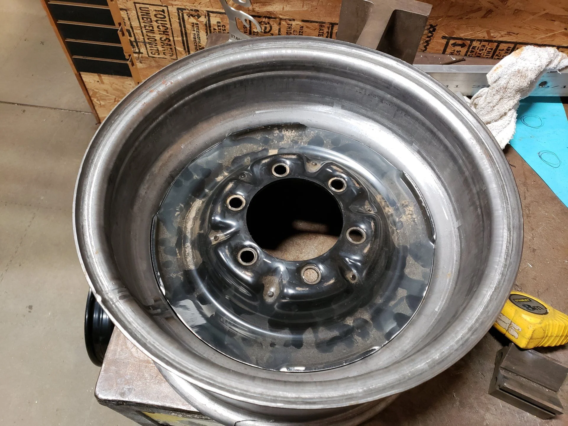

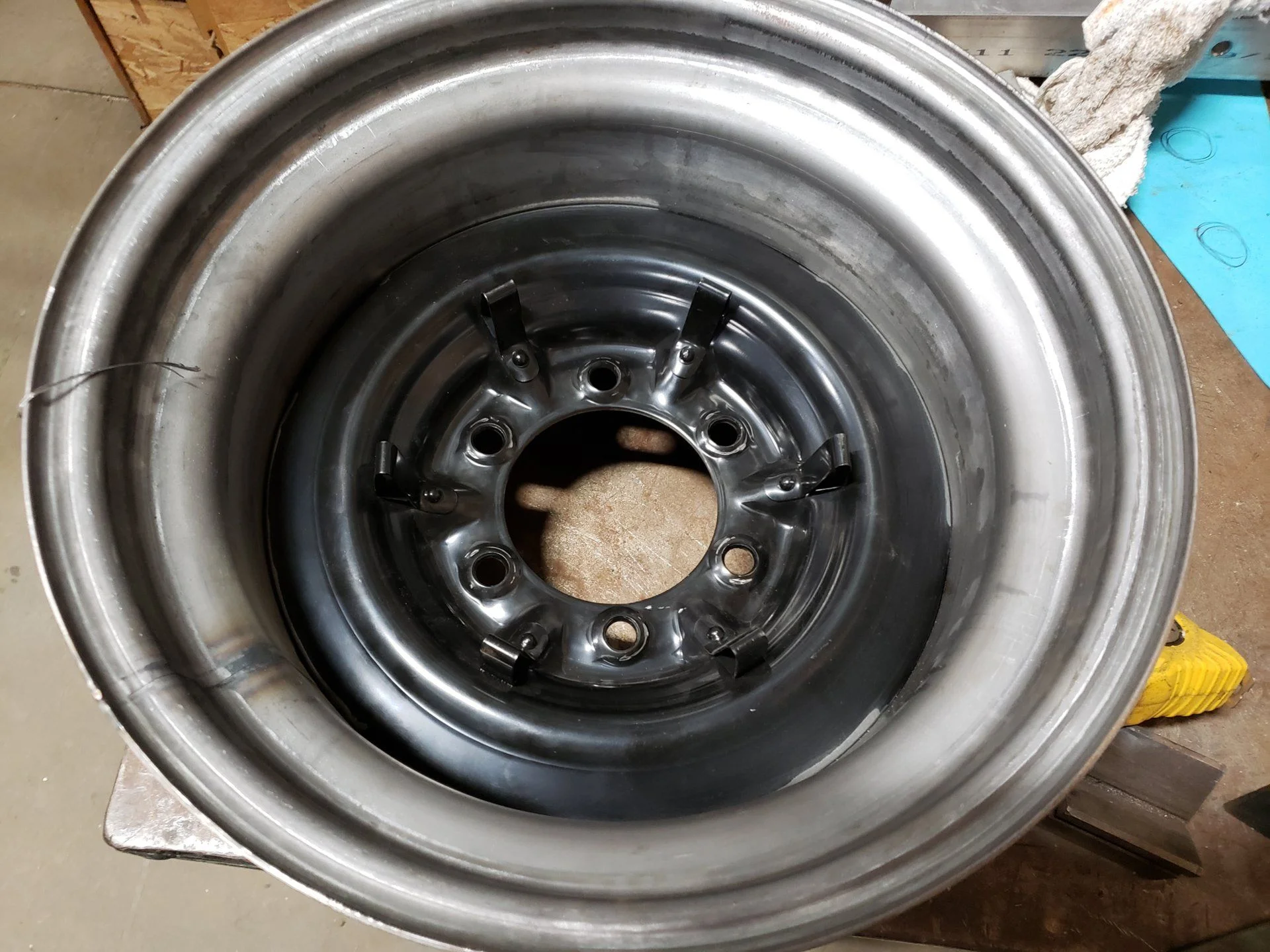

You mean like this :) .
That is my back up plan by the ICONS I have on it at the moment don't have much to be gained before hitting coils and other stuff.
If need be I will cut up the diff's and keep playing till I am happy .

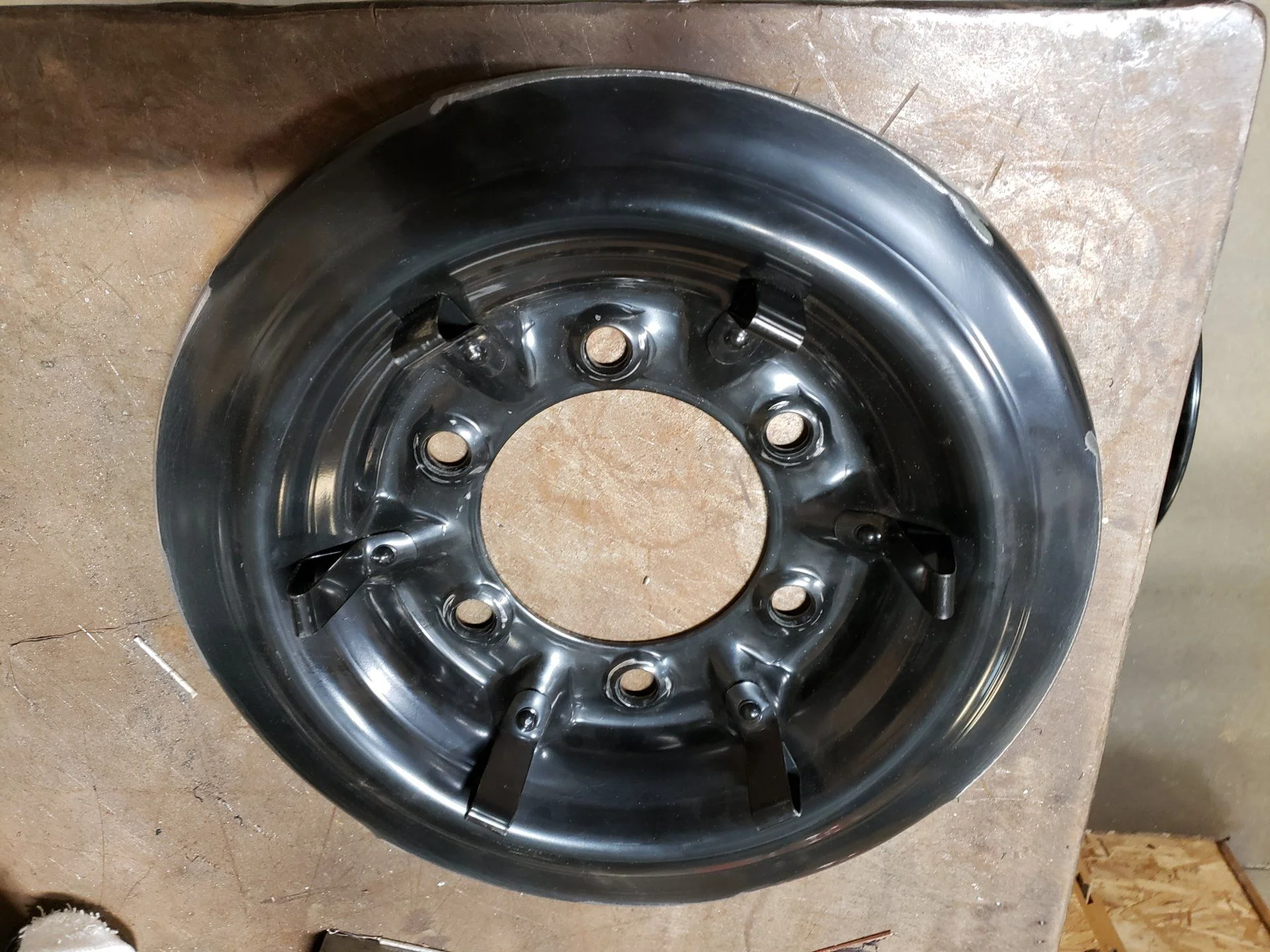

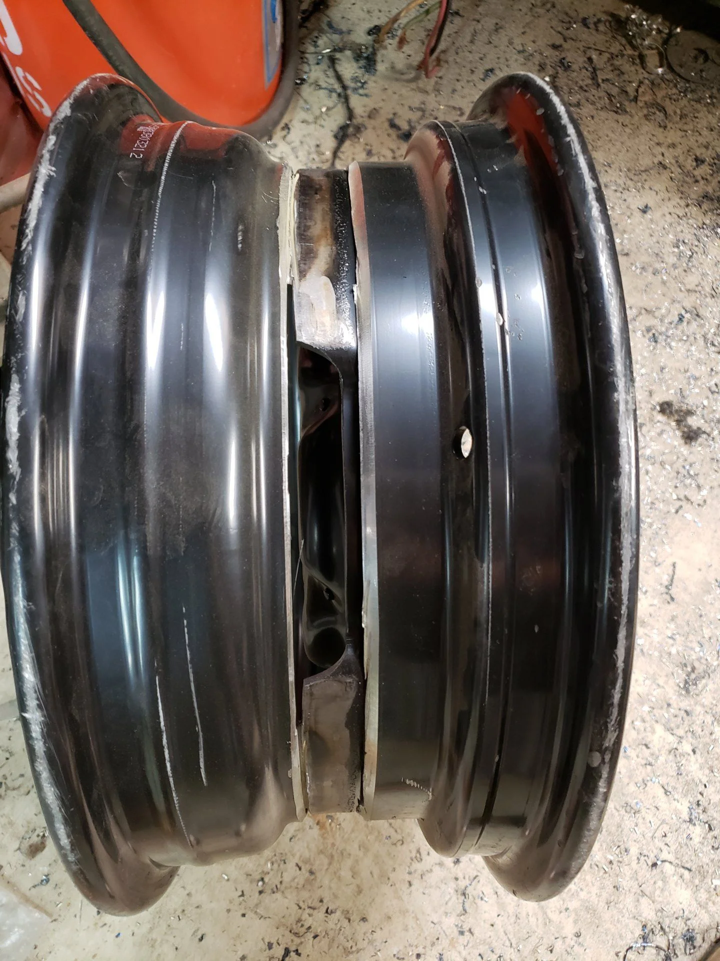

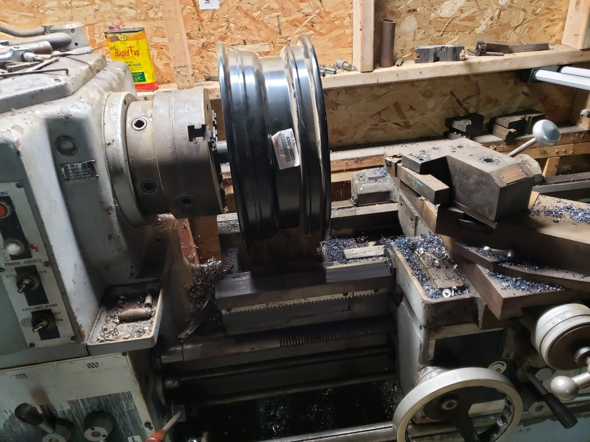

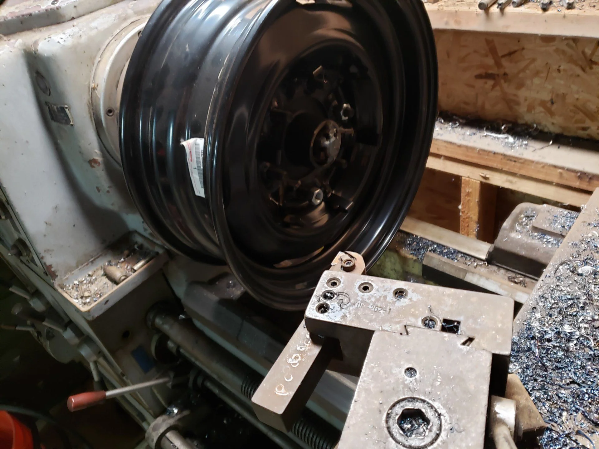

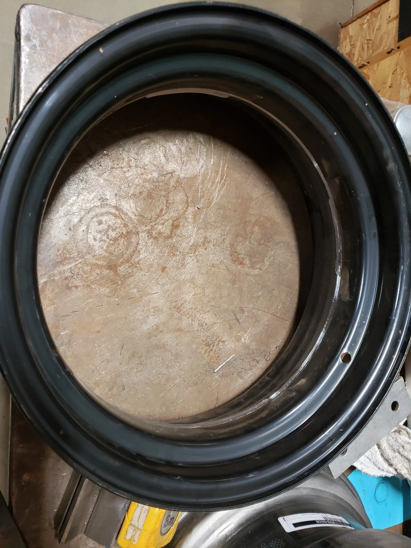

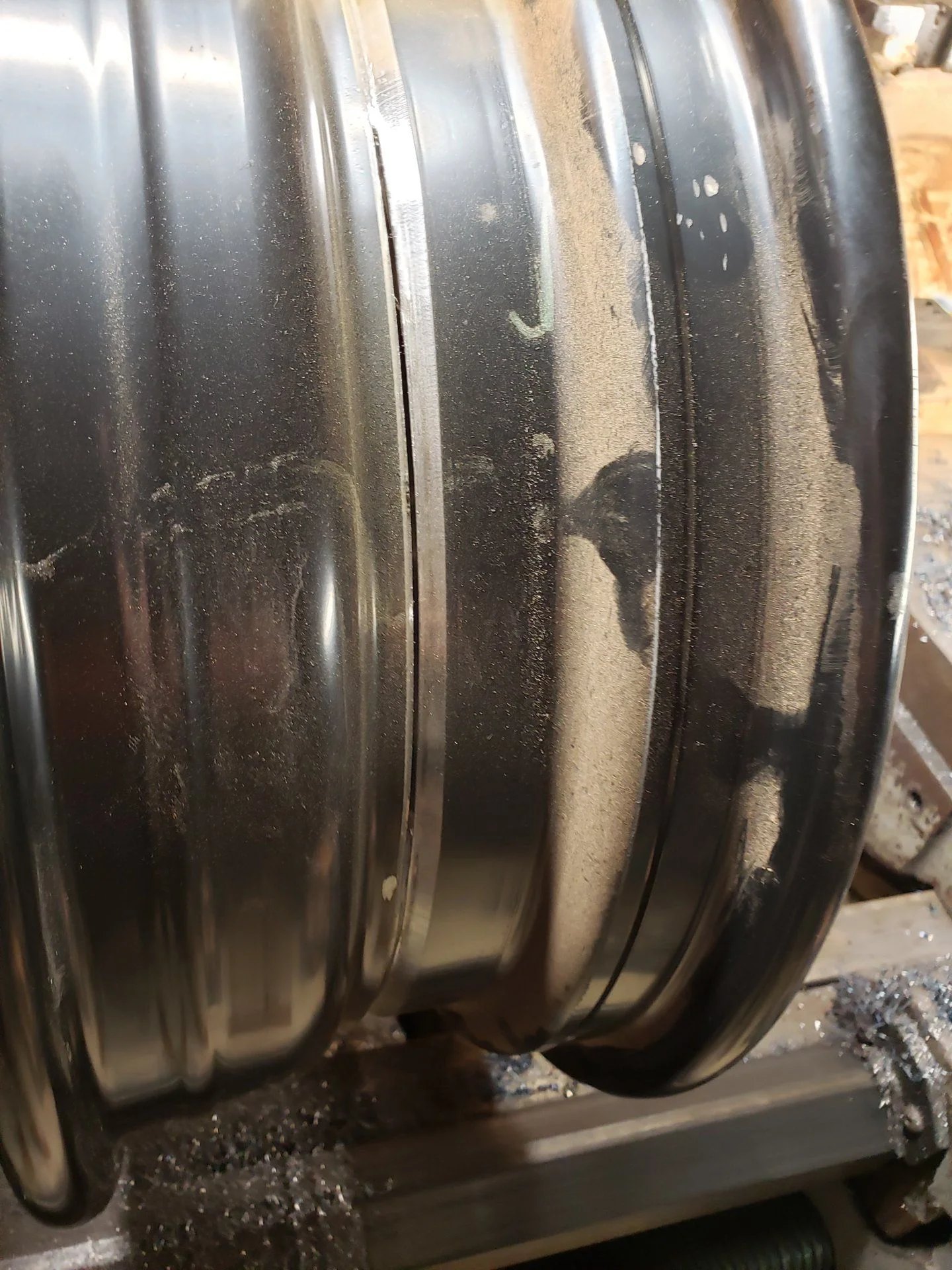

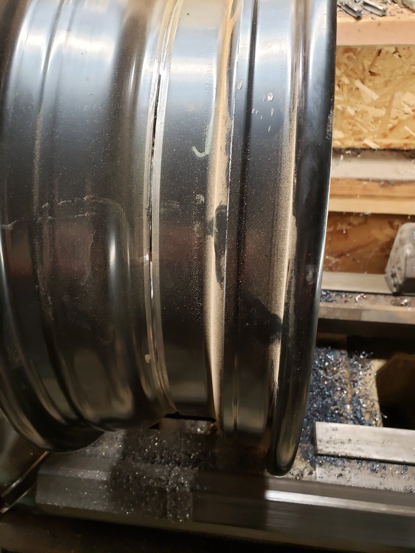

I also cut some centers out in case stock back spacing don't work.
Either way I will at some point get the look and feel I want regardless of effort :)

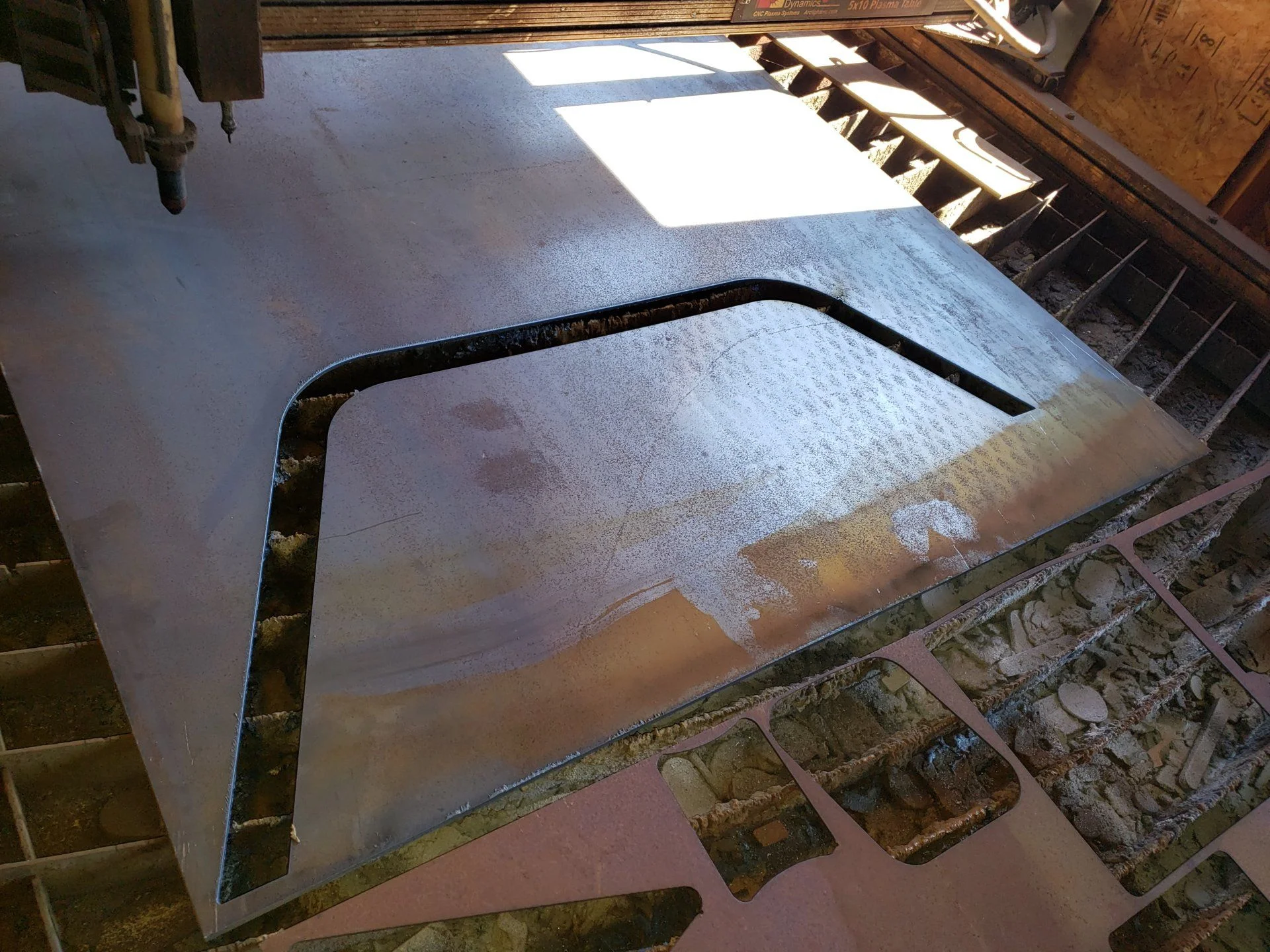

And in case I change my mind I made some different size openings so see how it looks with different options .
Now I have opening to suit 37" 35" and 33" wheels on the 80 series 4 link arc

when you take the 300mm or so out of the chassis on that area what are you going to do to make the 2 sides meet as they will be different widths as the chassis is angled at that point.
Yes, That’s why I was thinking that it’s possible to put the front part inside the rear and weld (rivet) it.
