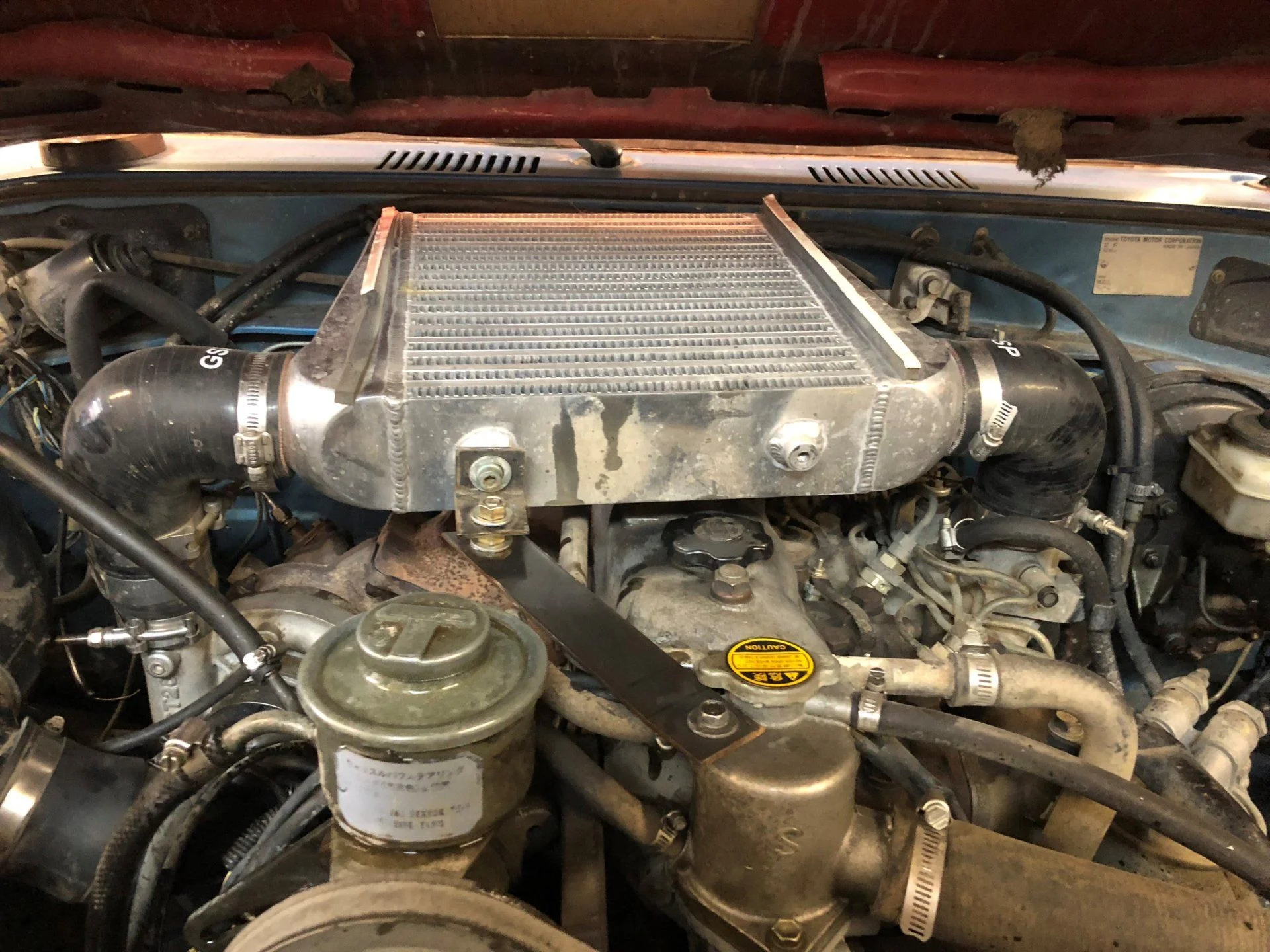

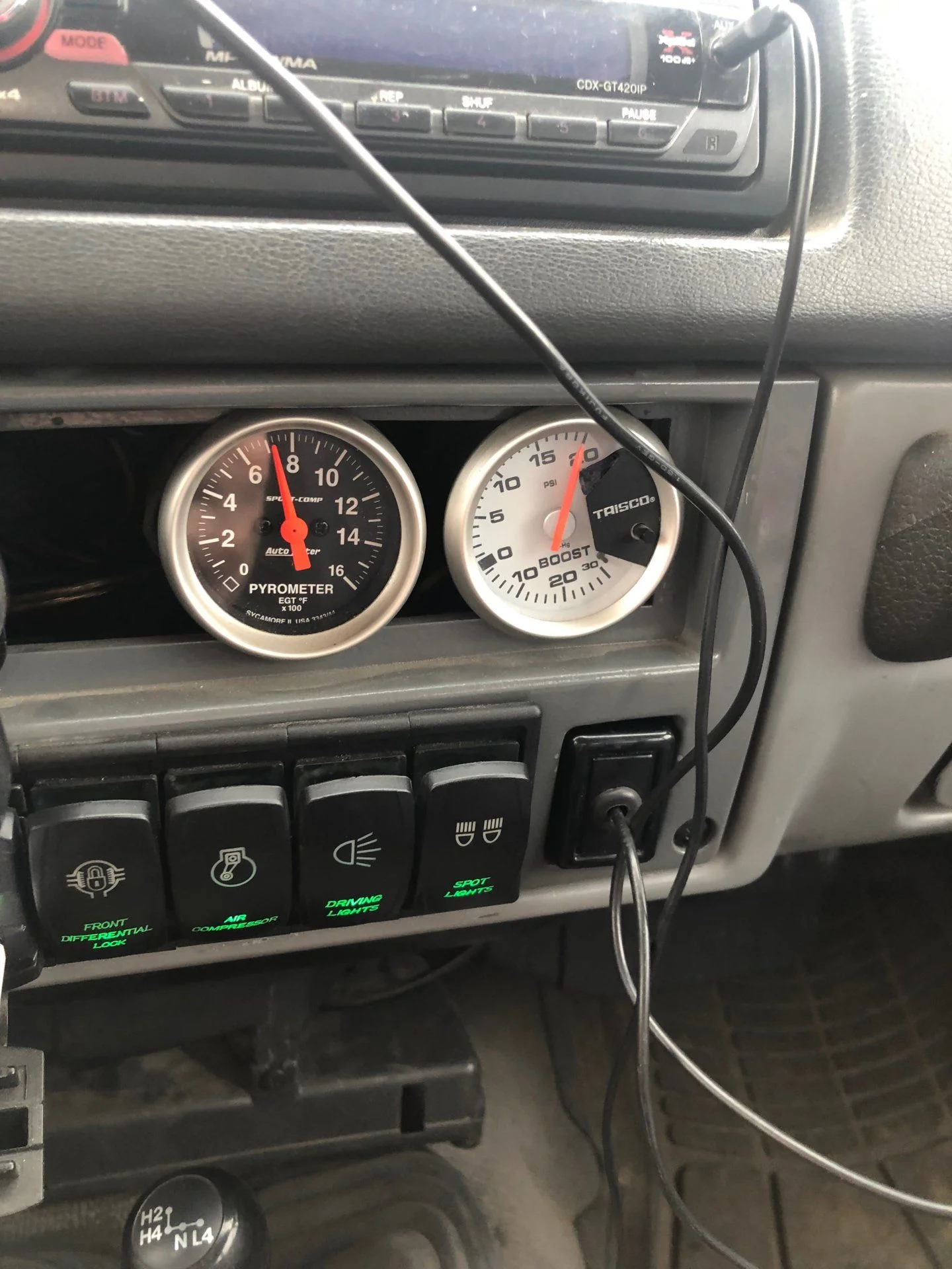

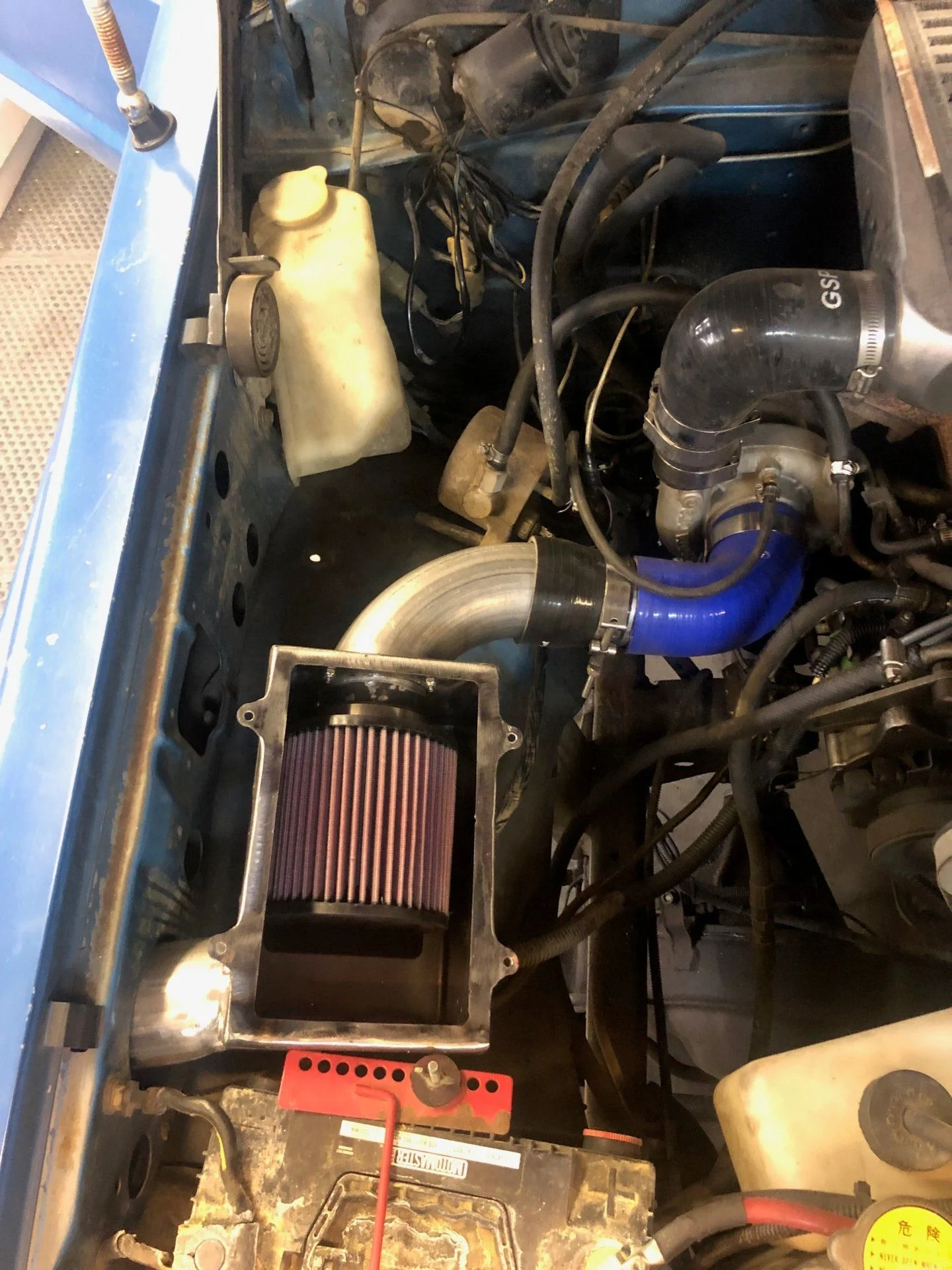

Mine is turbo'd as well. I have a 13BT manifold, CT26 and a top mount intercooler. I have the waste-gate welded shut and I adjust the fuel pump to manage the boost/EGTs/Engine temps.
Do you have any details on your Top Mount Setup ? Currently I will be going 13BT manifold with a garret but no inter cooler.
Aiming at Max 9 PSI so I decided the I/C wasn't really needed. I did play with that idea of adding a WAIC depending on intake temp. I will be running multi channel data logging on it so will have post and pre temps on it so will see how it goes and work from there.
Did you add an external waste gate ? why did you weld the internal ?

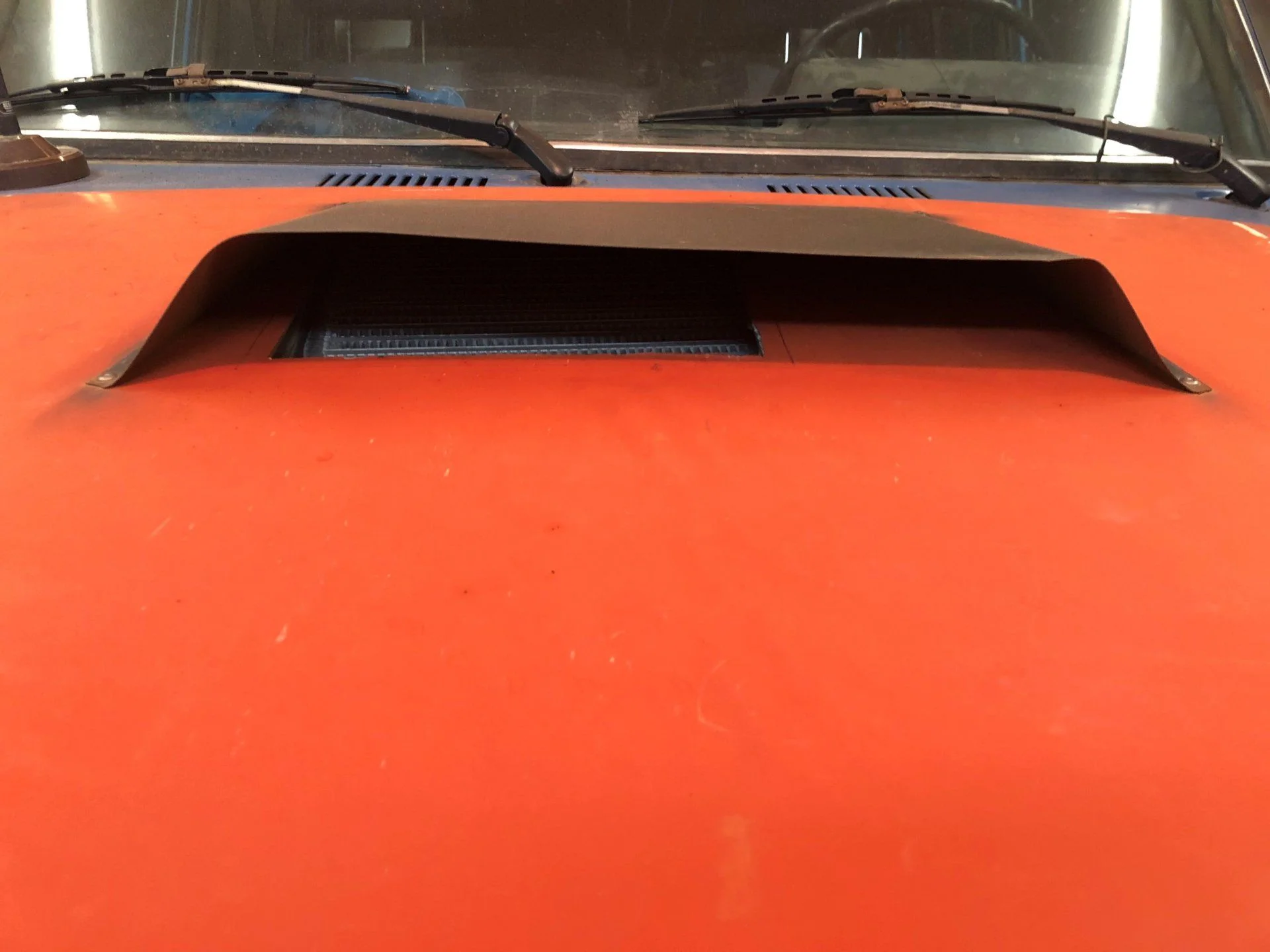

The intercooler is just an ebay intercooler. The manifold is flipped around so the turbo sits lower and is clocked to point up, making more room than the factory orientation.
There is no wastegate at all, I don't want to waste any boost. I had wired the wastegate shut previously, but that would fall off periodically, so I tack welded it the last time I had it out. Some might call that a little reckless, but as long as the engine doesn't overheat, and the EGTs are low (currently in the 7-800F range), I'm just gonna keep on keepin' on.
Damn ... you are running 20 PSI of Boost into a 3B Series 1 engine ? Have you done anything to it and is it happy with that much boost ?
Yup. I didn't say it was wise.
Its been running like this for years. The PO did the conversion and added the MLS gasket. I have bumped up the timing and turned up the fuel, and that is pretty much it.

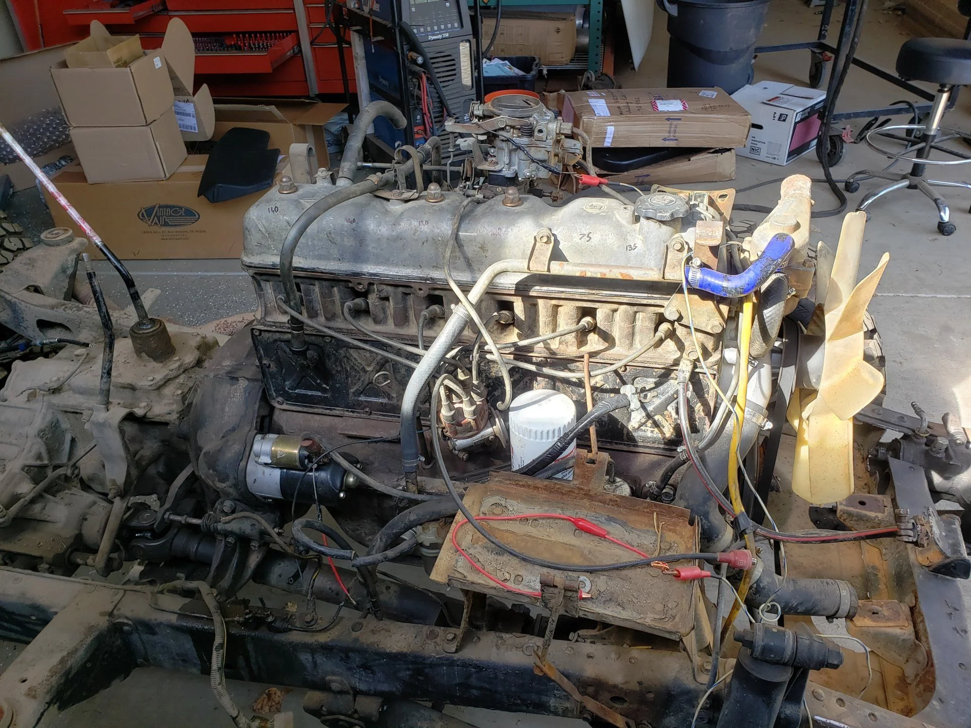

So with the FJ43 pulled down to chassis it was time to do some clean up and send the engine and transmission off to its new home and pull the chassis down to pack and store for the BJ46 Project. The FJ 43 cam with a drum brake front axle with out free wheel hubs and a full floater rear axle. It is always interesting the combinations you see on different market spec vehicles.

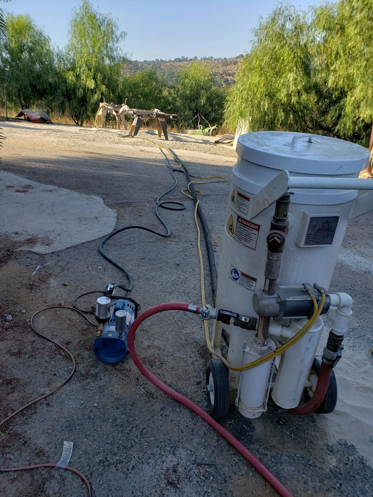

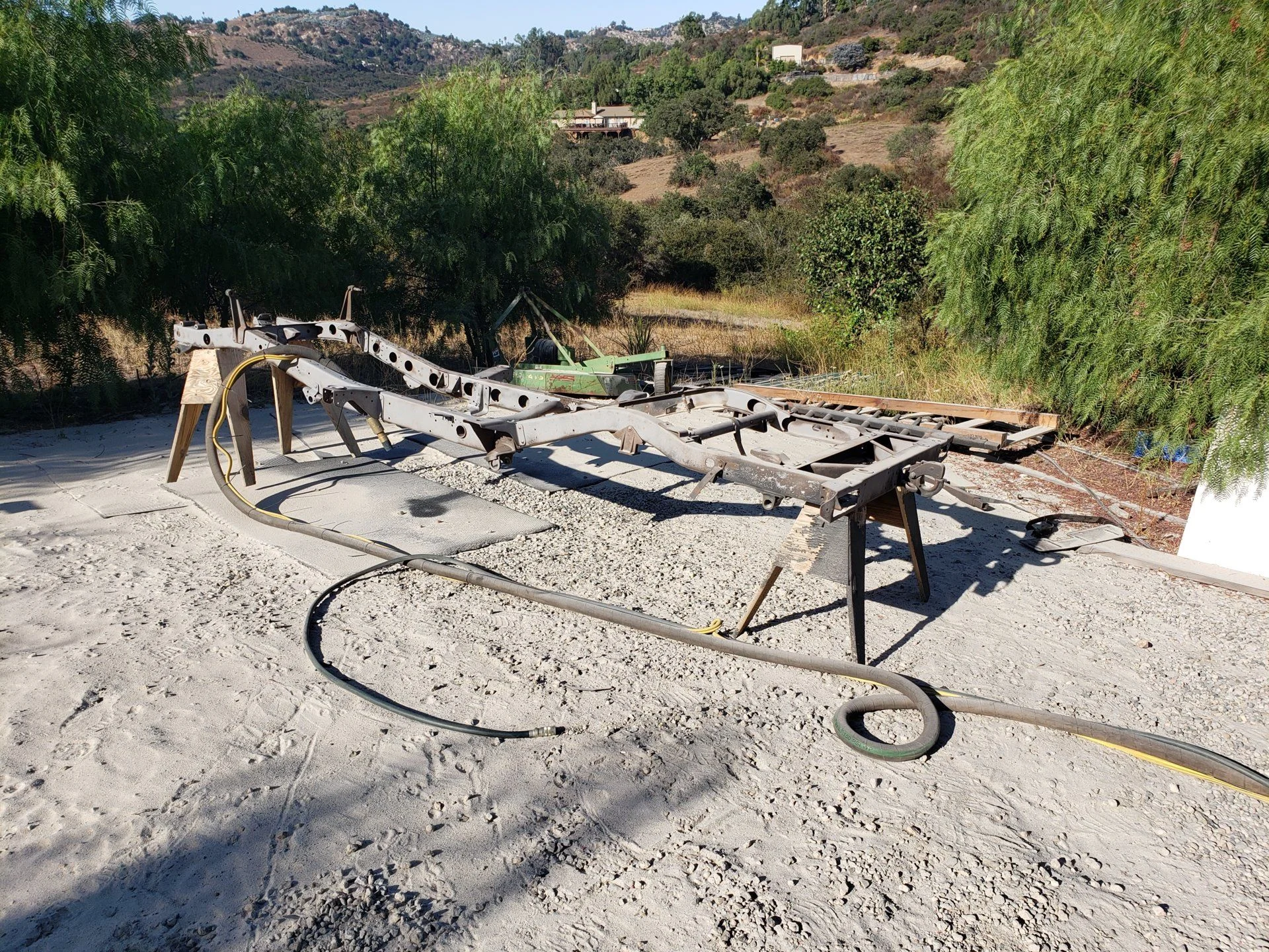

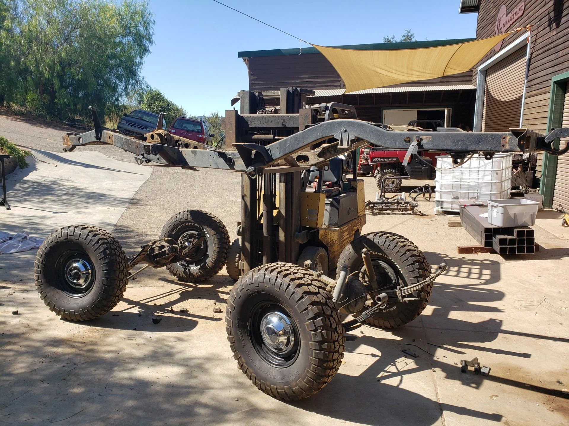

At this point I took a minor detour and decided to sand blast the FJ43 Chassis and make sure it was good for the BJ46 build. I didn't want to hang onto it if it wasn't what I expected.
As luck would have it she was 100% rust free ..... pretty impressive for something that old but again the advantage of a desert truck that mas probably seen very little rain. When I pulled it apart she was FULL of Dusty .... the doors where literally chocked up to the bottom of the door cards with it.
Once blasted she will get a seal coat and then off into storage

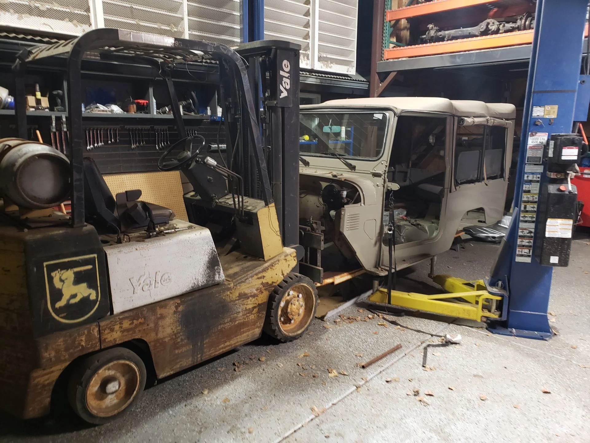

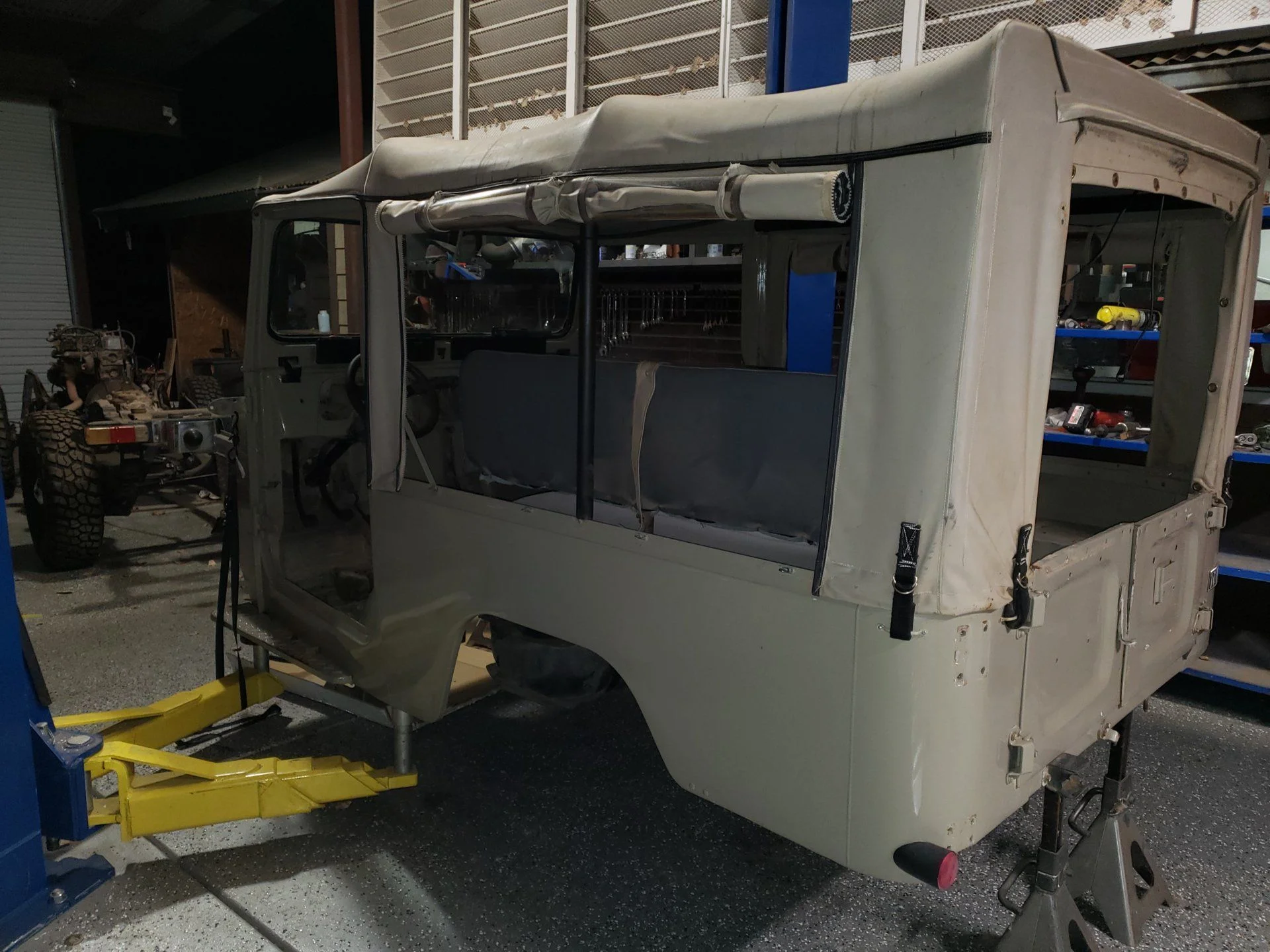

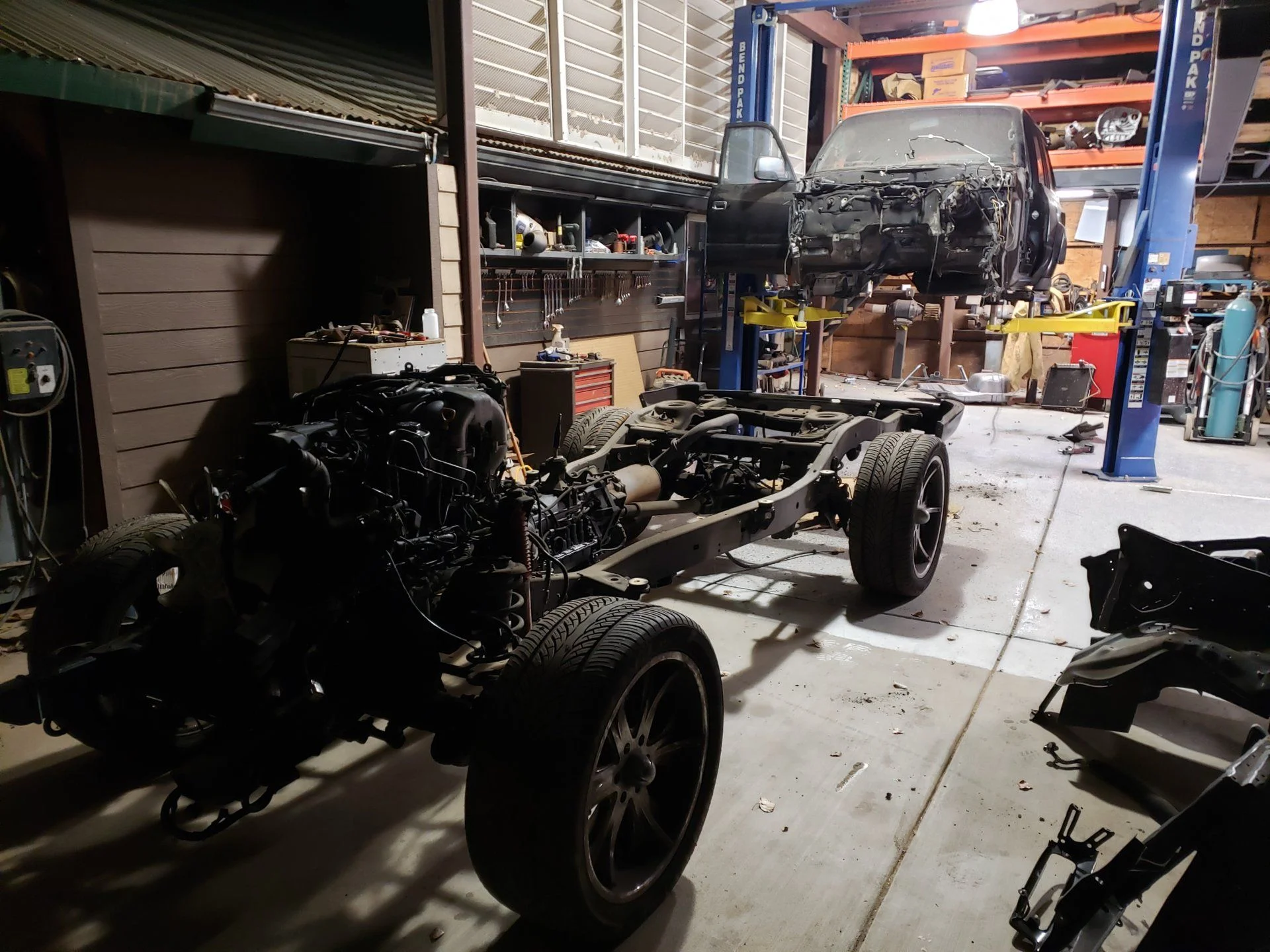

With the FJ 43 Body off the chassis it was time to clear the hoist and move onto the Z part of the Build.
43 Part Out !!

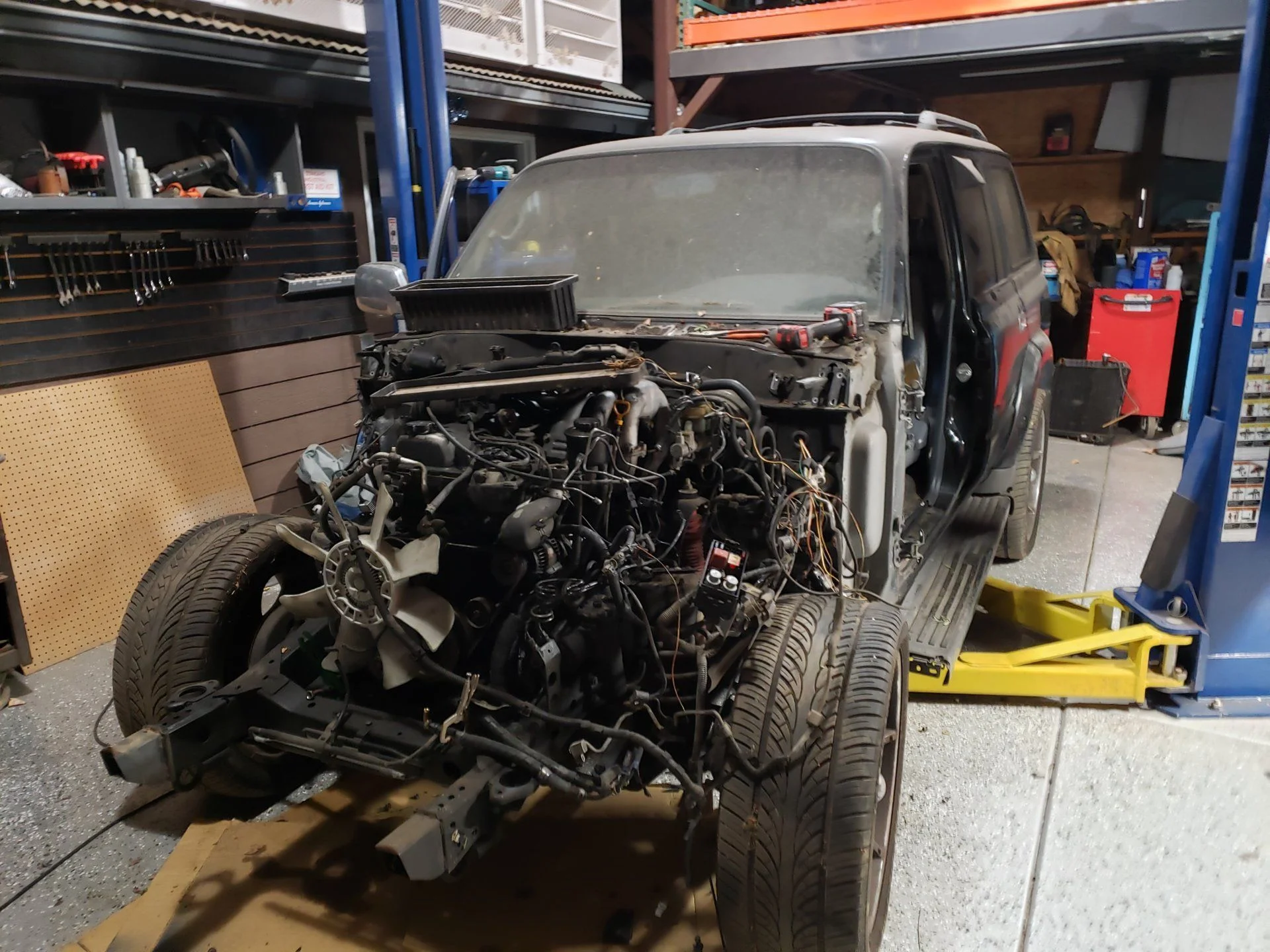

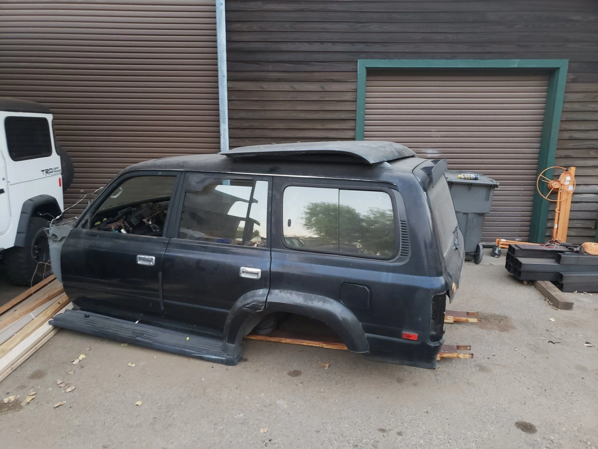

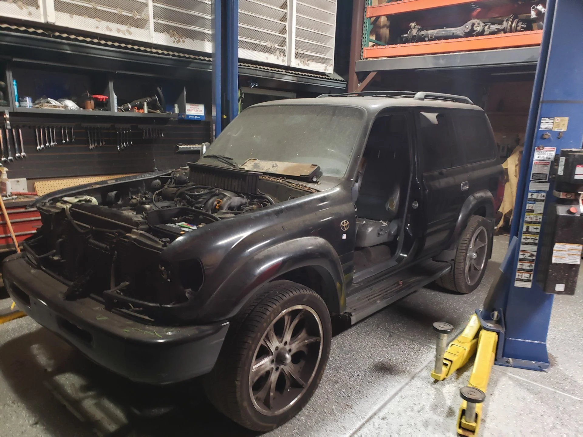

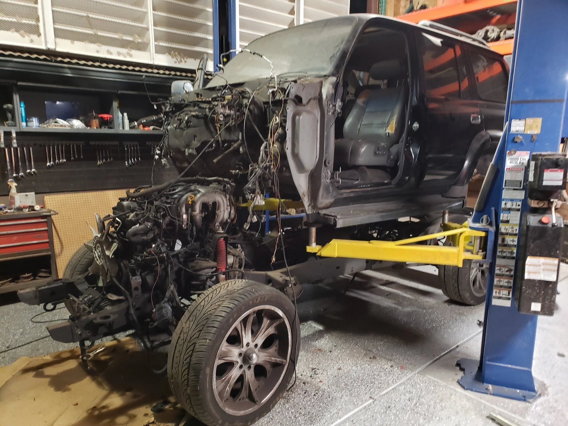

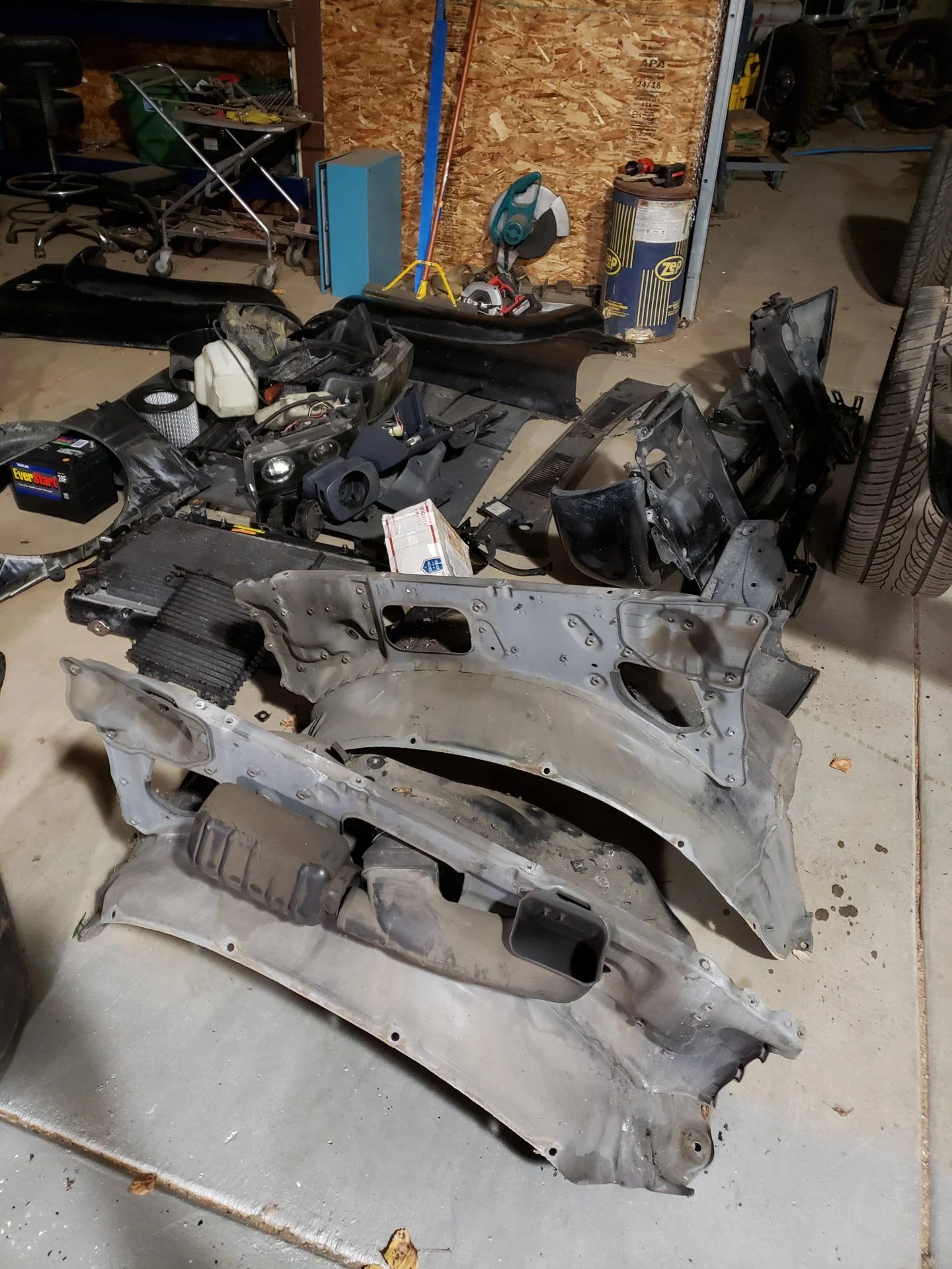

The 80 series is so much less fun to pull than a 40 series, good thing I don't have to pay to much attention to where stuff goes as it is all going out and not going back in .
Always a fan of pulling the drivers door so I can get to the bits I need to while it is on the Lift
hmmm something tells me this pile will grow as the night goes on
Look at all that junk, won't have that issue with the 3B :)
Up up and away, those fully sick 22's looking smaller by the minute .
Ahh finally the bot we want with the most oil leaks I have seen, so much oil leaks the underside of the carpet was soaked from it ...
Must have been a big night got to wake up and see the left overs :)
The Old 80 must have been sad it was trying to snuggle up to its older brother, he was no help though his head was sore and waiting for a 12HT to make him happy again .
So long 80 ....

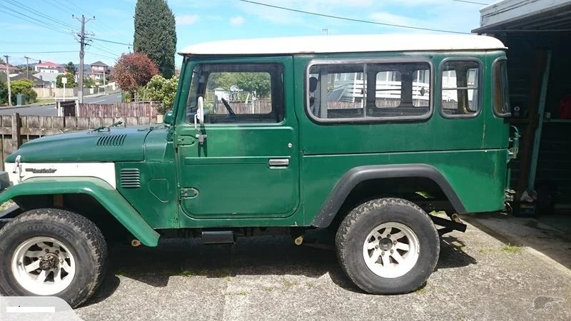

Sweet, here is my other one which is my BJ46 , it always looked like the wheel needed to go back at least 5 inches
I'd agree with you on the distance it needs to go back.

Have to love a 46. What is the measurement of the back of your wheel arch to back of truck ?

Previous owner hacked the guard so its no longer standard.
