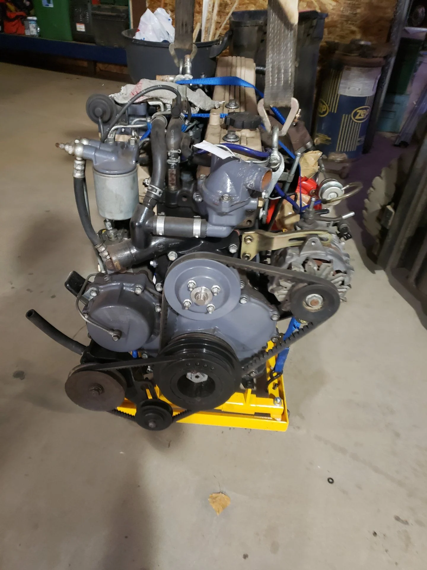

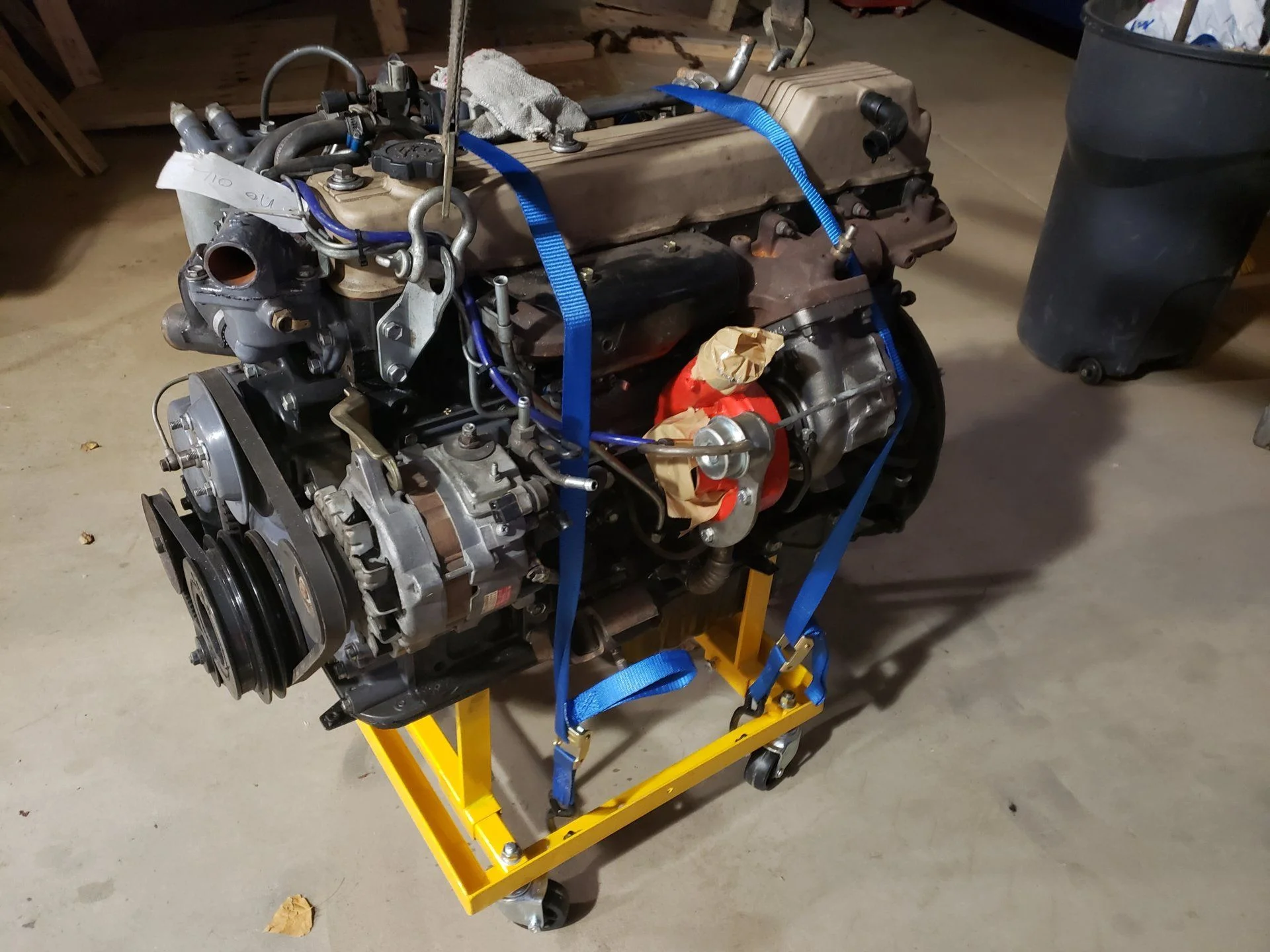

Ok gunna take a few weeks off while I do some more side work to fund the next phase of the build.
Have to stick this into something cool and make it go vroom vroom

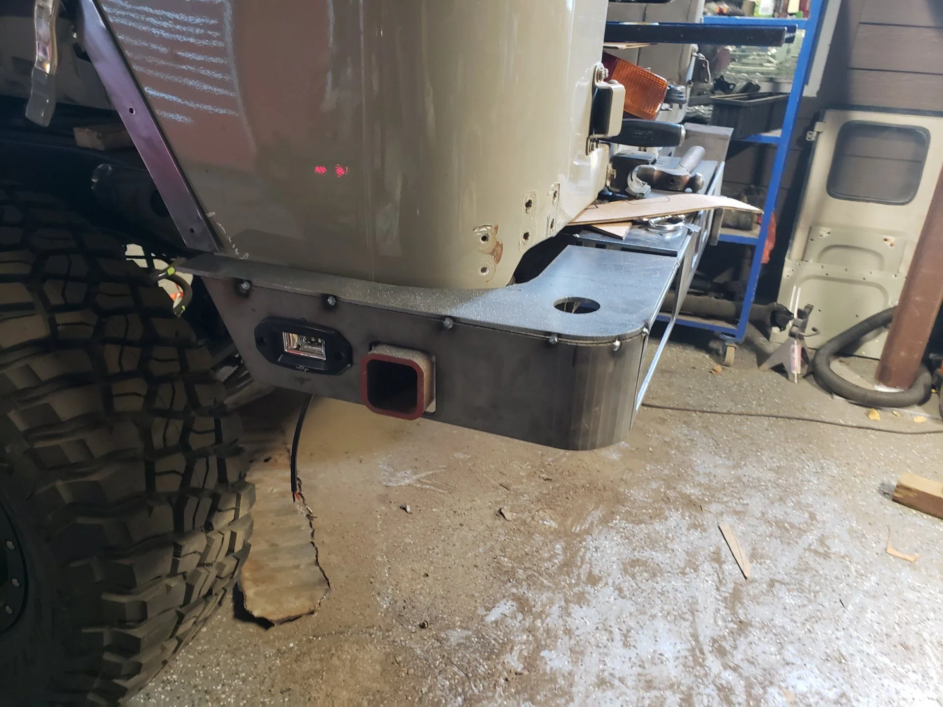

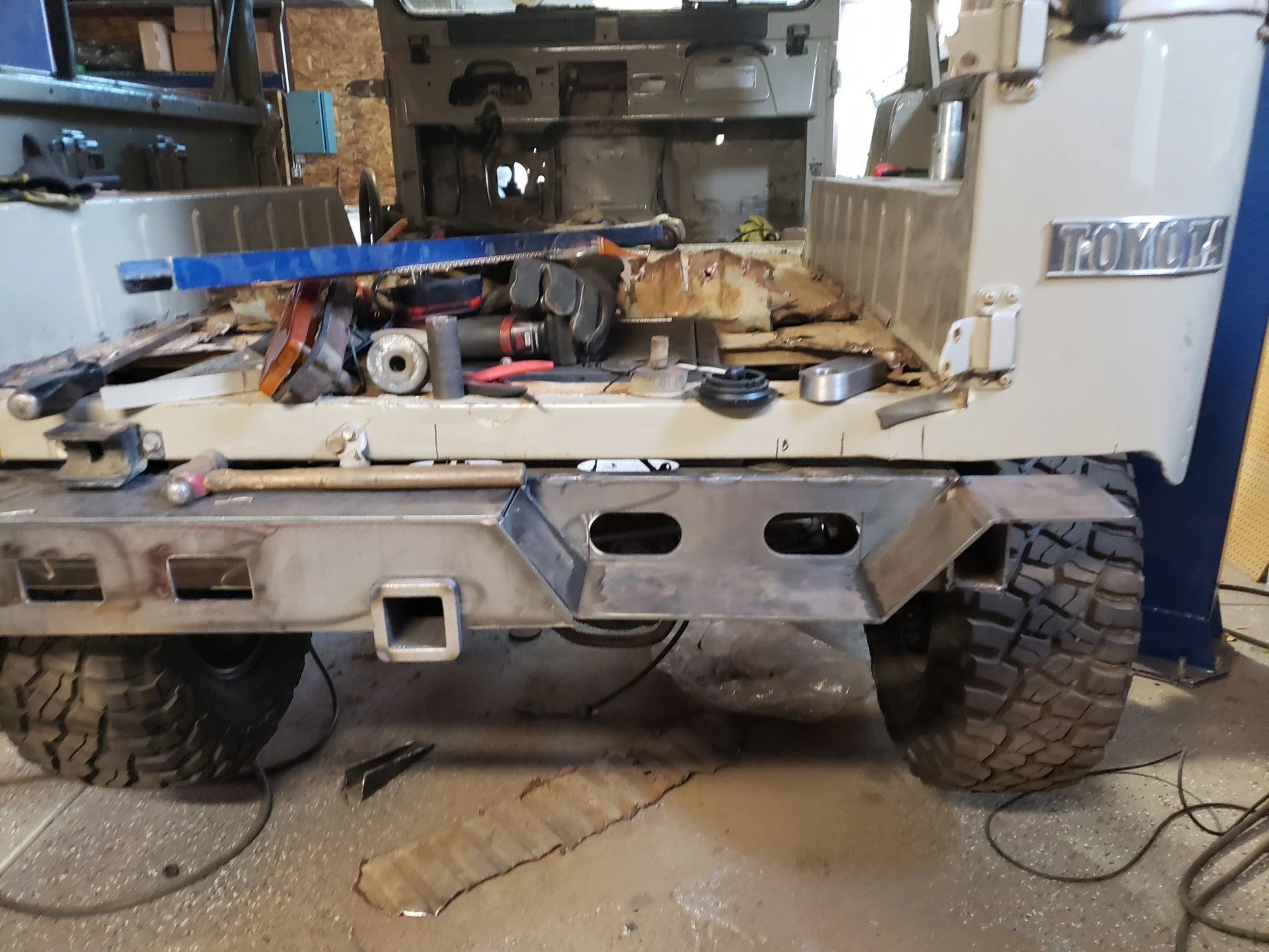

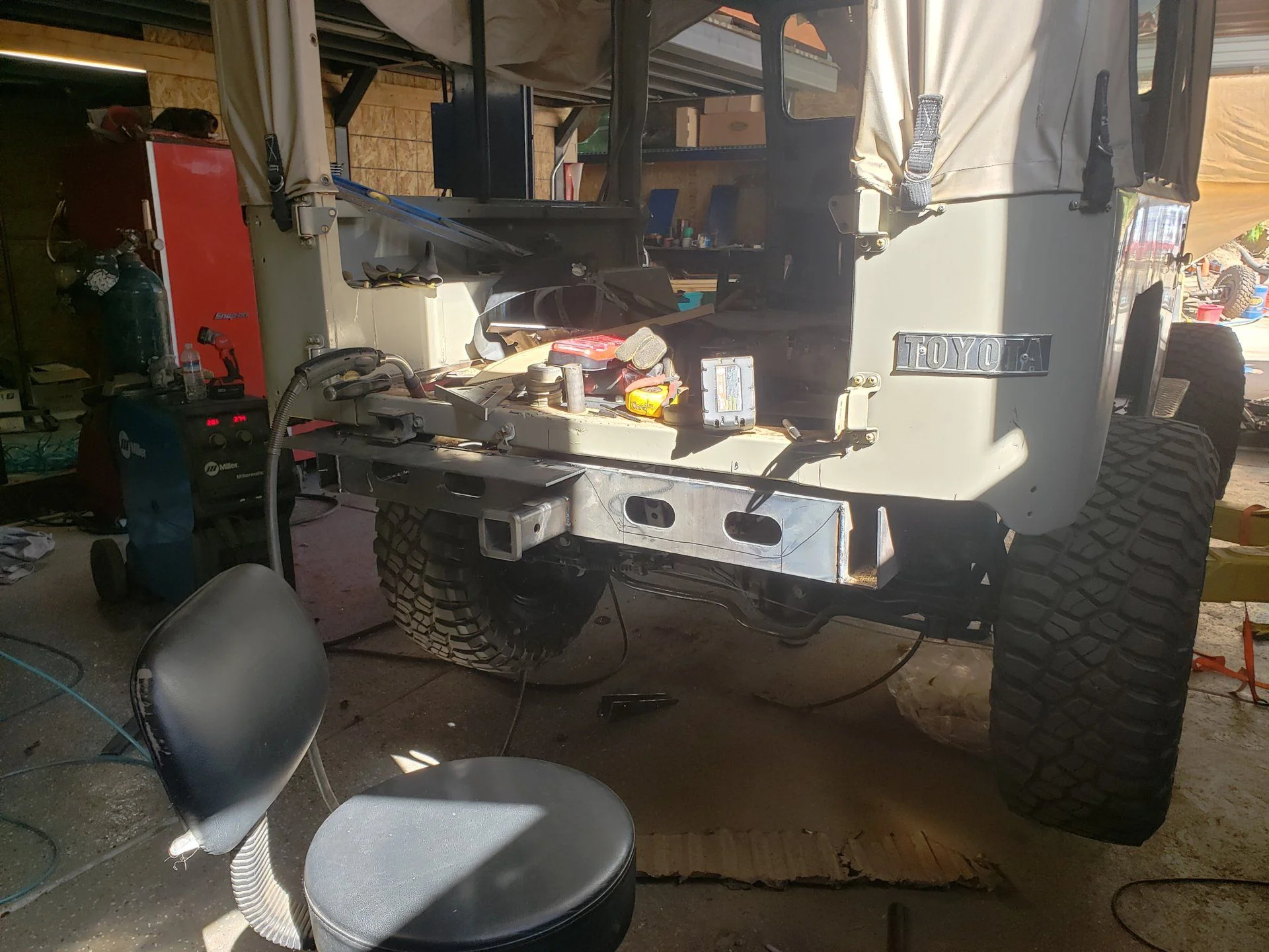

So things are running a little slow but with 80 series number two dieing last night for the other build I snuck back onto the BJZ43 to have a look at the rear bar.
It will be plate design with some lights and tow hitch etc. I will also put side hitches in for recovery points and high lift points.
Still a bit to do but getting there, will be 3/16 HR mainly with some 1/4" and 1/2" mounting flanges.
It will tie into the rear chassis section that is being modified to give more clearance.
Since I am using HR she will just get the mig treatment like the chassis.
