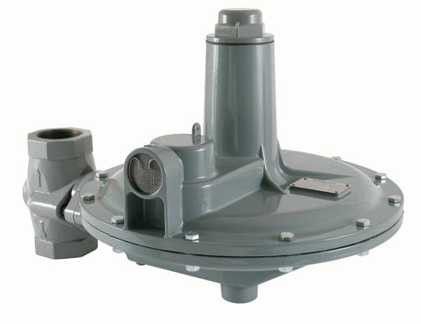

We use a lot of that style regulator too at work and there is nothing wrong with them. It depends on the manufacturer (we use mostly Parker), but their suitability also depends on their size. 1/4 inch might be a little puny for this application. It may not be enough flow to seat a bead, but it will fill tires and run an ARB. The 3/8 included in the kit will be much better.
Not sure what manufacturers we use on ours but these two styles are the ones that look like what we use. There are regulators out in the field that are going on 30 years old and still work great.

"Those type"? As opposed to what other type of regulator? Most regulators used in OBA kits are the same type but a cheaper version. I'm using Norgren and its beefy as hell. The HB and Viair ones are puny.

those regulators are fisher valves ;)

Those are very different types of regulators. The first one appears to be for fuel gas applications with a typical inlet pressure of 10-20 inches of water to fixed outlet 3 inches. The second type is adjustable, but it is not designed to be as easily adjustable as the ones with a knob and a lock ring.
Joey has the right type of regulator for the job.
You're correct. The first is what we use for the pilot gas to our heaters. The second is an adjustable and is used for all of the instrument air and nitrogen to our controllers.
