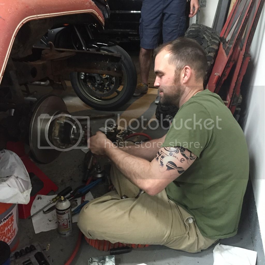

Been working on a disk brake swap with some mini truck knuckles I picked up from shmuckster, who helped me with lots of questions before and after picking up the parts. Very knowledgable guy. I keep running into little problems mixed with real life slowing me down from getting it done.

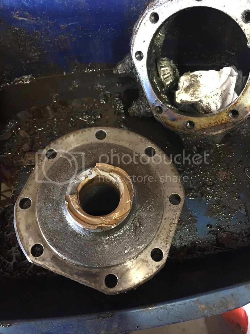

one of the mini truck knuckles looked like a trunion bearing failed and cycled through tearing up the dust cover. the bearing was seized to the bottom plate (don't know its proper name) It took lots of heat and persuasion to free it. I only thought to take a picture once I had partially freed it.
That's spindle bushing damage is no fun...
If you want to trade a good spindle with a clean brass insert for that one, let me know. I was

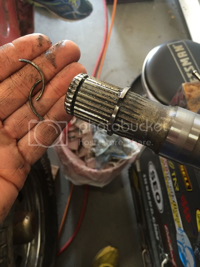

That inner clip breaks more often than not when separating birfs. I have a few of those laying around as well, but I suspect, based on the picture of you packing the birf, you either had them on hand or need them sooner rather than later.

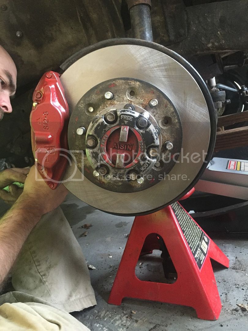

pieced everything together today, just need to pick up a longer vacuum hose for the brake booster. The new master cylinder had slightly different clearances.
I still haven't checked my alignment. Not sure if I'm going to have to do anything to make it right.
Test drove the yota. Night and day difference. So glad I went this route. Stops quick and straight. Tried some hard stops from about 40mph and the rear may have locked once slightly. Not 100% sure but it squealed for a second.
