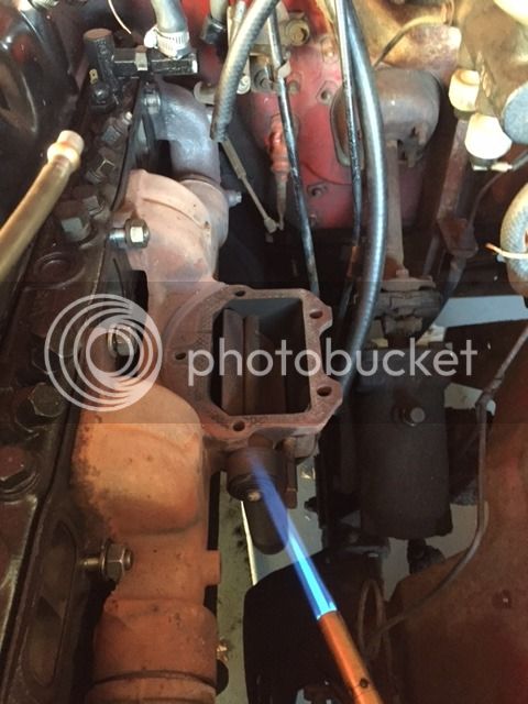

Truck has been running rough and felt like progressively worse. Fixed a couple errors on the rebut carb at a club tech day and put it on. The truck runs betterish maybe RPMs too high, can't really adjust... found this in the process...cracked intake manifold. Why did it crack?? It was milled with the exhaust manifold a year ago. Maybe the engine is running too hot??? bad water pump?? I need to find another one now.
A local machine shop is welding the intake. Any thoughts on why it cracked? Maybe running too hot??
Was the exhaust riser shield in between the two manifolds? cracked intake is a common problem if it is missing.
