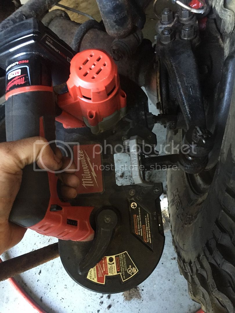

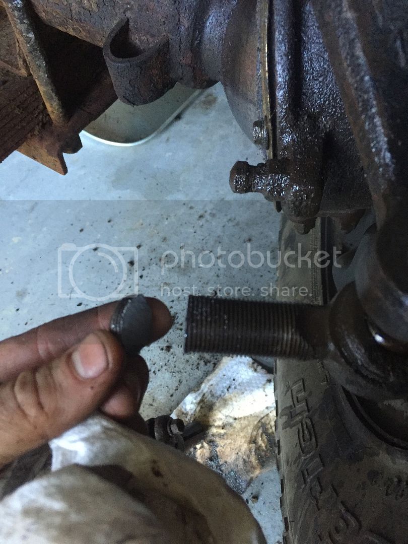

I spent some time on the alignment and ran into a small issue. The tie rid ends were already screwed completely in and bottoming out in the drag link I was still at about 1 3/8 toe out. I didn't see another obvious solution so I shortened the threads on both tre's so that the drag link would accept them a little further to get the proper alignment. I still have the same number of threads engaged so I don't think I gave up any strength. Truck is sitting at the proper 1/8 toe in and seems to drive straight.

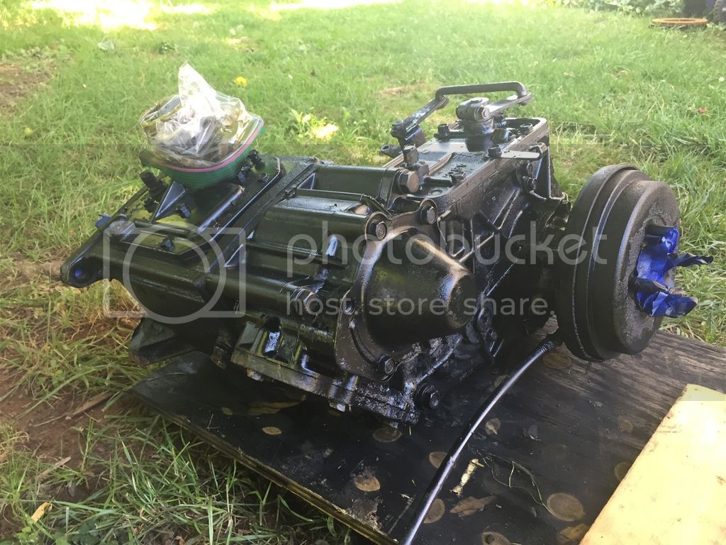

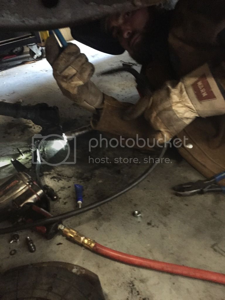

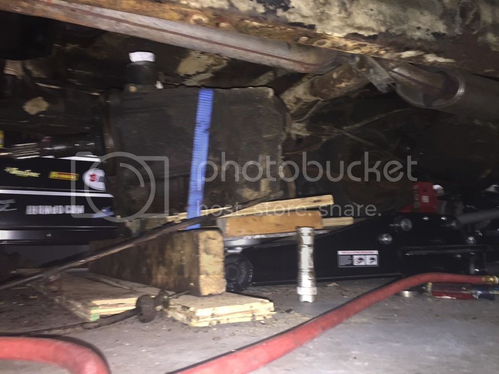

No sooner than I got the brakes straightened out and the vacuum leak fixed the clutch went completely out. Master and slave cylinder are good, maybe the clutch itself??? Rkymtnflyfshr hooked me up with a used clutch to install since I'm short on $$$ atm. I spent a good part of the day dropping the trans and transfer case. Wayyy messier job than I anticipated. Plus it took me a while to realize the exhaust was bolted to the transfer case....:doh:
All and all, good day wrenching with the GF

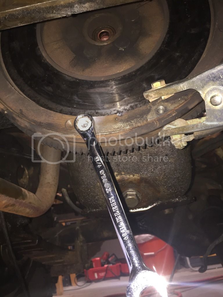

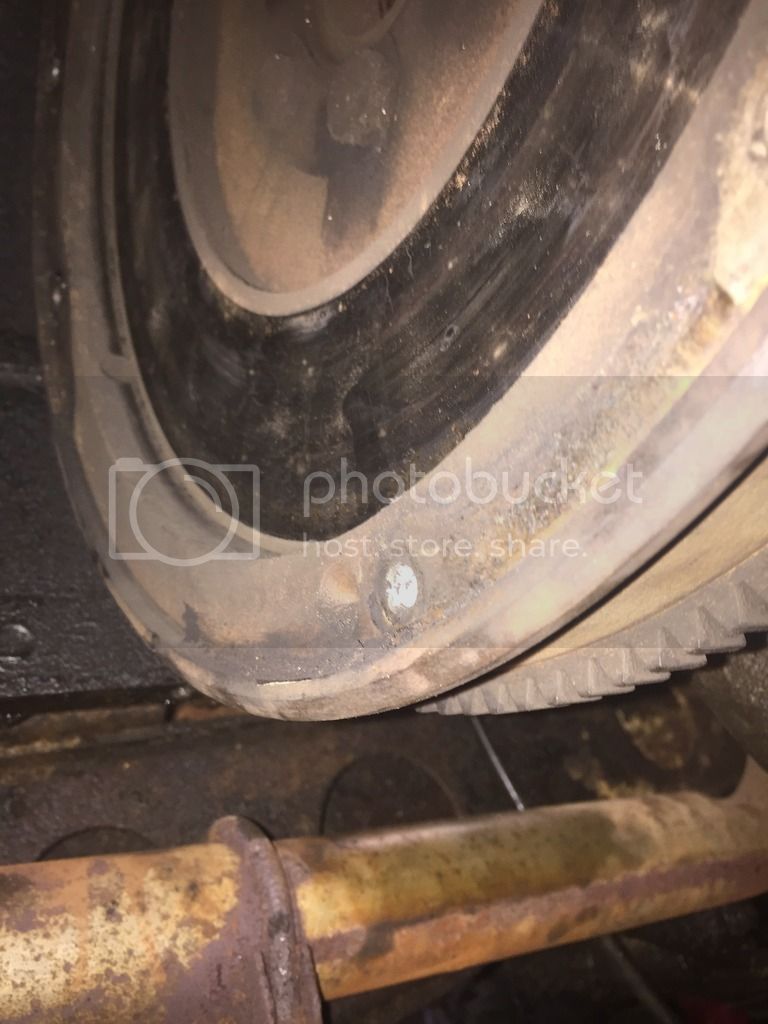

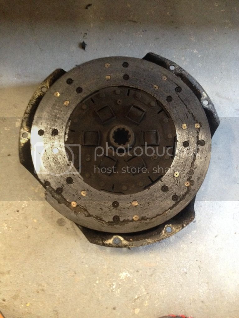

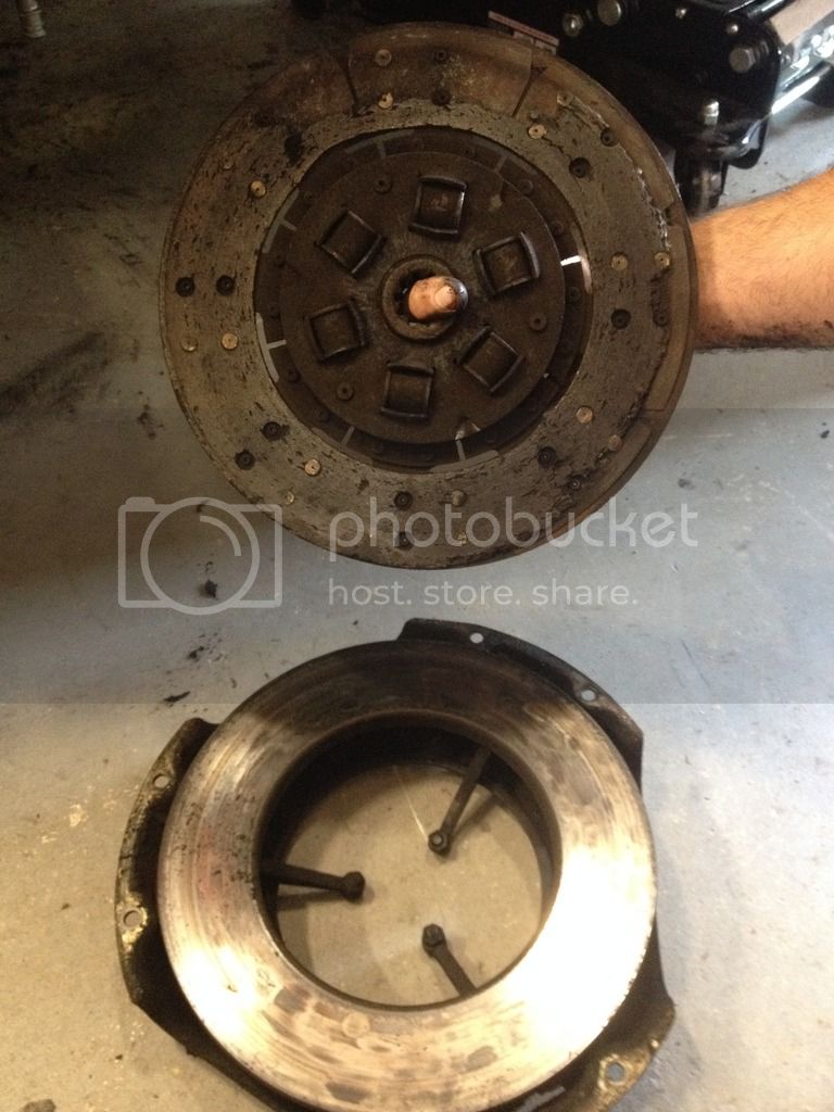

Spent a few min on the cruiser. shaping to old clutch for the "new to me" clutch...six bolts in and out... super easy....until I broke one off in flywheel :bang: I guess air tools are a bad choice for this job.
Faster is not always the fastest way...
welded a nut to the broken bolt before the red loctite set up and was able to get it out of there and continue fitting the clutch. Waiting on the pizza man now to take care of the kiddos
Love that trick for broken bolts, drilling them usually ends with the drill finding the softer material than the bolt "Guess that bolt did need moved over 1/4 inch...". Nice work!

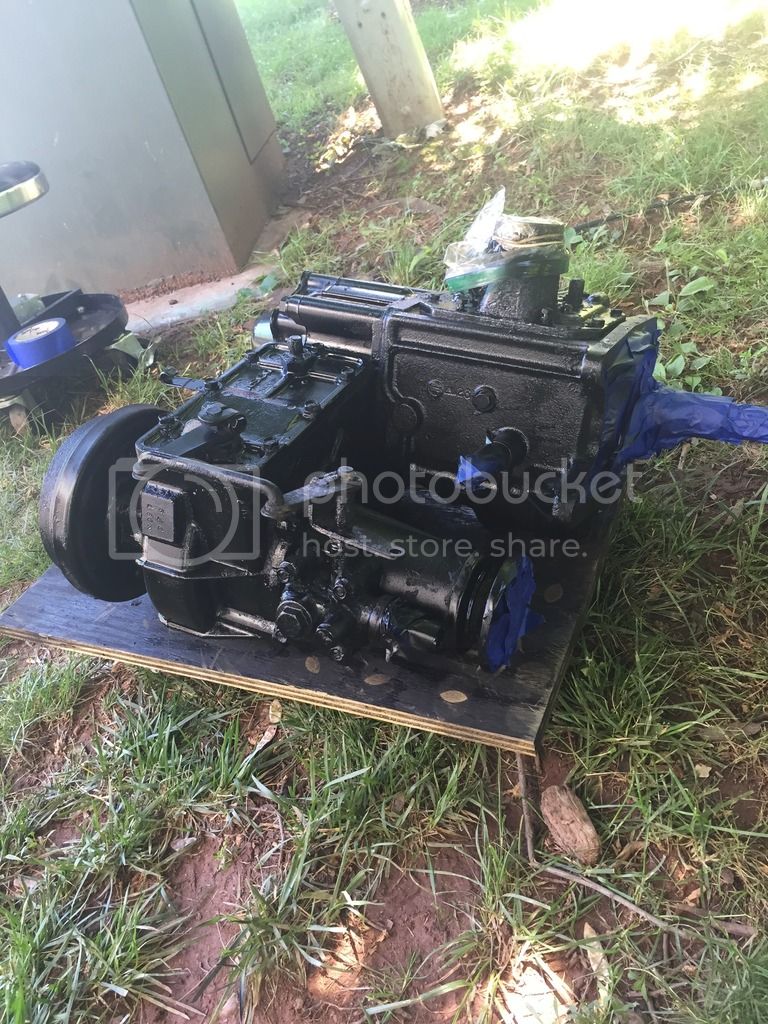

Thanks so much to rkymtnflyfisher for coming up to get that heavy pos three speed mounted back to the bell housing. Had a hard time trying to safely make it happen with my sons. Video is first test run. It jumped right out of the driveway and kind of surprised me. Popped the clutch and about stalled going forward, lol. Night and day from before. Truck is finally coming together. Lots of other small issues to solve but a great afternoon cruise.

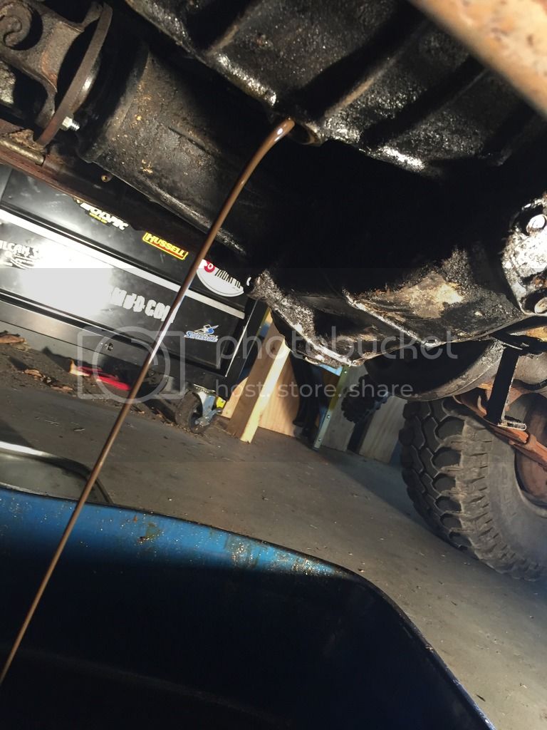

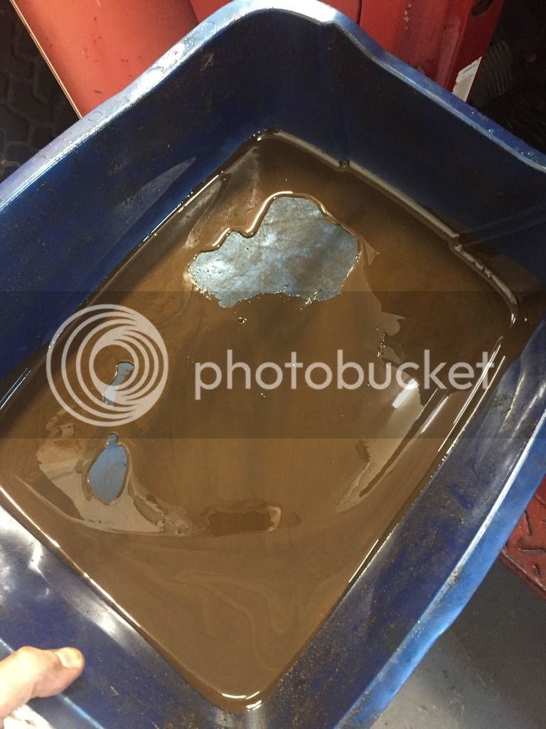

While I had the skid plate off I wanted to change the oil in the trans. This pic is all that came out, even though the FAQ here says it should hold something like 3.8 qt???
Hard to tell but thats like nothing....
That oil was a bit milky... You might want to run some elcheapo gear oil in the trans and t-case for a few miles and change it once or twice before filling it with decent stuff.
I changed it again last week and the new oil already looked nasty (pic) l
I hadn't yet changed the t-case when I did it was almost empty and really dirty. I changed the diffs also, they were full of red oil, maybe marvel mystery oil?? Weird.
