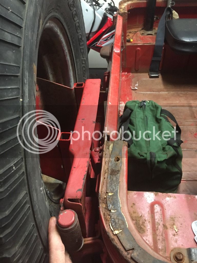

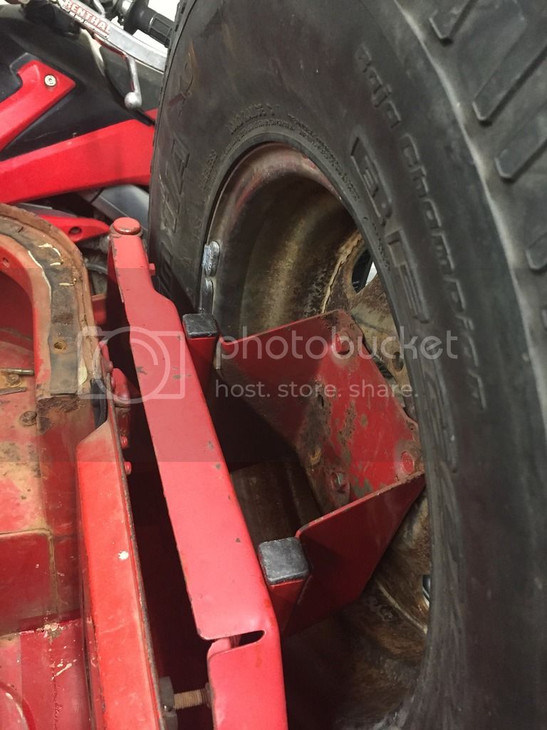

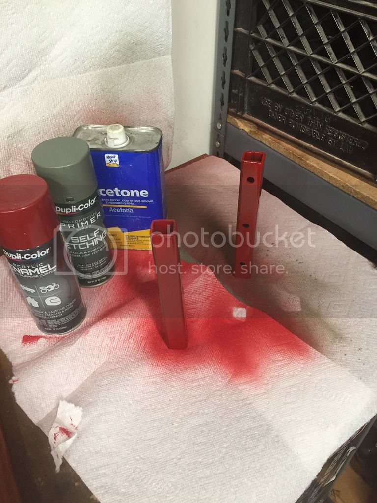

Ever since I put the 31" mud terrain on the rear swing out, it has been contacting the swing out hinge. Causing it to work it's way up several inches at times. The gf and I made spacers this weekend to move the spare tire a little further out from the truck. As I'm writing this and looking at the pictures I'm realizing maybe we should have made end caps for them. Anyhow, been so busy it felt good to spend a few minutes on the truck.
At some point, you can upgrade your spring plates to later model ones with integrated shock mounts that allow you to mount your shock lower and increase travel.
Now I've got a 1/2" clearance between the hinge and the spare. For the first time the spare sits flat against the mount. Its a little thing, but it made me happy.
Hey those look just like mine! I still need to get my two plastic end caps. They should be available to fit your tube assuming you used a standard steel tube size.
I harvested end caps from my dirt bike stand. Thanks for the idea stump!

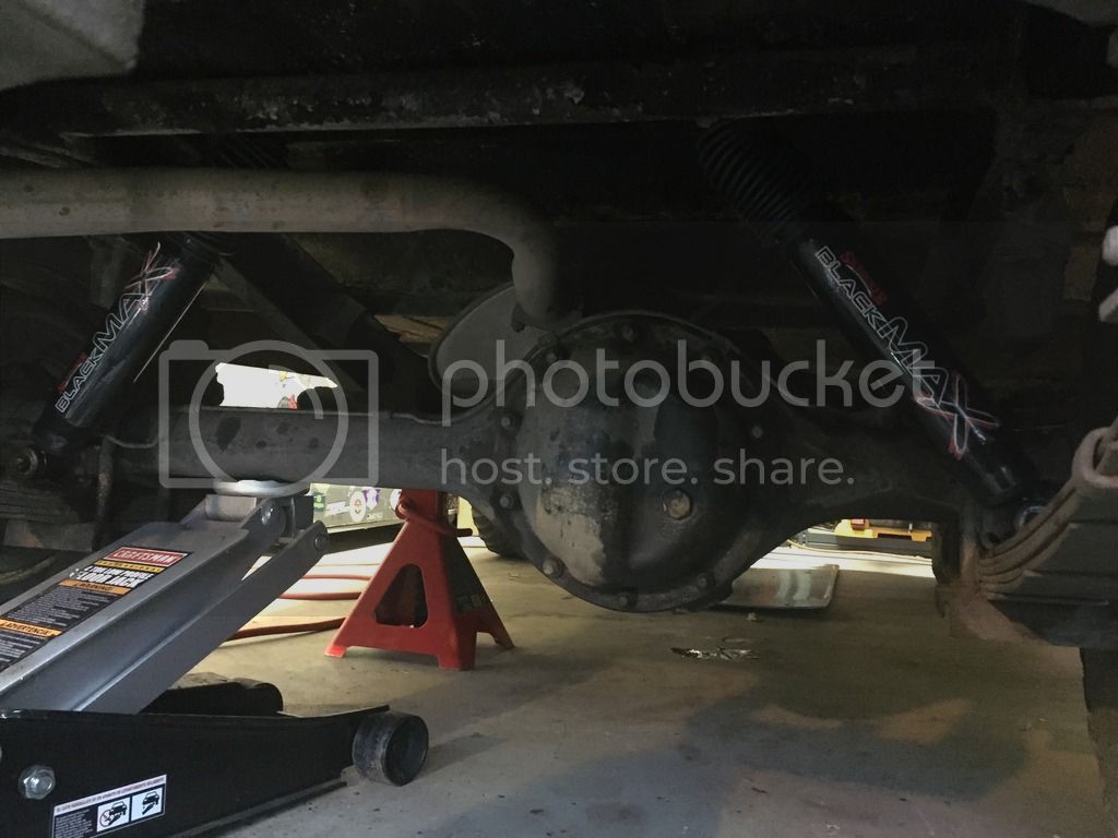

Shocks are upside down...
I've seen shocks mounted both ways and the box said they could be mounted in either orientation. i think I'm good.
Just the way i feel haha. I look at it like this:
-make a fist around a pen with the vertical, now pour a small amount of water around it then move pen up and down where does the water go? Now try it with the exact opposite way haha. Just my opinion on shock mounting. All good man

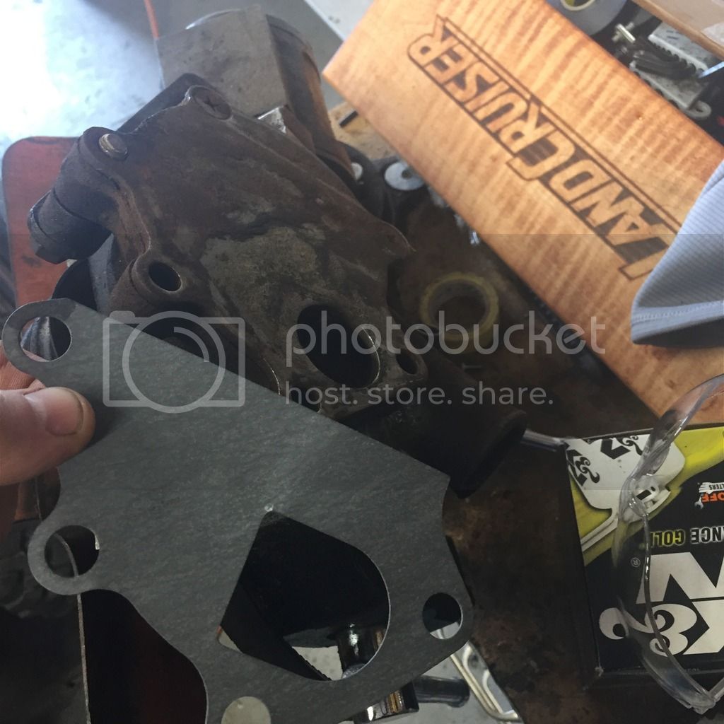

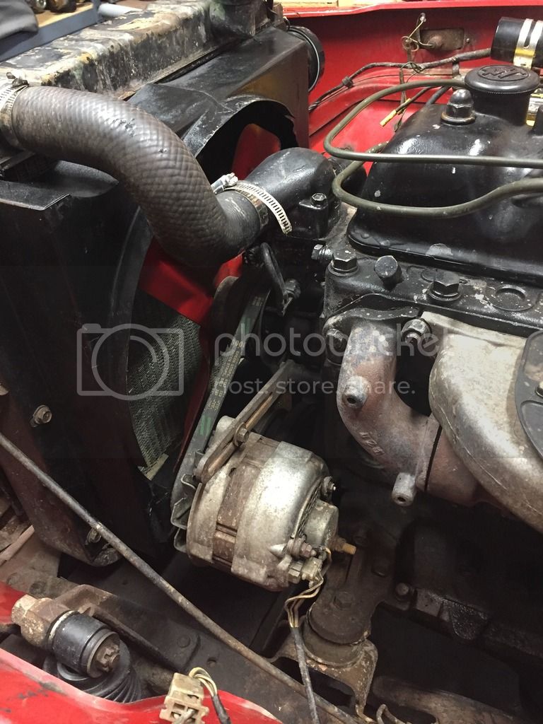

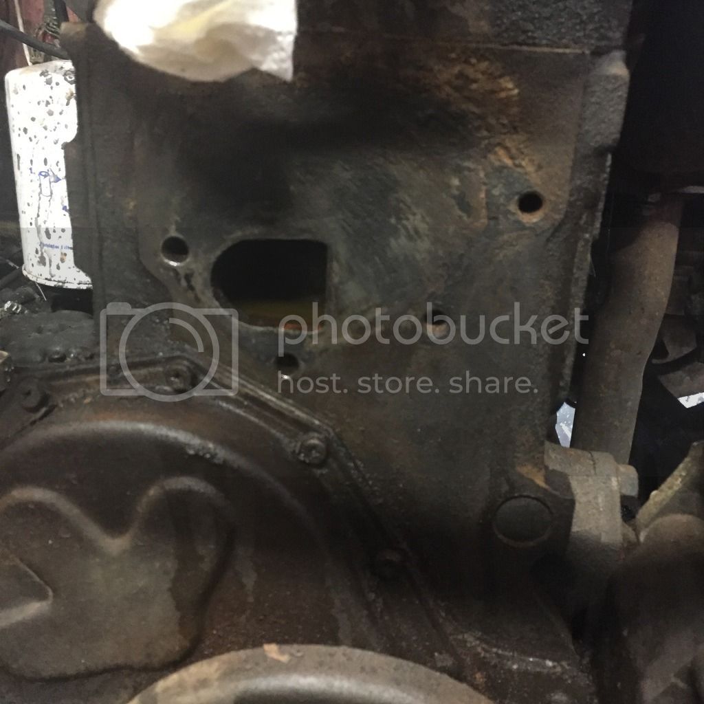

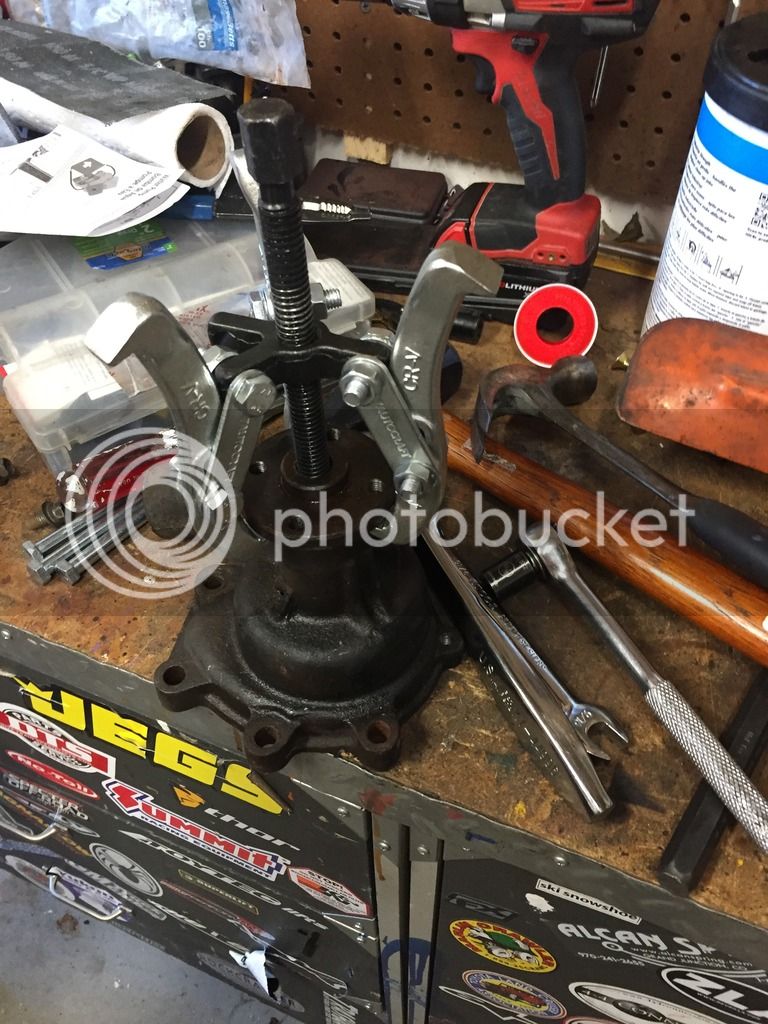

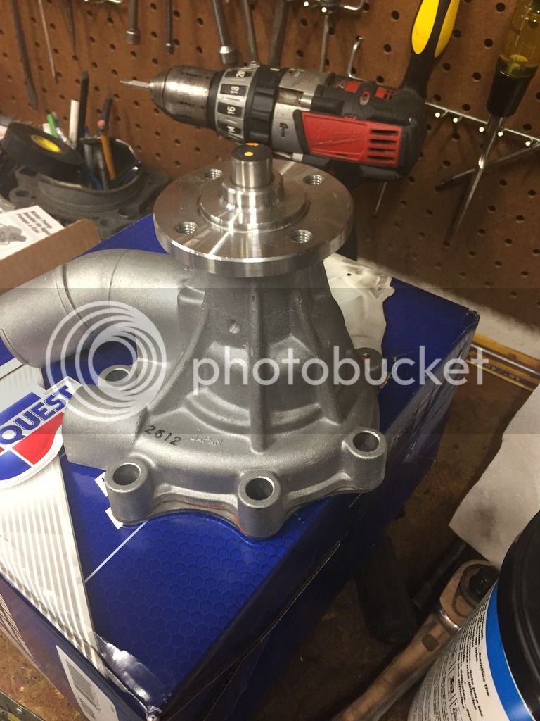

sooooo water pump started leaking again. This time from the between its body and the back plate. I pulled it apart again and RTVed a good seal. After putting it all back together I see now that its also been leaking from the seal up front. :crybaby: So I did what I should have done the first time. I picked up a new water pump for 40 bucks after using my advance auto speed perks. Got it all apart again and see the new water pump has a different size hub and the pully wont fit over it.o_O After a little advice from rkymtnflyfshr and my neighbor, I got a puller and swapped the hubs. more of a pita than I thought but its finally done. Got it all back together and finally no coolant leaks! Sorry I missed the guys at GSMTR!!
