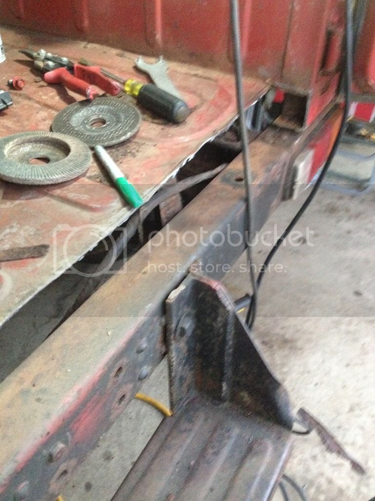

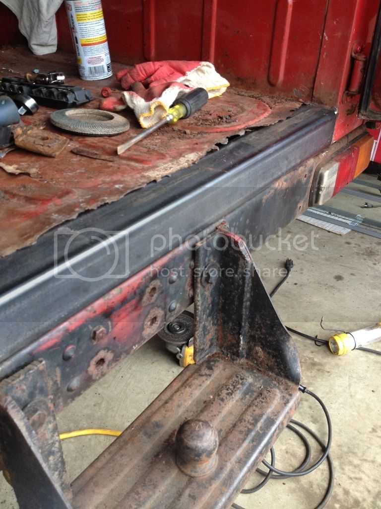

Spent some time on the 40 since its finally warming up in the dc area. Working in my apartment complex garage, really difficult to grind quietly...
not exactly sure of the best way to bolt the 2 1/2 x 2 1/2 square tube to the frame. I saved the rubber isolators, I guess Ill drill and tap the 1/8 thick square tube and run the bolts up through the frame?? Opinions???
