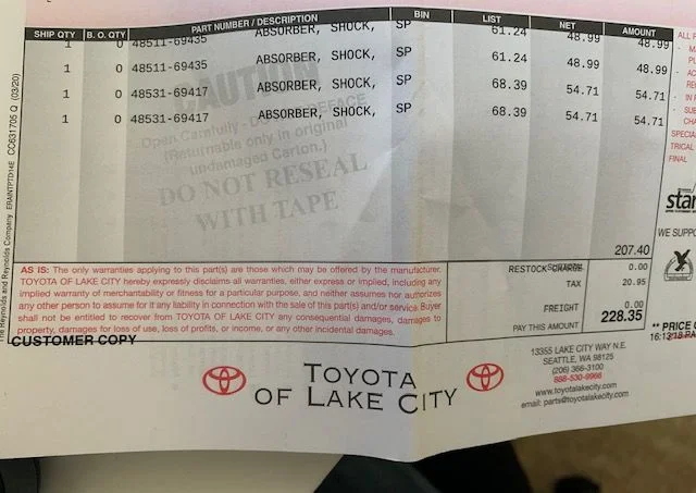

About to replace my dad's 97 with OEM shocks and the stock height dobinson springs. I'll take some before and after photos and post em up. FWIW- the OEM shocks from toyota were like $60 ea and I think theyre an awesome value if you're not going full expo.
Wow, that is a good price for stock shocks.
$228 out the door and they come with new bushings and hardware
