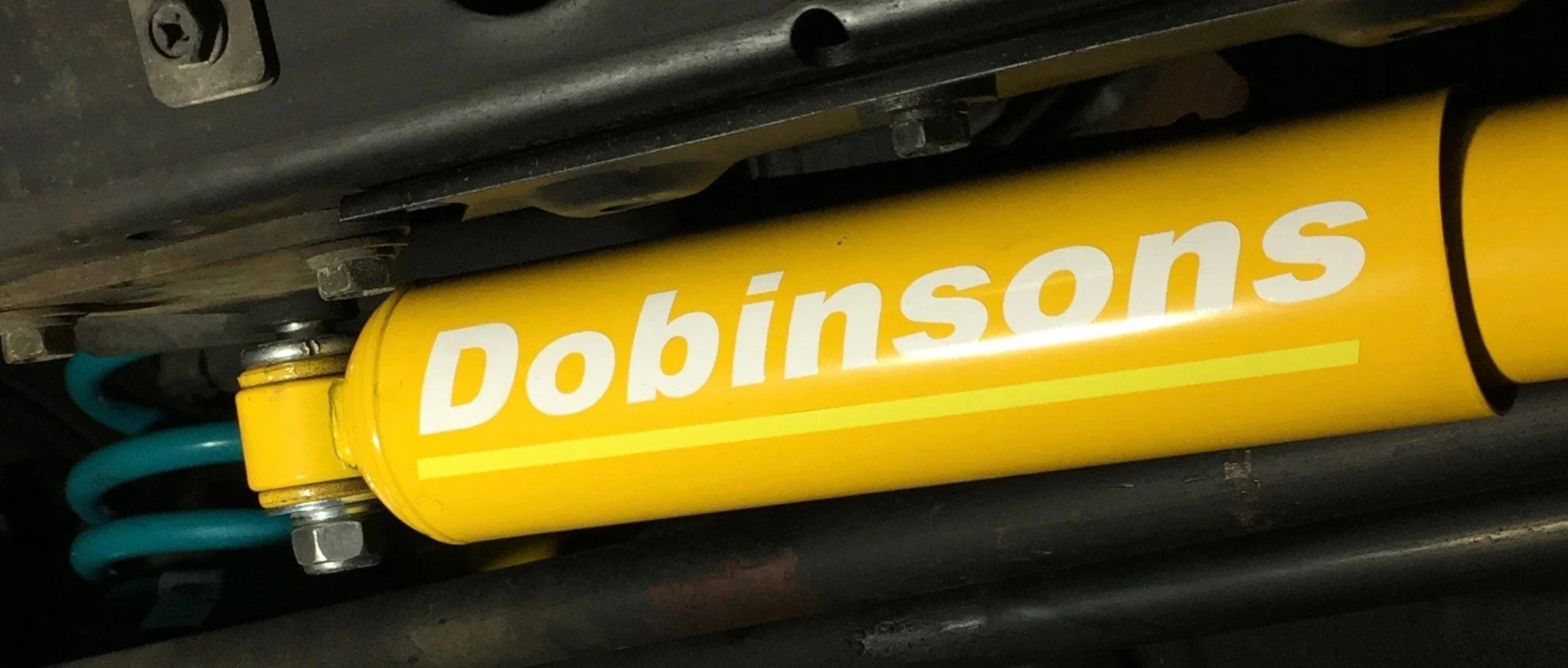

- SD59-824 – Heavy Duty (Big Bore) Steering Damper, complete with Fittings

I’ve done a few thousand street and highway miles on this setup, and would certainly pronounce myself very satisfied so far. Work schedule permitting, I will get in a bunch of fire roads this winter and maybe some sort of group drives (hello, TLCA!), and report back, ideally with more pictures than just that purty steering stabilizer and that teasing bit of coil spring!

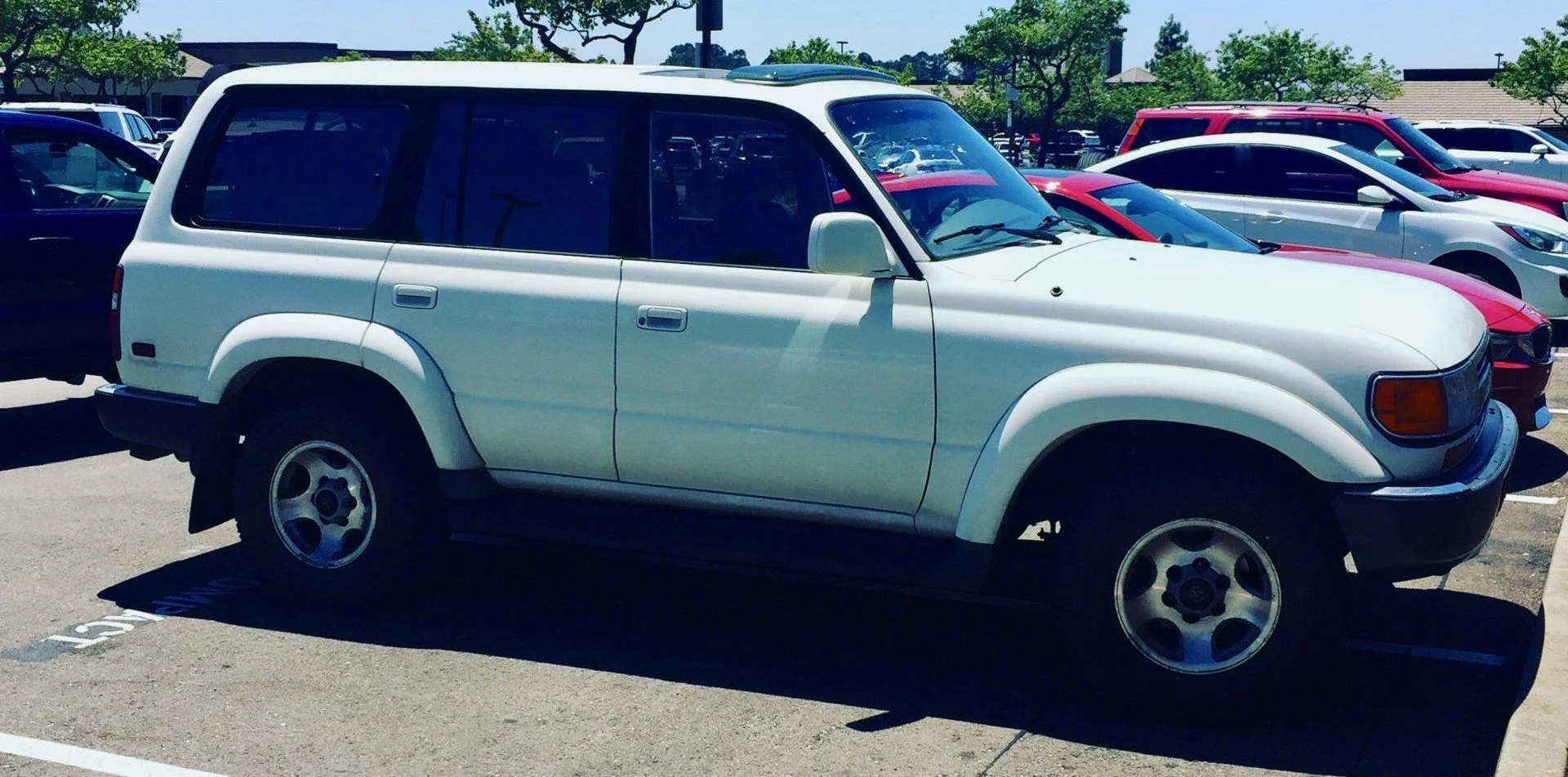

Any pictures of the truck before and after ?

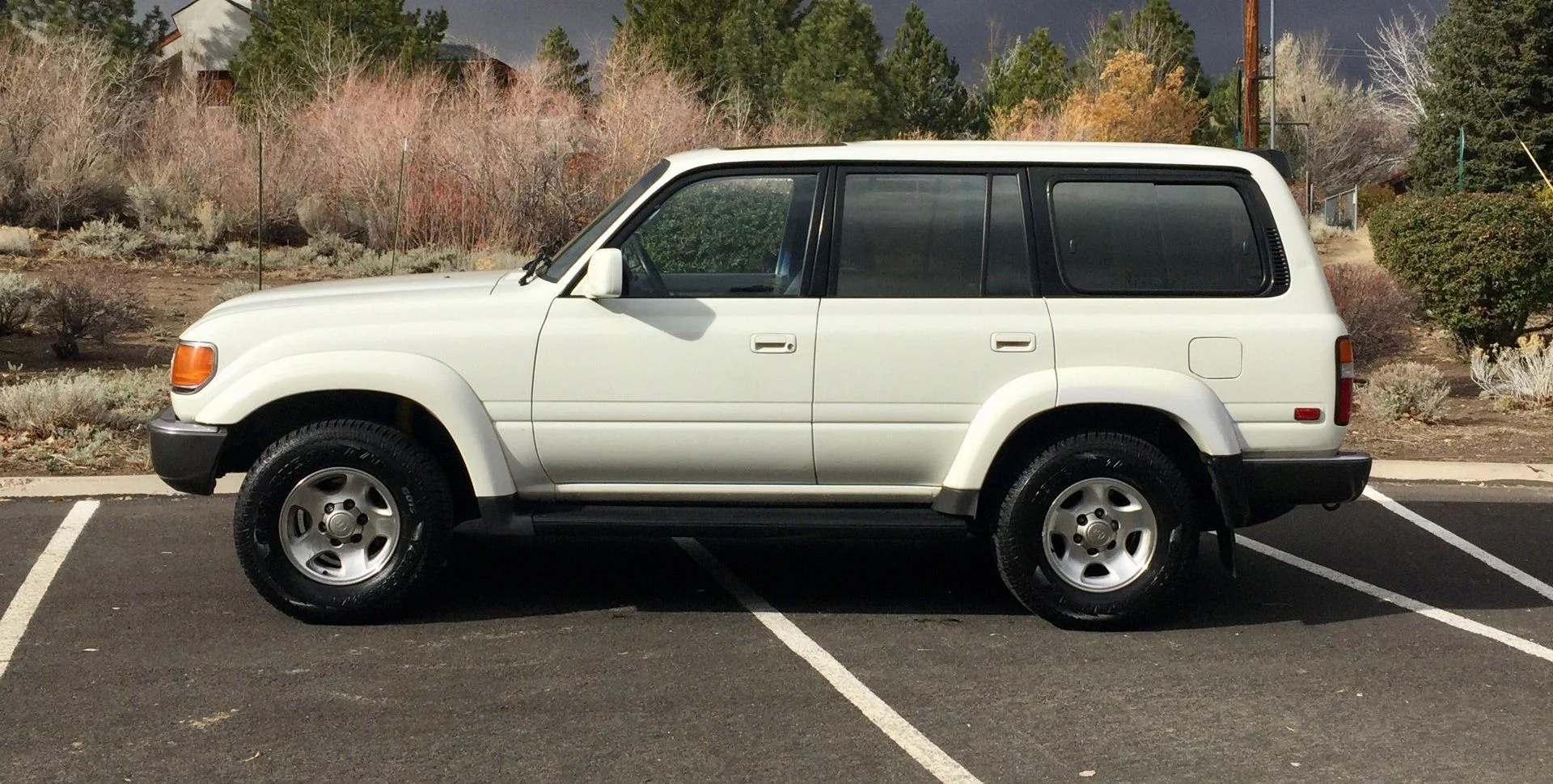

>>>I only have one true 'before' pic, taken the day I got it, and I failed to measure the pre-/post-install height, which was purely due to logistics and available time. But to my eye - and maybe the other pic helps confirm this (the one with the shiny tires) - it looks more level and an inch or so higher in the front.

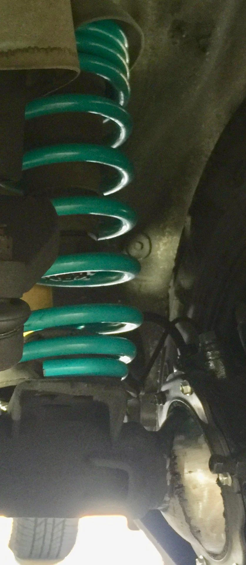

Any pictures of the coils ?
>>> This is the only shot I have right now. Hoping to take some additional detail shots in the near future. Will update this thread when I do that.

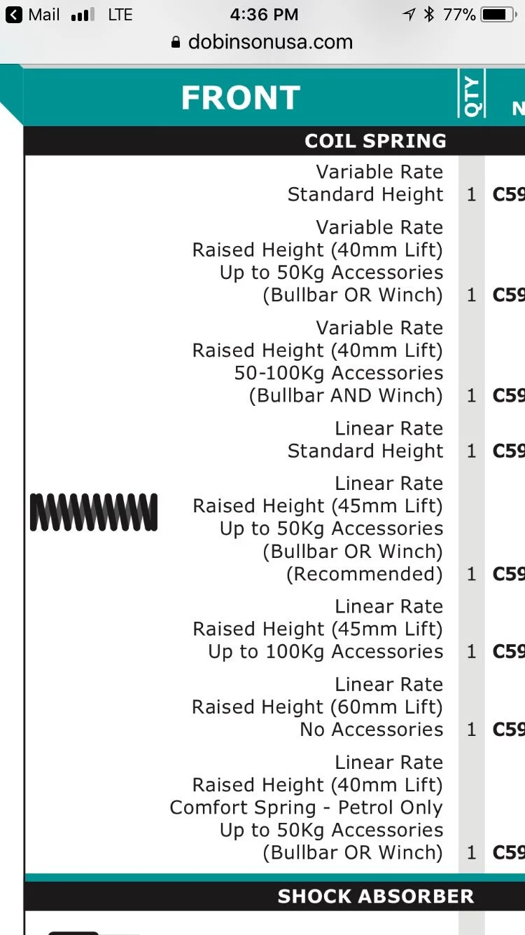

Sub'd. I'm liking this. My 1994 is the wife's and she didn't want a big lift but acknowledges that my 1997 with OME rides and handles better. This would be a nice option. I see it's only a 45mm lift.
Looking forward to more info as well...and FWIW I replaced my shocks with OEM Toyota shocks on my 1995 with about 225xxx miles, didn't do the spring but just shocks and even that was an absolutely amazing difference. So I can imagine new springs, stabilizer and shocks.
Where are you finding that its a 45mm lift ? I just poked through the catalogue and couldn't find the spring free heights, it just says stock height.
I interpreted This doc where it said Raised Height to be the lift. Maybe I read that wrong.
F%$# if I know, that's why I was asking. I have had nothing but good things to say about Dobinsons products so far, but their catalogue just doesn't do it for me. Thankfully they have some knowledgeable folks in @David Otero and @crikeymike . I just hate bothering them with all of my questions.

GWNugget posted up all our coil specs in his comprehensive coil post. But free height on a variable rate coil isn't very useful information due to the variable spring rate.

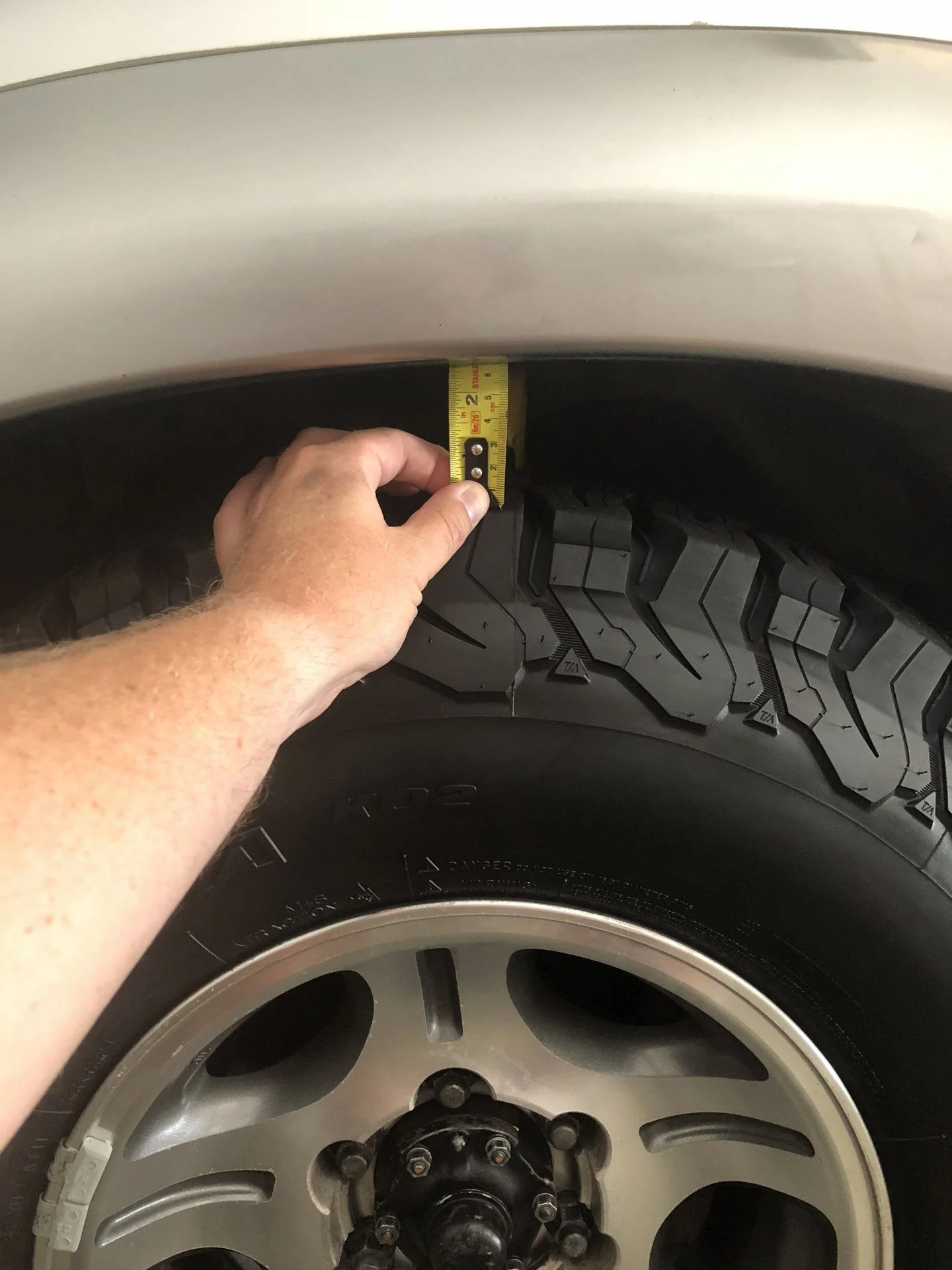

Can anybody comment on actual height after installing the 40/45 mm combo of Dobs coils? Want to land just over stock and after settling these coils should be right in there right?
My other option is stock height with spacers. I don’t want to mess with castor and seems like if you don’t raise it over 1.5” should be good.
