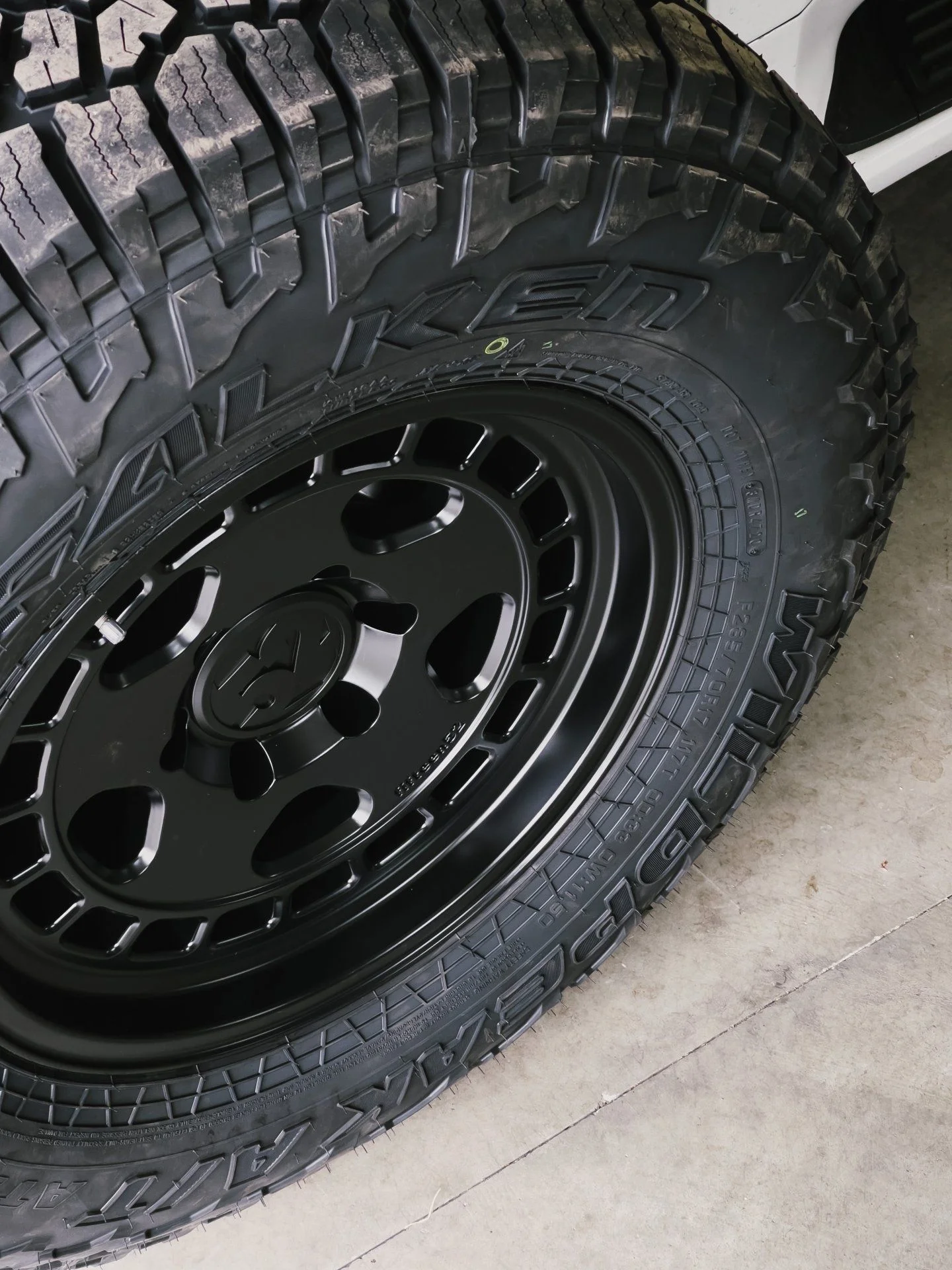

Finally got some parts coming in! Ironman is having a 25% off sale so I pulled the trigger on their Nitro Gas 2.5"F & 2" rear kit w/ UCA. Also got the Metal Tech (non poor) sliders and BMC kit, Prinsu rack and Fifteen52 Turbomac HDs 17x8.5.
I've read good reviews on Falken Wildpeak ATW3s so I'll probably go with them.

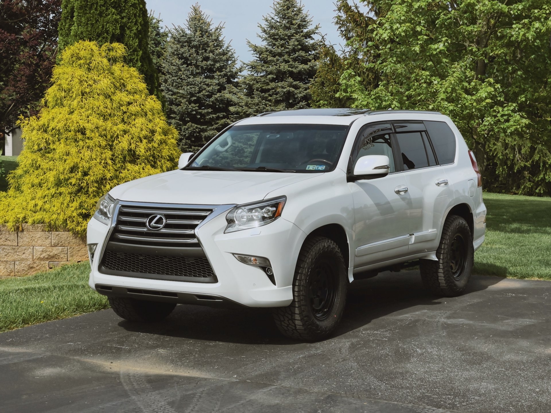

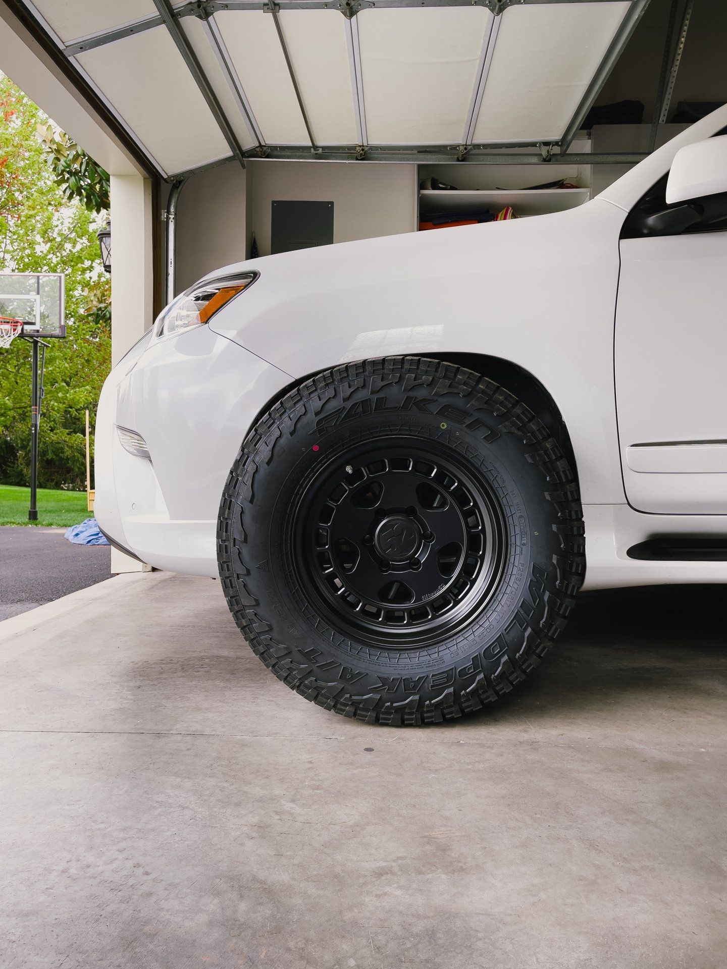

Thank you, they look great on the truck. I did a quick test for today and they make a huge difference from stock.
While I am rubbing on the stock sliders, I don’t seem to be close to the body mount. Does that mean I won’t need to chop it after I lift? Or will it depend on alignment?

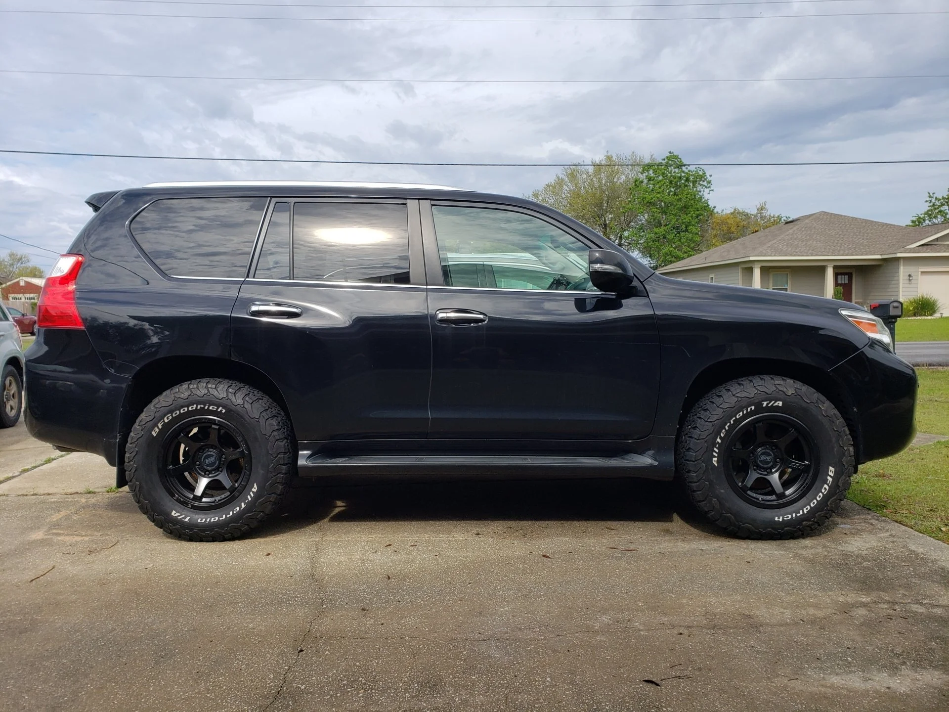

Did you look at full lock? I look to possibly hitting my body mount, and looks like I will after my lift. I'm getting my lift installed next week and having them do the BMC while they're in there just in case. Below is a pic at full-lock with my Relations Race Wheels RR2-S 17X8.5 -12 with 285/70 BFG K02s on stock suspension.

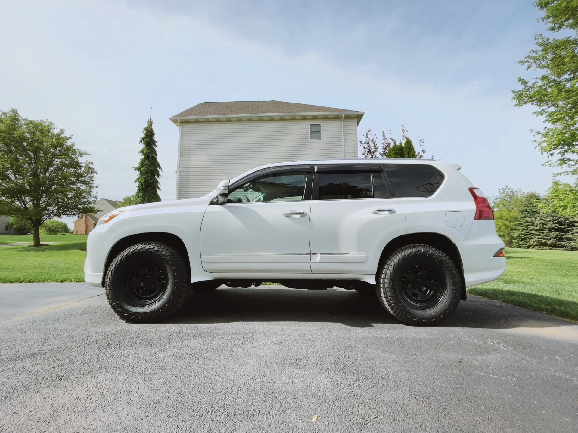

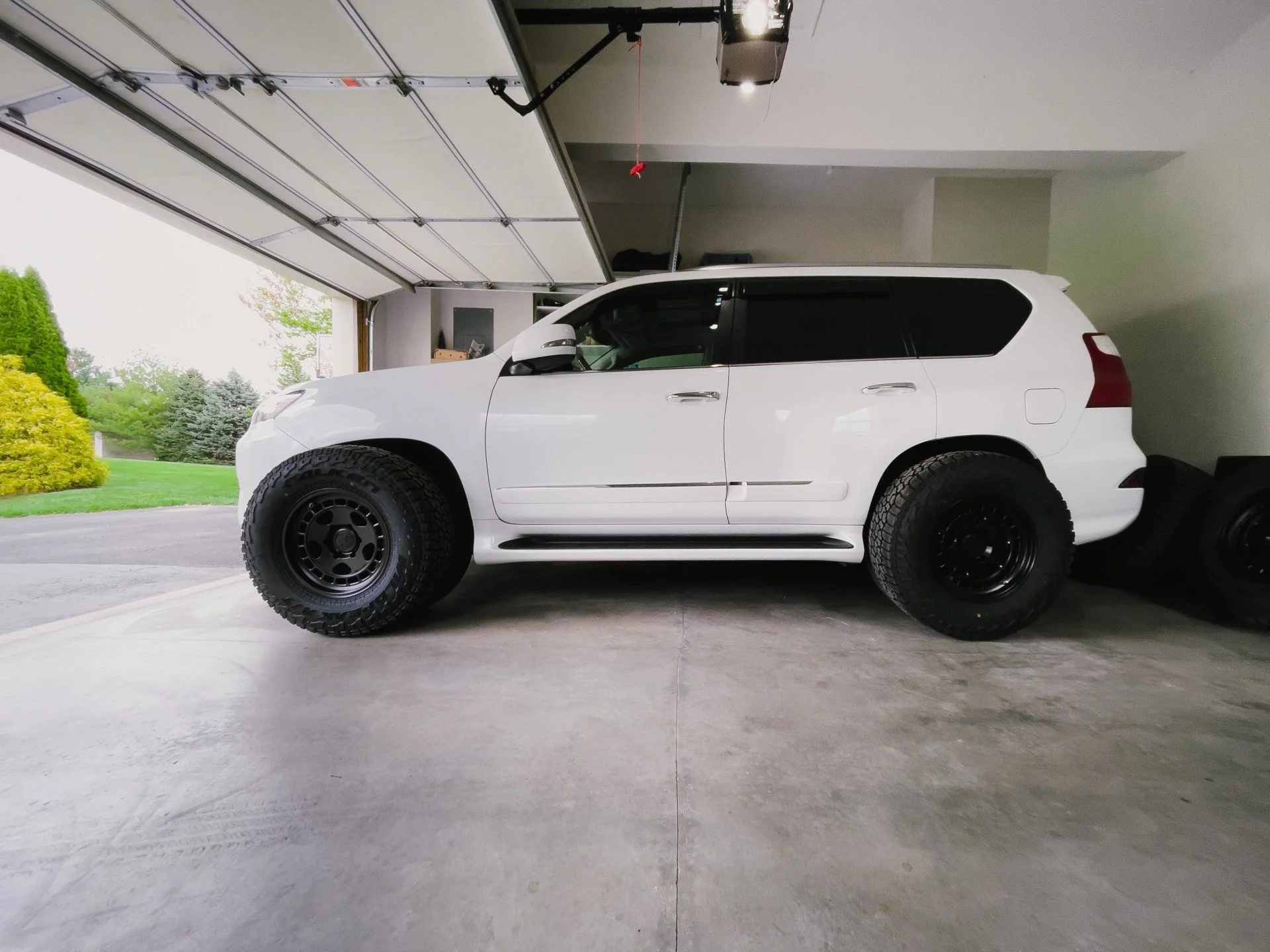

Happy to be running the new wheels on the stock suspension. Did some trimming and zip ties this week. Got the stock trim ready for the Metal Tech sliders to be mounted when they arrive later in May. I only rub backing up on the very front of the fender liner, which will likely be cut once I trim the front bumper. This won’t work off road, but will hold me over to daily it on the road.

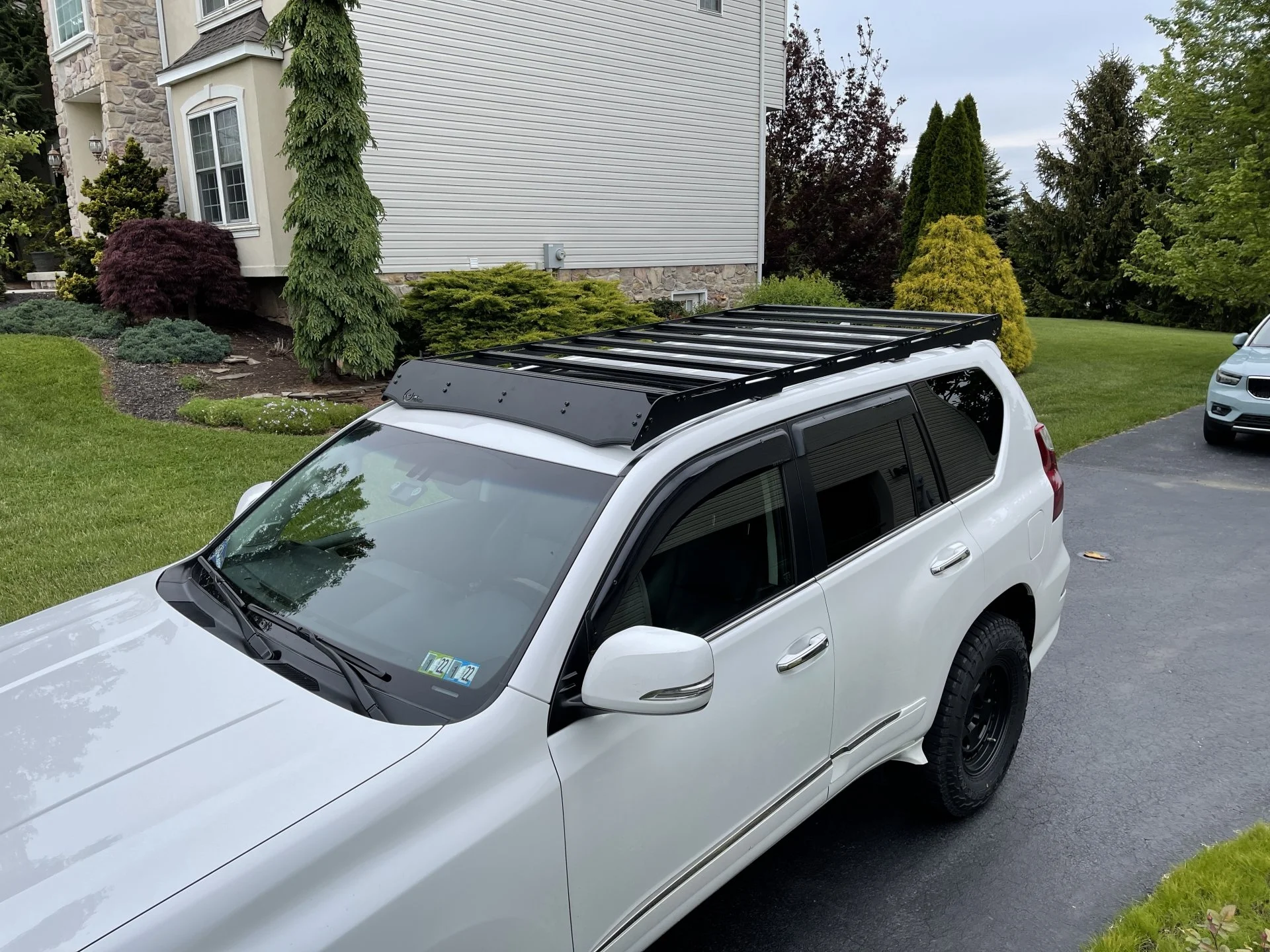

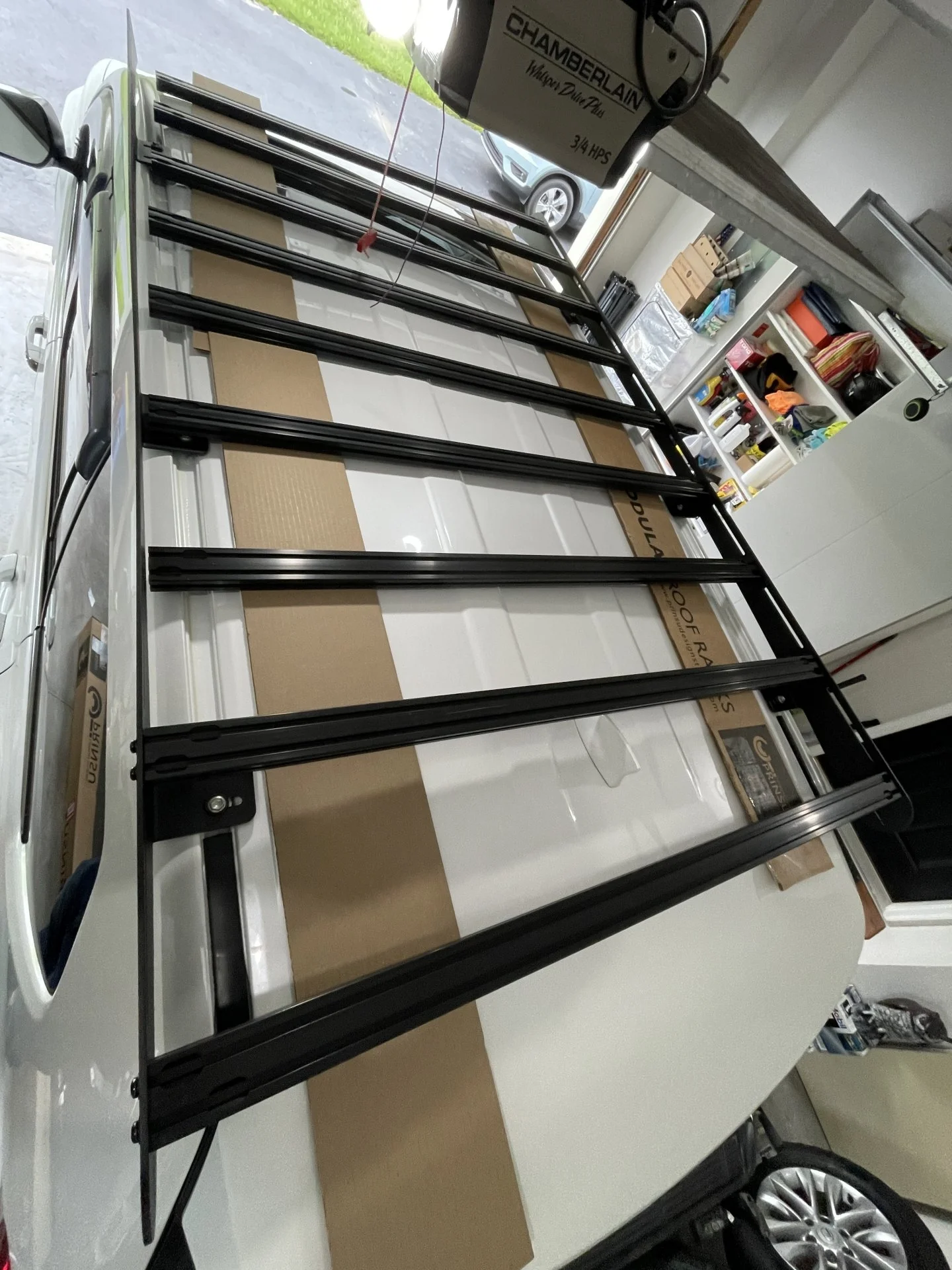

Next up is the Prinsu rack. Arrived today and hopefully I can install it this weekend.

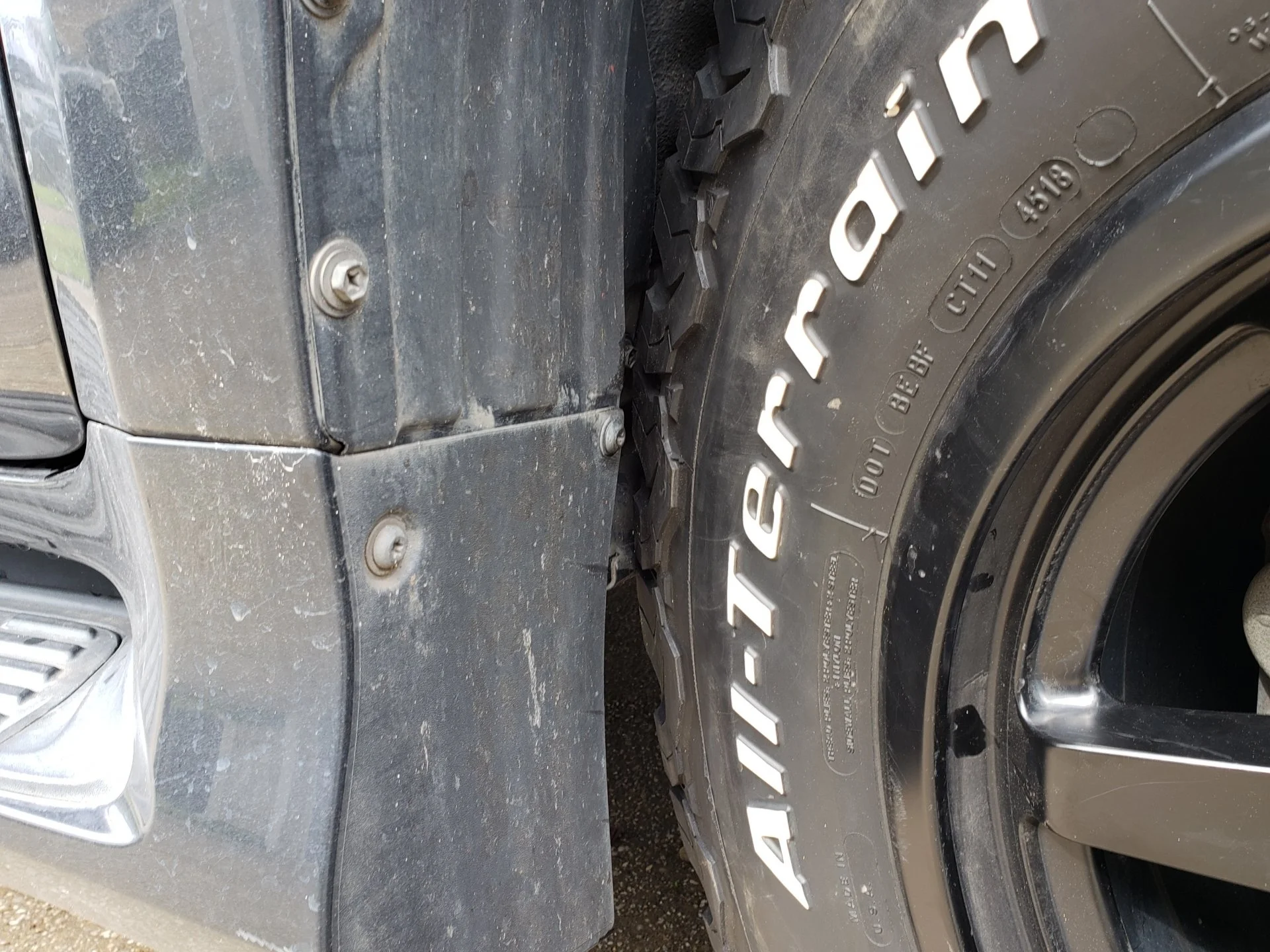

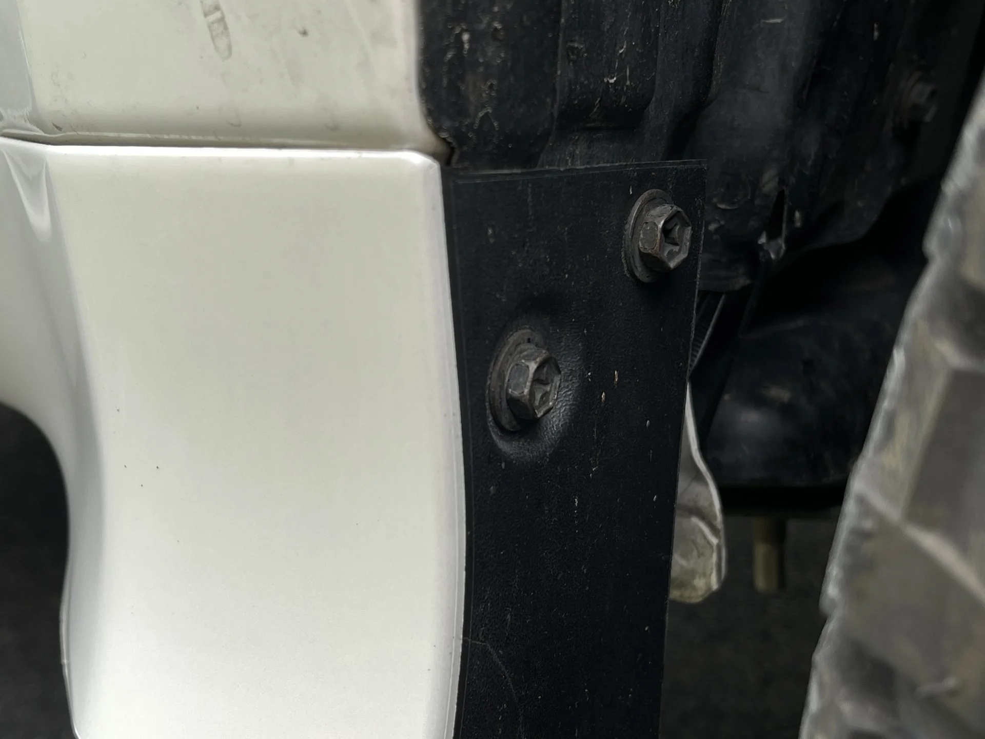

For those planning on doing the trim. I went at it with a Dremel tool with a small cutting wheel after mocking up the cut line. It worked well, specially for the sections where the trim is curved. For the straight cuts, a box cutter and patience worked better. Everything got sanded with a flat bottom manual sander to make it look clean.
Also, I moved the inner bolt in the front fender liner since I trimmed the mud guards a bit. Picture below.

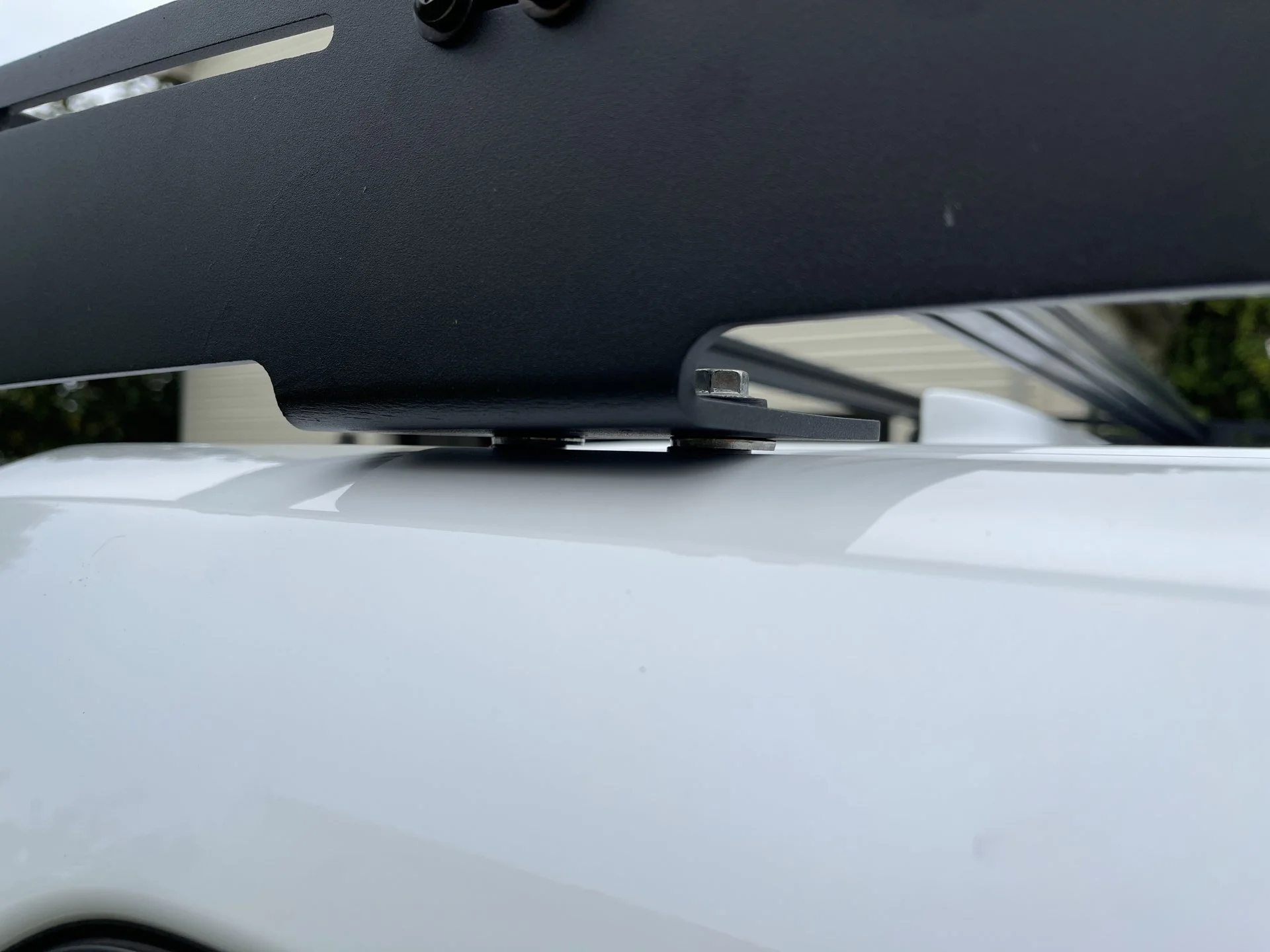

Mounting the Prinsu rack today. And find it kind of disappointing I have to add washers to space the rack up a few mm so it doesn’t rub on the paint. Not a huge deal, just figured the design of the spacers the rack comes with would account for the correct space. I read I’m not the only one with this issue also. Pics to come later.
Very nice!
