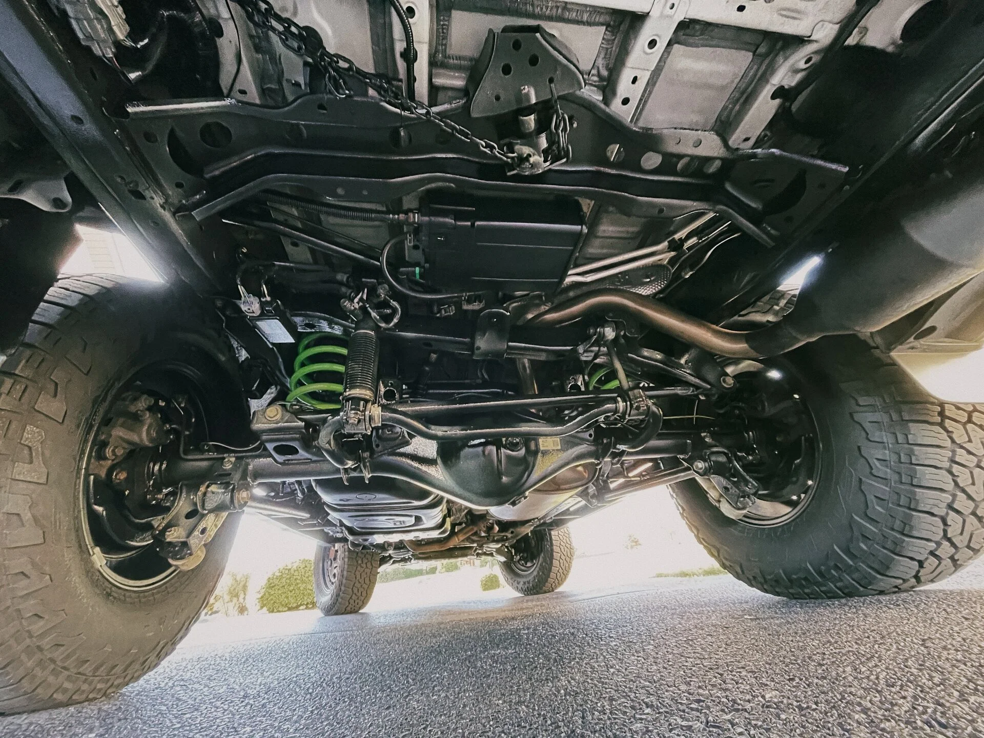

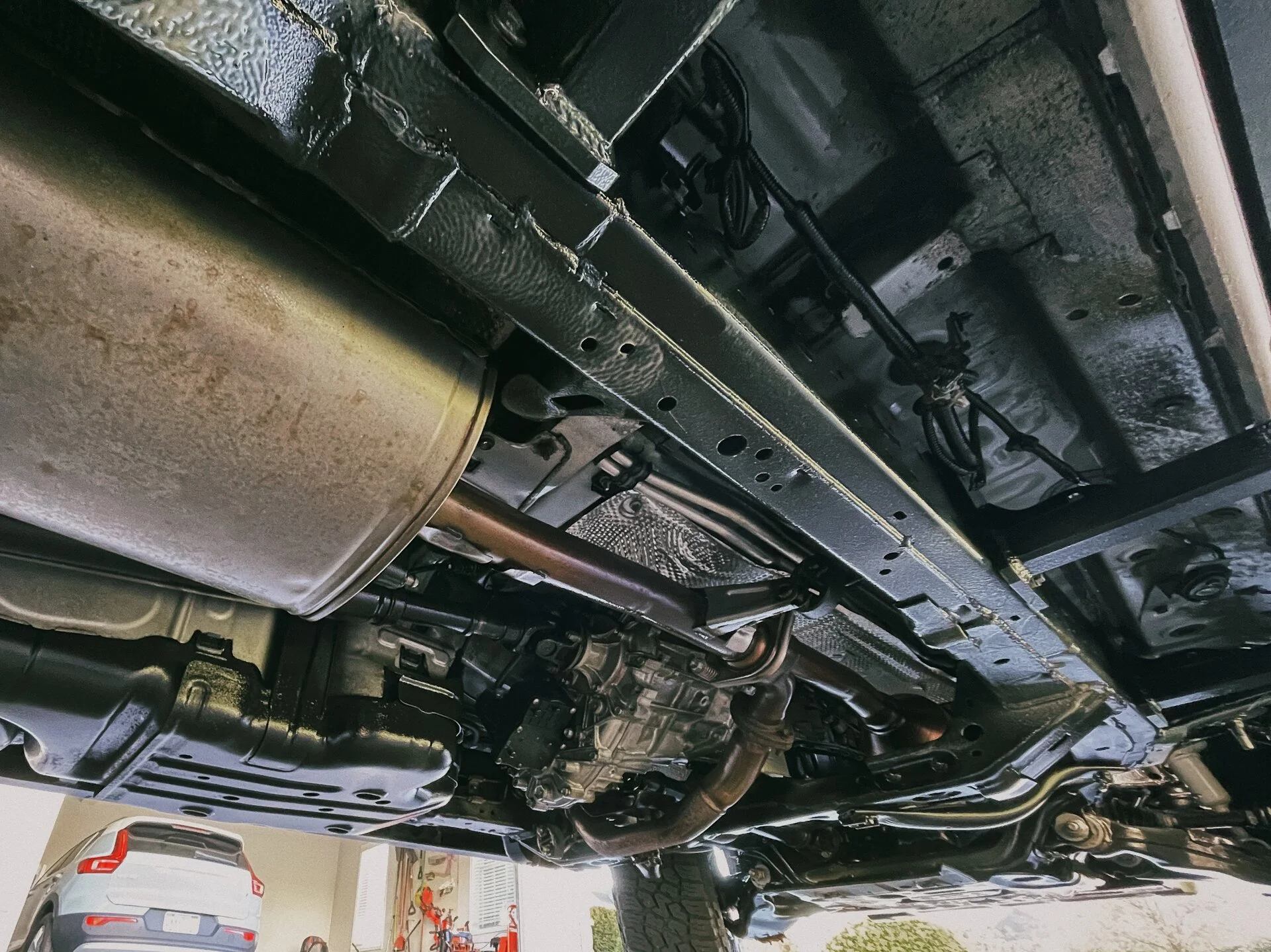

3rd year applying Fluid Film after getting the truck. Surface rust is minimal for living in PA.
I usually wash the underside with a 1:3 mix of Simple Green and a power washer. Then let it dry for a day and spray the film.I wish this stuff didn’t smell like dirty old rags 🤣
What's your technique for keeping the fluid film off of all the stuff like you exhaust, coils ,rubber bits, etc? This looks really nice.....I have a hard time not getting overspray everywhere making a mess
How are you spraying it?
I use an air compressor and their air gun and have pretty good control.
Also, you can spray it on everything technically. Whatever gets hot will just smoke for a little while, which is why I avoid it.
FF doesn't hurt any of that stuff. It evaporates off the exhaust pretty quick. I spray everything that is metal, though I don't try to hit the exhaust or brake rotors.
