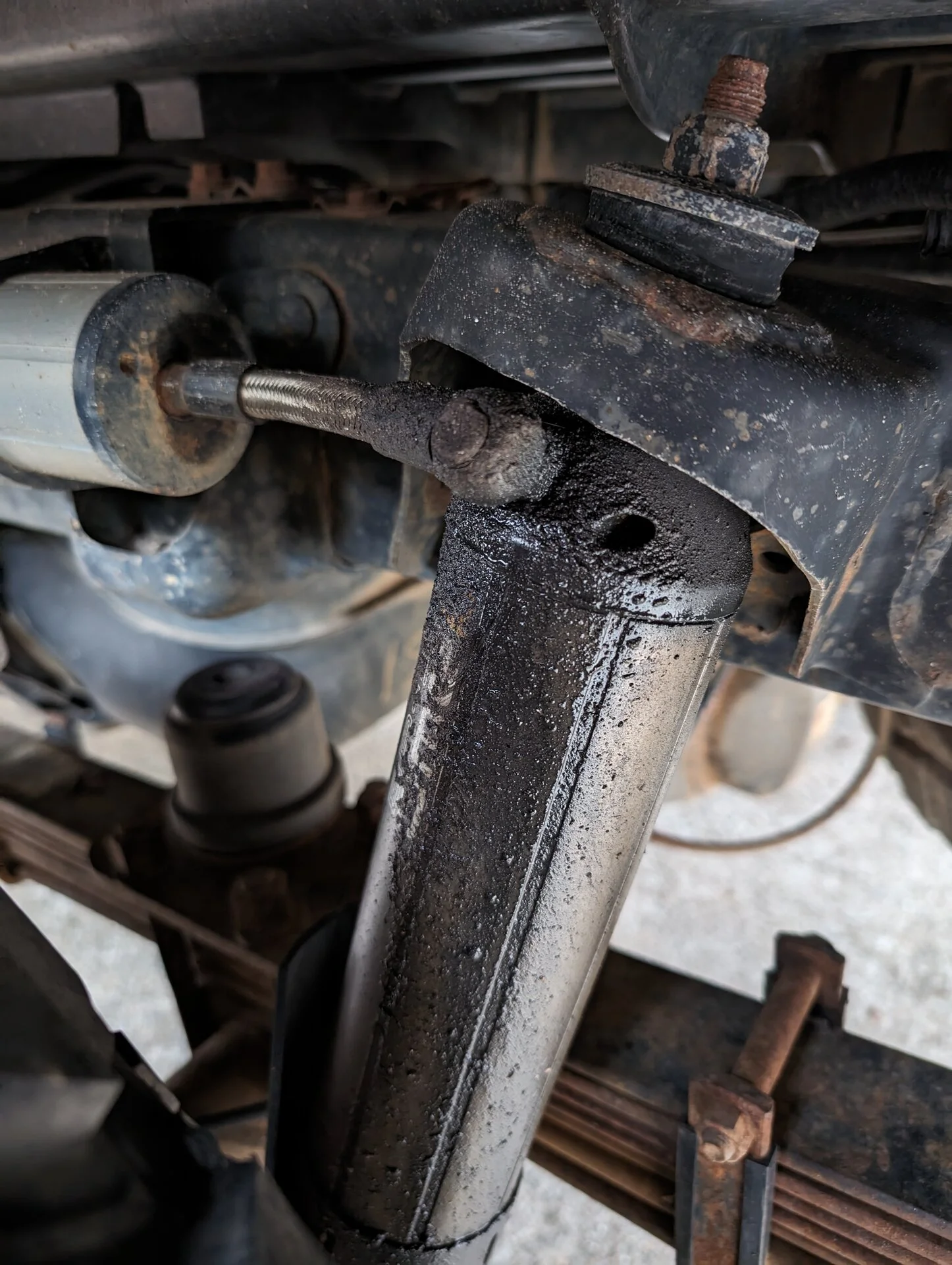

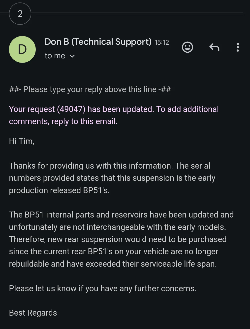

Well I guess this is the end of ARB/OME for me. According to arb tech support since my shocks are an early serial number and they have changed design they no longer carry parts for them and have determined them to be "end of servicable lifespan". Solution buy new BP-51, That will not be happening.
Time to move to a manufacturer that doesn't have such a closed service arrangement, doesn't require shipment across the country, and product that can be better maintained.
Original install date: 5/26/16 169k miles
Warranty replacement of leaking rear: 7/9/16 172k miles
Leaking & Beyond "end of service lifespan": 1/17/24 325k miles

Yes, both rears were warranty replaced because they leaked within 6months/15,000mi. The fronts have not been replaced but the bushings have worn out several times and I finally made correctly sized spacers in the same material all other shock makers use. I had thought about sending in my shocks for service (before they were leaking) but did not have another suspension to run in the mean time(2+ weeks it sounds like). Unfortunately now I don't even have that option, and obviously was never made aware of the design change by ARB that made early production models obsolete.
