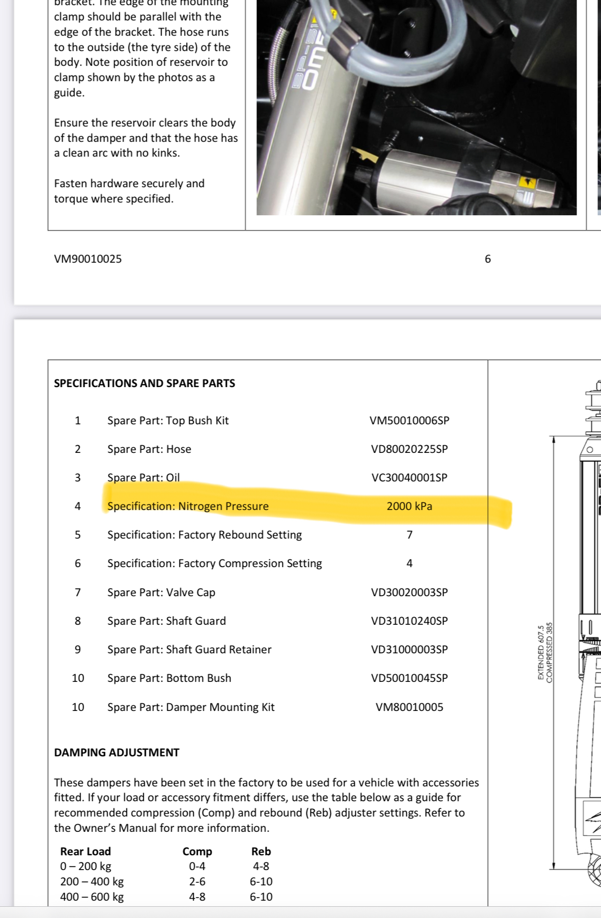

So ... What pressure do you set them to? Should I call ARB and ask them?

Yeah I’d talk to ARB, we can’t assume the pressures I used in my kings apply here. I’d also make sure messing with pressures doesn’t somehow impact a warranty if you still have one. Based on how they “supported” others for their inspection and rebuild I wouldn’t put it past them.

Spec is 2000 kPa, call it 290 psi.
Thats some high pressure
