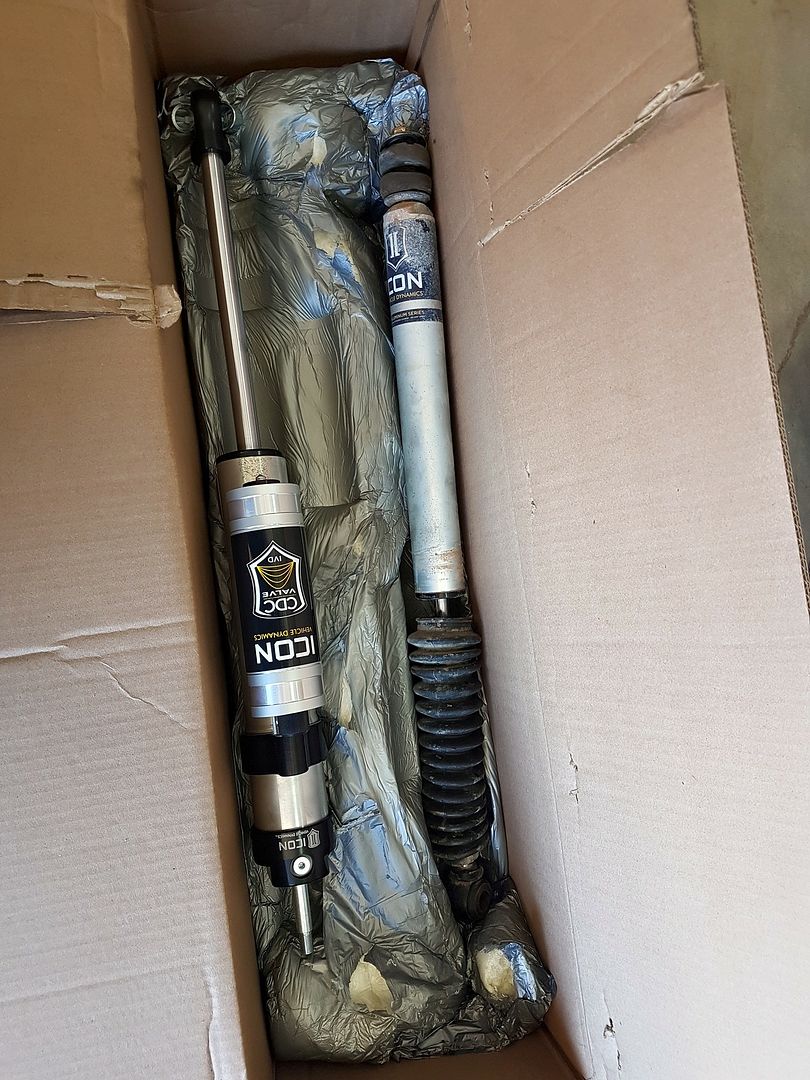

Well I've got almost 1500 miles (more than half of that on dirt) with the new Stage 4 Icon shocks for the Slinky suspension. I'll be writing another article for TCT magazine on these as a followup to the article I wrote last year reviewing the Stage 1 kit. It's been nice to get a real world comparison on these.
The short summary is that while I've been really happy with the Stage 1's for the past year, the Stage 4's will not disappoint and are worth every bit of extra cost, especially if your truck is on the heavy side with big bumpers and lots of gear on it regularly.

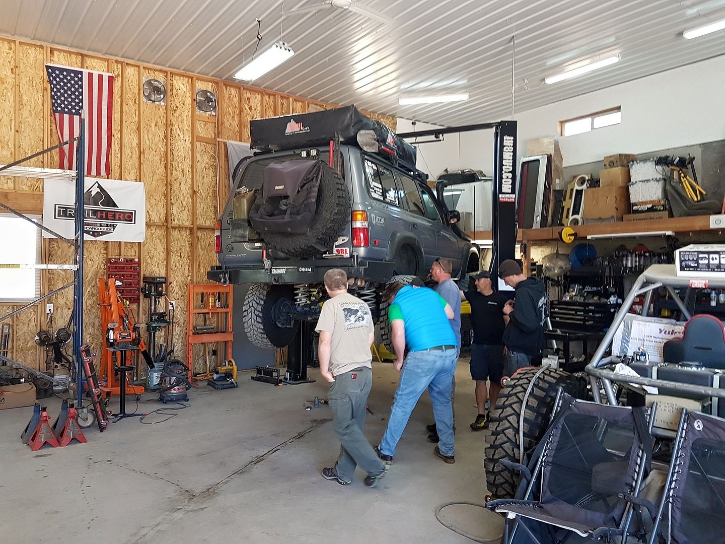

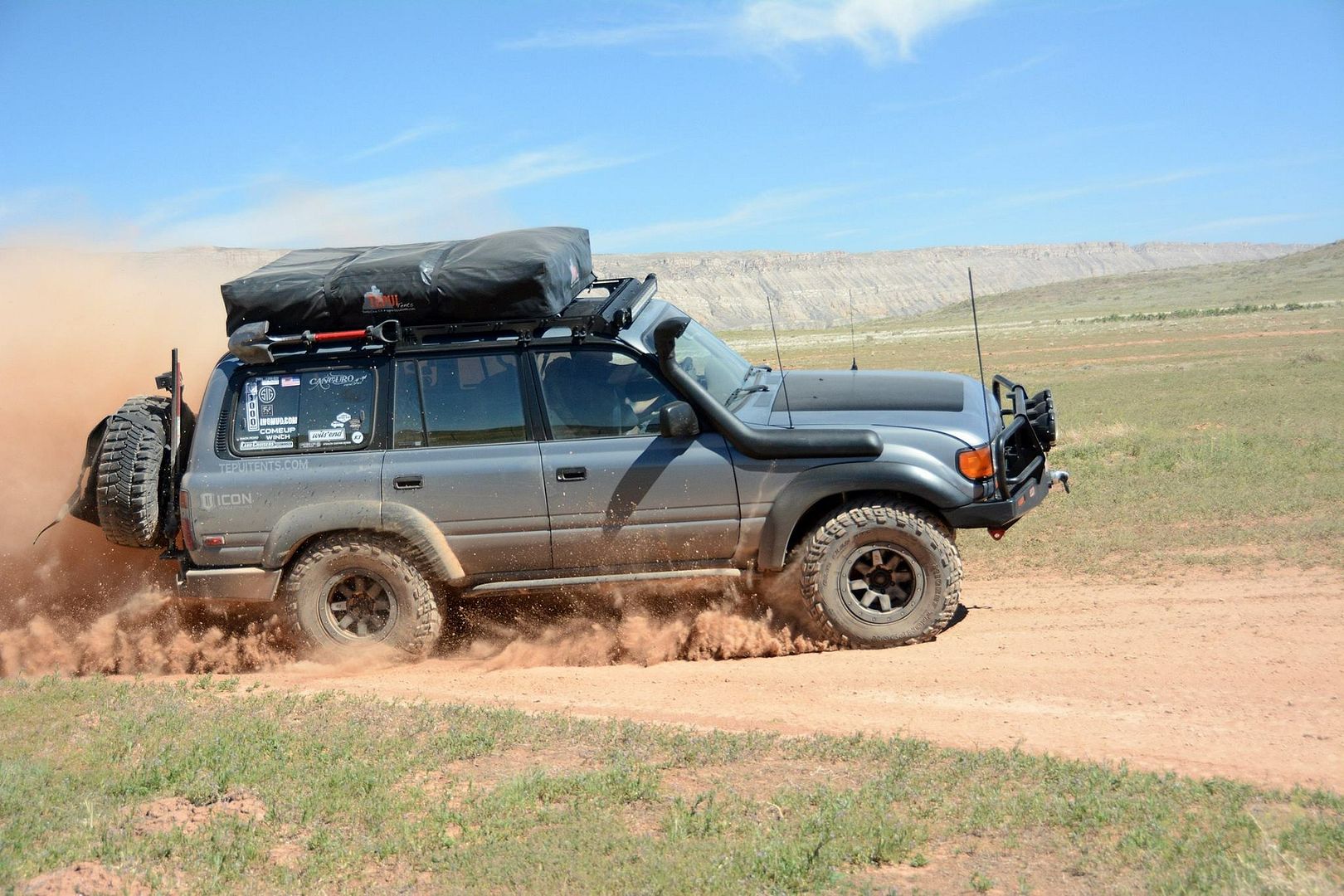

We did almost 600 miles of offroad testing of the Slinky Kits through southern Utah and Arizona in the days leading up to Cruise Moab. Most trucks in the group had Slinky kits and few did not. There was obvious differences between the ones that had Slinky kits and those that didn't. The most noticeable difference was the non-slinky suspensions experienced pretty dramatic shock fade and dampening almost disappeared and those trucks became really bouncy. The Stage 4's have zero shock fade with the large bodies and remote reservoirs. For me, the CDC control was HUGE. Being able to stiffen up the suspension allowed me to drive the truck more aggressively with it fully loaded and a RTT on top than I would have ever been comfortable doing with a completely unloaded truck without a tent on the top. I'll post a report and pics from the trip later.
We were able to use the IH8MUD HQ shop to swap the shocks before the trip started. Made it much nicer than swapping them in a parking lot.
The resi mounts for the front are slick, way better than anything else i have seen.
