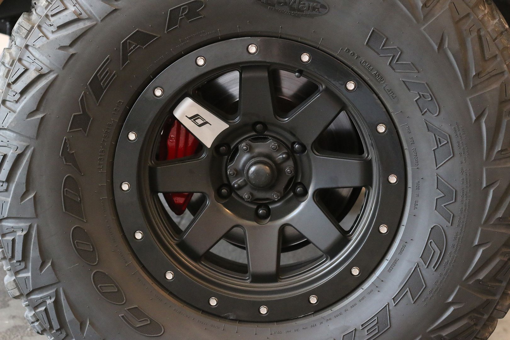

Not much to report but I'm doing a bit of brake work lately. I anticipate trying to increase braking performance some in the next month or so. Since the suspension swap I'm able to travel much faster on the trails and the brakes are heating up and fading quicker than they used to. I have a couple good recommendations for pad upgrades I'm looking at.
But I spent some time making sure my calipers and brake lines were in top shape. The calipers were working well but were quite rusty. So I did a bit of cleanup and a fresh coat of caliper paint. :) Now just need to get some better pads.
