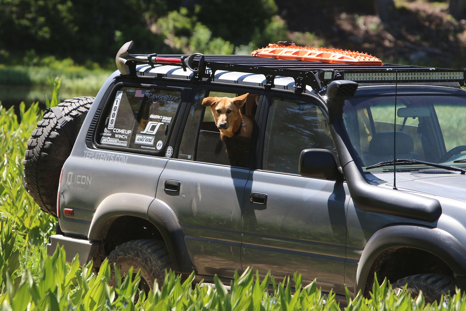

I finished up the TMS snorkel install last night. Overall pretty smooth. The supplied template wasn't quite accurate. The two holes closest to the windshield were not in the correct place but that was about all I needed to change. After drilling the holes, I removed the fender to make it easier to tighten all the bolts and remove the factory intake plumbing. The quality of the snorkel is really quite good, in fact excellent considering the price. For a $40 Snorkel it is great. Comparing it to the Safari snorkels I've used in the past, the obvious difference is the lack of the embossed Safari logo on the main body. Fitment is and construction is good although it may not be quite as precise where the snorkel follows the contours of the fender at the front, but I'm getting quite nit-picky. Material seems to be the same plastics. Time will tell if this one has problems with UV exposure and fading or cracking, but I doubt it. So with the exception of needing to do some double-checking of measurements I'm very please with the purchase.

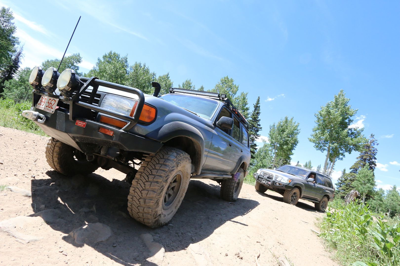

Hey box rocket can you tell us the secret behind how you mounted your antenna on the right lower side. I have the same bumper and I don't like the stock position of antenna they have on arb it blocks your view. Thanks
Sure. It is a widely kept secret of drilling a hole in the top of the bumper near the corner. :)
Oh cool, I don't think I want to drill my $1k bumper yet, maybe when it gets a little old not saying that yours is old. Thanks for the response

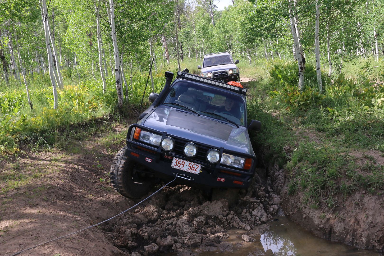

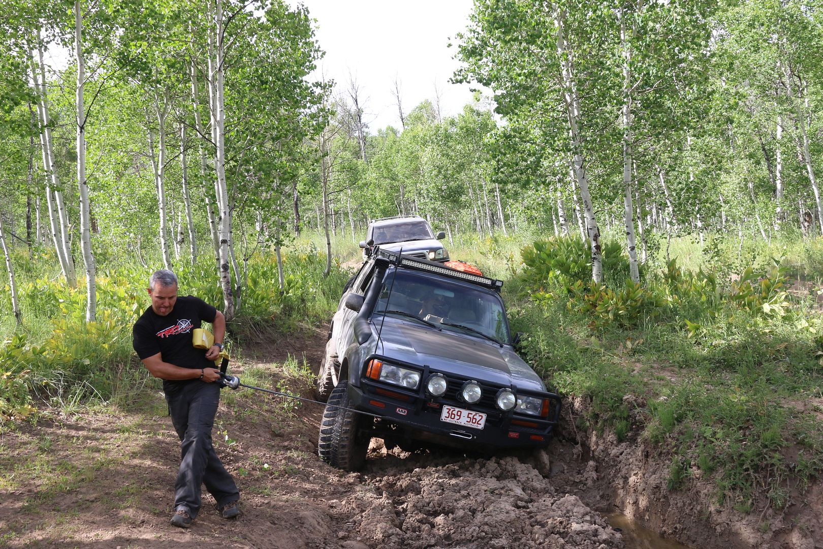

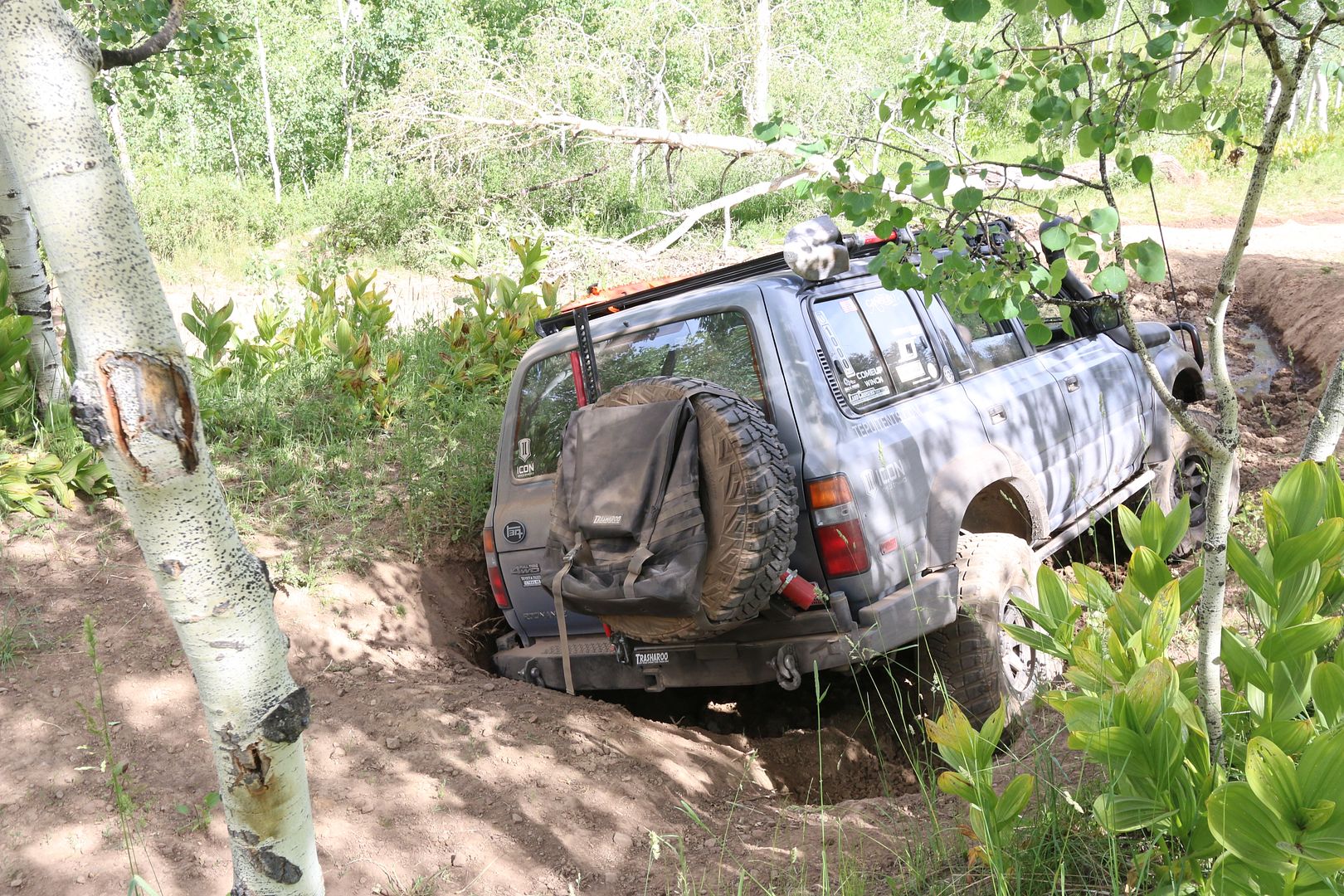

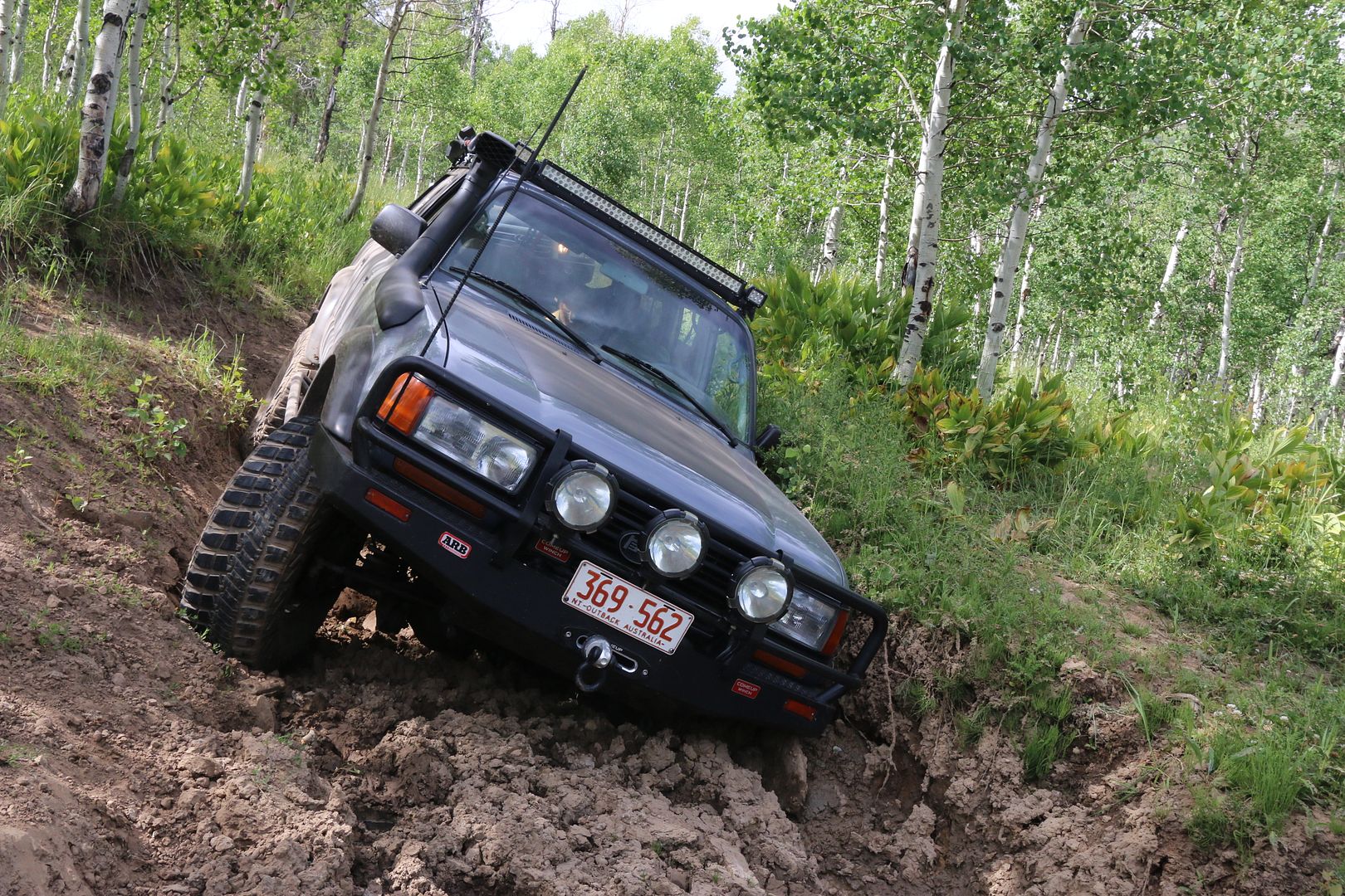

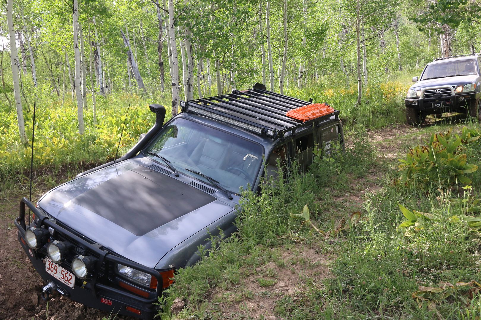

near the end of the route I dropped the 80 into a hole that turned out to be deeper and softer than it appeared and swallowed the driverside. The drop in was a vertical ledge about 3' high and the rear bumper was hung up. Between the rear bumper being hung up (keeping the rear tire from touching the ground) and the slippery clay in the hole, I wasn't able to drive out immediately. So a used the COMEUP winch to pull the truck about 12" to free the rear bumper and then was able to drive out on my own. Fun little challenge.
