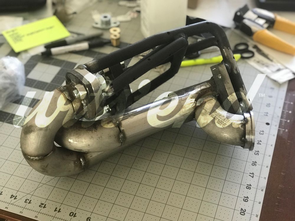

Ok boys, a little bit of dirty pipe porn. More of a teaser of what is around the corner.
This is the jig and the prototype that was rigged up for flange and tube placement, nothing else. There is another jig made that holds the pre-bent tubes in place before welding. I'll get a photo of that as well. If this project was one-off, my life would be so much easier. But repeatability and consistency is paramount on something like this. I'm showing this now because I wanted to show you guys the progression of just this one piece of the puzzle and how it looked before and what it will look like as a finished piece. The manufacturer had some advice for me but I'm not going to act on it/discuss it here until AFTER I see what the finished production pieces will look like.
At the end of the day this is just a Wits' End 1FZ-FTE J-Pipe. Just two flanges, going to a pair of J-pipes into one collector with a T-4 flange and a WasteGate flange. For as complicated as this has been, its really all it is. There are no other ports on this, those will be on the intake and downpipe.
Enjoy!
