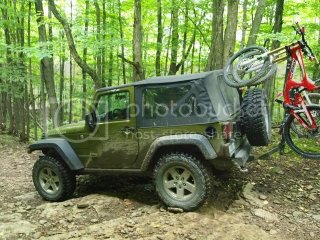

Anyway, when i finish my swing outs (hahaha been saying that for awhile), I want to build a vertical one similar to:
Luke & 4x4labs has a vertical one for his swing outs.
I've had no issues with the bike sticking out further than your review mirror. You can always pop a wheel off too.
