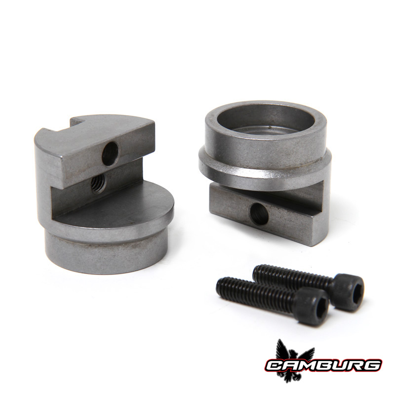

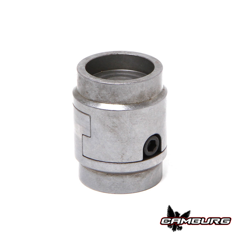

This is what I'd use if I wanted a removable piece:
Camburg Billet Tube clamps
I like that idea, the only thing is that my understanding of the tube is that is actually loads up when the frame twists, the clamp wouldn't work under that situation, someone clarify because if I'm wrong that is a great idea.
The couplers are designed so they are stronger than the tube they're connecting. They'll work.
