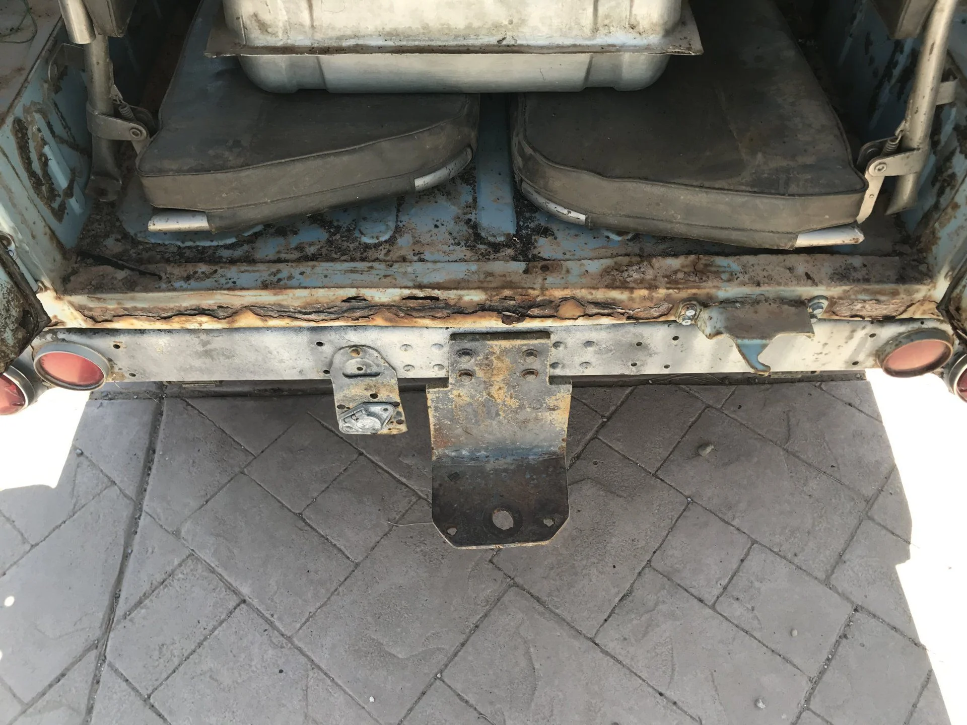

Rear Sill: Rust has eaten through a few layers of metal, but not all the way through. It also hasn’t wrapped around to the rear quarters yet.

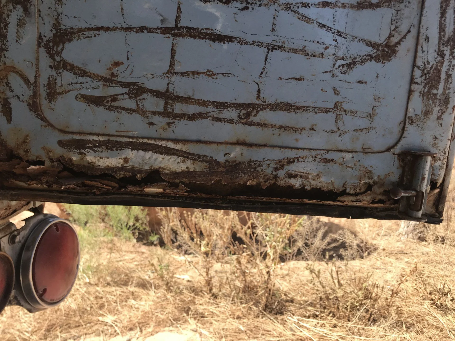

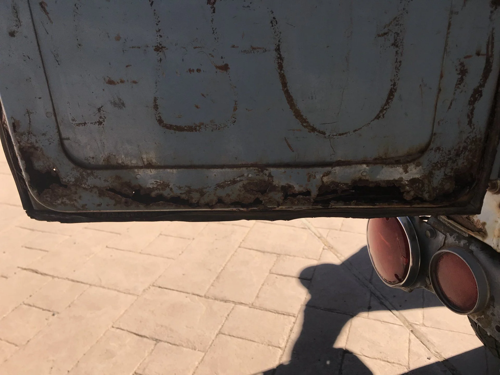

Barn Doors: The bottom edge of the Doors have been rusted through from the inside.

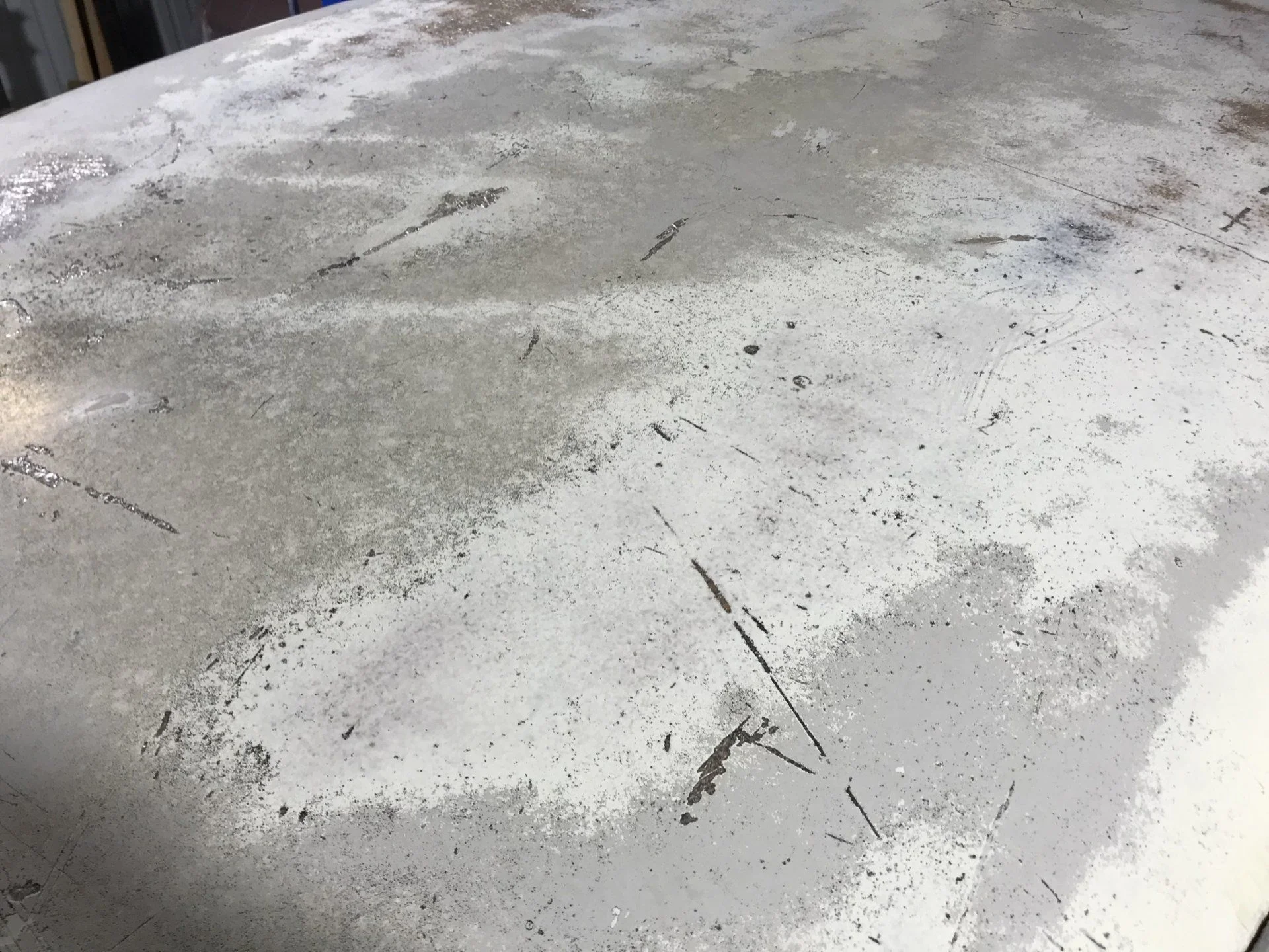

Fiberglass Top: Several surface cracks and a few pin sized holes. Fiberglass fibers are exposed through the paint in some areas.

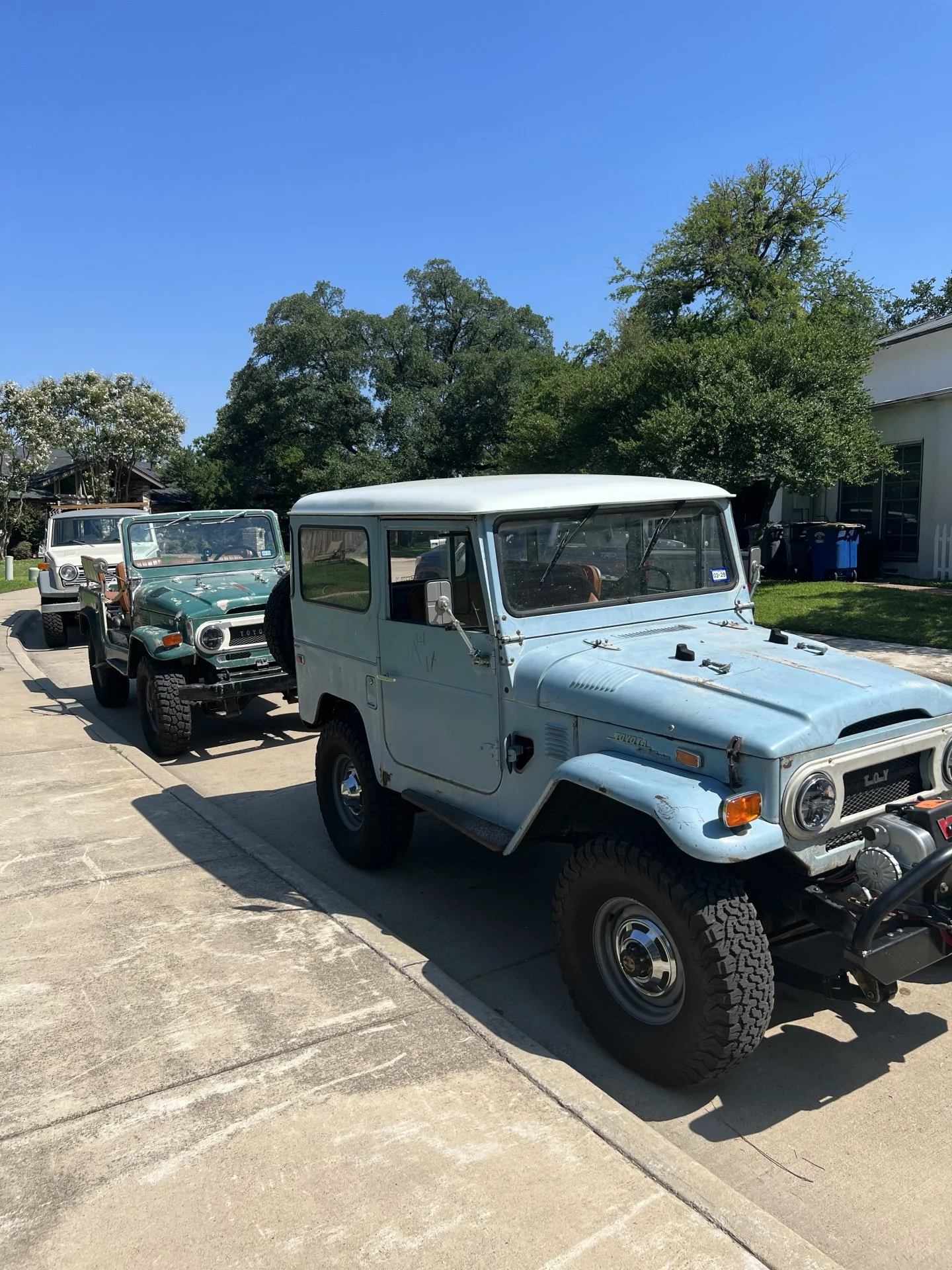

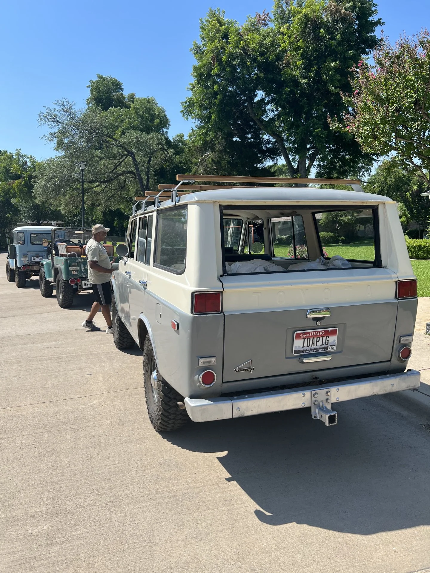

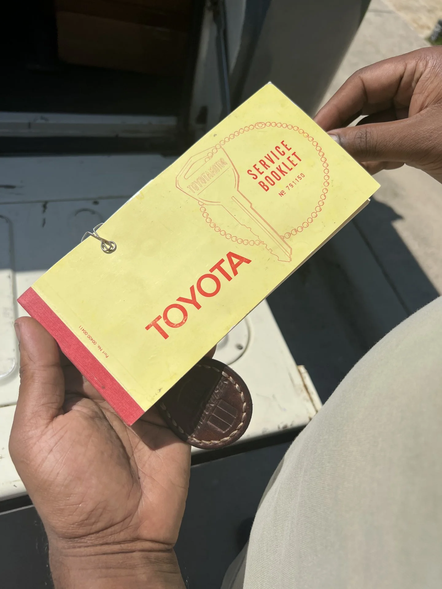

Took Hades and Bluebonnet down to @banieldowen ’s place to check out his latest 55 purchase. 65k documented original miles. All maintenance recorded down to oil changes and tire rotations. Even had the original service booklet with the original owner’s vehicle identification card and warranty. Primo to say the least.

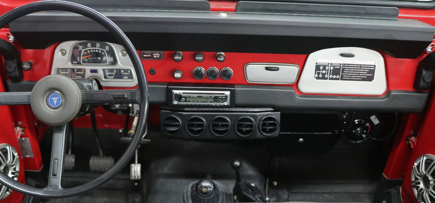

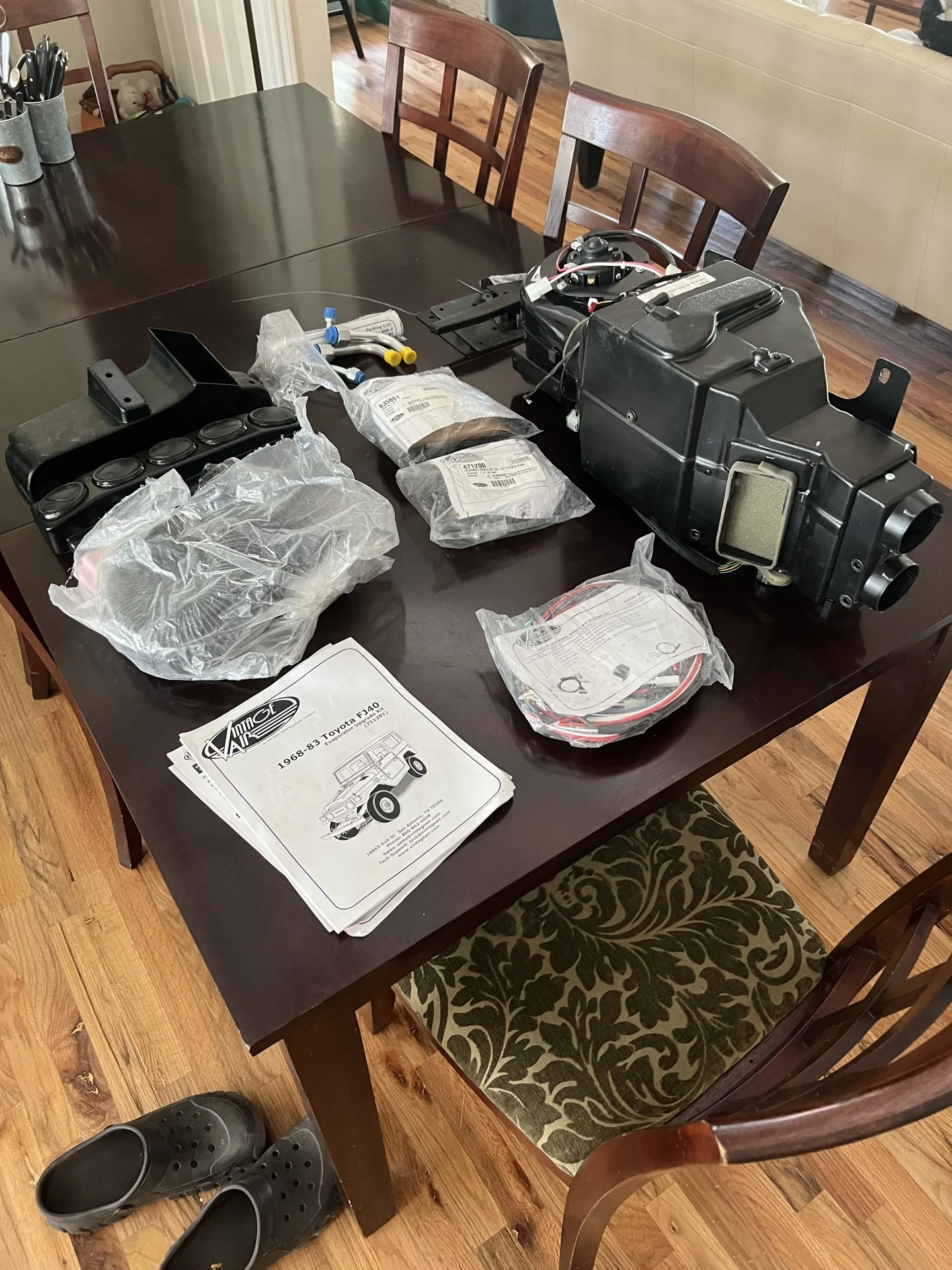

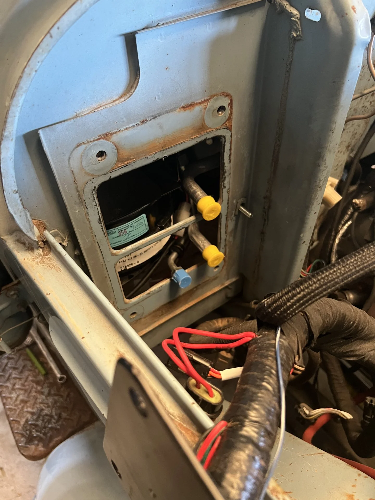

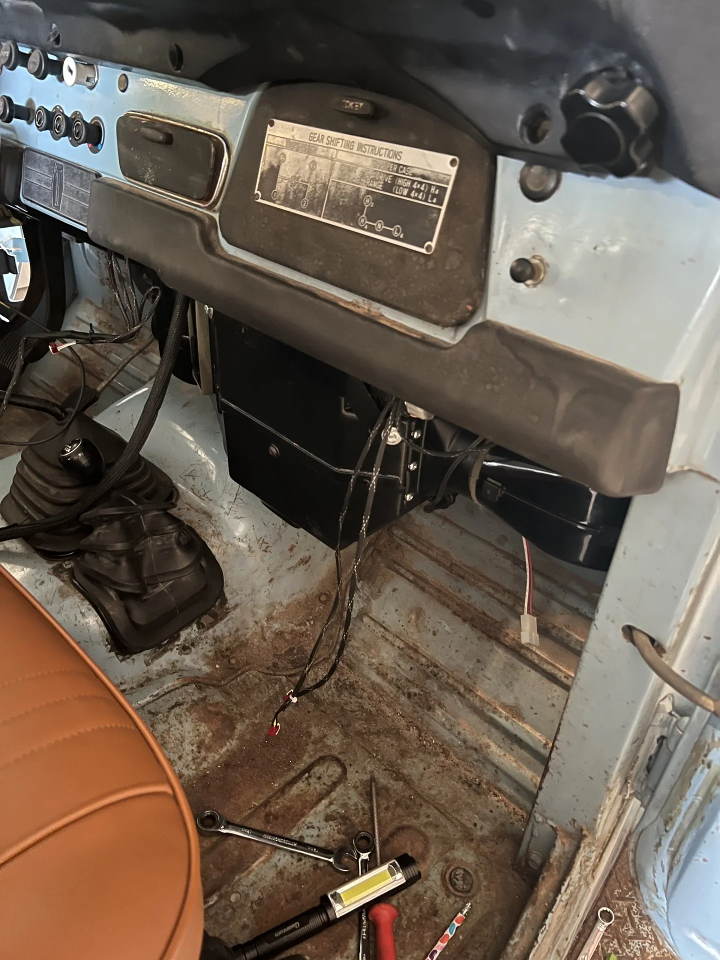

Have been driving Bluebonnet in the TX heat all summer. With outside temps getting up to 105 recently, ac became a top priority. Was told VA orders are backed up for 14 weeks. Luckily I was able to snag a gen IV high flow kit that @cwags12 had laying around. Thanks Clint! :)

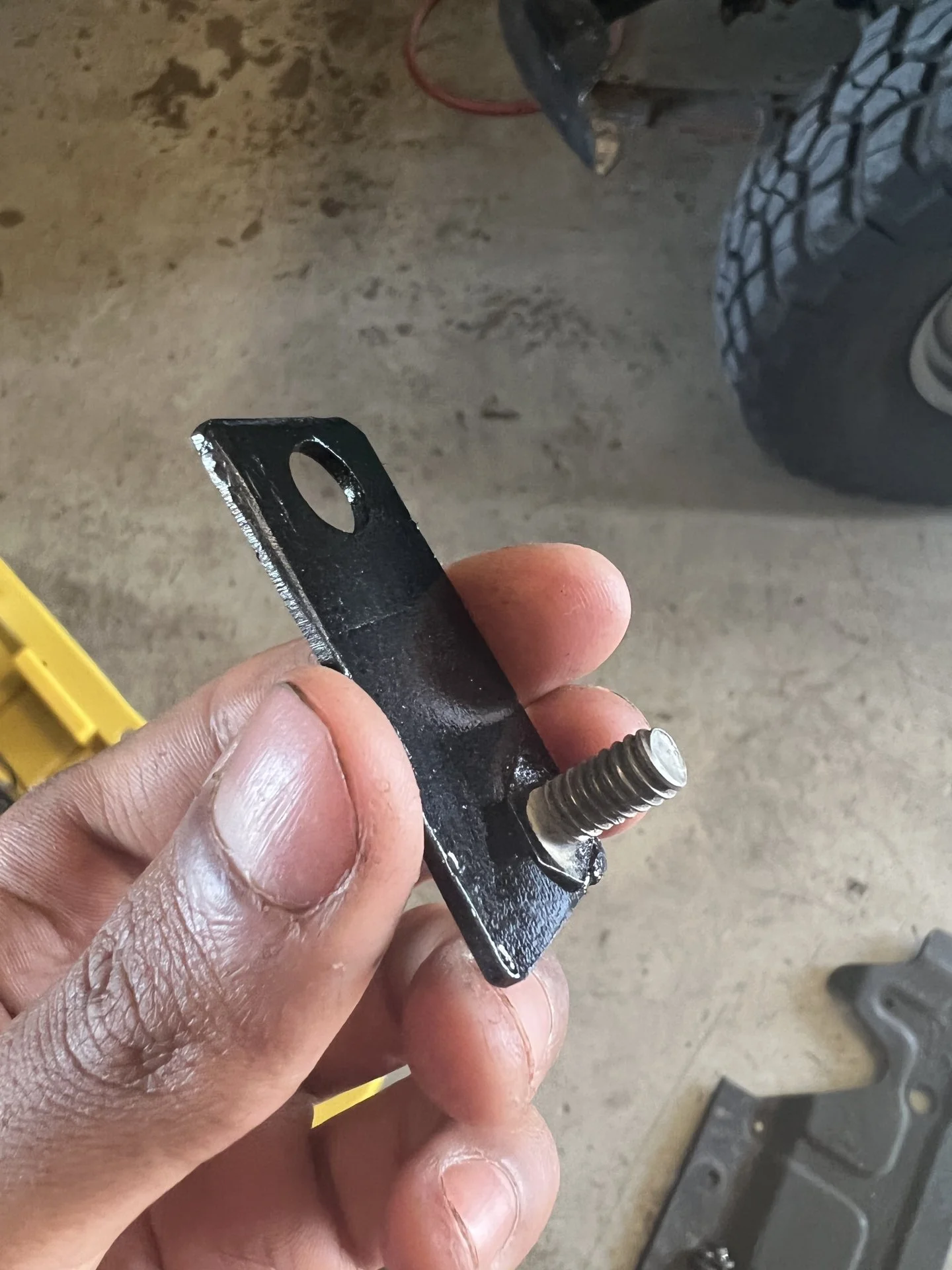

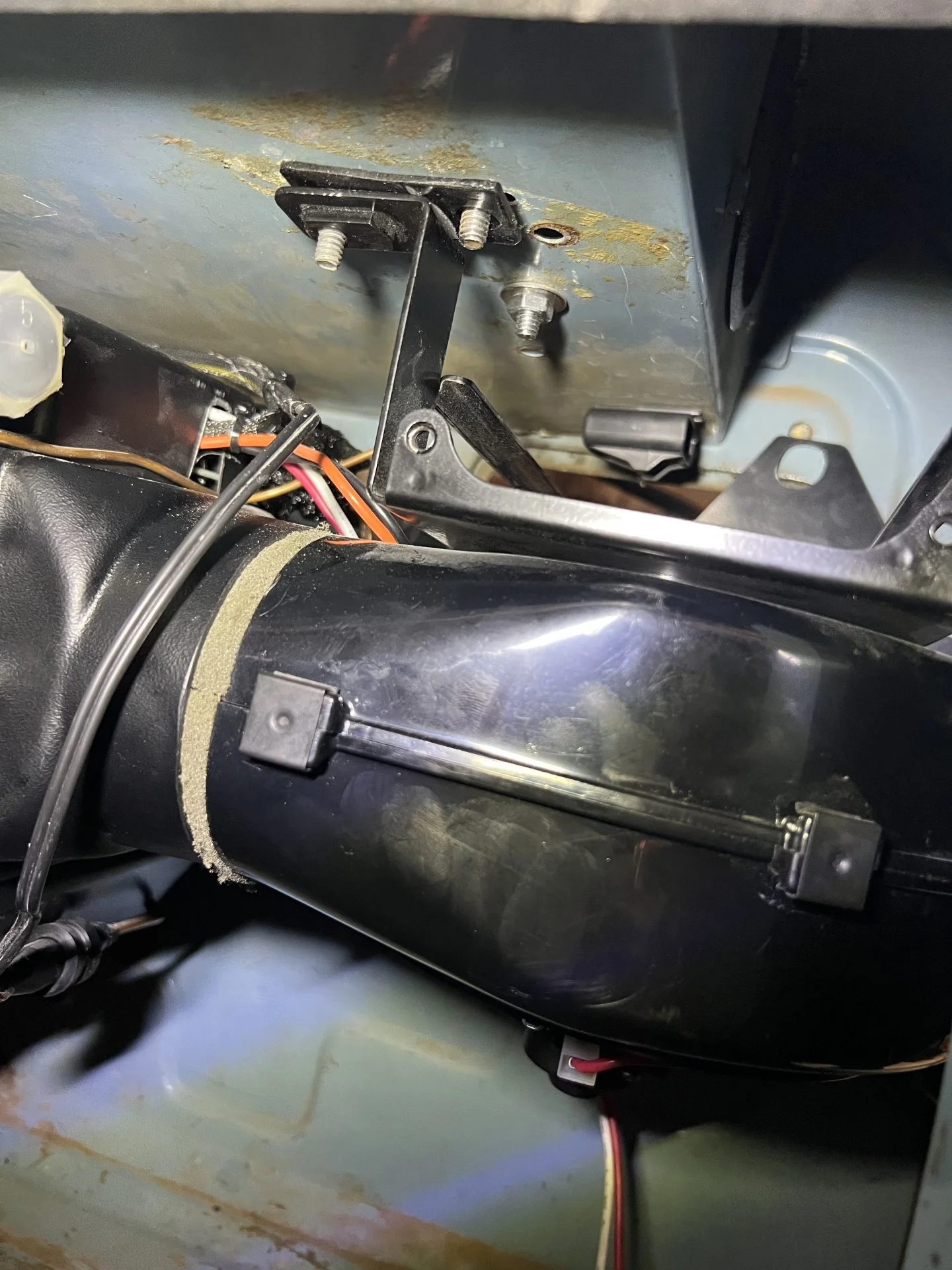

Got the unit mocked up in the cab. Not sure why people think these interfere with leg room on the ps, plenty of clearance. Shifter clears the vents by 2 inches or so. One of the mounts near the glovebox interfered with my ecu so I had to fab up a bracket to mount it to an existing ecu mounting hole.

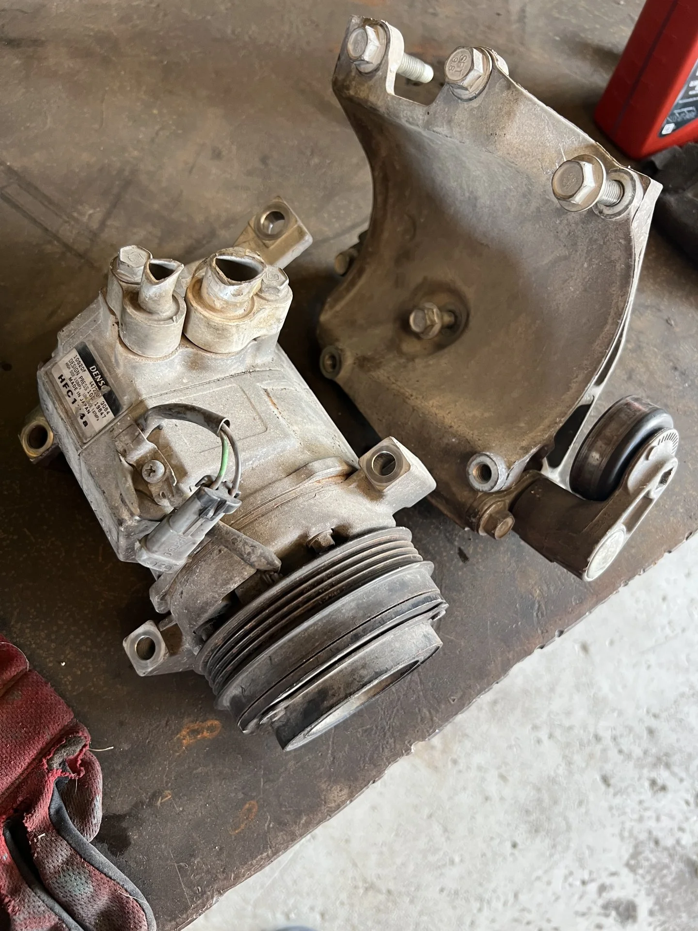

Pulled my ac compressor, had to pull the mounting bracket too because it’s tight near the ps of the frame. I plan to run my lines using the stock denso compressor. That way I should be able to pick up a 4 seasons compressor from any Autozone or Oriley’s in the event it fails.
View attachment 3045987View attachment 3045986View attachment 3045989View attachment 3045988
The older fan sticks down a lot. Not a huge deal but more obtrusive than your High Flow.
