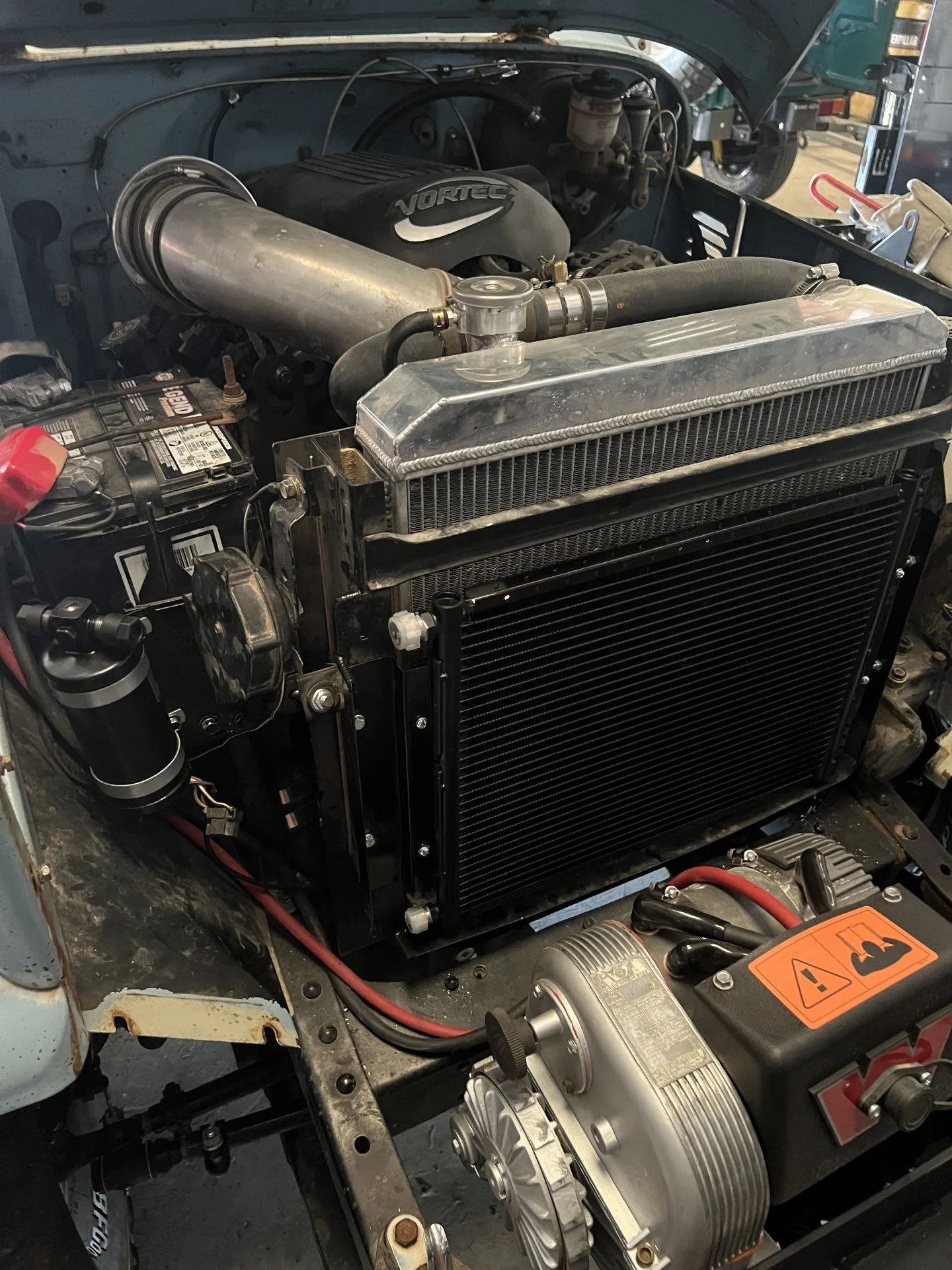

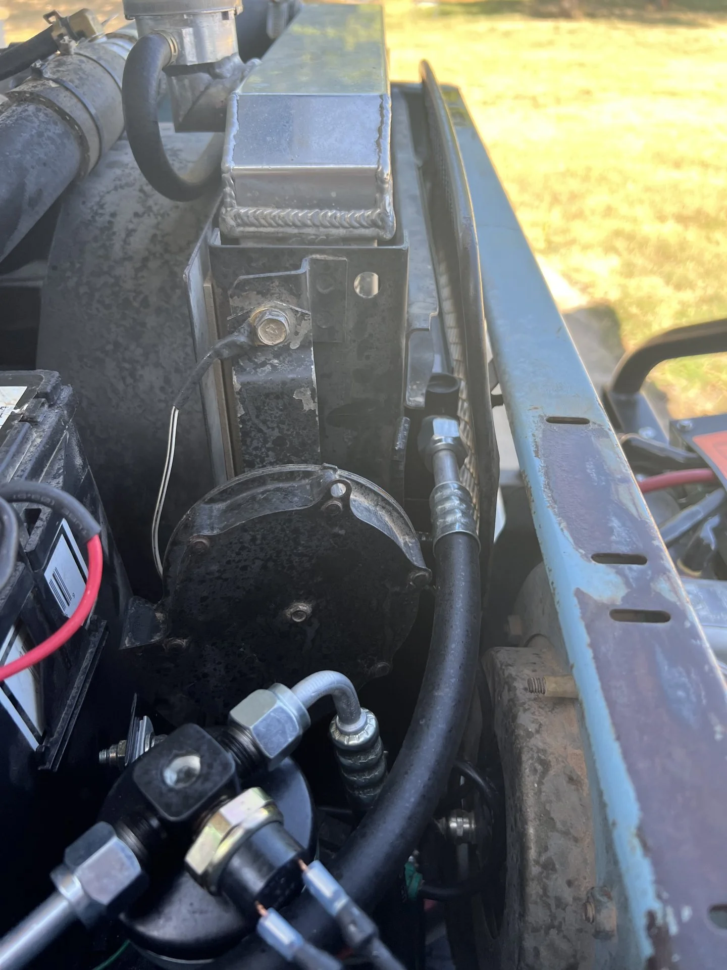

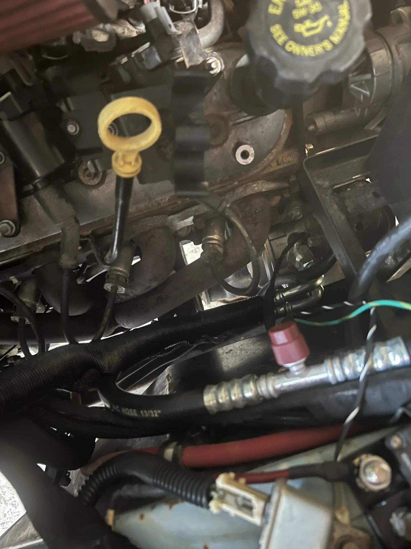

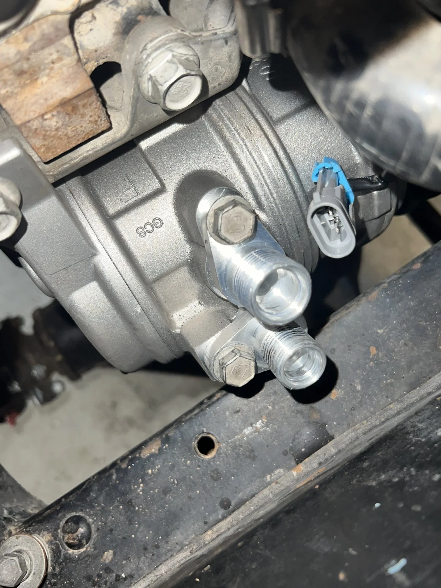

Back to work on the AC install after the trip. New compressor is mounted. Found these handy adapters that convert the compressor high low ports to #8 and #10 o-ring type fittings.

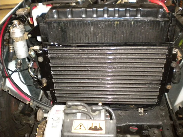

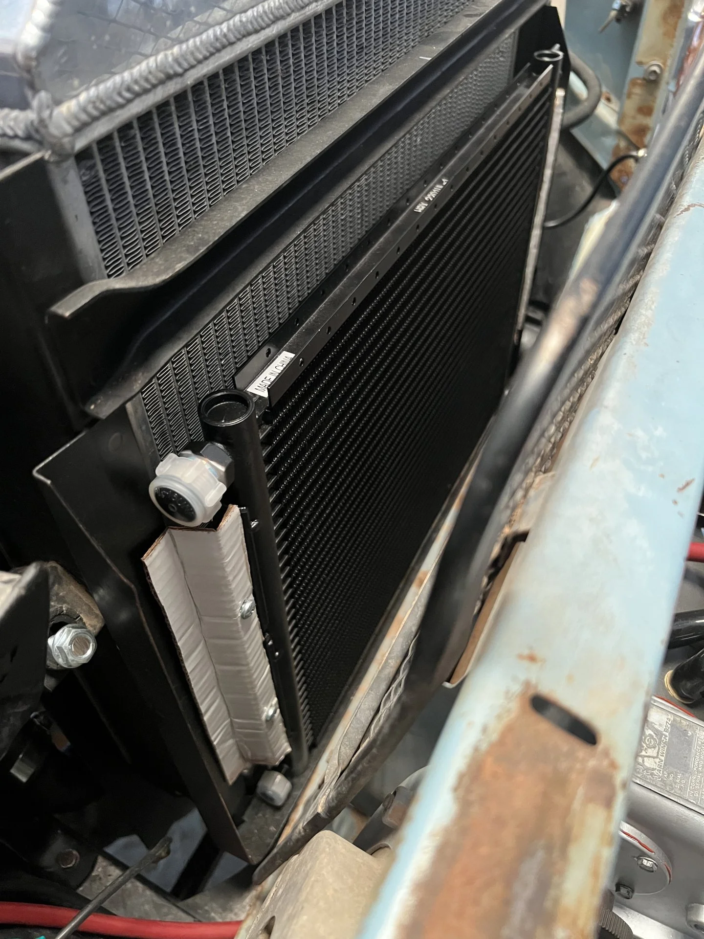

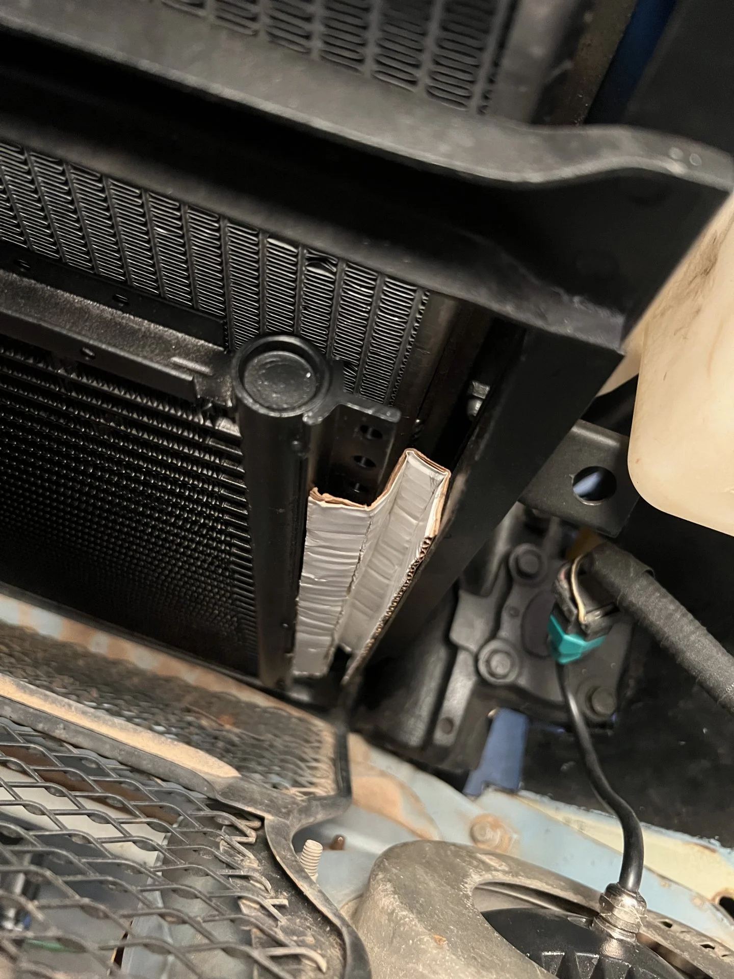

Didn’t get a condenser kit with the vintage air kit I purchased so I had to get creative. This is a generic nostalgic air ac condenser that fits perfectly. Just had to make my own mounting brackets and trim the core support stiffening ribs in the upper and lower corners to create room for the lines. Also had to weld the lower rib back to the support. Got the drier mounted to the battery tray as well.

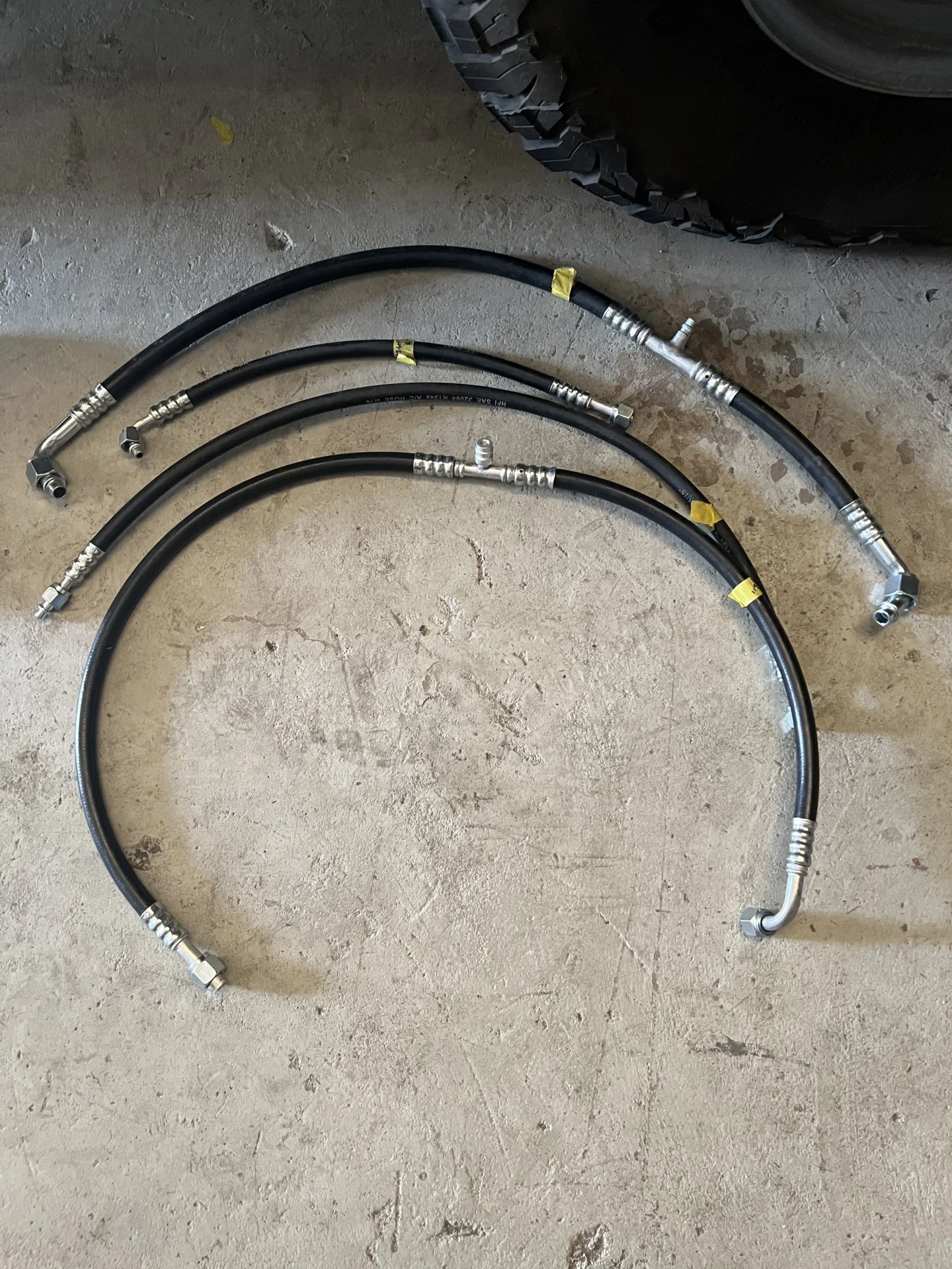

Have a local mom and pop shop called Hosefast near us. They do awesome work and are willing to take on any job. Had them make these custom ac lines for me.
We have a shop in Wilmington NC, Diesel Parts of Carolina. That guy is a wizard. He made up my AC hose, PS hose and even a hydraulic line for my 1969 JD 140. They can do it all.
Yeah these guys have perfected their craft. They have every fitting imaginable on inventory. The old timer Shaun who works there has been there for years. He did all my lines in like 20 minutes. Price is fair too. Hard to justify buying the tools when we’ll only use them once per rig.

Wrapped up installing my lines. Had to add a new main ecu harness pass through hole in the firewall. Had no room to run it through the blower cover panel anymore. Really nice 2 piece pass through that landed everything directly in the glovebox.
Condenser fits with no mods to the bib. Had to remove the “Toyota” emblem though. Will revisit mounting it later.

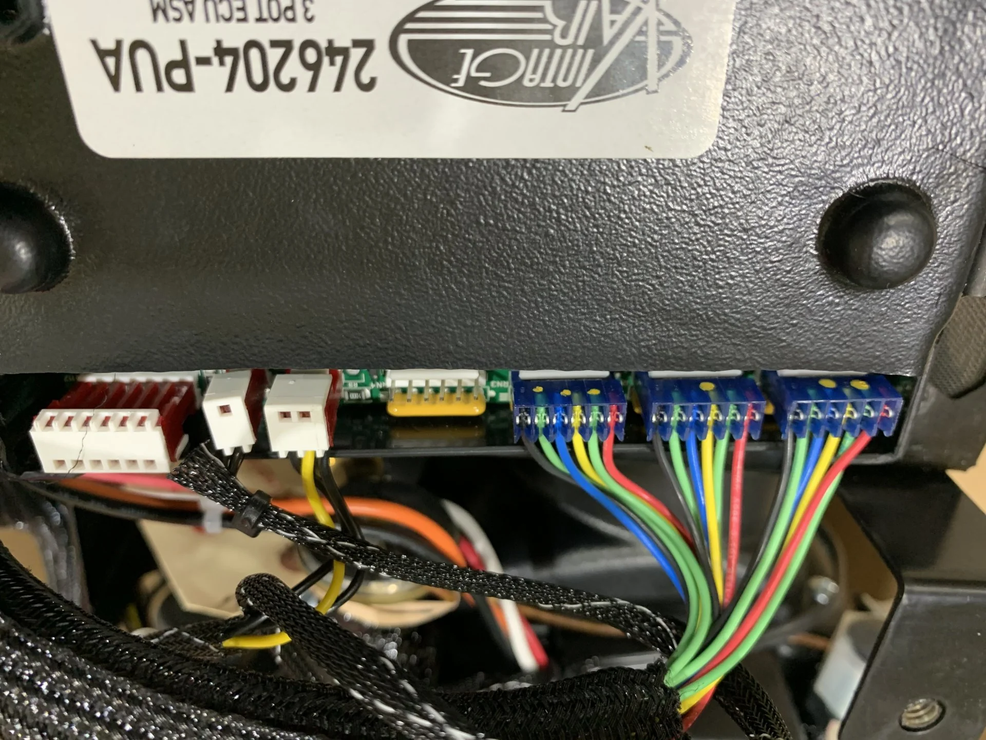

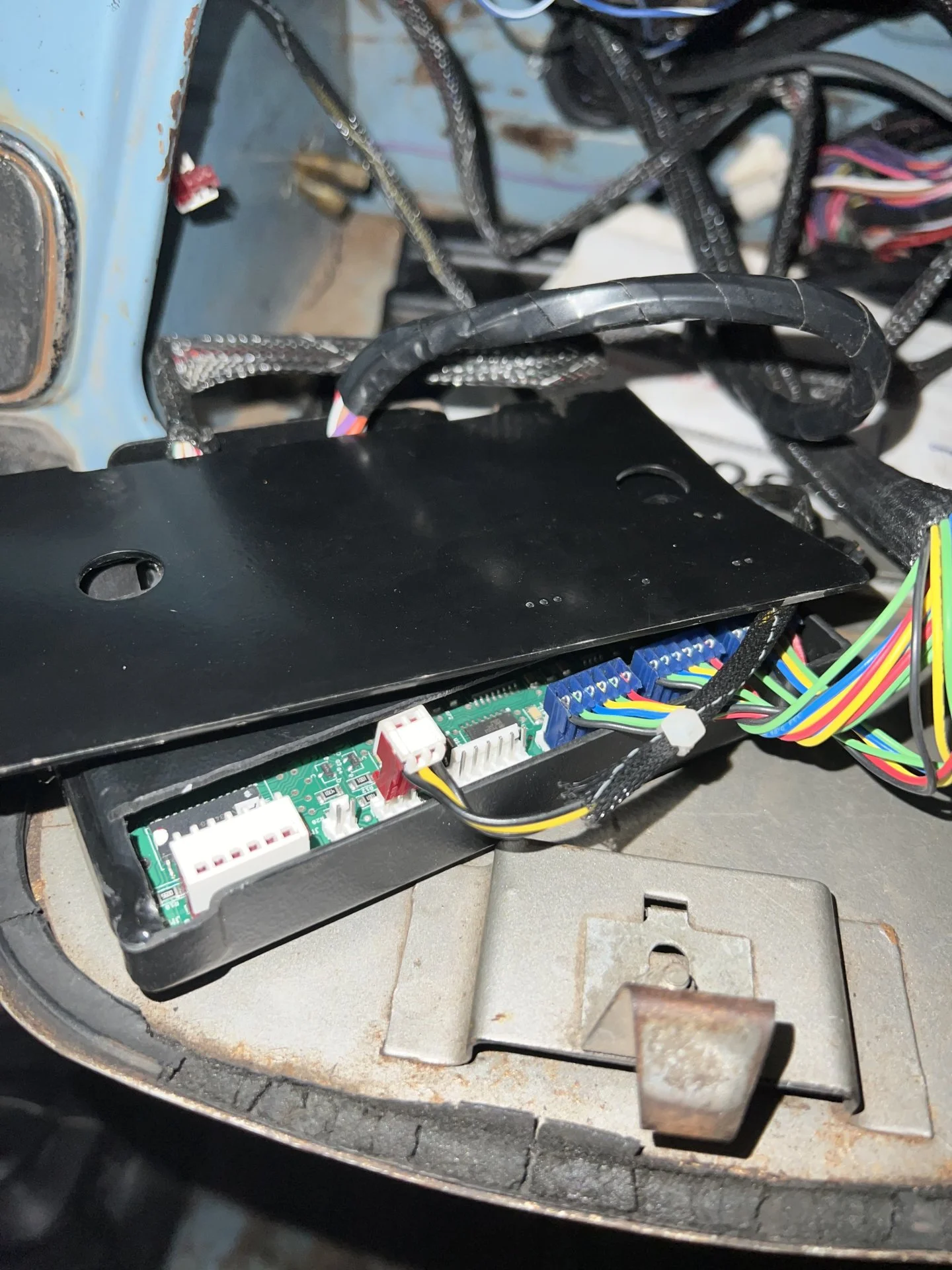

Checked system held pressure and charged it. Compressor would not receive power from the relay to the pressure switch. Hardwired it to get the pressure up. Still no dice after system was pressurized. Texted @samc2447 and it turns out I lost the evap temp sensor female plug behind the evap when I wired everything up.
My ecu:
Steve’s ecu:
Plugged it in and compressor started cycling. Unplugged the low side port connector and refrigerant went everywhere. AC shop didn’t install schrader valve to the low side :bang:
