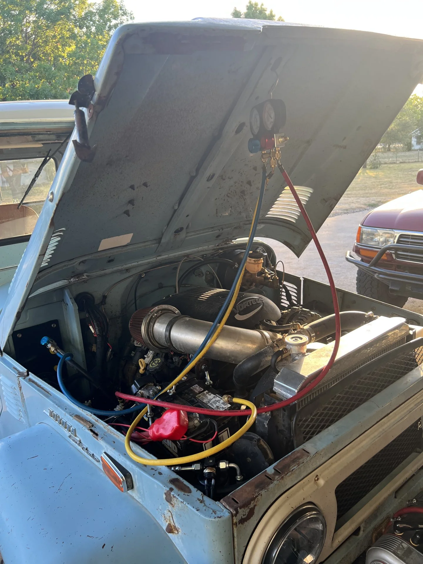

Its been a while but if I’m correct you check for the bubbles in the sight glass on top of the dryer, lots of bubbles means low refrigerant.
If it gives low temps/enough pressure you’re fine.
Yep, sight glass has few bubbles and a milky white tint to it that hasn't cleared up yet.
Added more refrigerant and an oz of PAG to the system today. Was 100 Ambient, got low side to 50 and high to 320 psi. Compressor cycled a few times. Drove it and city driving temps went up roughly 8 degrees to 204. Will see how it does on the highway but I’m expecting it to drop back down to 197ish.

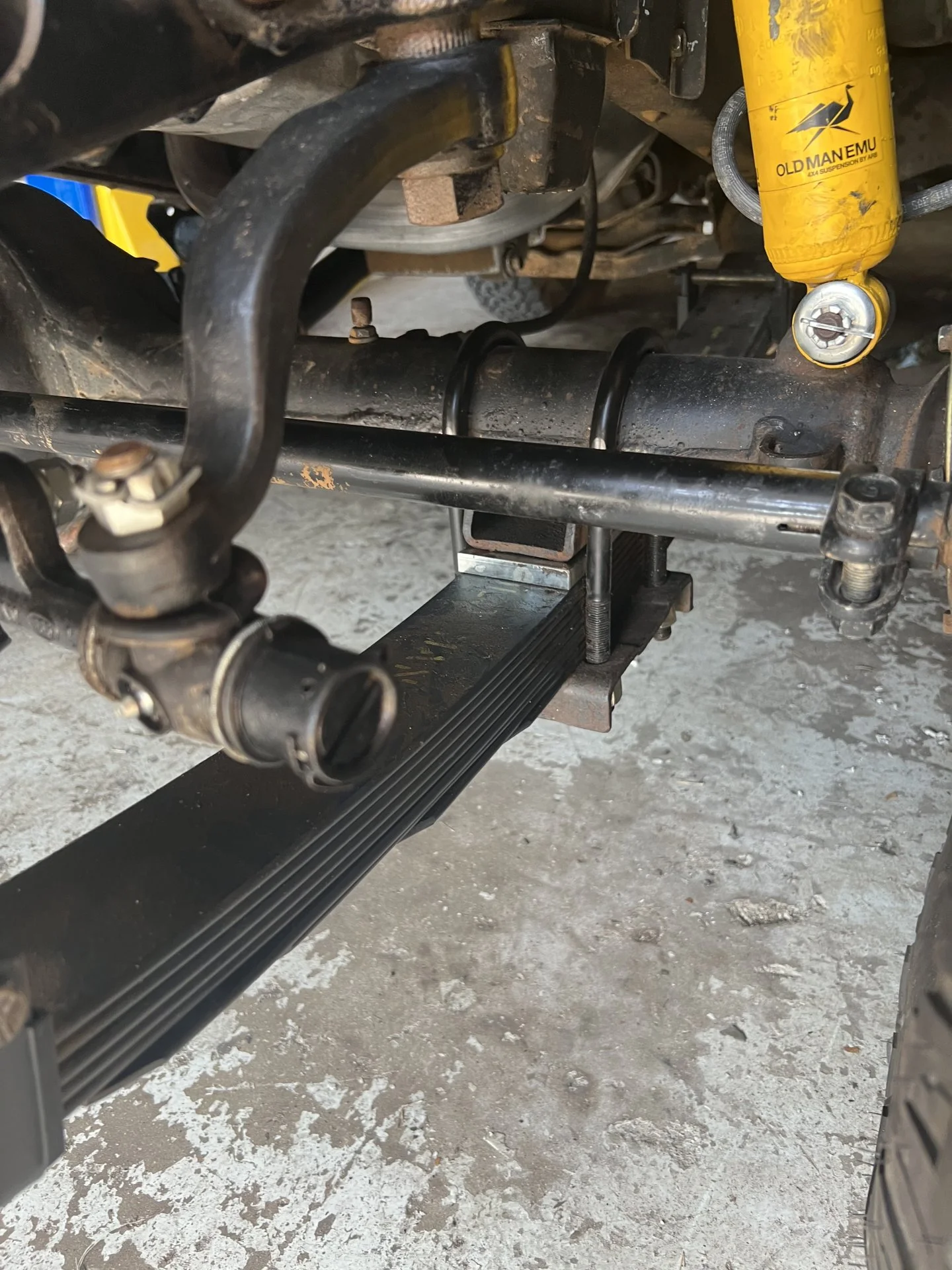

4 degree caster shims went in too. Big difference, notice it on sharp turns and winding roads. Also seems to hold a line firmer when braking.

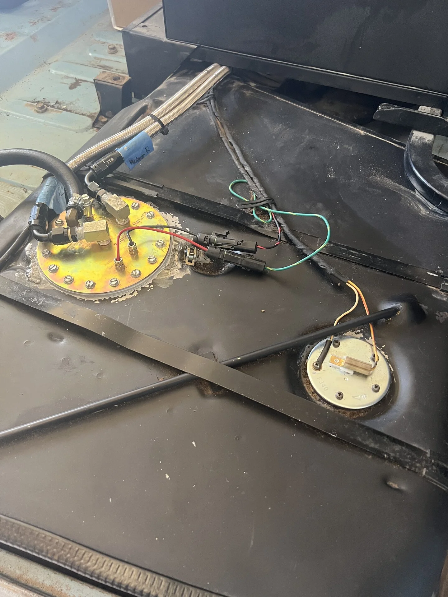

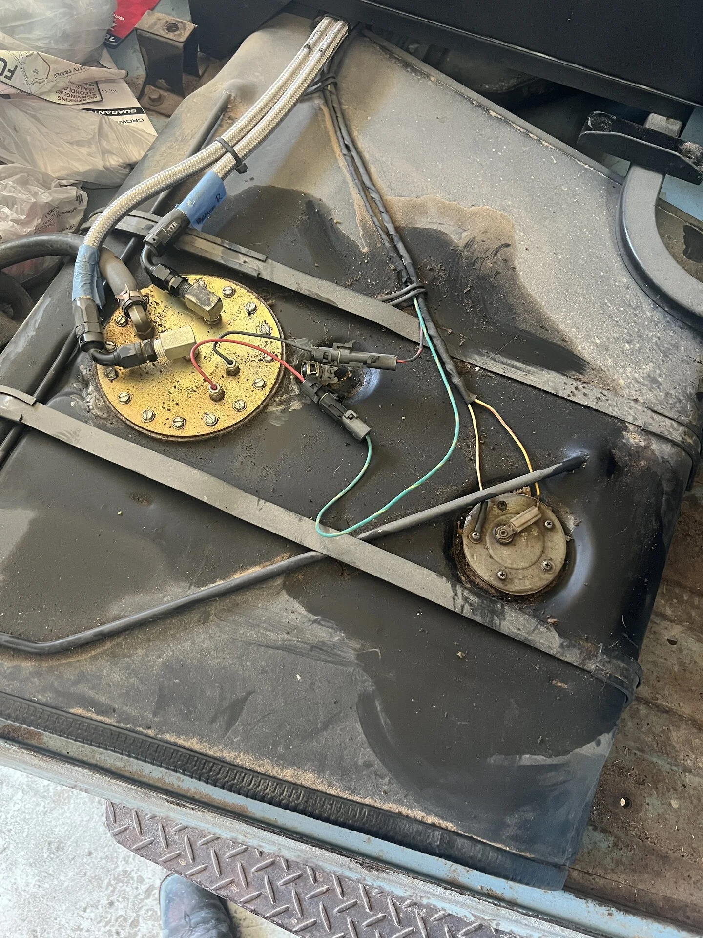

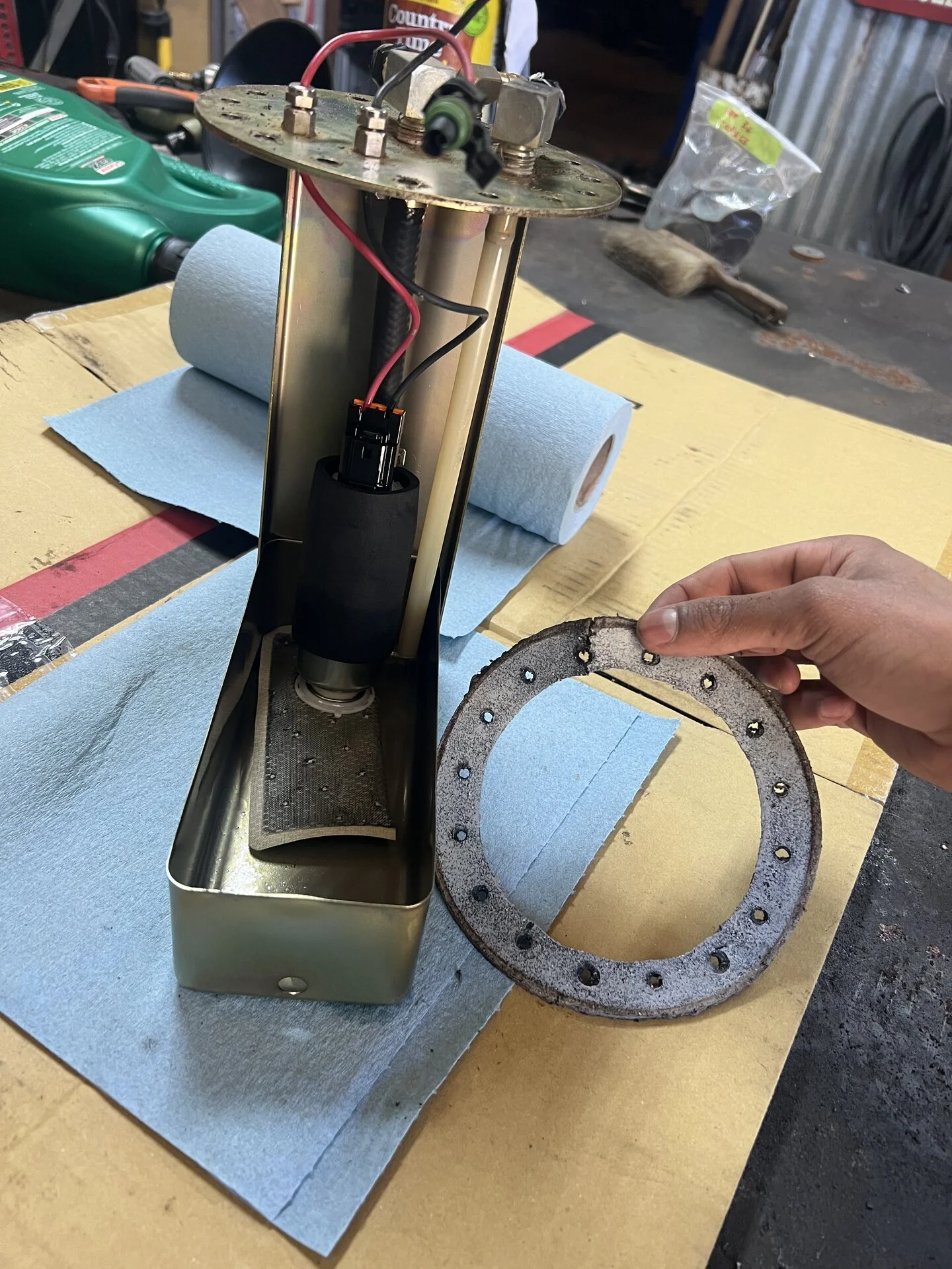

Fuel pump mounting flange seal blew at SAS. Thinking the tank wasn’t venting fast enough with the altitude change. Was running an oem cap with a hole drilled. Any suggestions for an aftermarket vented cap? Running no cap for now.

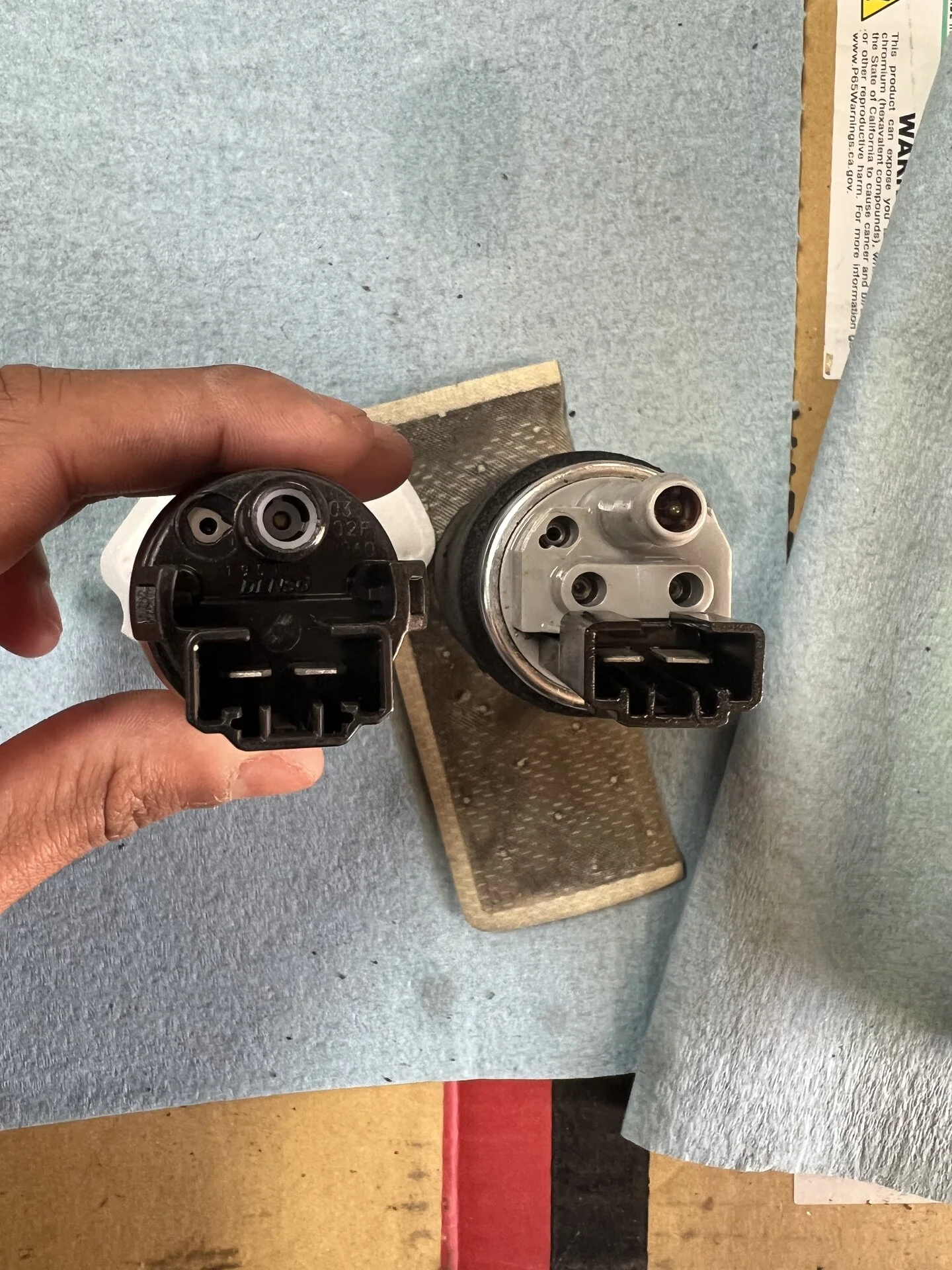

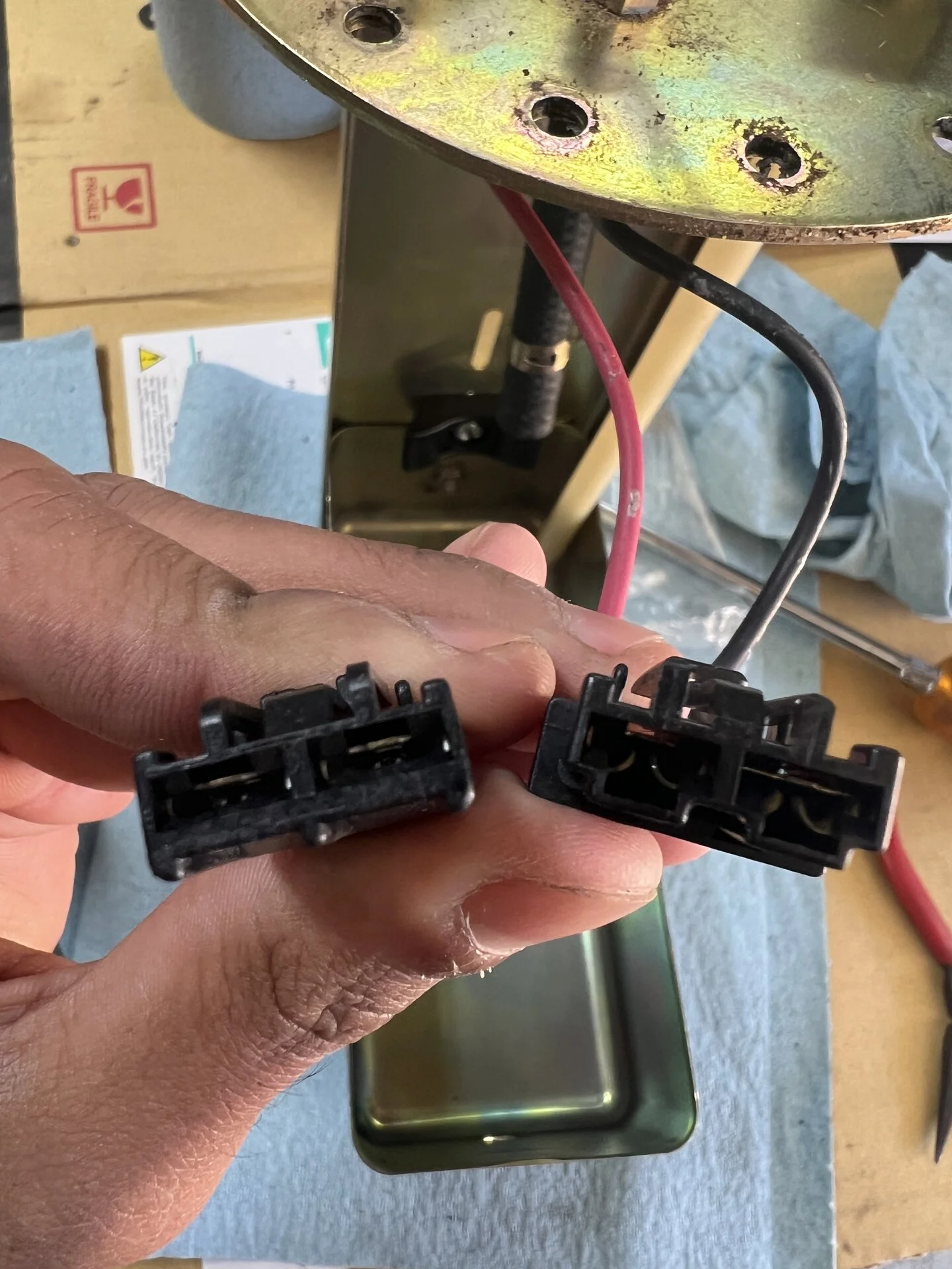

Swapped to a Denso fuel pump while I was in there. Walbro was reliable but too noisy. New pump is whisper quiet. Thanks @Zjohnsonua for the rec. Part #950-0226.
Walbro:
Denso:
Connectors between the two are also interchangeable.
Denso (left)/Walbro (right):

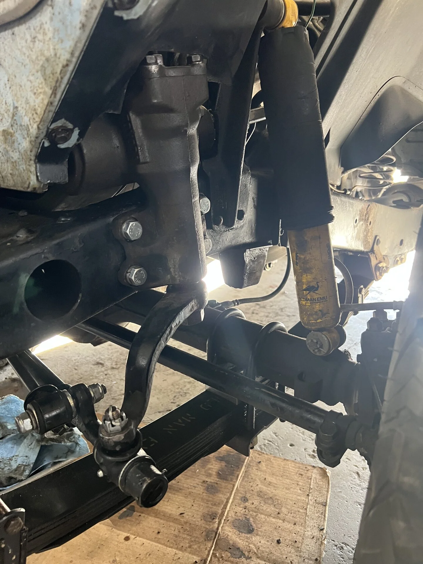

Power steering box has been puking for awhile. Decided to rebuild myself. Fairly easy, hardest part was feeding the ball bearings back into the worm gear/power piston assembly.

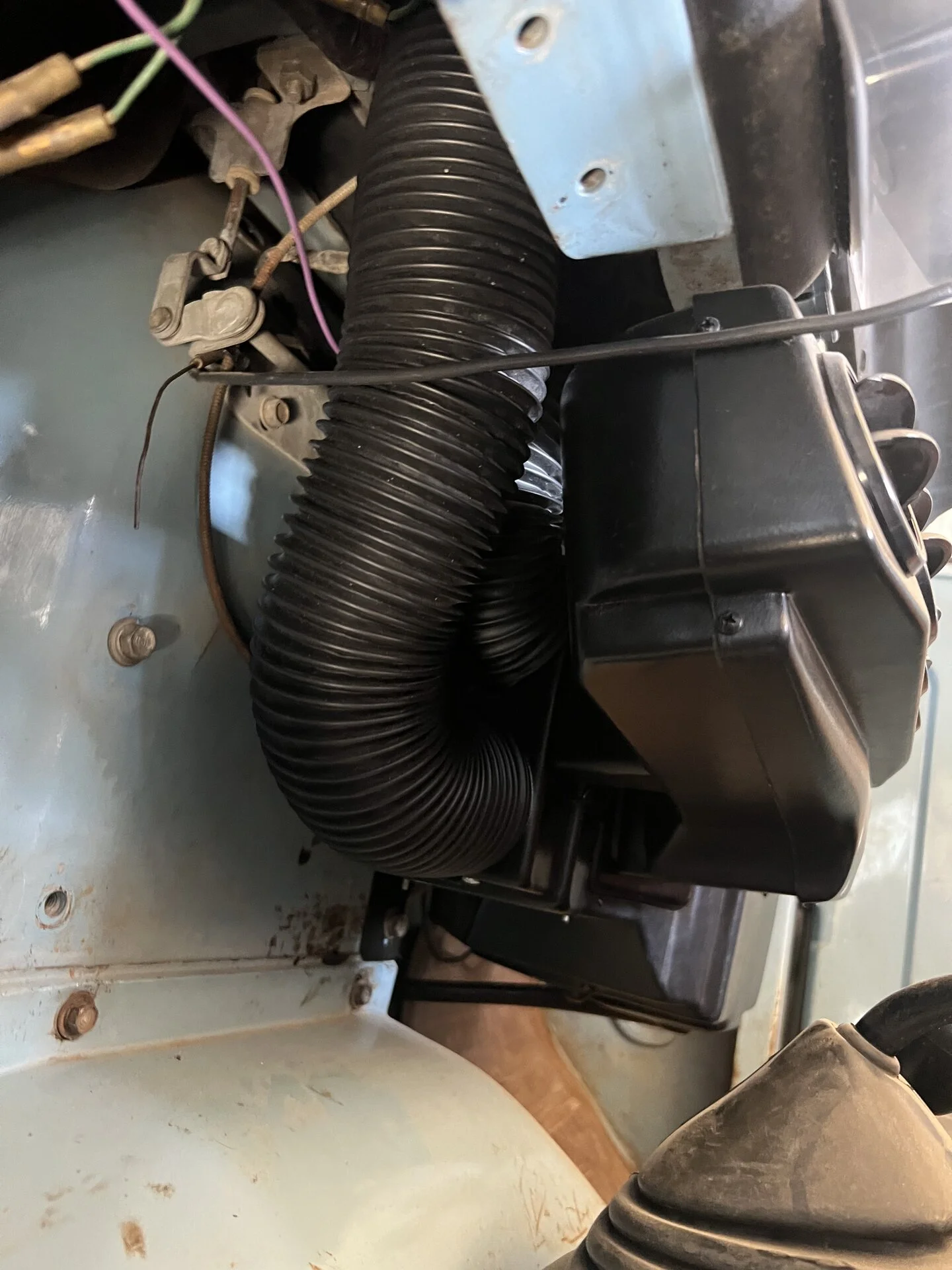

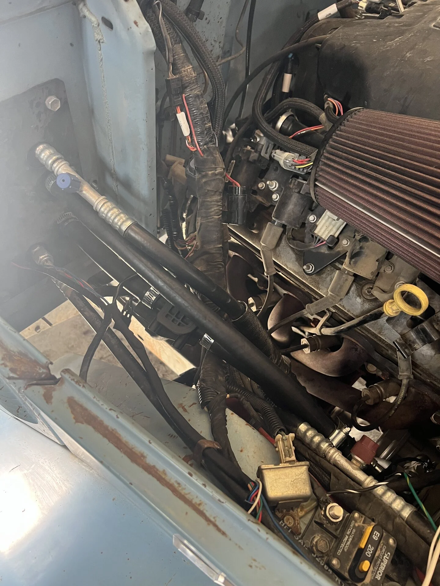

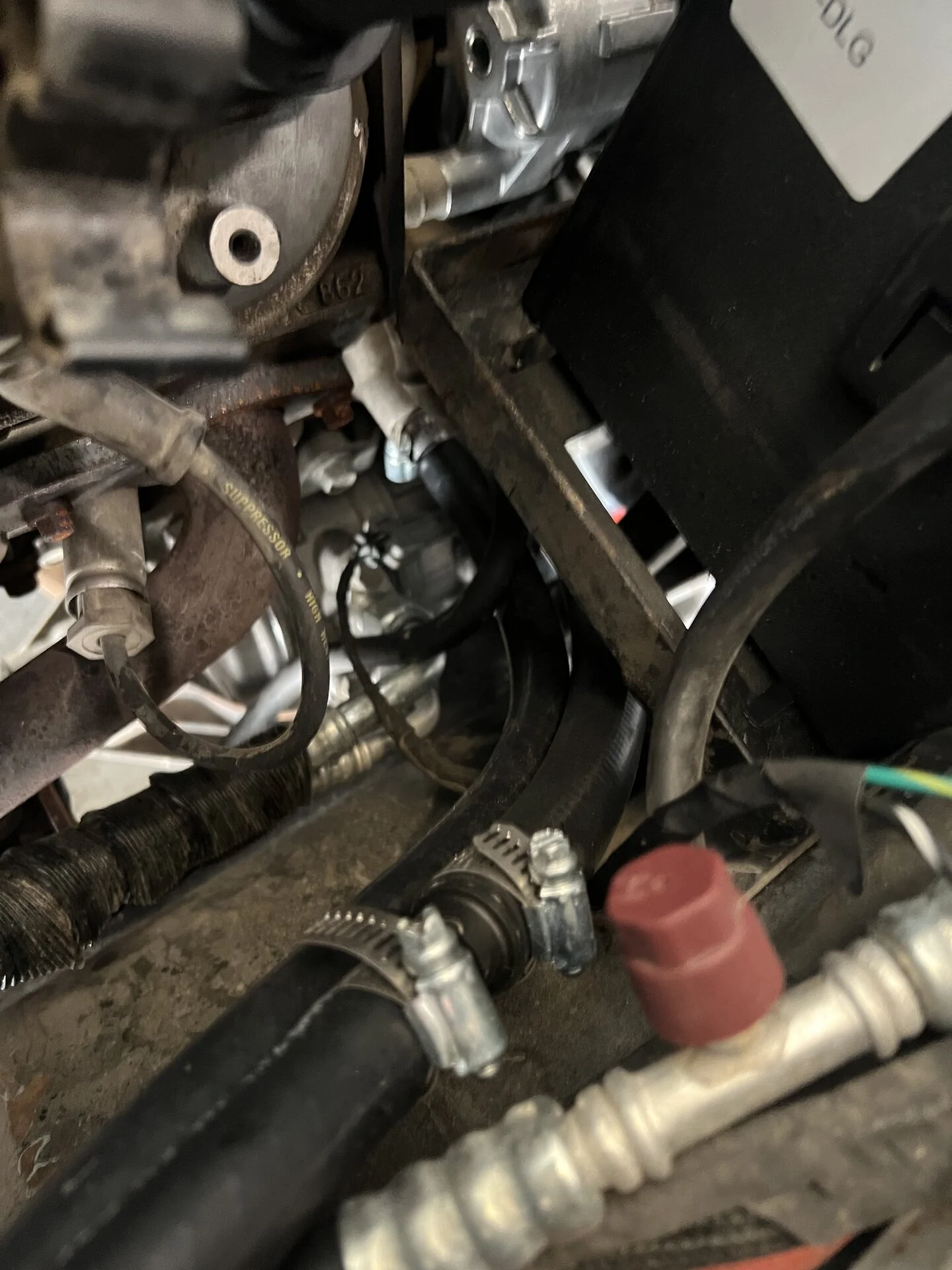

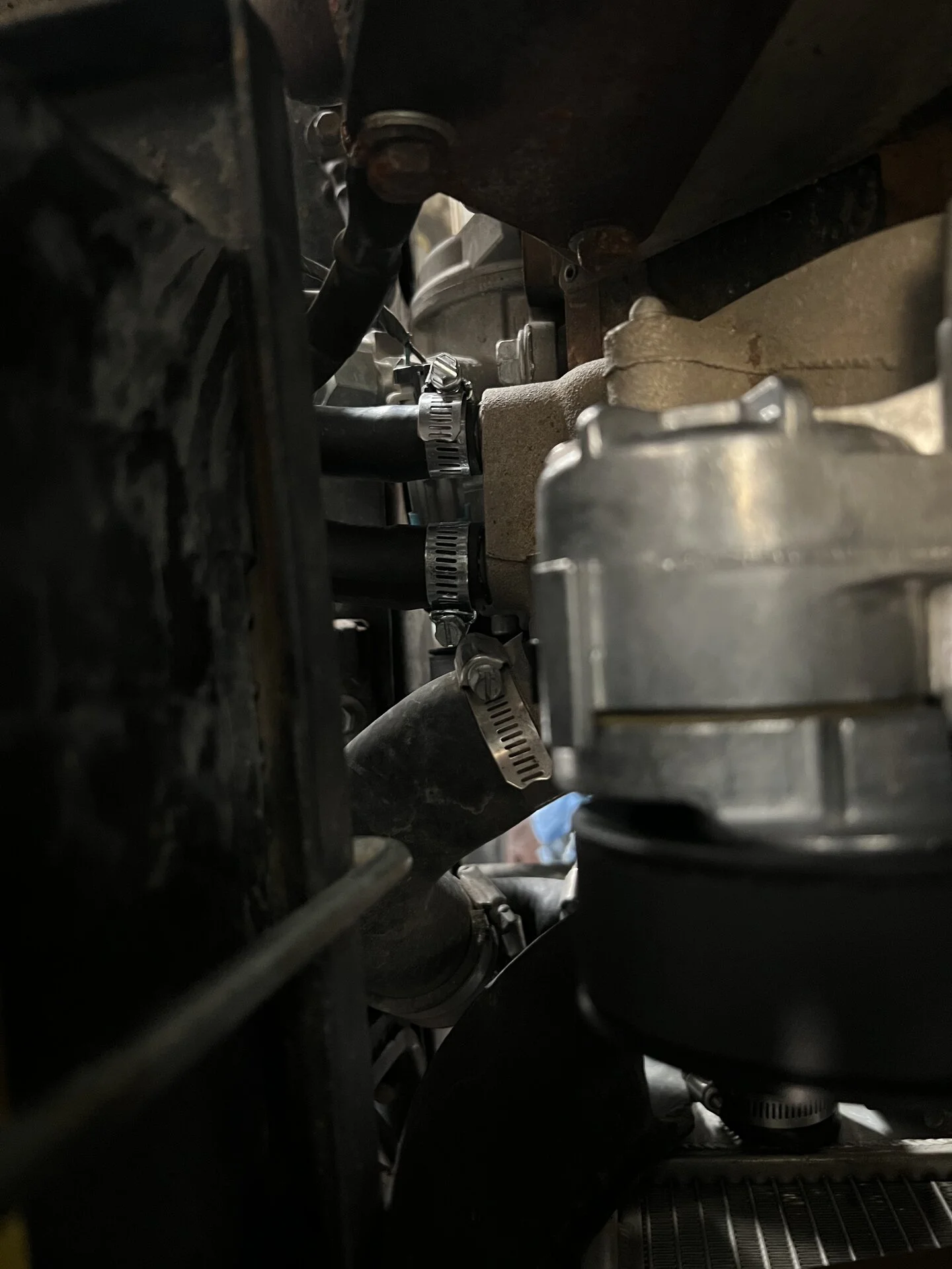

Got heat and defrost up and running due to the colder weather recently. For those looking for the correct flow orientation between the LS/Vintage air setup I’ve added photos below. The 5/8” is the outlet and the 3/4” is the inlet on the water pump side. Both heater fittings at the firewall are 5/8”.
