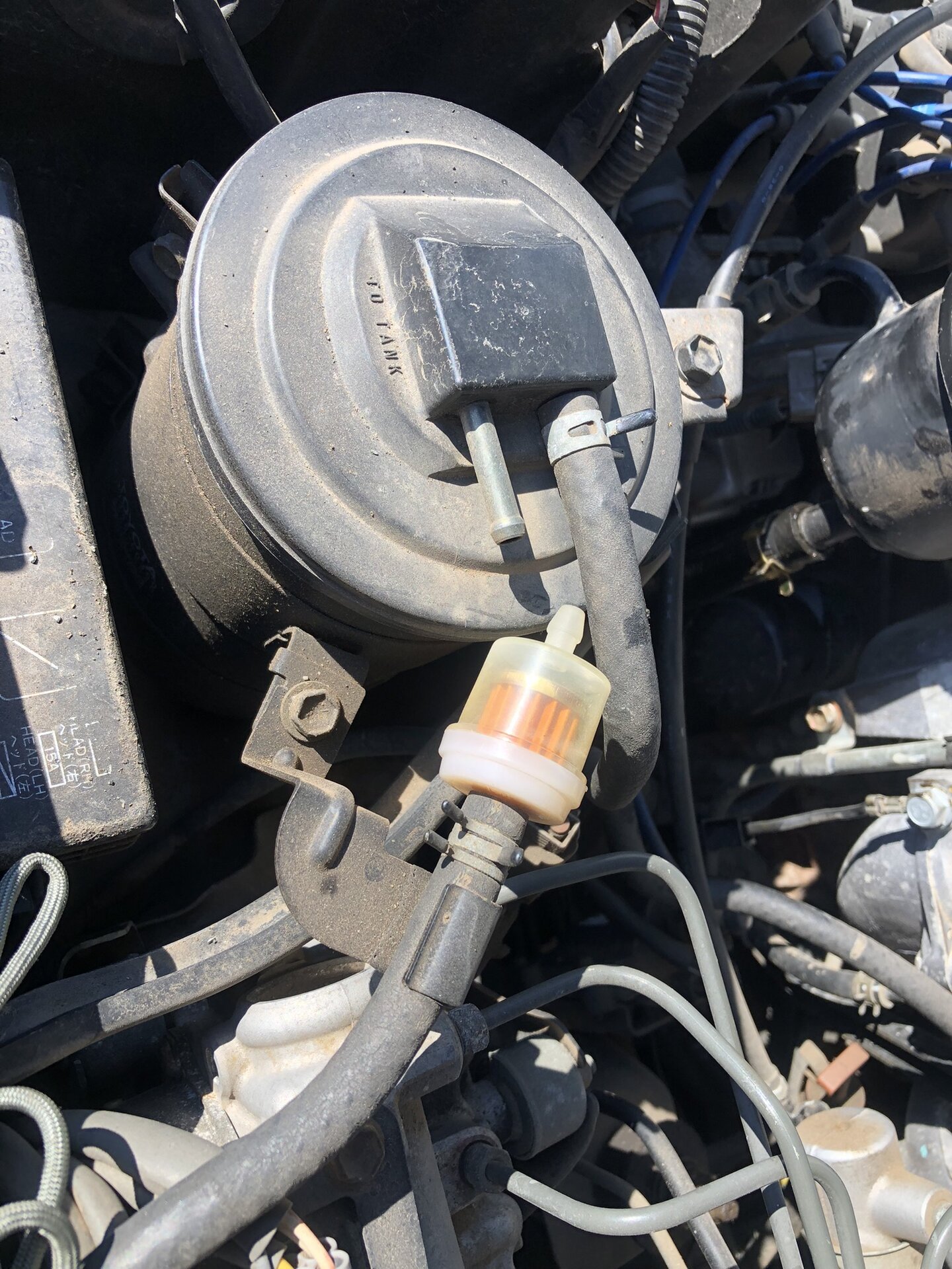

Before you do anything else put an inline fuel filter on the inlet side of the canister and leave that line unhooked and see if suction at tank stops. Takes less than 5 minutes.
Do what @Hornd says. And depending on vehicle inspections and emissions where you live consider it a possible permanent fix.....

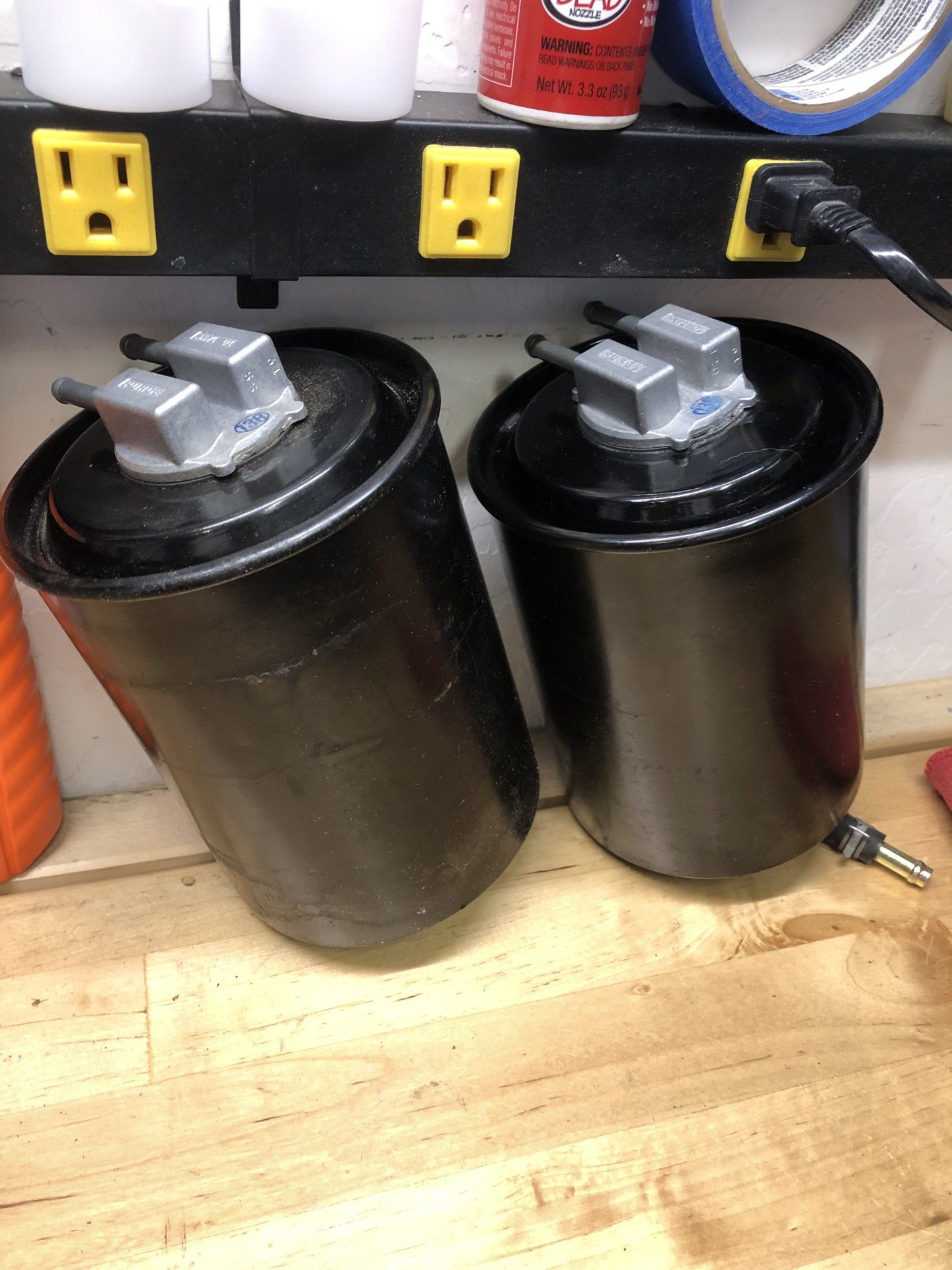

Several of the members in Arizona, myself included, rebuilt them.
How did you do that if I may ask?
Not an 80 but same process.

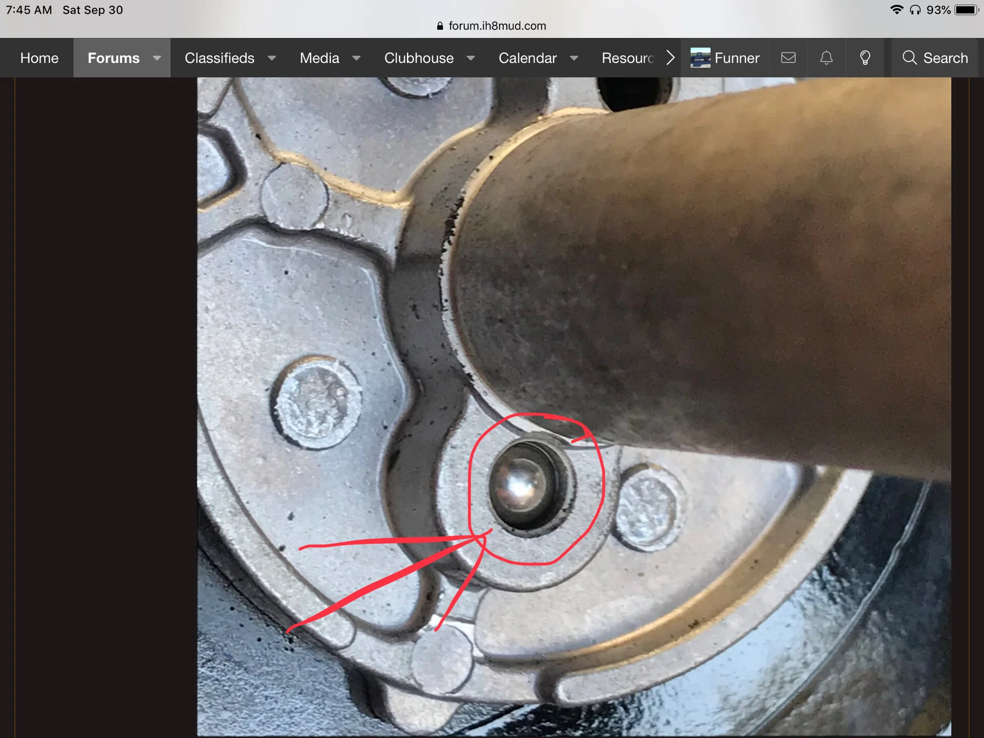

I elected to drill out the bb check valve.
Here is the link to the 80 rebuild
