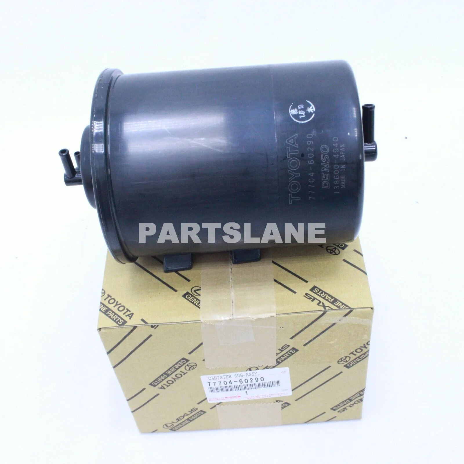

Figured I stay Toyota and ordered 77704-60290 the "Toyota OEM Genuine CANISTER SUB-ASSY, CHARCOAL"
It needed a bit of modification to fit, in that the canister has some plastic mounting lugs that needed to be ground off. Otherwise, perfect fit.

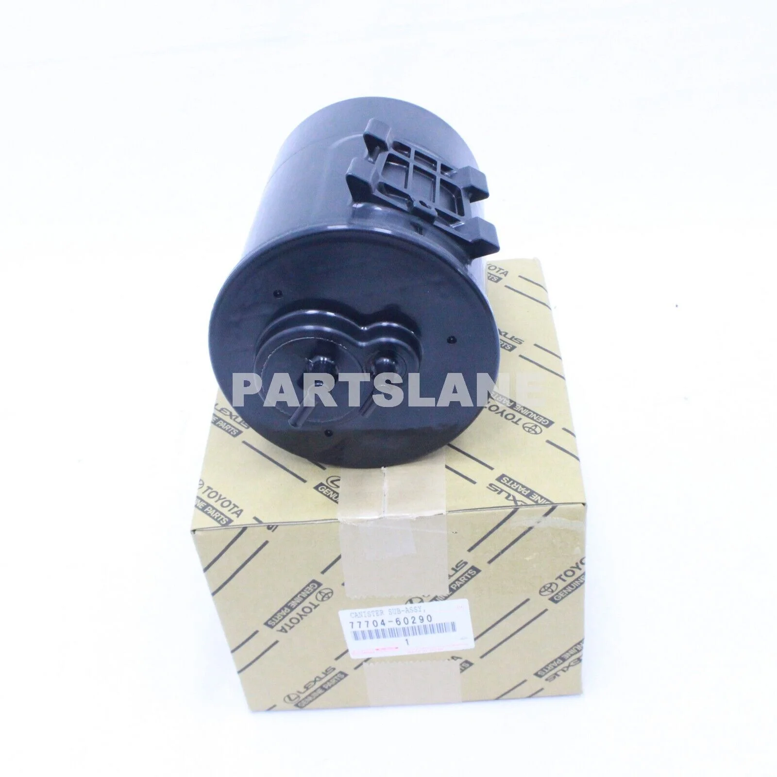

In the second picture, you can see the plastic lugs that need to come off. And you'll need about 10mm longer bolts for the canister brackets
WHAT A DIFFERENCE! Driving around, it's like a new car - the smell is GONE. So yes, gas vapor smell in cabin was fixed with new charcoal canister. A 1 banana job.

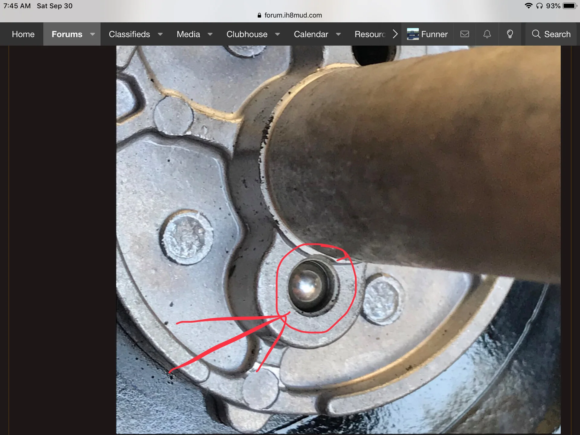

Not an 80 but same process.
I elected to drill out the bb check valve.
