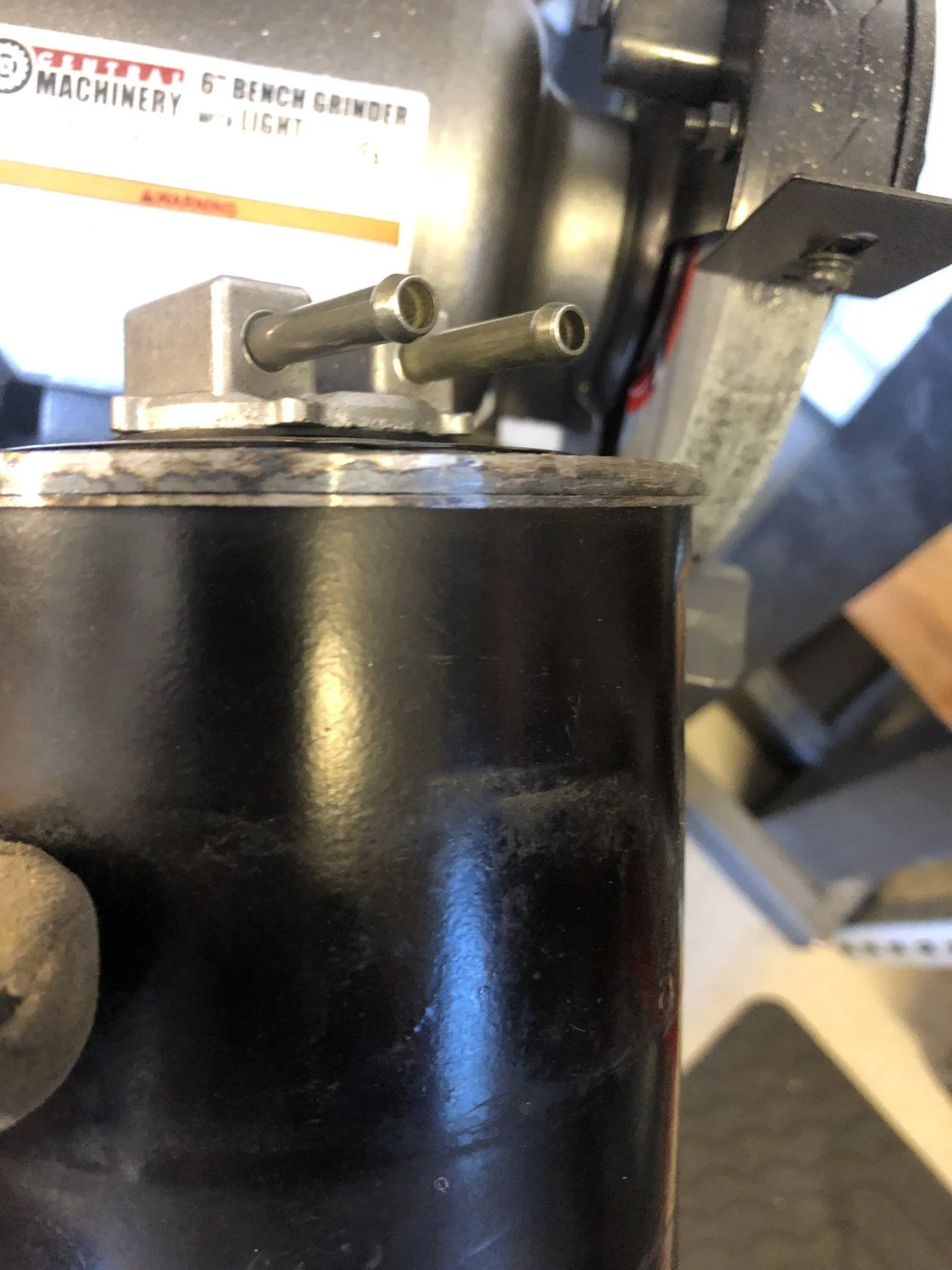

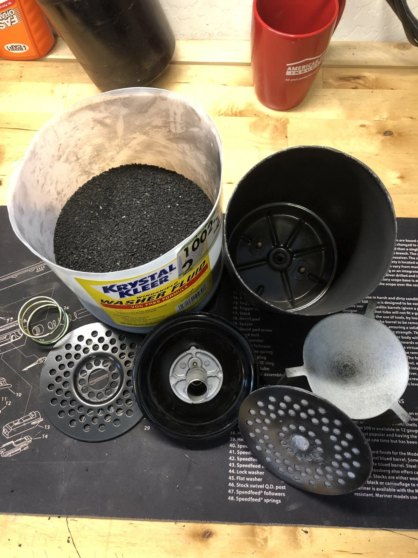

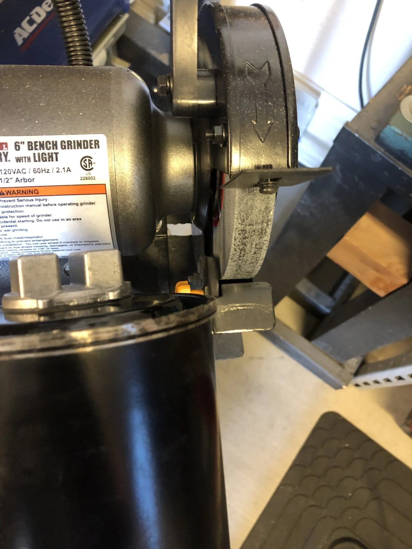

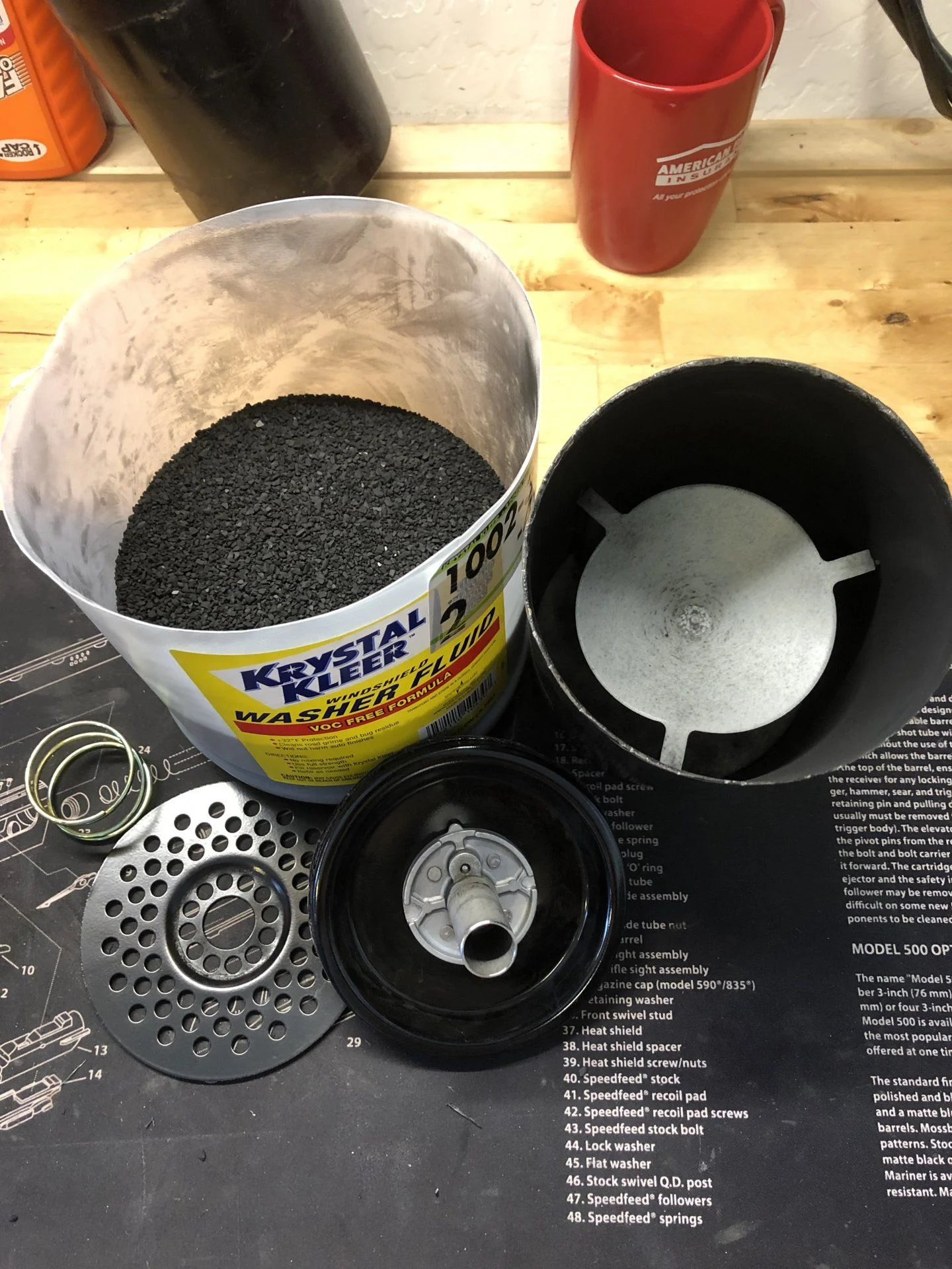

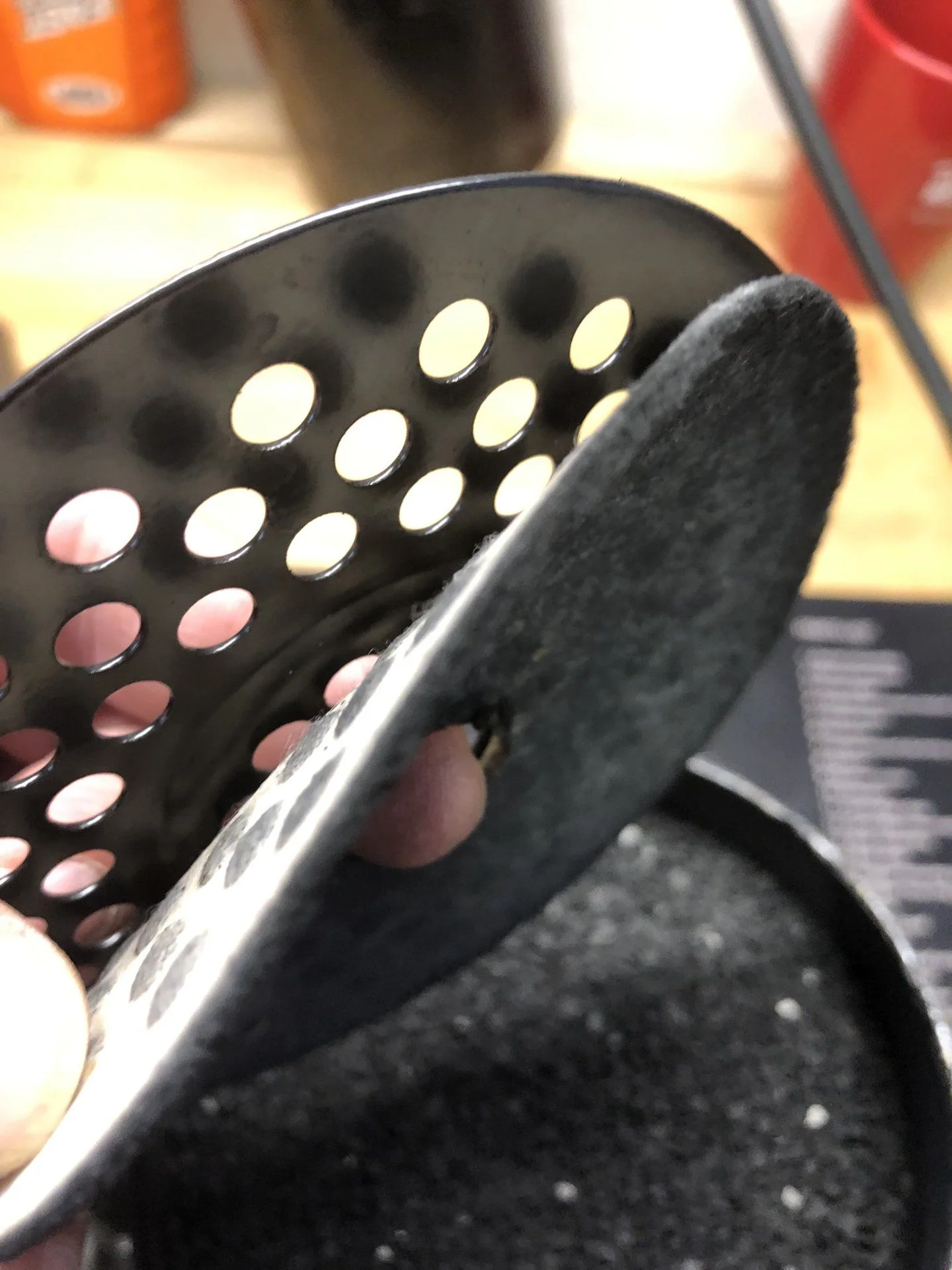

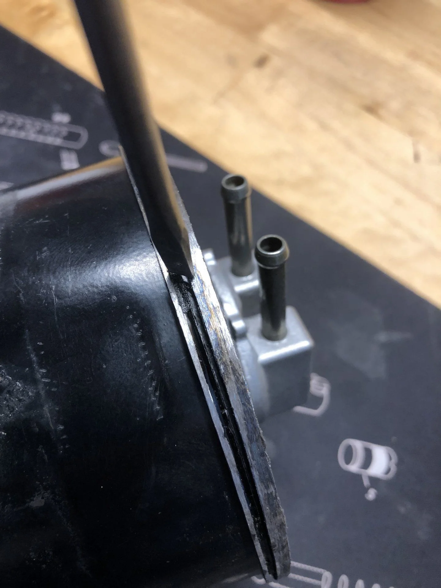

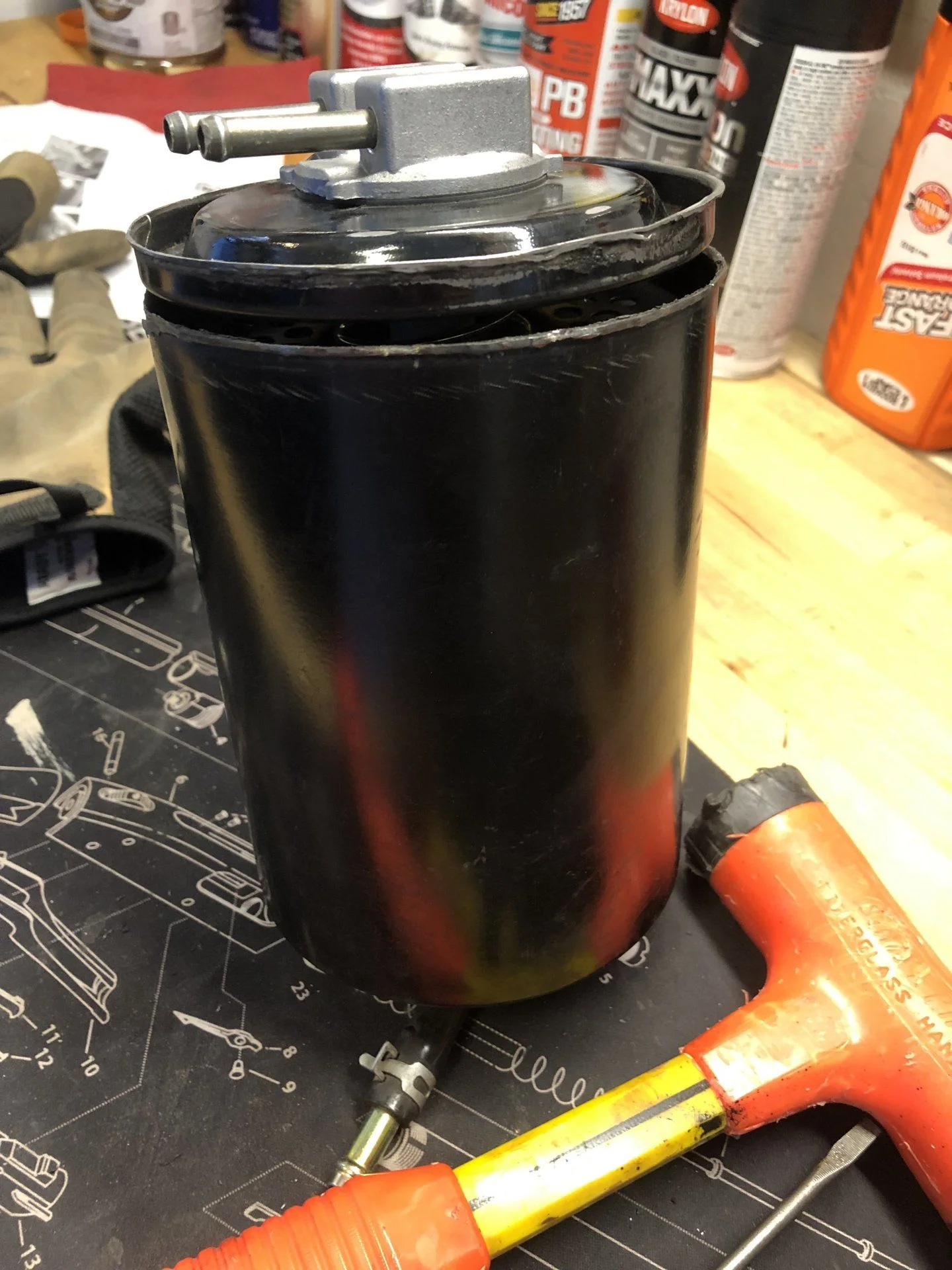

80 Series Charcoal Canister rebuild. Bench grinder removes the seal cleanly. Wrap up is clean the valves, replace the old charcoal, button it up and reseal. You can weld it closed or use a good epoxy like JB weld. I will finish mine up later today with a little rattle can paint. The problem was clear on this can, the valves were full of debris and the check ball was seized up.
Another mod is to drill out the check ball on the “to tank” valve and remove the BB and spring to allow the can to always flow. My friend LCP did this and 3 years later it is still going strong with zero issues.
I am doing that on the next can and will run both for 3 months each and follow up.

Interesting thread. Where did you source new clean charcoal? Reminds me of some of the "Brita" filter rebuilds I've seen online that talk about using fish tank charcoal to rebuild those expensive little buggers.
Glenn in Marana
As LCP suggested, I pick some up at the local pet store a few years back when I did this
Glenn in Marana
Local pet store if they sell supplies for aquariums. Watch the price! Petmart was around 20 bucks, got mine on-line for 8 bucks.
