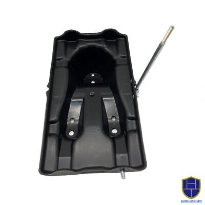

Pulled the batteries and started to chase all the extra wiring. Bit tedious but looks much cleaner now. PO "customized" the battery trays..More parts to track down. Made a few phone calls, front is available from Japan for $$$ shipping, rear is NLA. Anyone?
Well that's disappointing. I bought one off partsouq a couple years back but it looks like the tray is NLA. You can still order the arms though.
And I see a chinese tray on ebay. It looks like the right shape to hug the inner fender / wheel well.
These are the parts I used. Although I remember the clamp I received was actually a match for the front not the rear, so I had to cut/bend it a bit to fit.
  • 74403-60140 - tray
  • 74404-60090 - clamp
  • 74434-90K03 - support arm
  • 74435-90K02 - support arm
Hello,
You can try a later model (2007 on) tray.
This tray may need a bushing or two to fit the fender.
Juan
Thanks @JuanJ and @TreadingLight
I ended up ordering the tray and one battery hold down from Cruiserparts.net, I was a bit skeptical after reading some poor reviews of the website but they showed up without hassle. The tray is off of a 2000+ 70 series P/N 74403-60230 the only problem is that they mount on the right side of the engine bay not the left like the BJ74, I will have to relocate the studs to mount the support arms and the hold down, but for $25 I cannot complain! I'll get some pics once its complete in case anyone else runs into this in the future.
