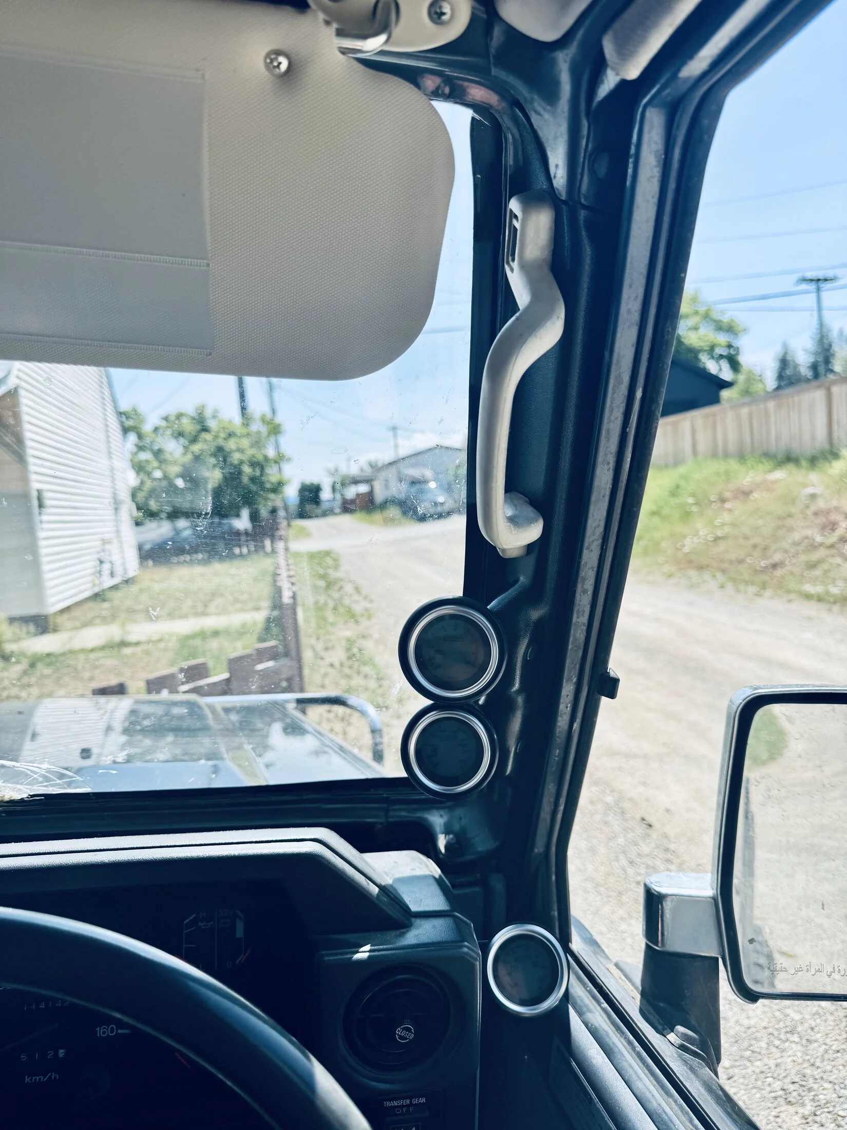

Got the ROAM boxes mounted on the roof rack, they look a bit tall to me but I’m not planning on leaving them on all the time. Gives me 180L of storage which will be nice when I’m trying to camp with 2 humans and a 135lb dog. The SAAS. Pillar Pod is a great fit, I had to do some very minor adjustments with a file to get it perfect but now that it’s installed it looks very OEM, I’ll probably paint it to match the grey eventually. The 3rd gauge pod is just a cheap plastic generic mount for a dual battery gauge. Fits pretty clean to between the window and side of the dash. Not something I’ll need to look at a ton so I don’t mind it being less visible.

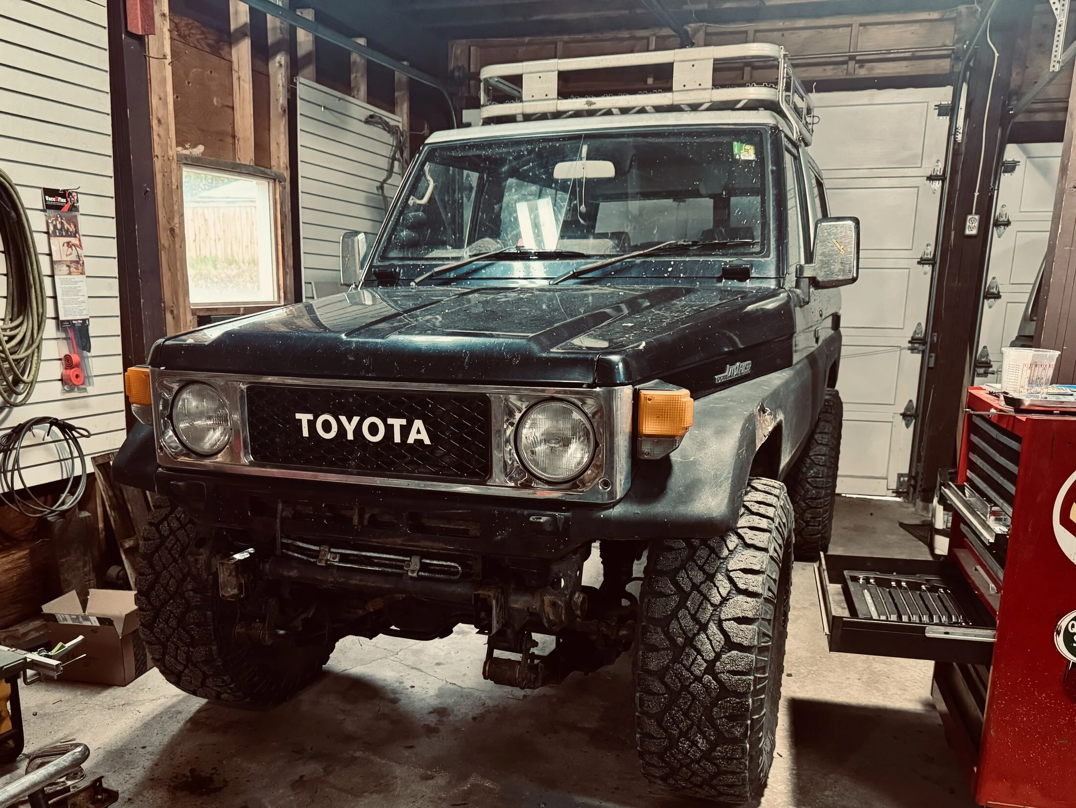

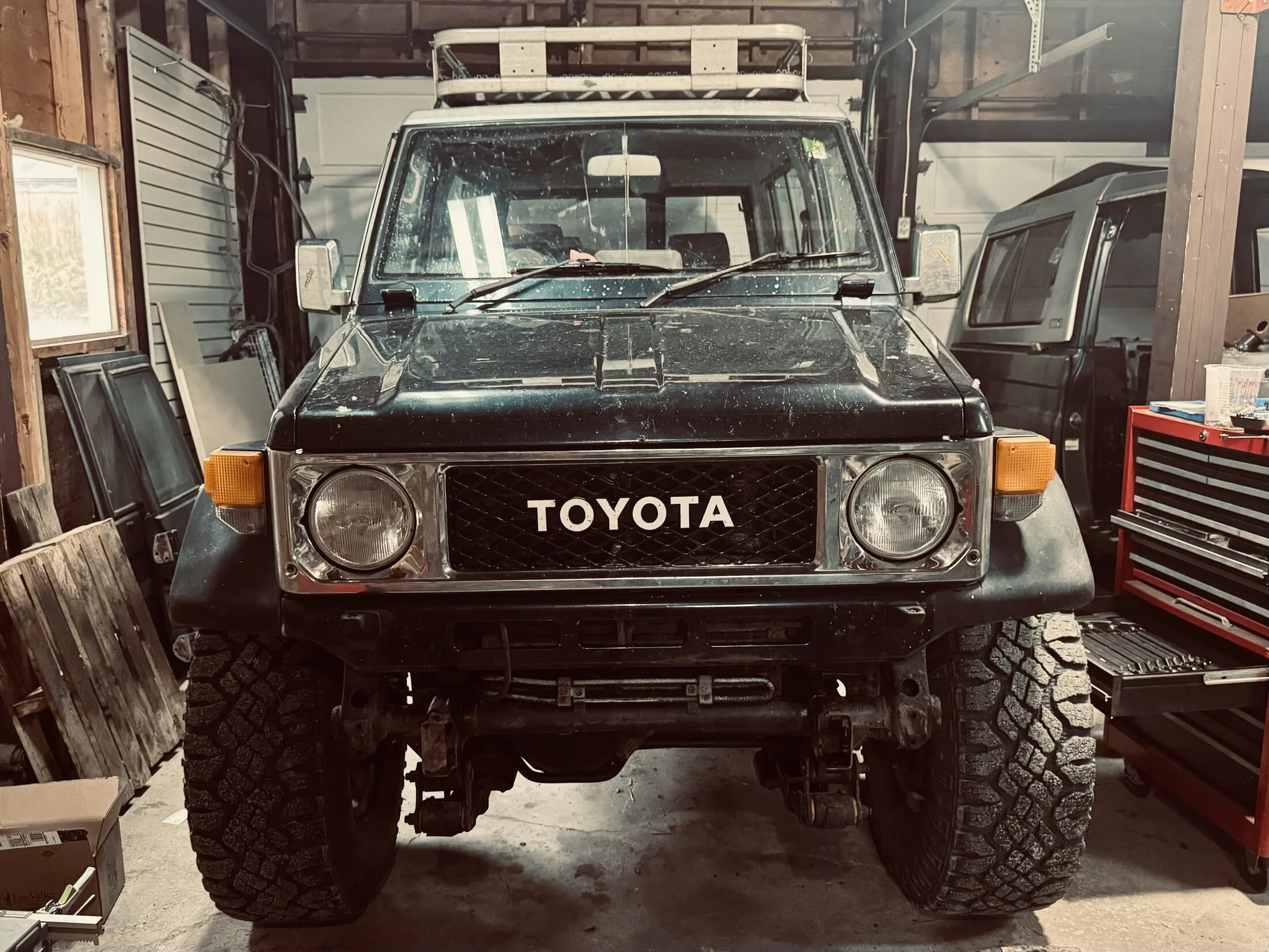

Pulled the front porch off this weekend, if I didn’t care about mounting a winch or the deer and elk that are more common than people around here I’d be tempted to leave it like this..

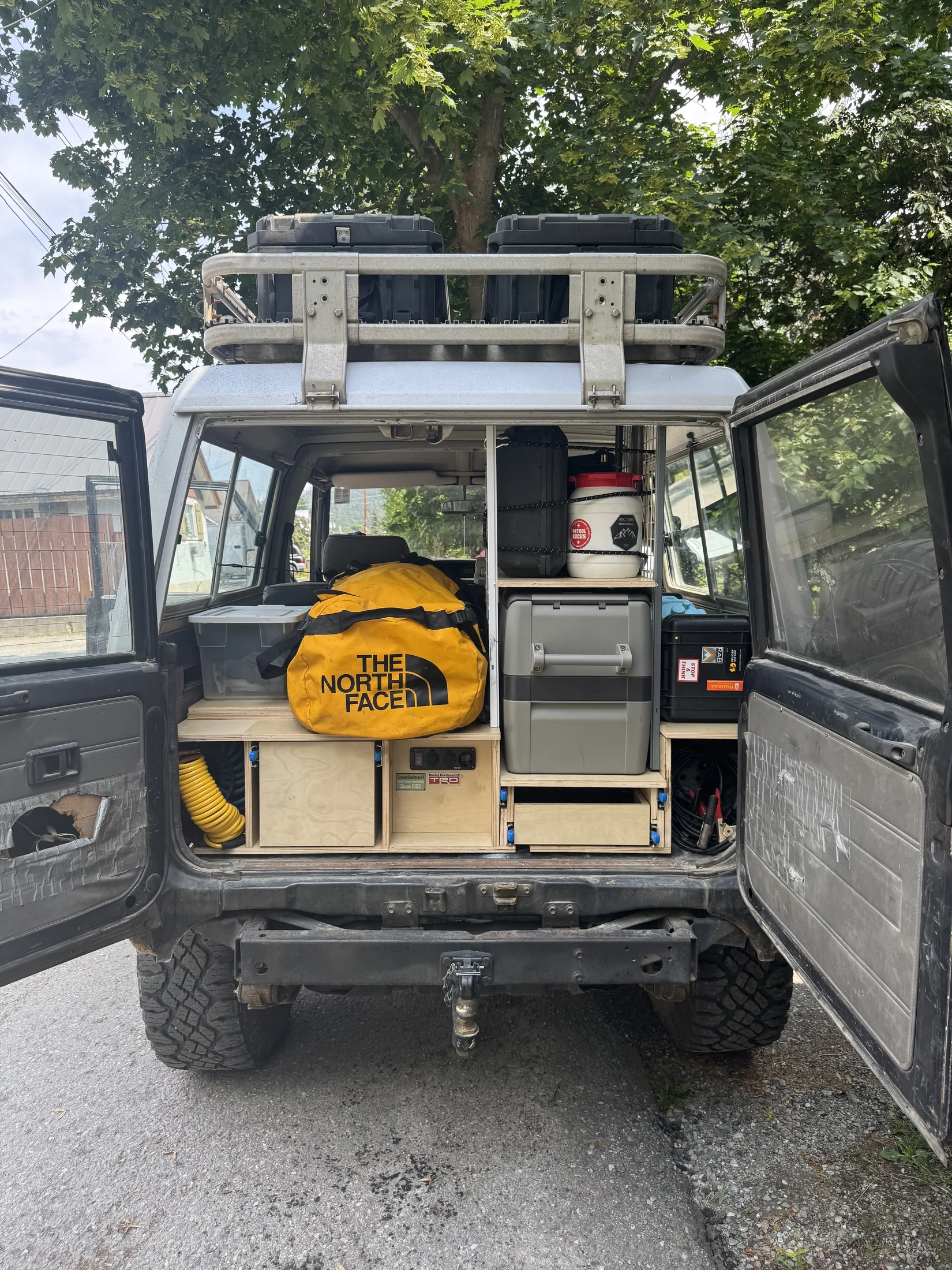

No time to finish up the coolant sensor install yet. An 11 day trip to the Canadian Rockies at the end of October meant I needed to focus on getting my camping/sleeping setup dialled in. The pullout cutting boards sure make for a ton of extra space. -17°C / 1.4°F overnight the last 2 nights, thank goodness for the diesel heater…
How did you manage to fit sleeping in there
are the rear seats pulled out?, mines a 70 so like 9" shorter than yours but maybe its still doable
The rear seats are still in, just folded down and the sleeping platform rests on the back seat. This is what it looks like folded
I have exactly 6'2" length on the sleeping platform so unless you're really short you'd have to do something with the front seat. You'd have to either pull the front seat completely or put a swivel base on it to gain the extra room.
