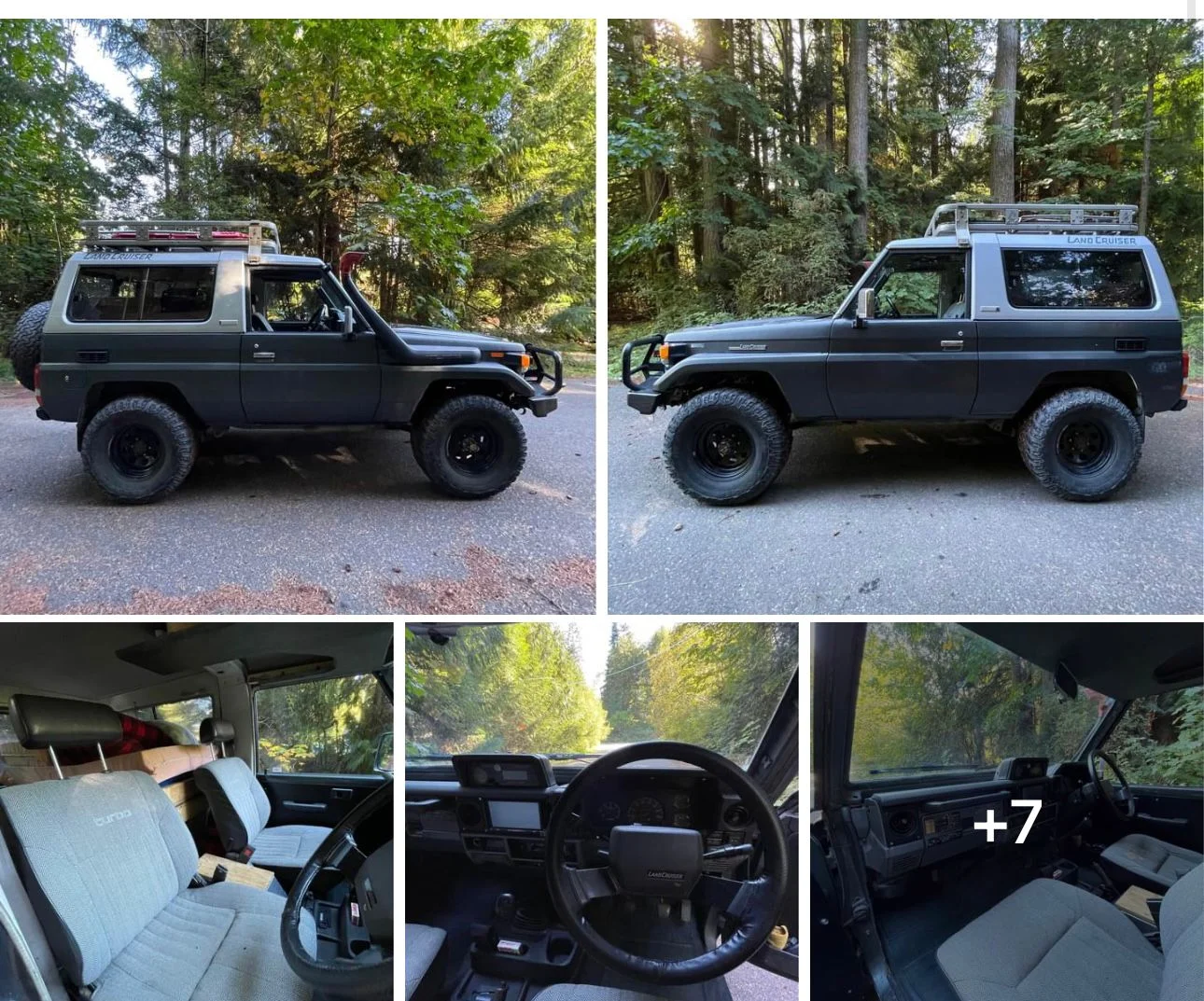

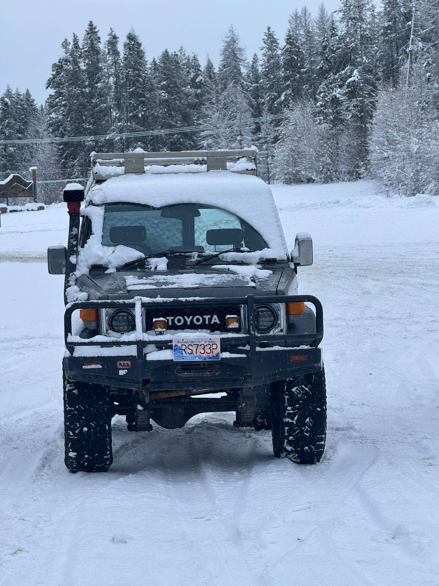

So I bought this truck recently off Vancouver Island, I believe I'm the 3rd owner since import but who knows.. If anyone recognizes it or knows some of the history that would be great, I didn't get as much info as I would have liked. It's a great truck with lots of work already done and fantastic bones, very minimal rust on the body and frame. It's a substantial project for me, and it will likely be a slow go. I owned a 60 for a bunch of years and this is the only vehicle I have ever driven that compares to the amount of "smiles per mile." It's been a while since that old 60's been around but this quickly rekindled my love for cruisers.
PO -1 head gasket blew, scored the piston...typical story on these when the head gasket gives. He ordered a full rebuild and installed new sleeves, bearing, pistons, seals etc. T case was rebuilt as well.
PO-2 reconfigured battery trays, installed 3rd battery, 12v winch, 12v compressor, glued a solar panel on the hood o_O and installed ARB lockers front and rear. Removed rear seats and built a sleeping arrangement.

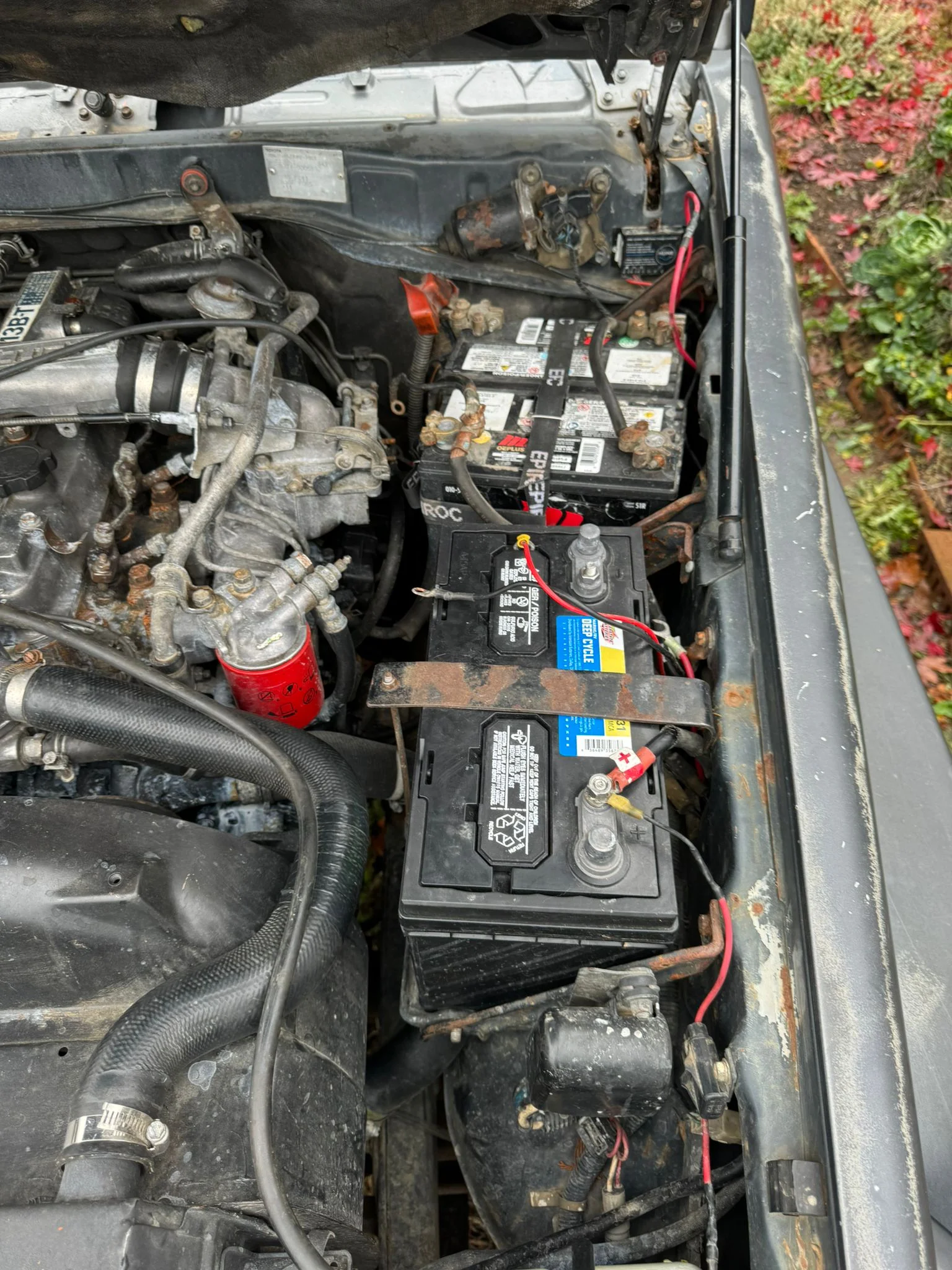

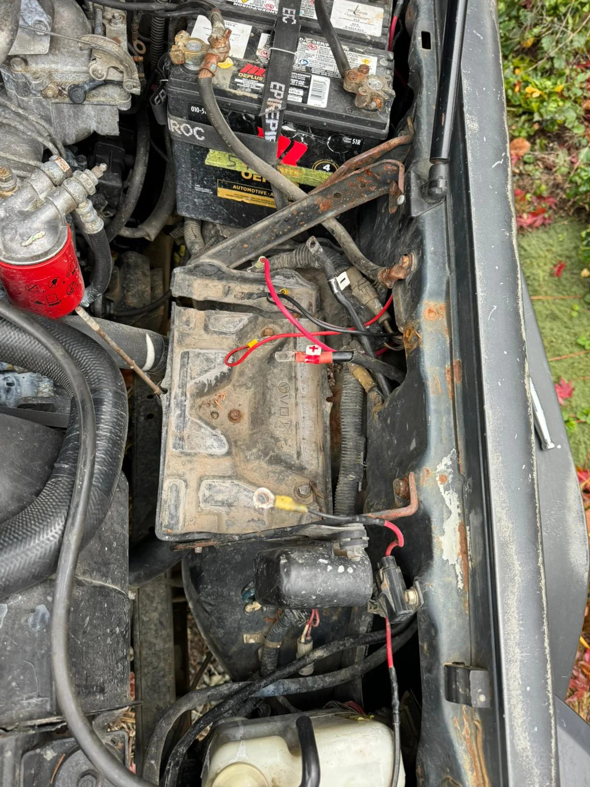

Pulled the batteries and started to chase all the extra wiring. Bit tedious but looks much cleaner now. PO "customized" the battery trays..More parts to track down. Made a few phone calls, front is available from Japan for $$$ shipping, rear is NLA. Anyone?
Was feeling wild, pulled the solar controller, winch and wiring, compressor, wiring and switches and the fog lights wiring, and the ancient inverter from the glovebox, much cleaner now.
Pics of before.

I don't see any fusible links on your batteries? I recommend to check the general fusing. Also the ground wire to the inner fender panel looks a bit dodgy. Yes, there should be a ground in that place, but actually a smaller one. Additionally there should be a heavy duty wire to the engine, in order to pic up the starter amps straight away. Make sure your engine and starter is not grounded via the body. Checking ground wires on the frame is a good idea anyways. Many electric gremlins have their root cause in bad grounds.
Diagrams from e.g. Partsouq.com, amayama.com and from the workshop manual help to understand the to-be setup.

That looks just like the one I saw for sale a few months back in Squam! With the red snork intake
Enjoy it, I'm doing similar things to my BJ74 right now
:beer:
:beer:
Yes probably the same one, I went to Nanaimo to pick it up.
Bad timing with a big relocation right after, but its been a couple years since my old cruiser and I couldn't say no!
Any chance yours has a fuse box cover? I'd love to know what fuses are what 🫠

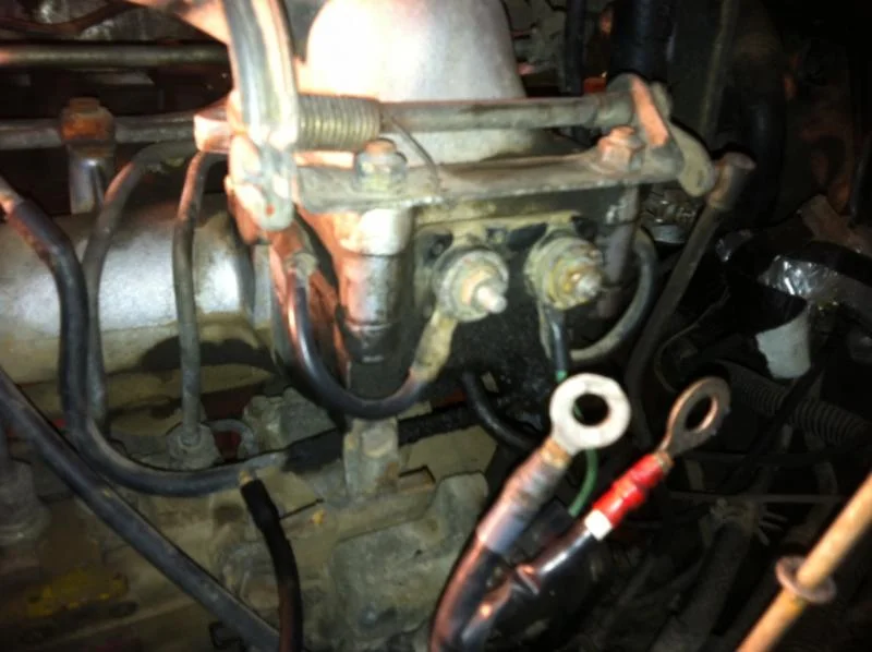

Sharp eye! Some poor grounding for sure, the fusible link is there but in dire need of replacement. I'm working on getting the wiring cleaned up and back to oem/spec. It seems that the PO removed the glow screen connections to reduce battery draw to the undersized batteries, and moved some things around to adapt the 3rd battery.
I think I've found a source for a new fusible link, still trying to figure out the glow screen connection.
I'm trying to chase down a diagram of the connection at the glow screen, this is what mine currently looks like...

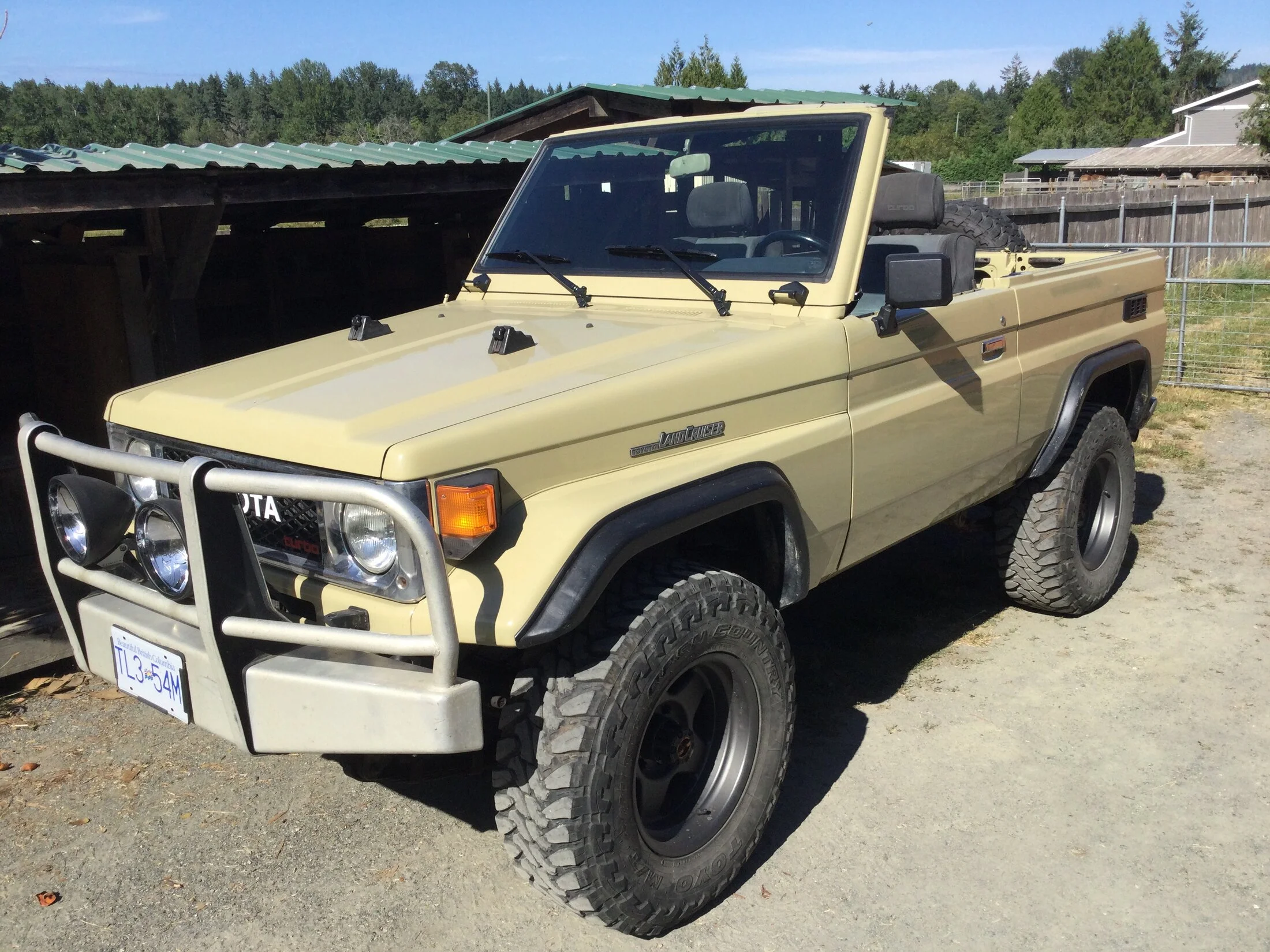

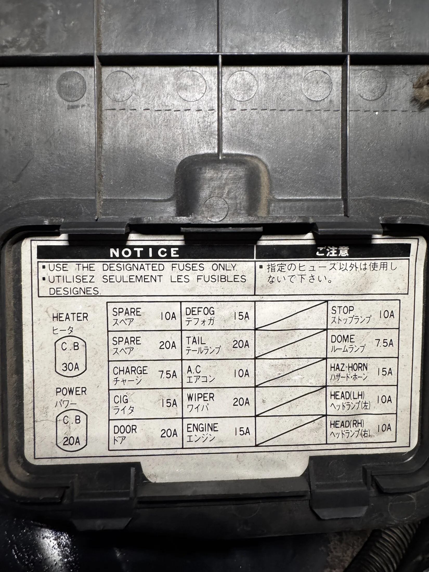

Here's a pic of my fuse cover at the kick panel:
Timing couldn't be too bad ... you ended up with this beauty! Interior looks clean too, is the carpet factory? One thing I'd check sooner than later is underneath the carpet in your floorpans, I've had bad luck with those holding water and rusting - good to catch before it rots out body mounts and rockers
Yea its actually in great shape rust wise, zero rust in the floor pans and usual spots. I'm planning to clean up the interior floor pans and then spray with sound deadener/insulation.
Previous owner just put the carpet in a few months before i bought it, so it hasn't suffered the usual moisture problems. Lots of interior trim pieces missing and a couple unfortunate holes in the dash but nothing that cant be fixed in time.
Thanks @Combat Wombat its a cool old rig, glad to have a fun project again.

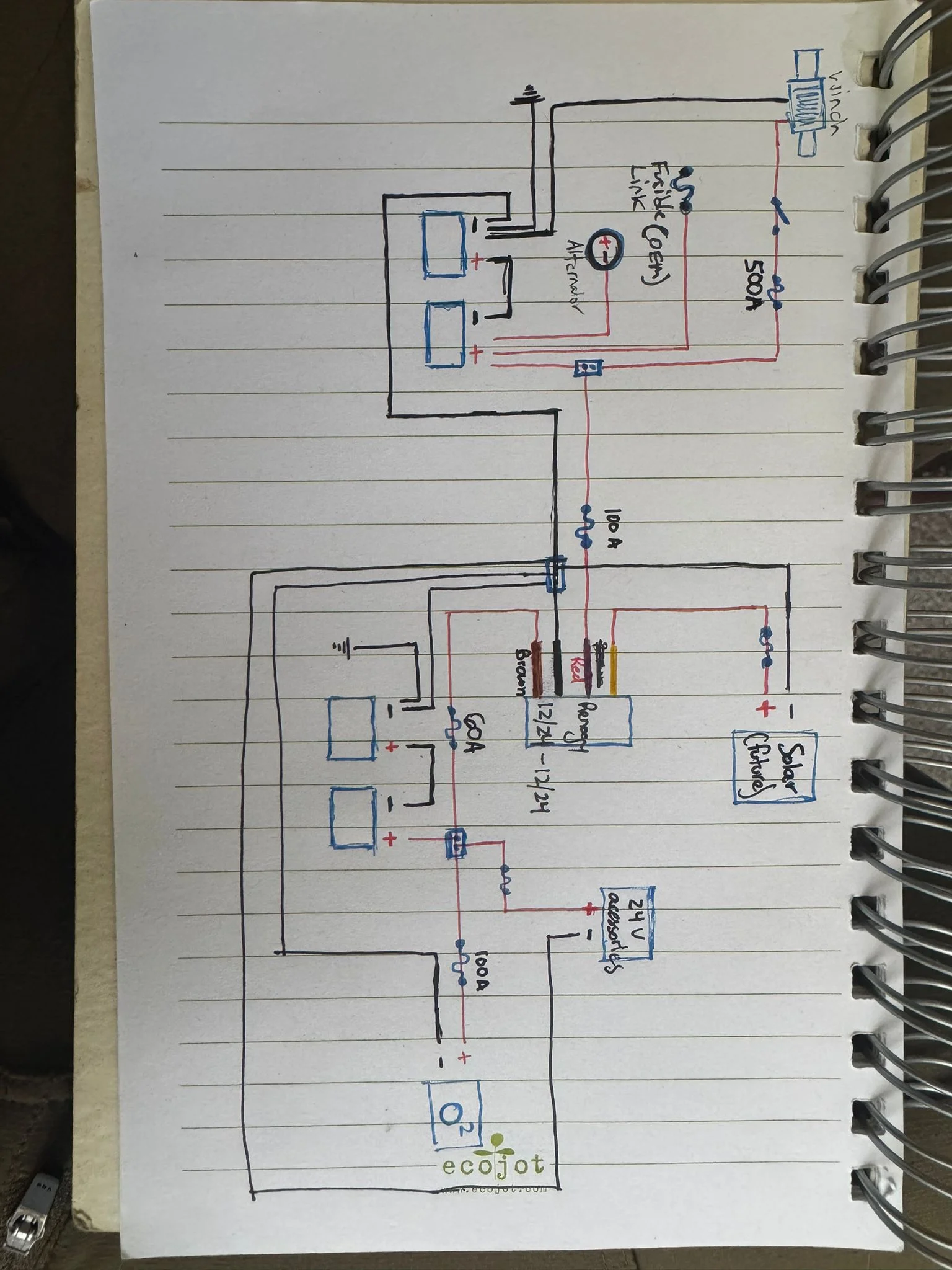

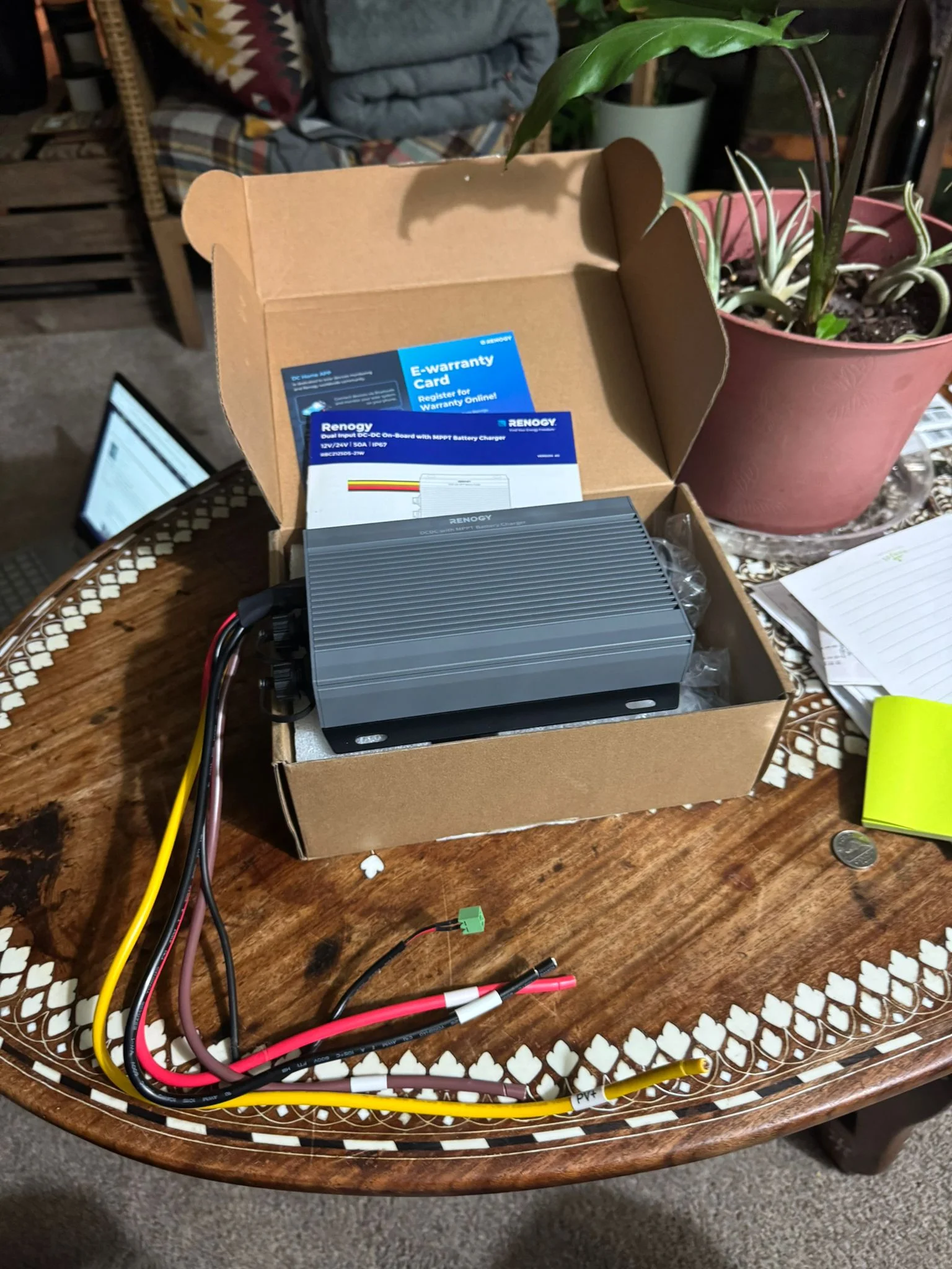

The Renogy DC-DC charger with mppt I ordered finally showed up (damn Canada Post strike)
I decided to gut the existing 12v setup and start fresh with 24v winch and compressor to keep things simple. Time to plan out some wiring layout and figure out materials to order before the new winch and compressor show up from Sherpa.
