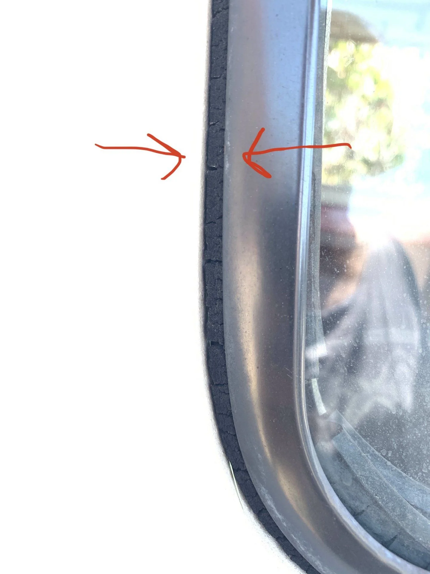

I’ve got this outside weatherstrip (pictured), which, from my research here on Mud, appears to be the part which is no longer available. So I guess this is what I’ll need to find another option for. I’m hoping the stuff @Delancy posted would work as a replacement. Or just do the caulk.

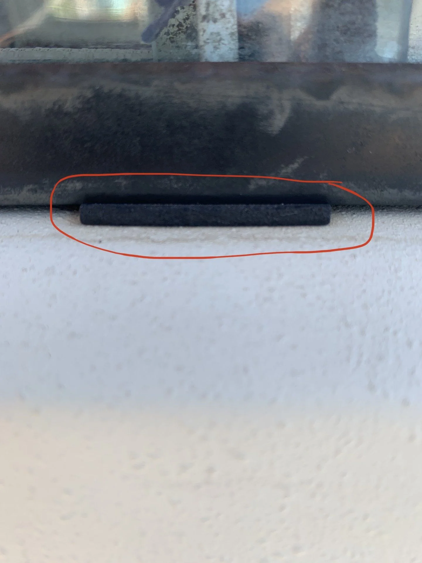

The weatherstrip above stops at the bottom, then I’ve got 3 of these rubber shims which seem to be available still, or easily replicated.
That all seem similar to what everyone else has? This all looks old enough that Id be surprised if it wasnt factory.
Either way, if someone did this recently either with caulk or a replacement for the weatherstrip I’d love to see pics of the finished product.
