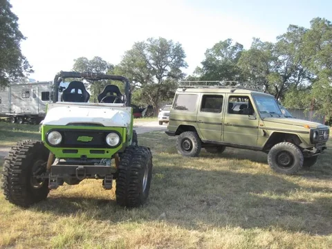

This is the first picture we took before heading out. I think we're missing a truck in that pic.

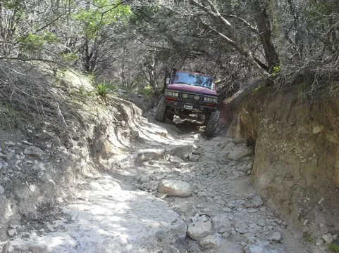

This one is following the pack up a hill, the camera never shows how truly steep the inclines or declines are

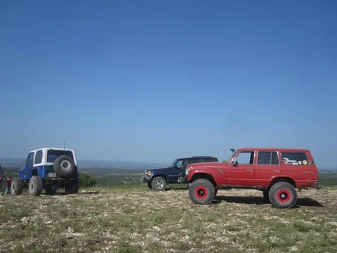

At the top

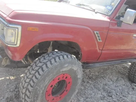

This is the only damage I suffered. The wheel got stuffed in the wheel well pushing it inwards a bit. Nothing that cant be fixed.

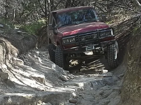

Following Mike's 80 down the trail

love the truck, please paint those bead locks black or?
Thanks. The wheel color didn't quite come out the way i imagined it. It's low on the to do list, but I need to change them. Once everything else gets done I guess.
Edit
Scratch that, boss man said no wasting money on repainting.
