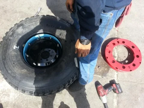

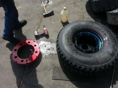

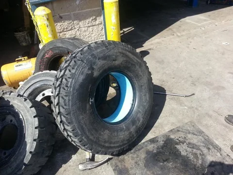

Nothing big, I just took the wheels to get the tires turned 180 degrees so that I can better balance them. Got most to 0 the worst one was 1.25 ounces off. Over all it rides much better on the highway. Now That I have spacers on I'm really paranoid about retightening them. They have however improved handling and turning at higher speeds (wider base). I also wanted to show the PVC inserts that help make these tires a double beadlock tire in case anyone is interested in getting these in the future.

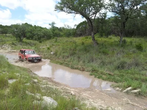

water fun
more fun

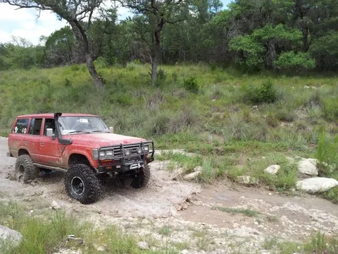

a few more random ones.
here the scenery reminds me of Lebanon. Hills and greenery. I used to wheel with the land rover club back then.
this is right as I started one of the trails.

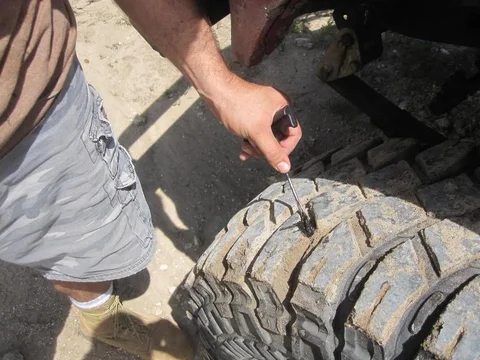

And this is right after the plugged the tire leak and aired it back up. I'm so glad I remembered to grab my fix a flat gear from the shed before heading out this morning.

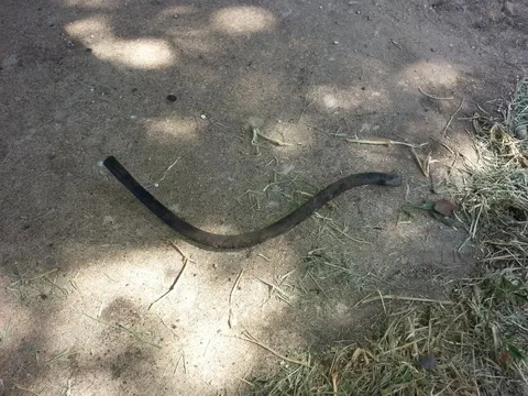

found the rear breather hose detached this afternoon. Ended up replacing it with a 3 ft hose just so it doesn't come off when the rear flexes again. The rear valve on it is one way, which makes me wonder how does air get back in when the temps cool? Anyway now I suspect that I might have some water in the rear diff, but not too overly concerned about it since it's the one that moves constantly and I'll be replacing it with the 3.7 once I get the money lined up.

I found this breather hose detached from the axle nipple
ended up buying a 3ft hose and replacing it, now it looks like this

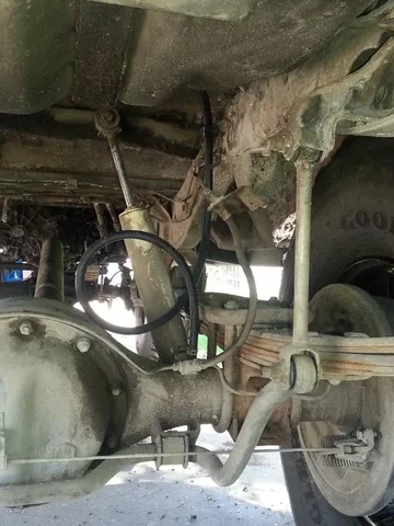

now I'm thinking maybe my rear brake hose also needs lengthening.
Looks like you needed an extended brakeline before you took that clip off the frame!
Get a longer line on there and make sure the hardline is still in good shape, no kinks :D
Thanks TallCanDan. I'm gonna see if I get a longer one just in case. The rear travels quite a bit and I'd rather have too much than too little.
GLTHFJ60, There isn't a kink per say in it, but it does bend downwards. I'm hoping it will last a couple more weeks before I tackle it. Got a couple of deadlines on other stuff that's coming up.

ok now I'm obsessing over this brake line hose. The longest hose I was able to find was this from Man-a-fre.
http://www.man-a-fre.com/parts_accessories/StainlessSteelBraidedDOTBrakeLines.htm
I think it's the same one that TallCanDan has. Any ideas on where to get longer ones? If I can't find one I'll just have to use a bracket to secure the hard line and use the Man-a-fre one. I like the video where you add two OEM ones together, but my paranoia is telling me that it's only one more place it can leak from. Open to ideas and suggestions.

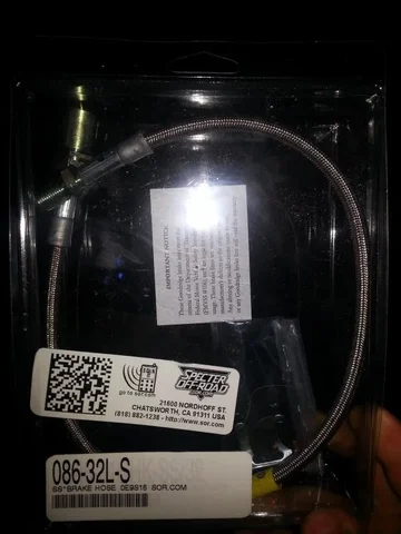

Look what I got in the mail today!

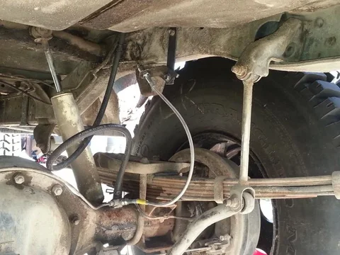

Had a bracket put in to keep the metal brake line from flexing and installed the new brake hose from SOR.Here's a before and after, the picture doesn't do it much justice, but the new hose is a few inches longer
Before
After
