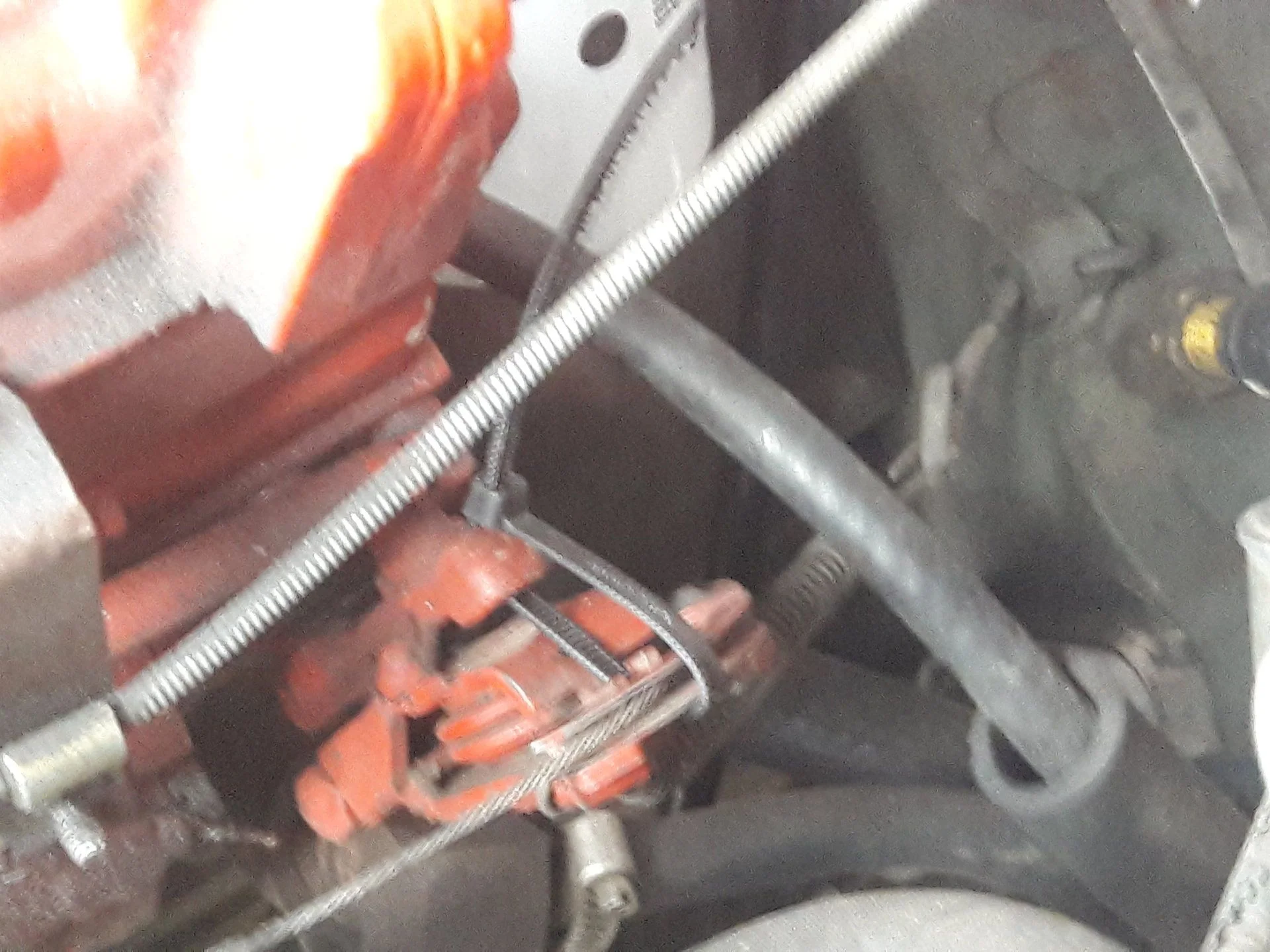

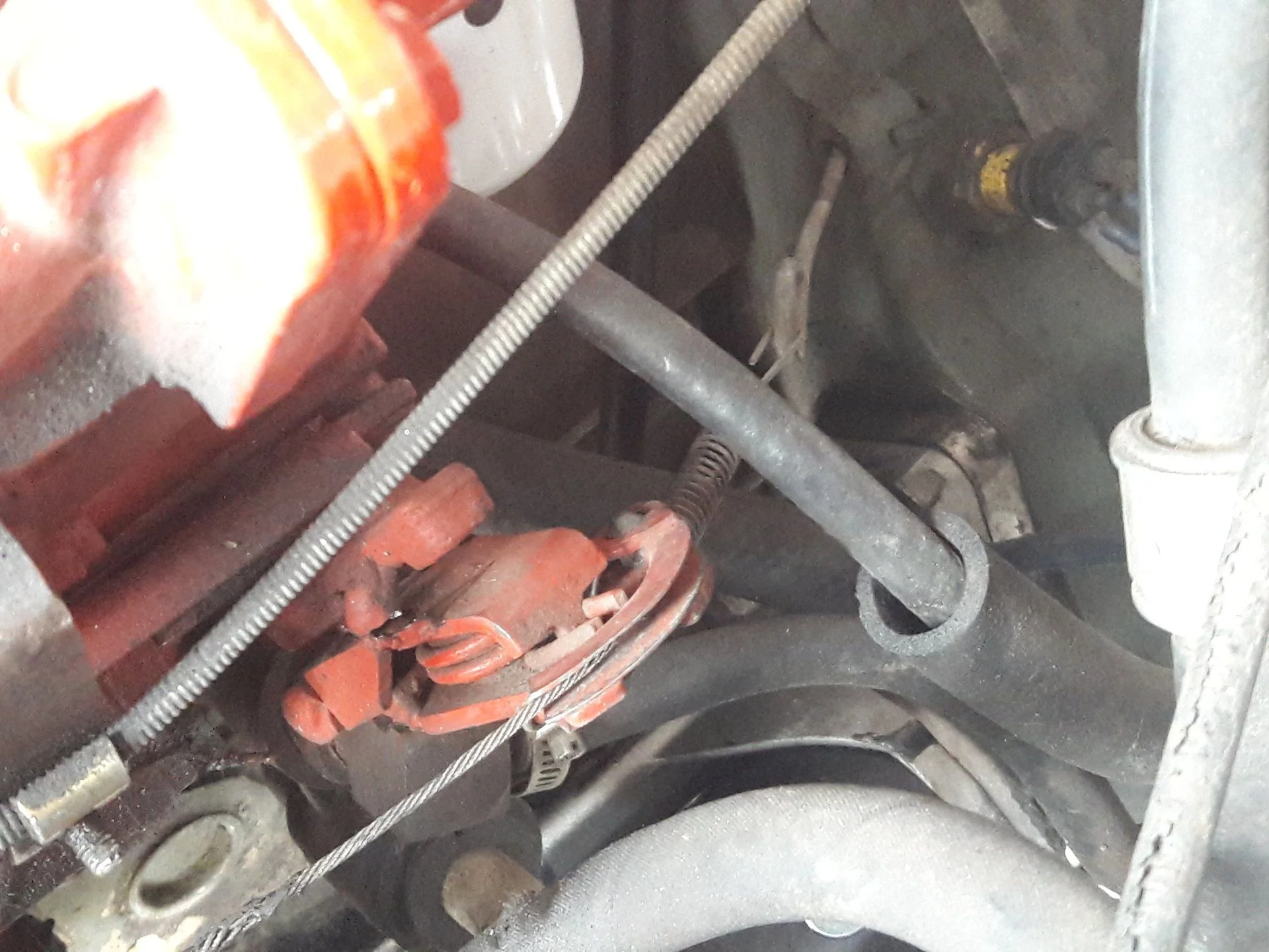

The drive was great, doing 75mph with a gear loaded trailer and some firewood. Was averaging 20 psi and 1050* for EGT. About an hour and a half into the trip I lost all power while in the left hand side on the highway. I managed top safely pull over and realized the fuel pedal wasn't giving it any diesel.
I had this issue a few years ago and thought I fixed it by getting it welded. Looks like the weld broke, but luckily I had zip ties. I was down for maybe ten minutes.
It's not a permanent fix but it got USD three and back.

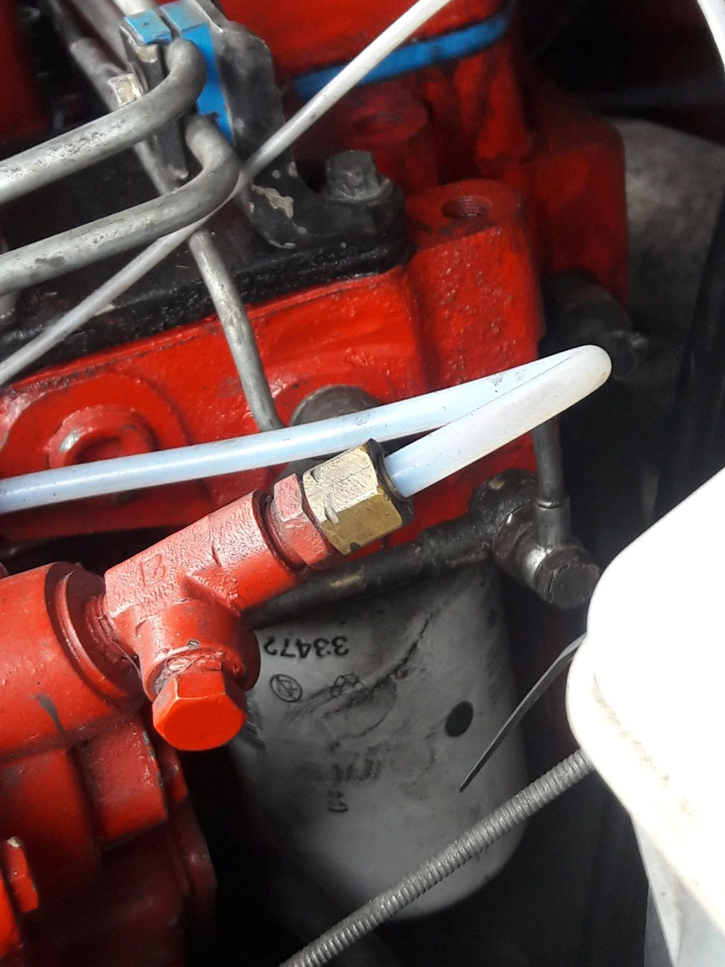

Is the fuel filter leaking at the plastic drain? I switched to a manual drain that is part of the filter itself. Wix 33391
I’ve never used the 33472 filter but when I looked up leaking last year it seems to be a common problem and found the manual drain replacement.

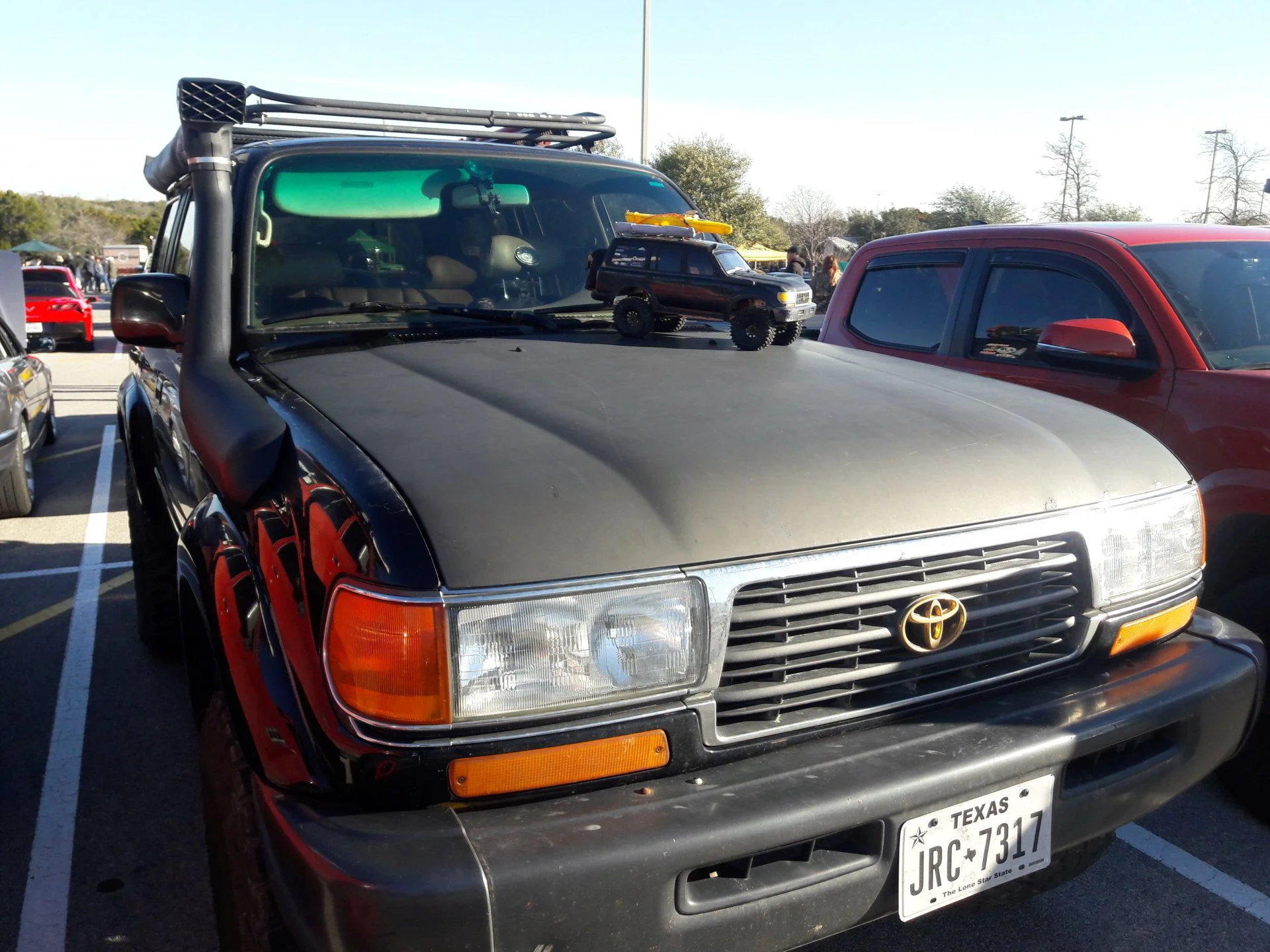

When I pulled into the parking lot I noticed a lot of smoke and soot. Looks like the small turbo exhaust is leaking and not getting the big turbo to boost. I still drove home doing 70mph with 10psi at 900 degrees. It's almost like it works just as well with a single turbo.
