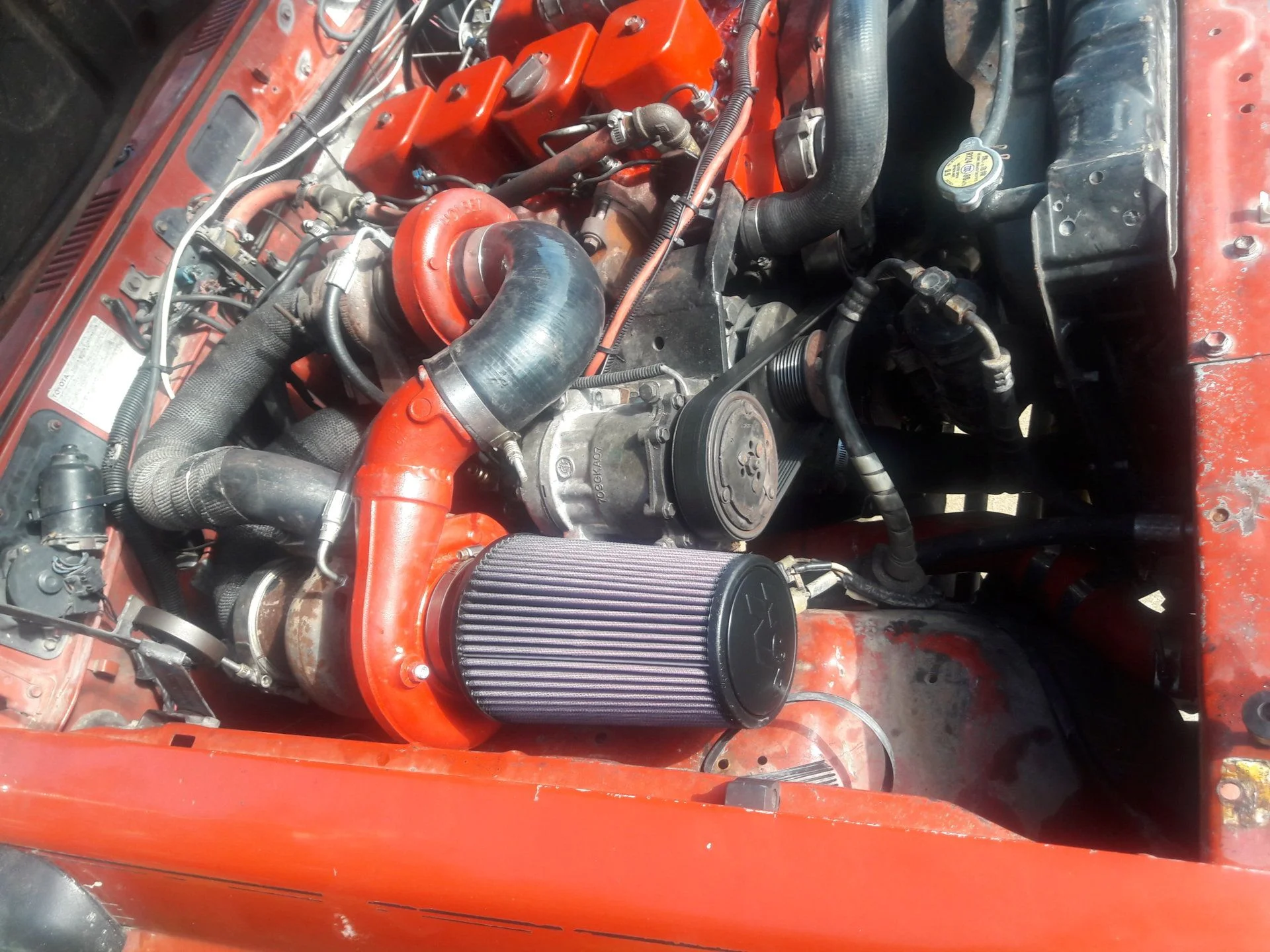

Looks great. Good time to change out the old fuel overflow/pressure valve with the bad off. Nice and easy to get to.
I bet your airfilter is too small. I see higher EGTs when my airfilter is clogged (too restrictive), aka it can't pull as much air through. Would be the same issue if the airfilter is too small to begin with.
Johnny, where have you been hiding all this time? I suspect fixing the EGT issues will be a long journey.

Going with Johnny's comment. Did you run it with a new cone filter or your old airbox?
The fire was really black smoke, making me think it was diesel, but who knows I could be wrong.
I tested it with the air box but will be removing the box and installing a much larger air filter before taking it home. I haven't driven it in the last 6 months except for an hour last weekend, so I'll be getting used to it again and making many adjustments.

Right now the plan is to not maximize the boost the compound set up can produce, but to have it as reliable and powerful with acceptable EGTs as possible. I assume there will be a long period of trial and error to find that happy medium. Right now it seems like she will be smoking a little more than before. Pictures will follow tomorrow.

Black smoke = unburnt fuel = hot EGTs. Focus on that pump tuning to get rid of (most of) the black smoke and your EGTs should go down as well.
