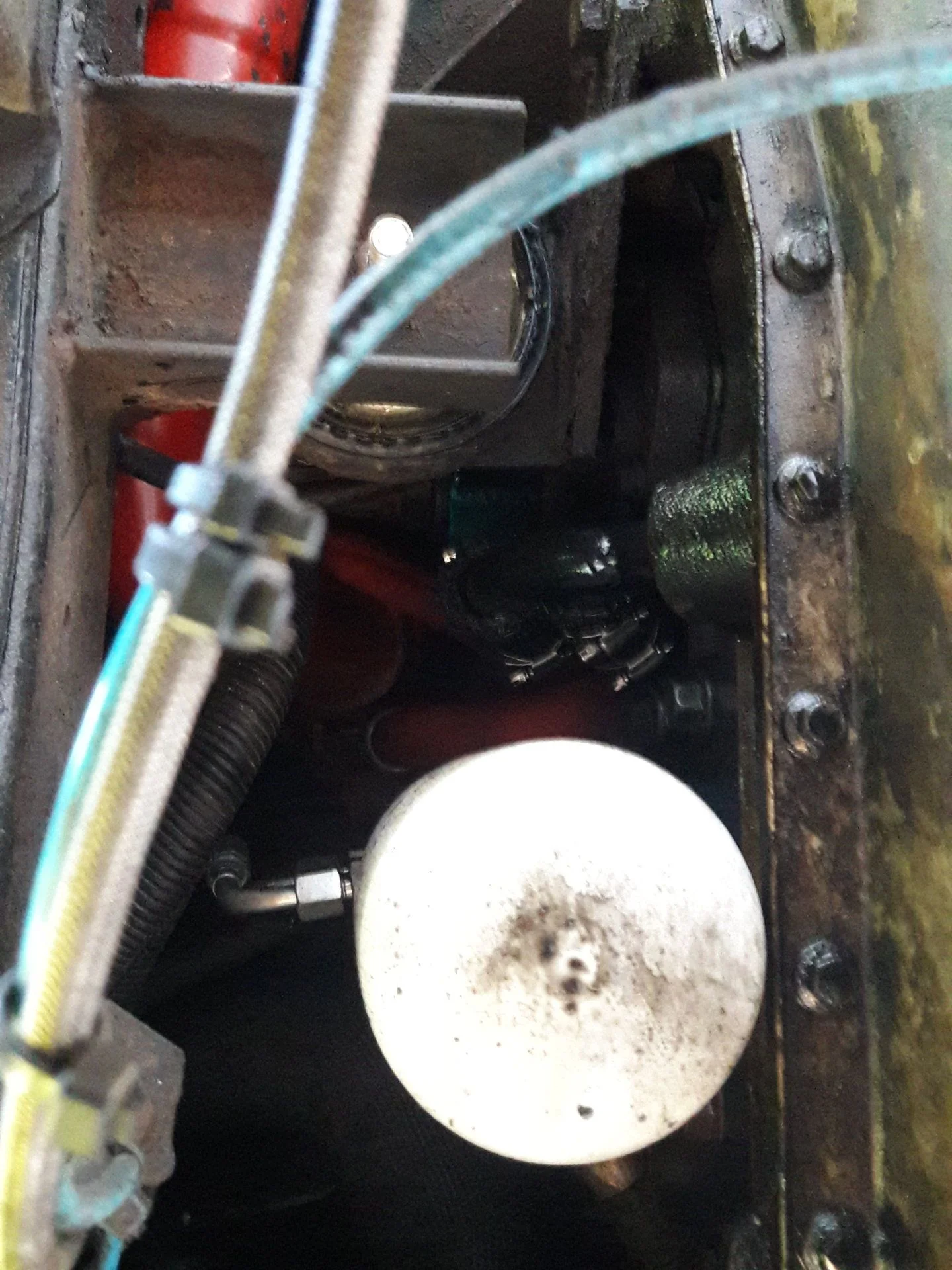

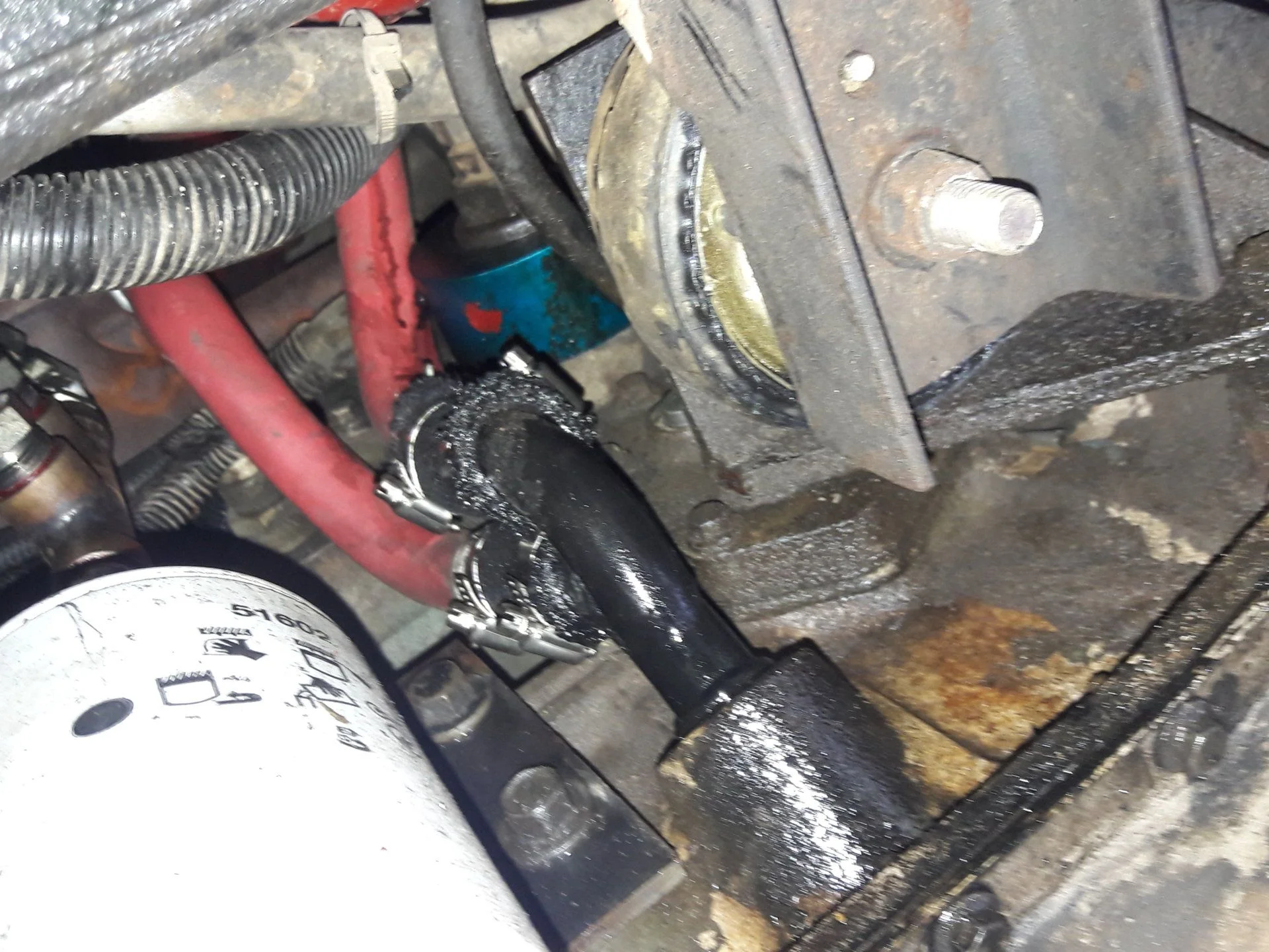

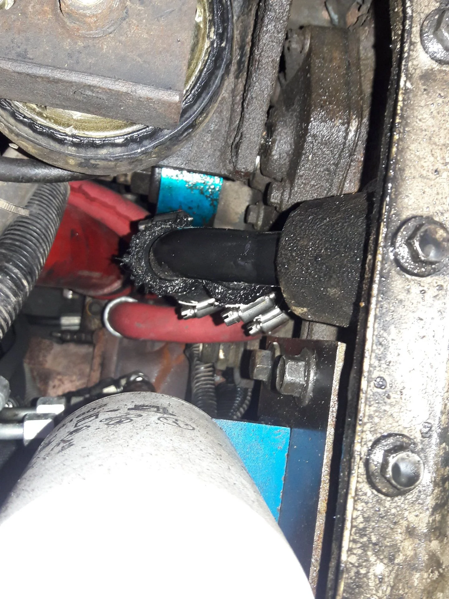

Been concerned with some electrical issues and this oil leak. The starter did not immediately engage today, but eventually worked. The pyro is erratic, but eventually settles down. I'm curious to see what the mpg is. I'll be happy if it remains the same around 18mpg with mixed driving.
Here's where i found the leaks to be coming from. Will work on it tomorrow.

It does look like your main leak is coming from the oil adapter. That seems the most juicy. If I'm seeing it right the small turbo drain looks dry but the large turbo drain does look to have a small streak coming down. Was the oil adapter that goes on the block removed during the turbo fab process? Is something leaking on the top and it's traveling around to the bottom of that adapter?
The oil filter was removed or still in its original position on the fender when the pipes were fabbed. I'm going to try to work on it after i get off work. Hopefully it's an easy fix. I need to track where the smoke is coming out and into the cab as well.

I guess it's update time. I didn't do much other than tightening the oil line clamps and sealing the firewall with foam. No more smoke in the cab :).

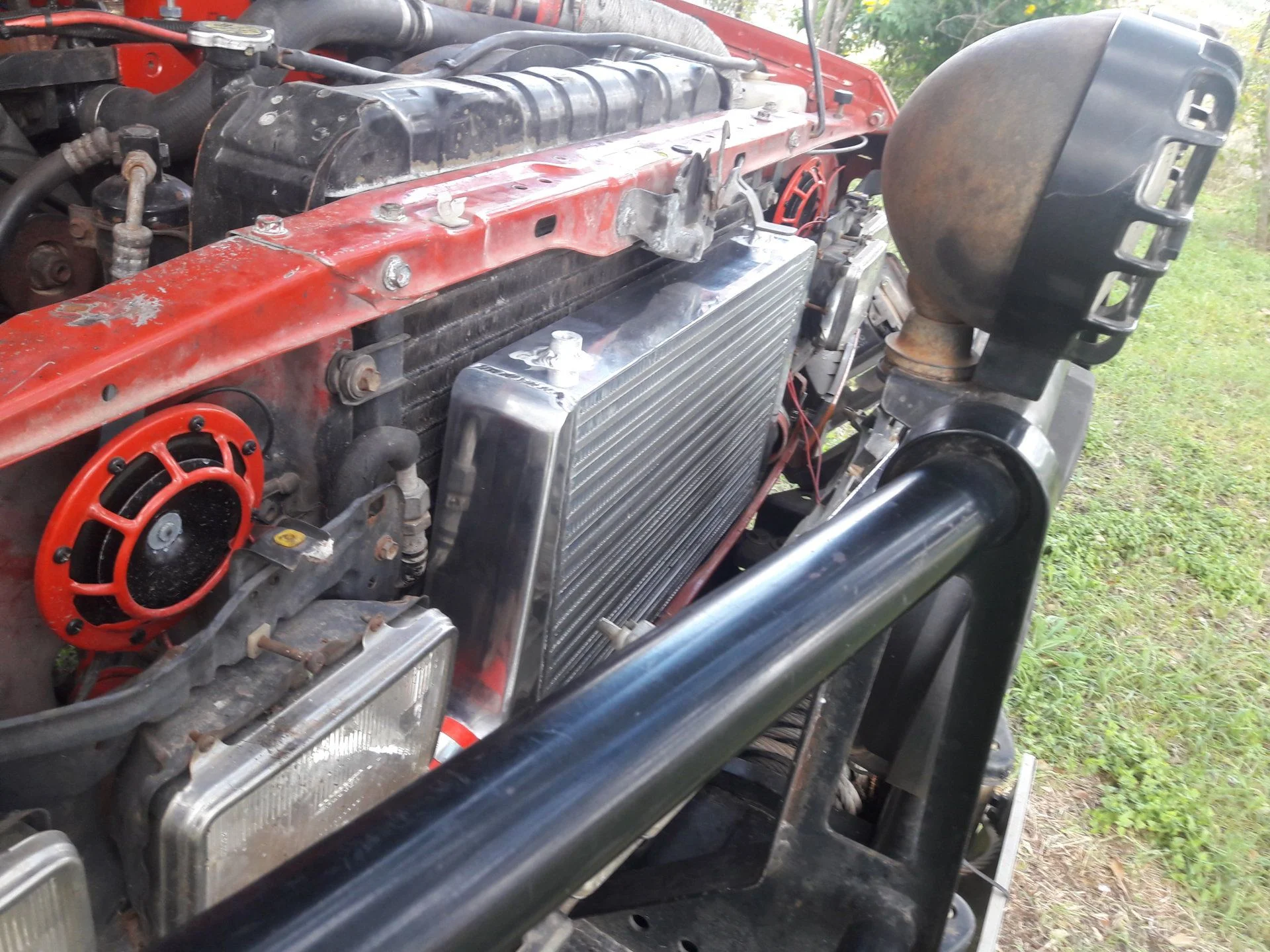

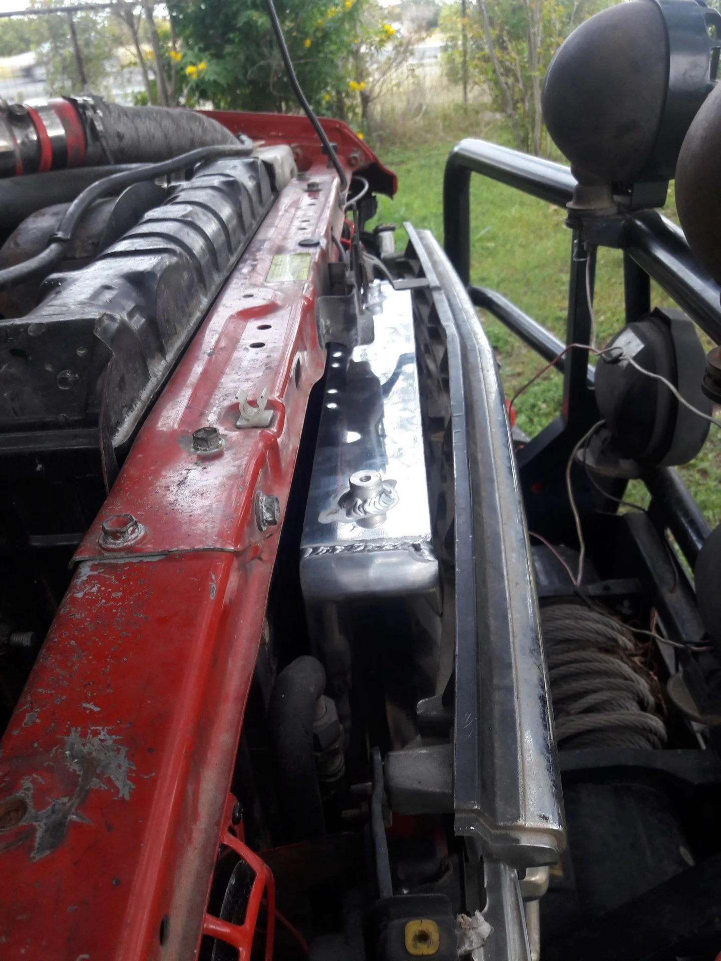

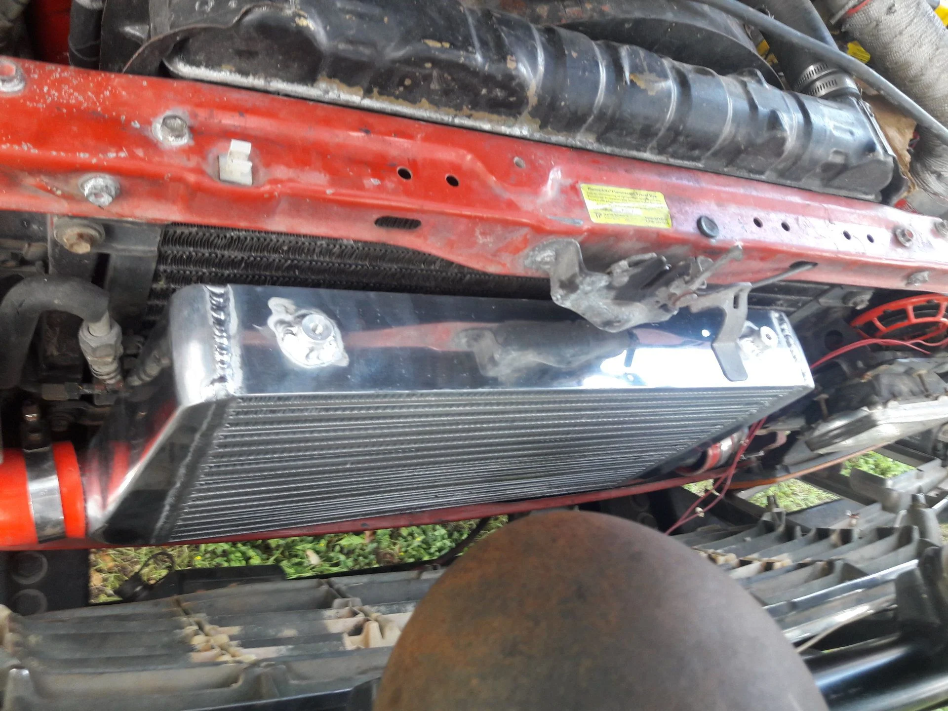

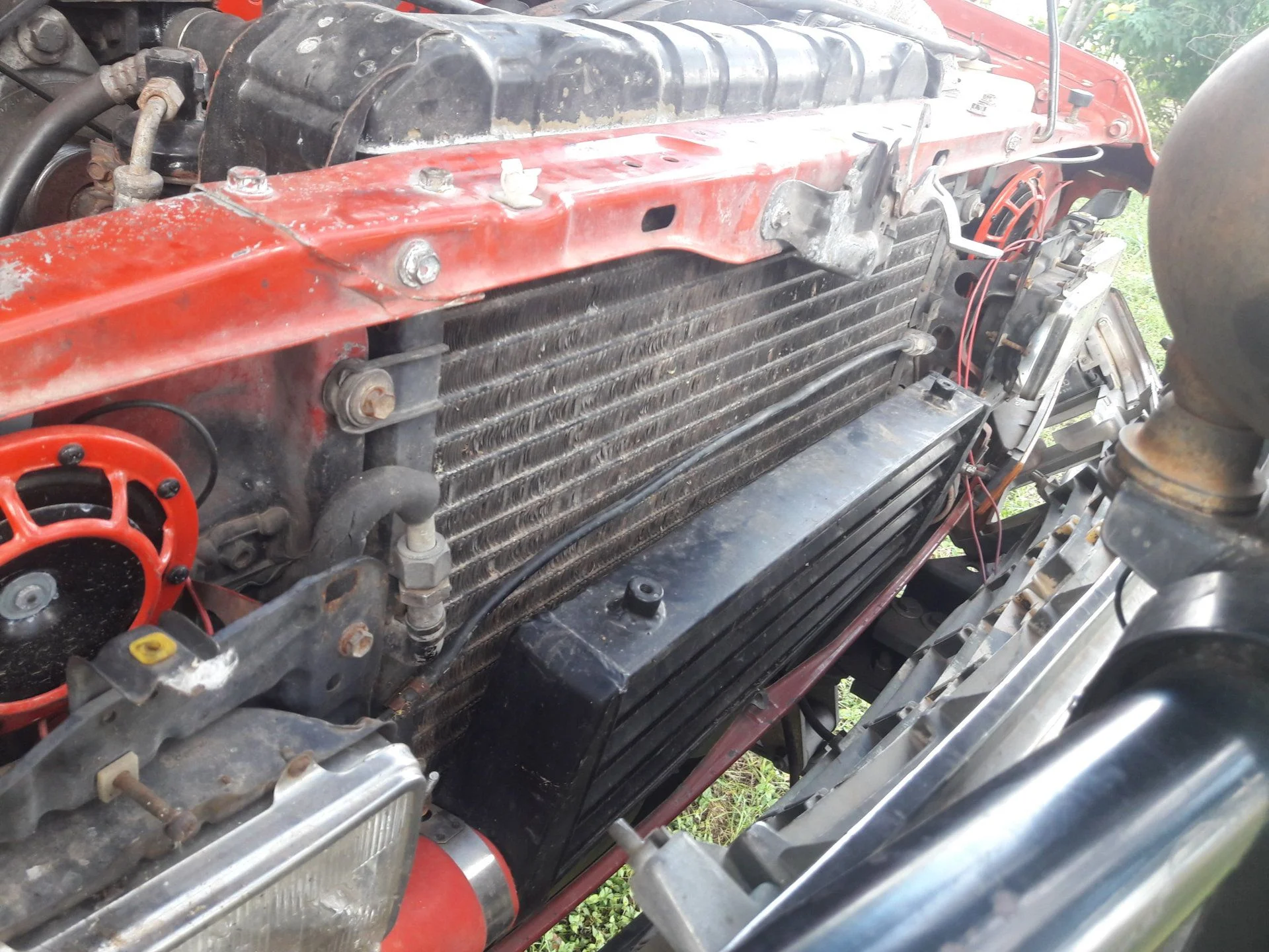

Mounted the new intercooler. Very snug fit, but it fits.
Ended up blowing a boot at 25psi. Had to delete the methanol injection pump and change out a few bends to make it fit and work. Tomorrow i hope to change out the starter.

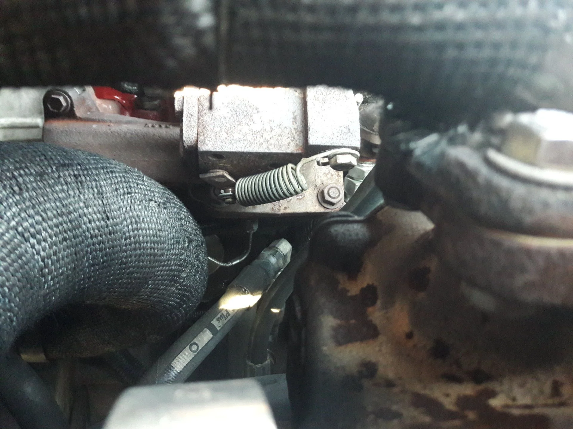

I think it's safe to say my wastegate opens at around 30psi. I can get there quickly, but then it's labor-intensive to go higher and maintain anything above 35psi. I think eventually I will weld it shut. Right now I'm trying to see if the couplers will hold that kind of pressure. On my test run, there was this older lady (60s) driving a pick up with her dog give me the eye then the thumbs up. So I guess I'm doing something right :)?

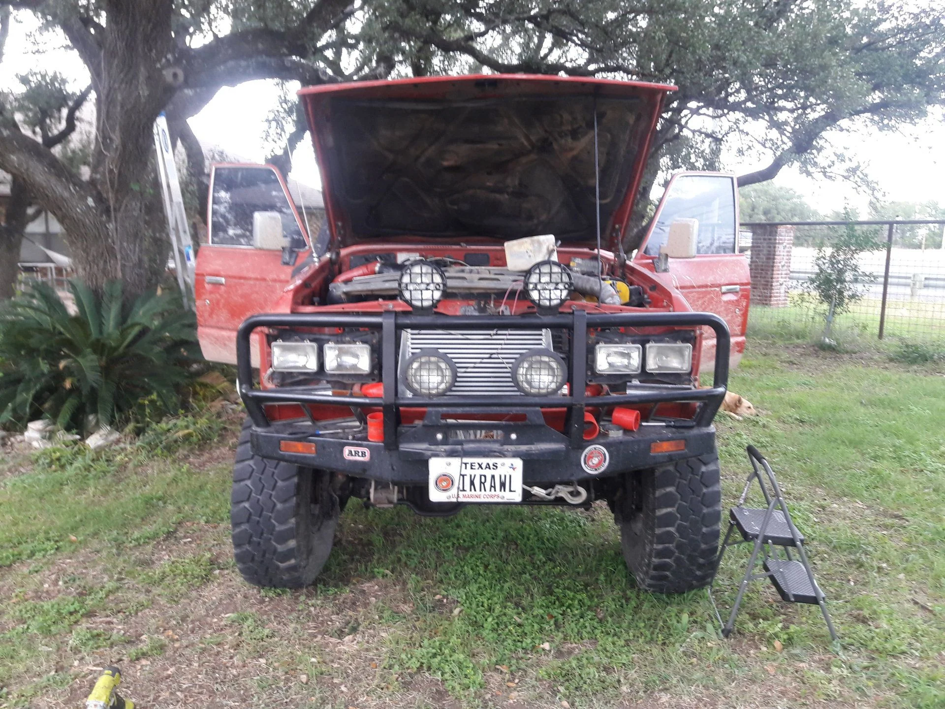

Here's what it looks like from the front with the new intercooler. It's not exactly centered, but that's the only way it will fit flush.
EDIT: After driving it for a while I guess I can say the intercooler works. On one end you can fry an egg because how hot it is, but on the other end, it's really cool to the touch.

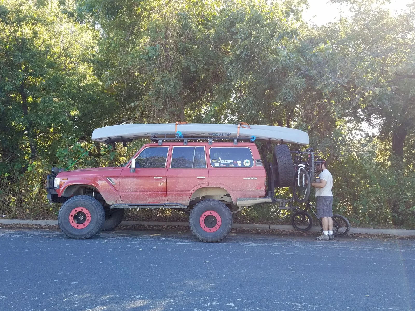

Larger intercooler seems to be working well. Cruised the highway at 75mph loaded with my kayak and 3 bicycles, EGTs we're between 880 and 950. At one point I decided to floor the pedal, managed to get above 45 psi and you can really hear the turbo whine, but i had to back off as the EGTs hit 1400.

Your small turbo looks like it is barely doing any work and your big turbo may be close to just making hot air. You need to get the wastegate on the small turbo to open later or in other words keep its wastegate shut longer. You can do this a couple of ways.
1. Tighten the wastegate rod so that there's more tension on the internal spring in the wastegate diaphragm.
2. Add an additional outside spring to add more tension.
3. Insert a boost fooler (boost control valve) to the boost line that runs from your small turbo to your small turbo's wastegate diaphragm.
I have done and am currently running all three of these things together to get the small turbo to keep it's wastegate shut longer. This will have a couple of benefits of faster spool up, cooler egts, and better sharing of the boosting load between the two turbos which will cool off the intake air temp. Do this in steps and watch your gauges so you don't make too much total boost. You can work the above formula's to find out your tuning results. There is a lot more potential in your set up.
Wow, Thanks for doing the math. I thought it was the larger turbo that's not being used efficiently.
I need to figure out a way to keep it shut, now that I have a baseline for how the truck runs. Maybe make a bracket that holds it in place. It's crazy that it's not even making 3 psi.
