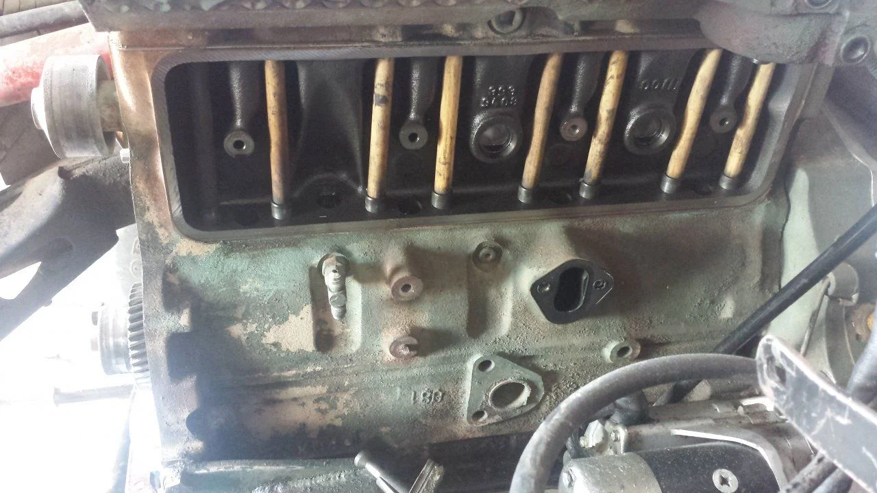

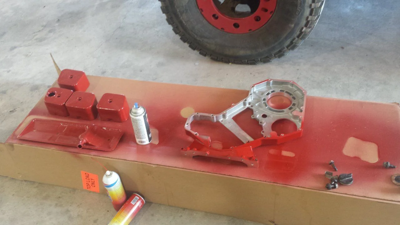

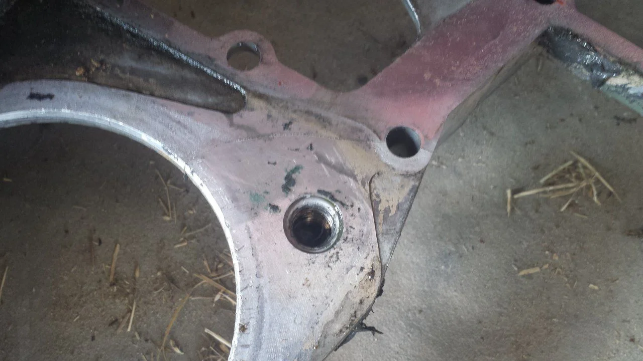

I just came back from checking up on Big Red. The parts came in and are being painted. You can also see the crack in the old housing cover. The guy working on it said my pump was retarded a few degrees , that explains my high EGTs. Once everything is buttoned back up he's going to advance the timing and play around with the fueling from there. Anyway here are some pics for now.
This is the old housing, if you look at the bolt hole closely you'll notice a hairline crack where the oil was leaking from.
New paint on some old and new parts.
What it looks like with the tappet cover removed.

Did you ever figure out what caused this crack to begin with? Is the brace in the back of the injection pump there?
I'm not sure on the timing part, but I think what broke the housing was the vibration and the weight of the attachments on it. It did have the injection brace, but from what I can tell it wasn't actually bolted to the block. The oil leak started slowly after Round UP and got progressively worse, so it must have cracked while I was off roading.
