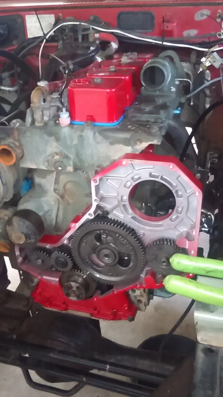

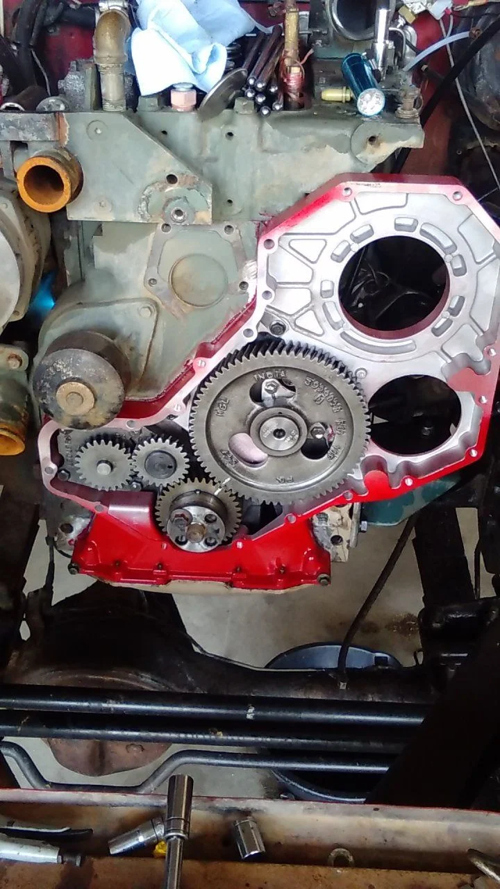

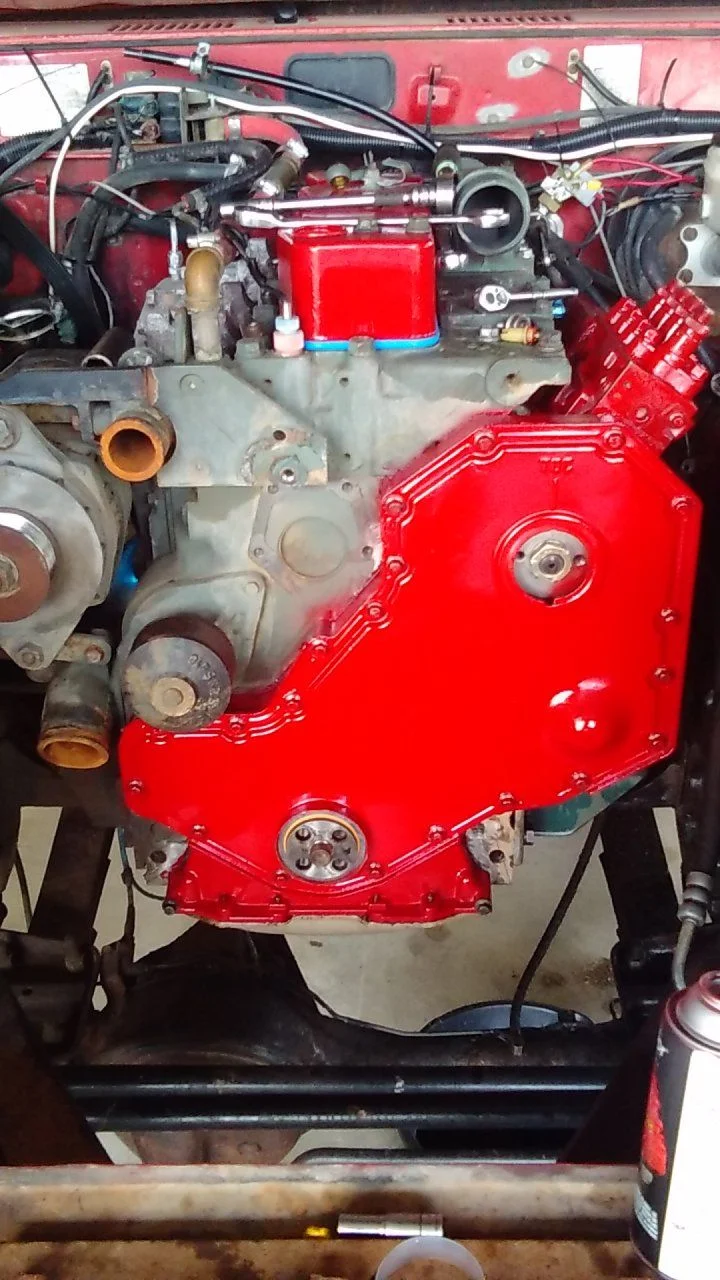

The engine pics are slowly trickling in. I'm realizing more and more that my American engine has some of its core components made in countries not exactly known for their high quality workmanship. The red color is growing on me, I should have had the oil pan painted when I had it off. Anyway here are some pics.
The housing is back on.
The KDP is secure
And the tappet cover is back on.
The cam shaft is back in. Needs some buttoning back up and fluids. Thinking of installing some Industrial Injectors down the line. These engines can produce between 160 and 200 ponies depending on how they are tuned. The stock 130 hp isn't bad but with all the armor and extra weight, it wouldn't hurt to go for more. Of course this is budget and EGT dependent.

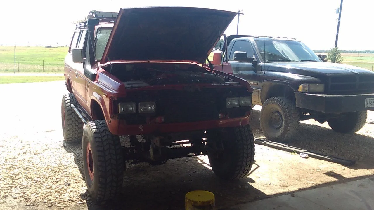

So the pics are slowly trickling in. Needs the radiator and wiring to be done.
I really need to start saving to paint the body.
Just got off the phone with the mechanic. He set the timing back to stock, says it drives a lot stronger now. Will be ready for pick up sometime this weekend. We have to order a bracket for the injection pump to bolt to the block. The one that's on there doesn't fit it properly. There is an abandoned gravel pit near his shop so hopefully this weekend I'll get to wheel it a bit :bounce2::bounce:.
Sweet!!
I bet that wrong bracket on the back of the injection pump caused the cracked timing housing. Better get that bracket on and adjusted properly before driving.
