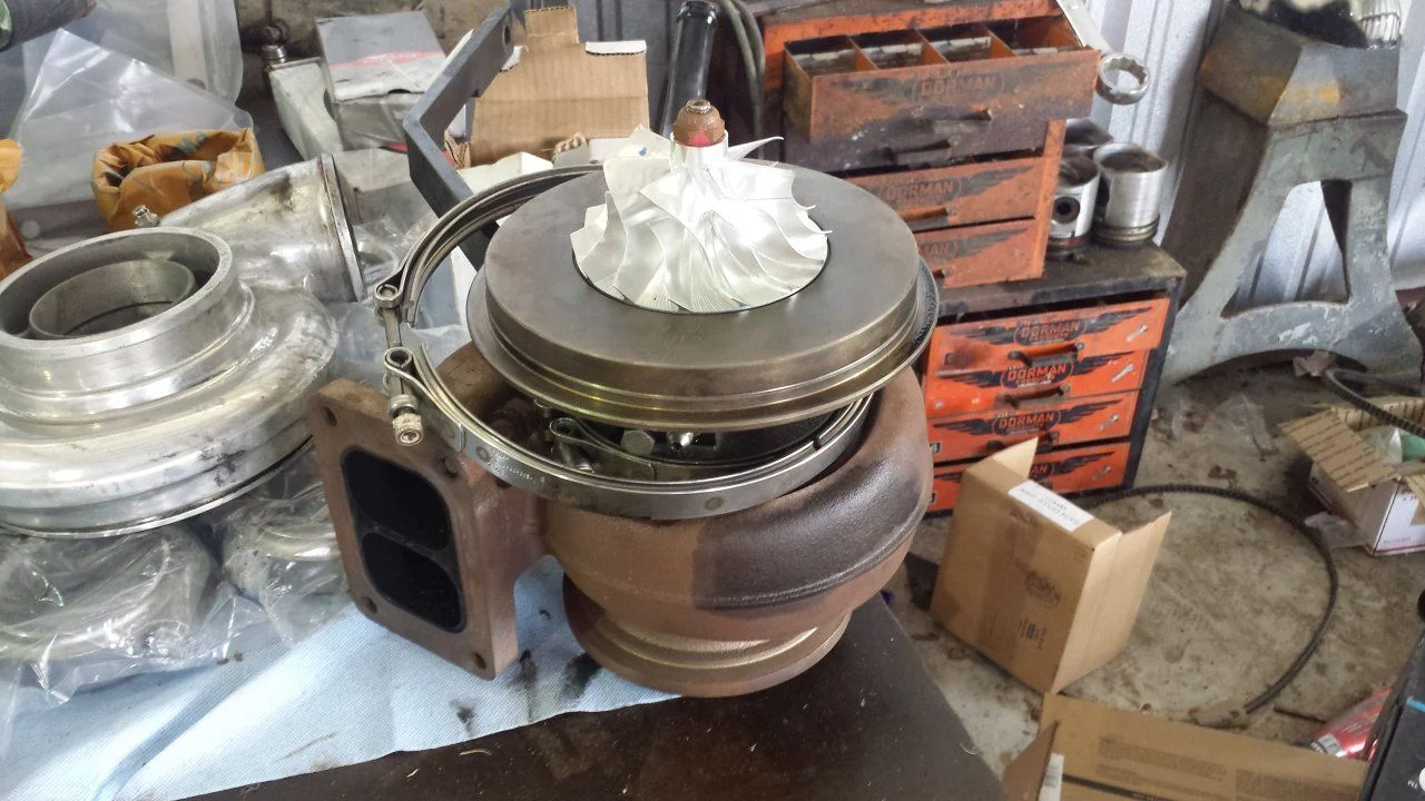

I pick it up this evening. I swung by to see the progress. It was in the middle of getting an oil change. Discussed possible ways to get more power out of the 4bt. Then I saw this big turbo that's going on a 6.7 Cummins that's reportedly producing nearly 875hp at the rear wheel.
I should have had a Coke can or something for scale.

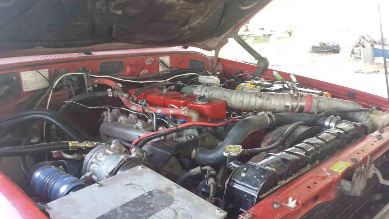

and here's what Big Red's heart currently looks like.
We discussed eventually getting a larger billet turbine for the cool side of the turbo. But if that happens it's months down the line. Will be licking my wounds for a while from this housing repair.

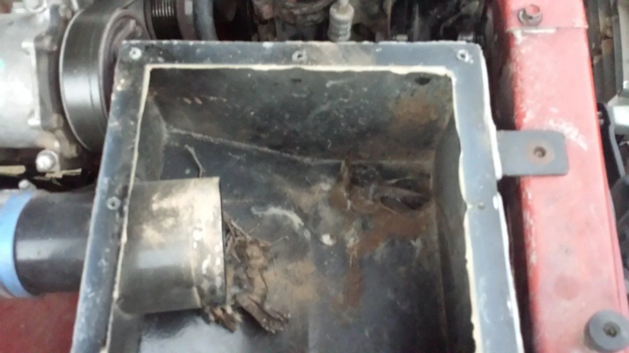

So I brought Big Red home because it was gonna be another week before the brackets show up. Runs strong, but had to turn the fuel pump down about half way, because I can hit 1400 in 3 seconds with about 27 psi. The power steering pump was rebuilt twice by me and once by the mechanic, it's still leaking. So i guess I'll be getting a new one soon. The brackets are being shipped so won't be driving it until they get installed. I decided to drive it with the air box open to see if I can get more air in there. This is what i found.
Yup that's two dead birds in there. They had built a nest in the filter. I forgot to take a picture of the nest before I removed the filter. Not sure how long they have been in there. It must have either been when I was in Thailand or in Virginia this year, because I was regularly driving Big Red. Anyway, removing them should help out with my air flow . I just think it's crazy that two birds got in the small openings of the snorkel and made a home for a while.

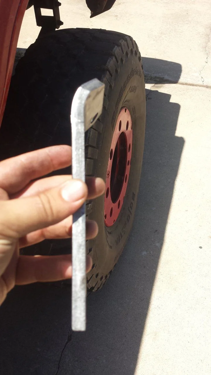

This ridiculously beefy bracket showed up. It better fit, but if it doesn't I'll drill it until it does.

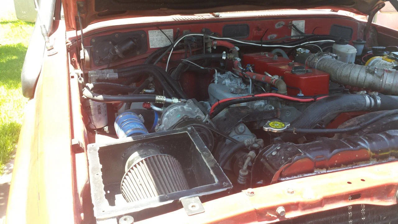

I also did a poor man's alignment while I was messing with the truck. I decided to try driving it with the airbox cover off to see if there's an air flow issue.
I managed to get to 30 psi in 3rd. This whole time I've been starving the engine of oxygen :bang:.

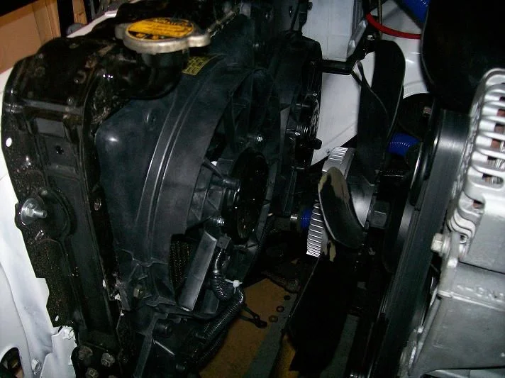

Mike, not sure if the Ford Contour electric fans fits your setup... I am going mechanical fan on my vortec and pulled of the contour dual fans
contour-jpg.202415
It would be really tight if I put this in as a pusher because of the inter cooler. Initial plan is to put this in the shroud as a puller. Just need it for when the AC is on.
