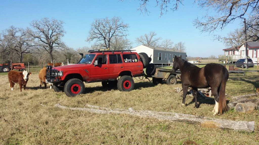

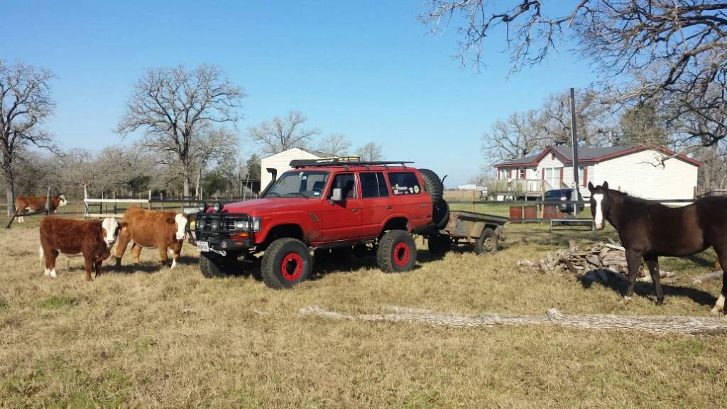

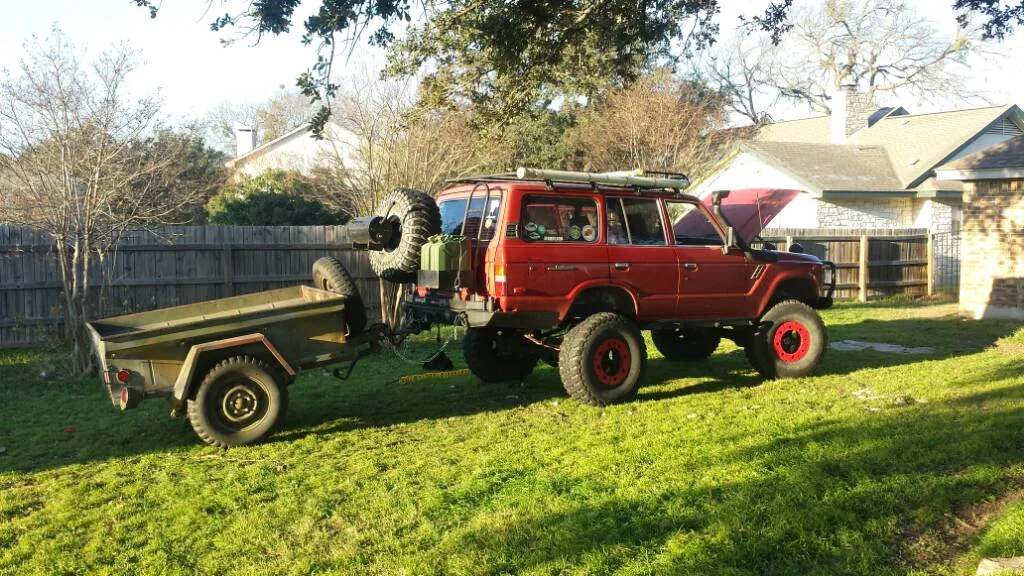

A friend of mine said I could have an entire pallet of wood if I can haul it off her property. She lives way out in the country and has about 25 acres of woodland.
Not being one to turn down a free source of heat, I accepted her offer. I hooked up the trailer to big red and aired up the tires.
My drive there was easy, mostly 5th gear at 70mph. After a few detours I ended up in a field with this beauty.
Soon her friends came closer for some attention.
I loaded as much as I could, played with the animals then headed out.
Here's what I brought home. There's at least half of that still to be picked up. Might go next weekend.
On the way back the rig handled great. Shifted Between 4th and 5th gear a lot depending on incline and my average speed was around 65mph.
Now I want to build up that trailer. Make it SOA and able to hold a RTT.

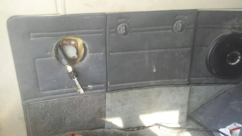

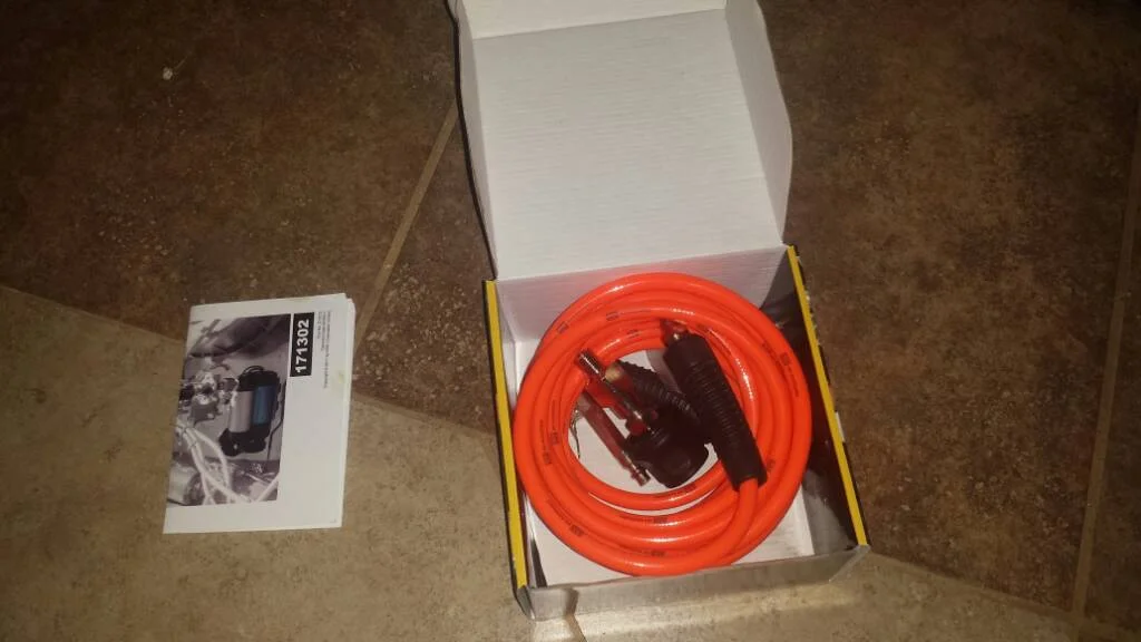

This showed up, can't wait to install it.
I'm already thinking this needs a longer hose, we'll see.
I bought a light weight slim hose at Harbor Freight for next to nothing with a coupon. Hasn't failed me yet and is the perfect length to get to all four tires.

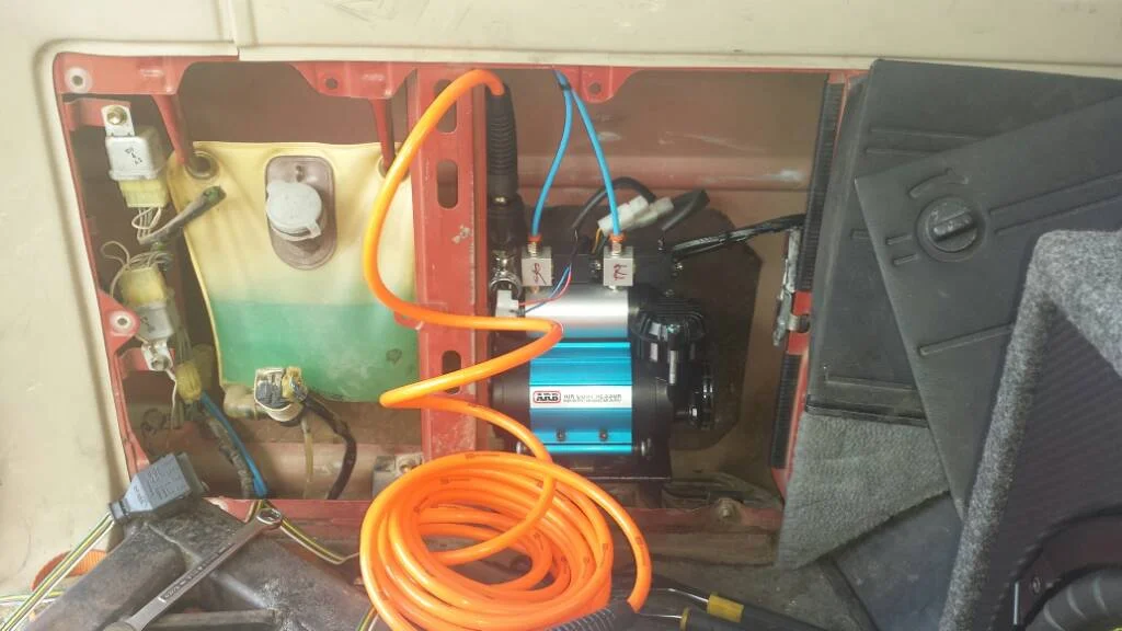

I had to do this job twice because I didn't use thread sealer the first time. All in all it took me about 30 minutes including looking for that sealer.

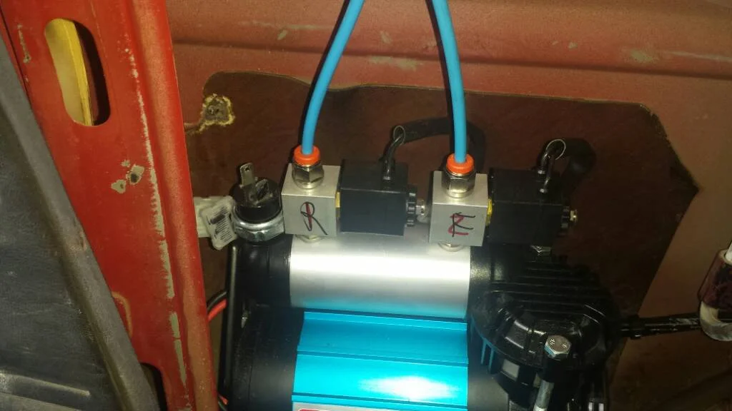

Unplug the wires. The instruction says is doesn't matter which way they go back on, but I marked them anyway.
Unbolt the solenoid looking thing from the tiny compressor.
Here are the three pieces that will bolt together. Really I paid ARB just for the T fitting and they threw in a short hose.
Reassemble And test
It works, but will either need a longer hose or pass the hose thru the cab to reach the front right tire.
