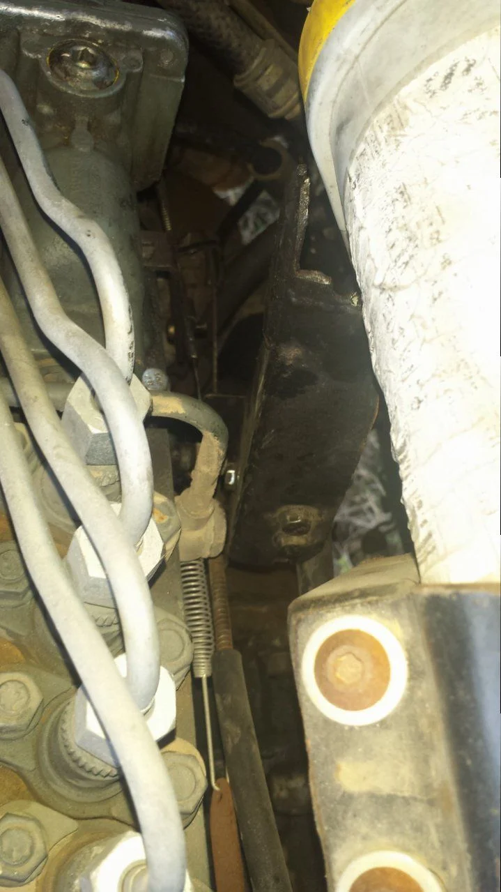

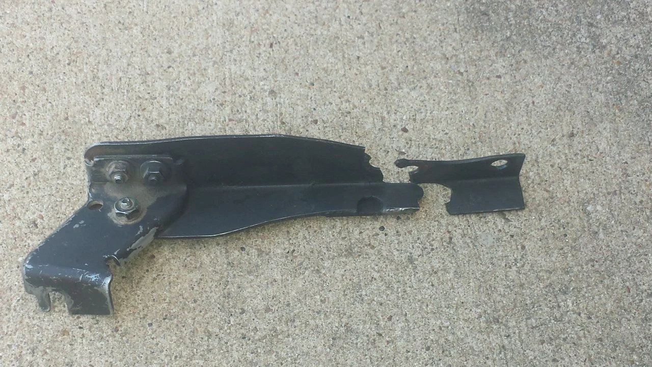

I was about 50 miles south of my house when I felt a thud and the pedal went soft. At first I thought I had a boost leak, so I pulled over to fix it. What I found was the throttle cable bracket had broken off AGAIN.

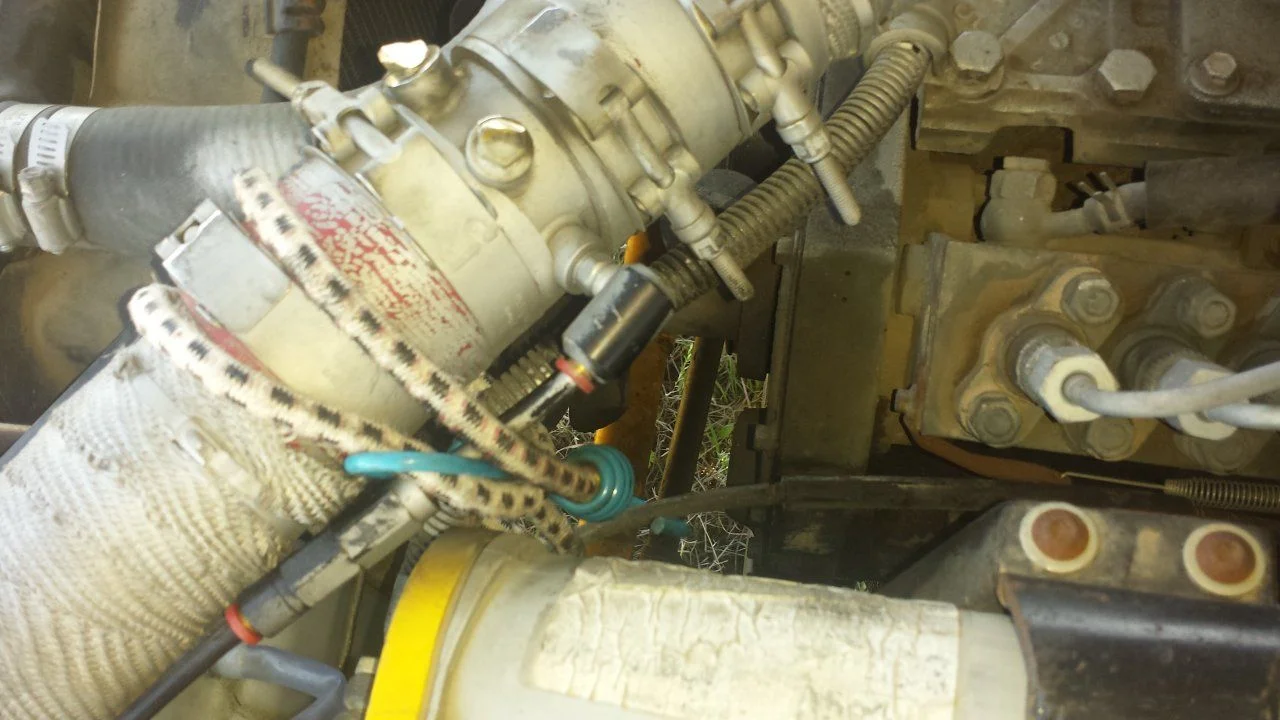

So here I was trying to figure out how to get the cable on the right amount of tension so I drive home. I rack my brain for a minute when I realized my son dug thru the tool box in the rear and was playing with a bungee cord.
So here's the best I could do with it. It worked well enough to take me to the Cummins dealership then home.
Sadly they don't sell the bracket I'm looking for. So does anyone know where I can source this?
Would like to not have to rely on a bungee cord for round up.
Can it not be salvaged or has it finally met its demise?
It broke once before, I'll try to see if someone with welding skills can fix it, but I rather buy a new one and not worry about it for a few more years.

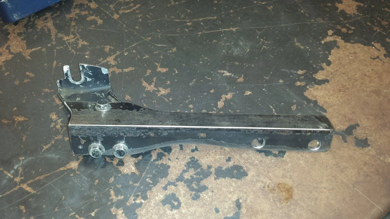

It came with the engine as far as I can remember. It broke off once before so it was reinforced when it got welded back together. Having a hard time finding a replacement online so it may be a custom job. The Cummins dealership don't sell brackets so it's hard to tell.
Which part broke off?

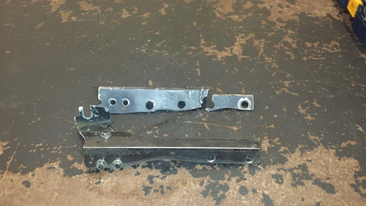

if you look at the third pic. the right side where it's been welded once before. Thats the part that bolts to the engine block. Thats what broke
Post some better pictures of the part and where it broke. Looking at the failure point will tell us if it was a bad weld or if the metal thickness is insufficient or something else happened. That way when you repair it again, it won't break.
Is that the part that broke on the way to Big bend?
No this part is just forward of the part that broke off on the way to big bend.
Here are more pics.
The closer I looked at it the more I realized it was a custom made bracket. I drilled two more holes and tried to reroute the throttle cable, but the power steering hose was in the way. I guess I need to have another one made. In the meanwhile I'll be driving with a bungee cord.
That's definitely custom. Rebuilding it with thicker metal would be better, but they did not choose a good mounting point for the bracket.
I gave the bracket to a friend of mine. He's going to try to make two new brackets out of thicker steel. as far as the mounting points go, I think there was no other choice, the space is very limited.

Here it is.
It's thicker than the old metal one and it fit in perfectly.
I didn't have time to spray paint it, so I just mounted it really quickly so I can drive home and get changed for work this evening.
It gives much better response now and is beefier than the last bracket. So hopefully this will last a few years. On my way back I did pass by a mud trail in the rain, was fun, but I should have aired down the rear airbags at least.
