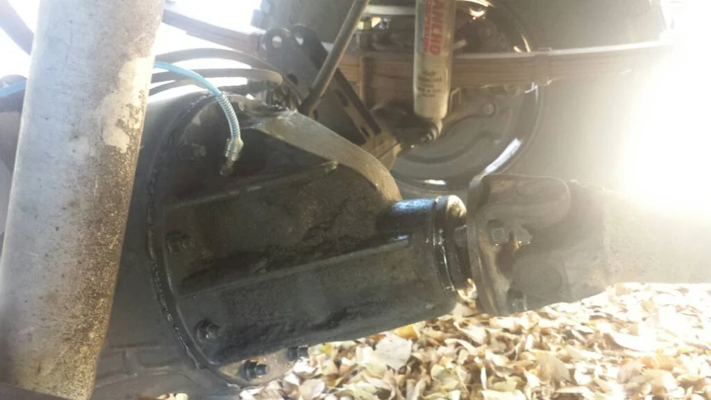

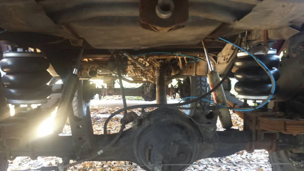

Here are some better daytime pics. I'll take some pictures of how the compressor is mounted once I'm off work.
The blue air line is zip tied mostly around the brake lines.
Rear pumpkin
Front pumpkin
Grommet for air lines

The airline should really have convoluted tubing over it. Especially running thru holes like that. Otherwise looks mint.
