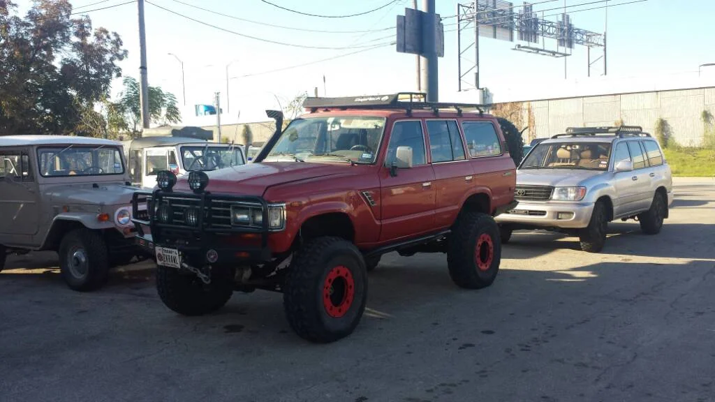

Dropped Big Red off to get lockers installed. Early Christmas present.

Is that a different 62 or is that an older picture?
It's a different one. They weren't close enough to take a side by side picture.
