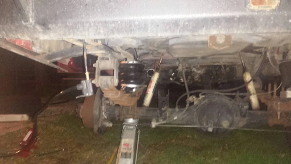

I'd be careful with that exhaust blowing right onto the bag... I had a dump pipe on for a few weeks after my swap and it pointed right at my traction bar crossmember and melted the bushings pretty quick.

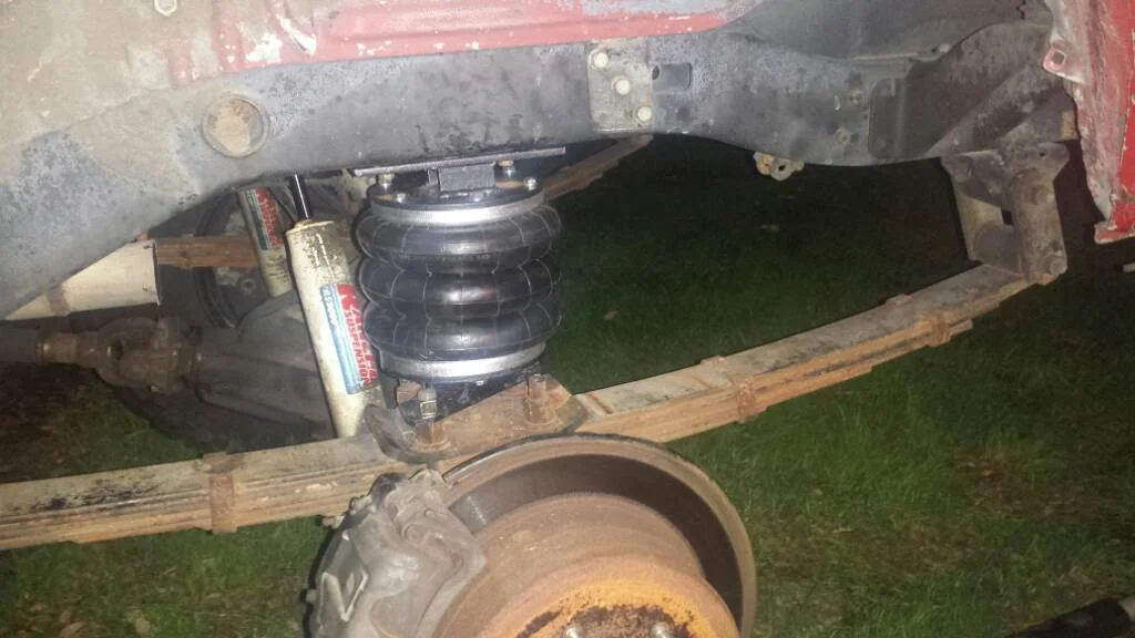

Ah, so you did mount them on top of the leaf packs. For some reason I thought you were gonna mount them on the axels like they show on their website. Def prob the best choice, for balance and strength wise.
How has articulation changed with that style bag and location?
Looks good mike!
Thinking about shortening the pipe until I get a new one in.
I'm about to do the right side then take it for a spin. Driving it to Dallas tonight so will post impressions this evening

I wonder if having airbags not at the same position as the leaf springs will make the truck teeter totter? Or possibly bend the axle housing?
I have airbags on my rig and one thing to keep an eye on is your pinion angle....I'm fairly confidant that for a time I was running too much air in mine and it caused the pinion seal to fail. Now I just use them at like....20psi since I added leaf beyond my OME heavies.
My build thread doesn't have my finial solution. In the end I added a hinge so the airbag flexes with the suspension. Lookin' forward to seeing this install!
Best way to utilize the air bags is to measure ride height without any air in them and no load or gear in the truck. Load up the truck with your gear, fill air bags until ride height comes back up to where it was before loaded.

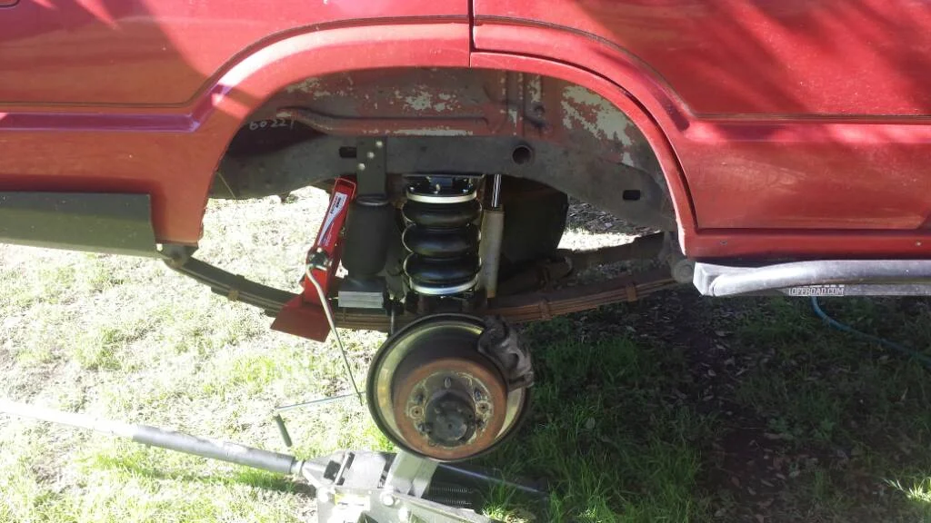

Doing the right side.
Rear pic of both sides

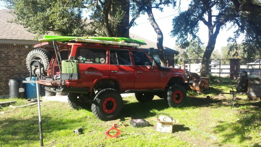

How it stands now.
At 70 psi, the rear is noticeably higher. I have to jump a bit more to sit on the tailgate.
Shortened the exhaust so it doesn't dump on the air bag .

ok initial first impression.
It feels like I'm driving a lifted sports car. The suspension is stiff and doesn't sway on turns. I like the ride height and when you hit bumps it absorbs it pretty well. Of course I'd have to deflate the bags for the trail so the suspension can become softer. I drove it around town, didn't smell any exhaust fumes, even at red lights. I'm eventually going to rebuild the tail pipe, but my next priority at the moment is getting those lockers and chromoly axles installed.
I'll be driving to Dallas this evening and will be watching my EGT gauge, curious to see if shortening my tailpipe will lower the temp. More to come.
