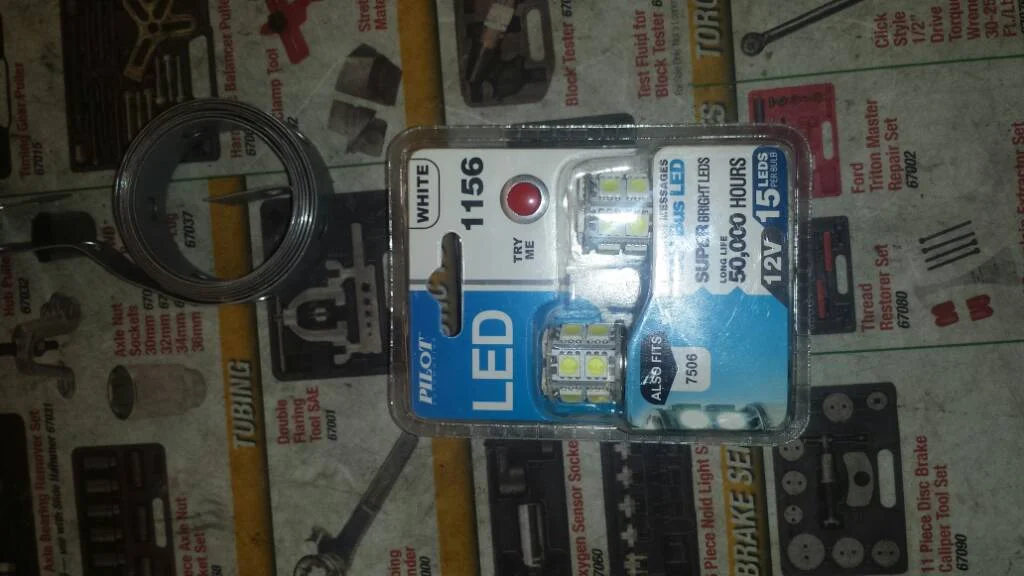

I also installed some LED lights for reverse, hopefully that will help at night.

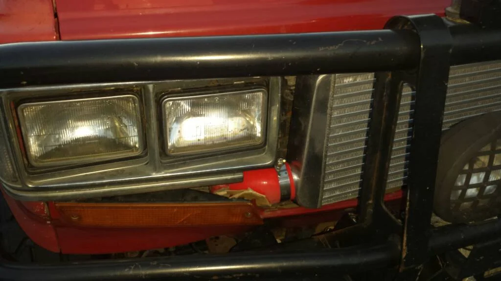

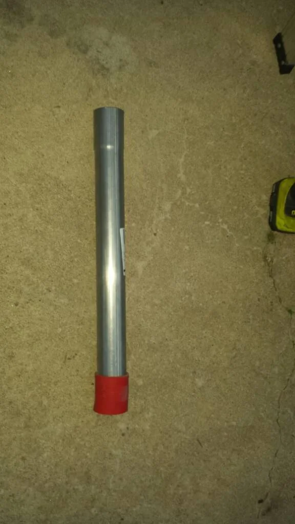

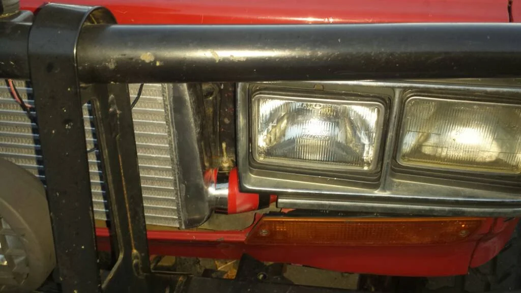

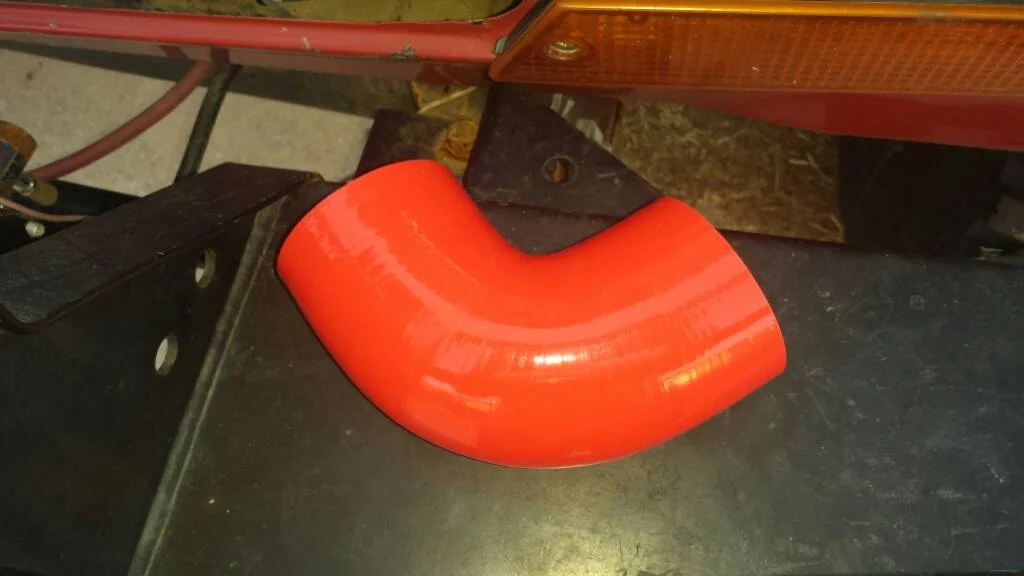

In tech news, I had a boost leak going and coming back from Dallas. It raised my EGTs and lowered my psi. Had to retune the methanol pump so I can make up for the list power and heat. I eventually ran out of methanol but made it home ok. I had to pull over a few times to retighten everything. I basically needed a 90 degree elbow that arrived while I was gone.

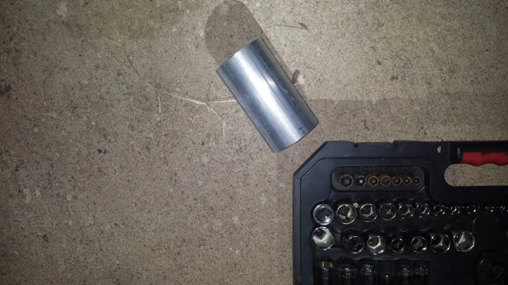

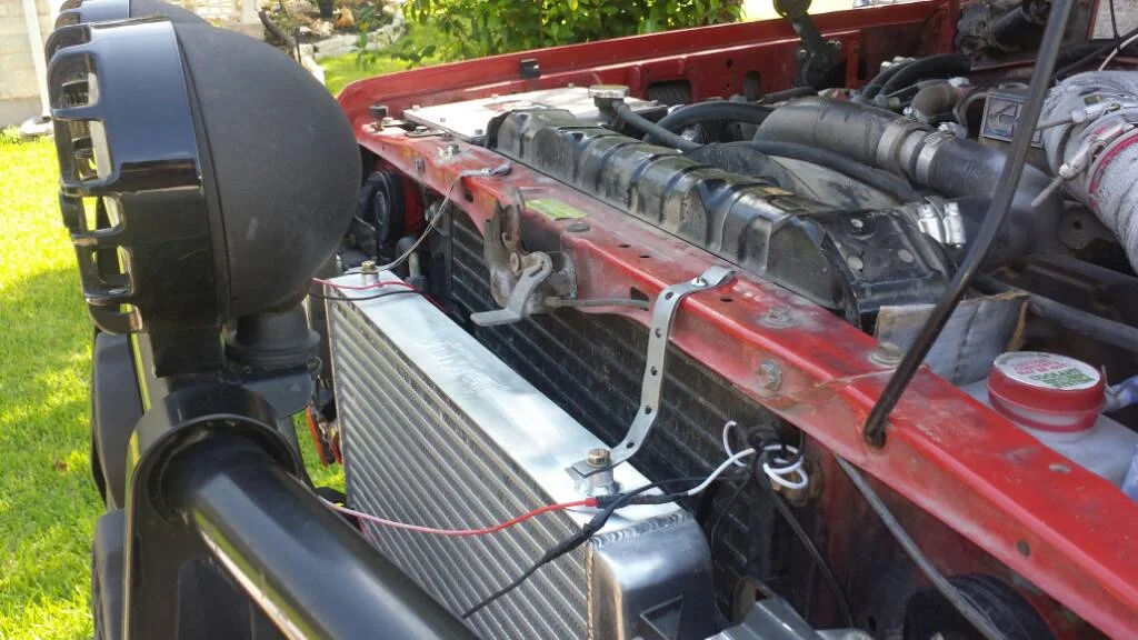

I then went to O'Reillys and got a 2.5 inch exhaust pipe and cut it to size to extend the piping for the intercooler.
As I wad working in this, a random guy in a discovery pulls up and introduced himself. He ended up helping me install the intercooler and wet got the hood to sit flush.

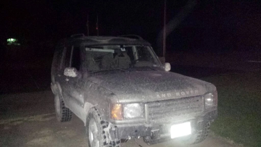

Not having a grill is growing on me. I just need to figure or a way to line up the turn lights.
What you guys think, grill or no grill?
Can you shave the grill down in the back to fit over that monster?
No. Best bet is to get a custom grill that sticks out. I love the performance I'm getting now. Was doing 80 today. The thing is the uglier it looks the more I like it. But not sure I want it that exposed.
I would have to reroute that condenser line to push the ic back a bit. Honestly might have Edwin see if he can figure it out.
On a tech note, I'm cruising at higher speed at between 11 and 15 psi. Can give it up to 20 easy.
the injection is set up at around 14-16 psi. you can feel it kick in when it goes. I still have the rtt on so it;s not as aerodynamic as LCs are known to be:D
I think you better call Dave Gore for one of his custom grills. It'll be 80 - zero in a second if road
gator jumps up and smashes both rads. J
Yeah I side with running some kind of grill for both aesthetics and protection. Glad the bigger intercooler is doing its job.
