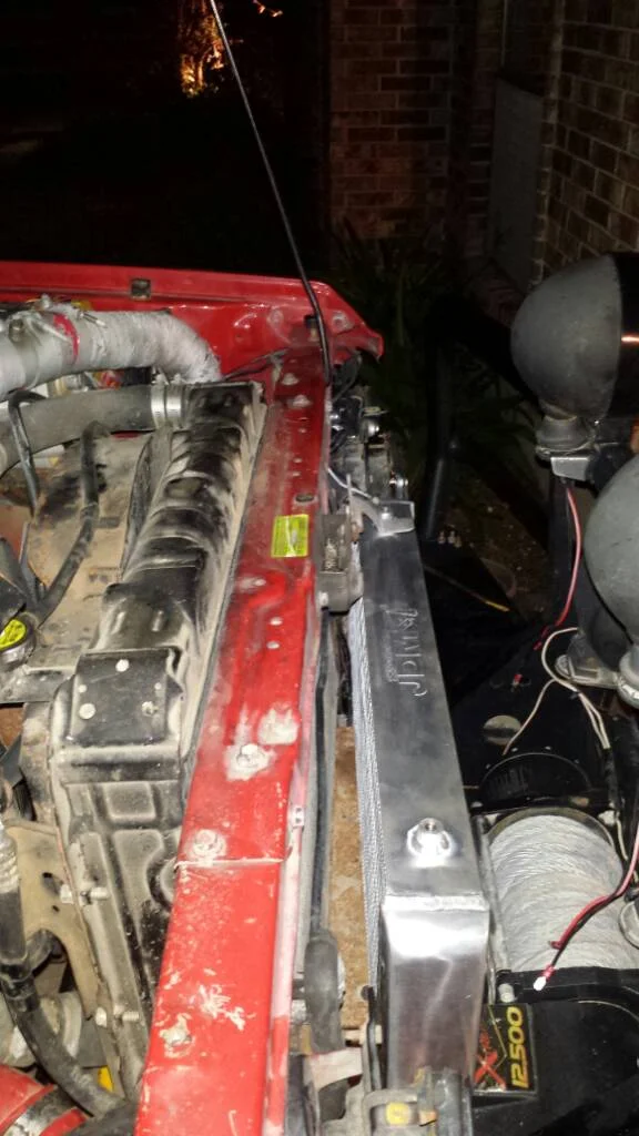

Thanks for correcting the link. Hard to work off the phone. Yeah between the grill and condenser. Might have to shave the grill some.

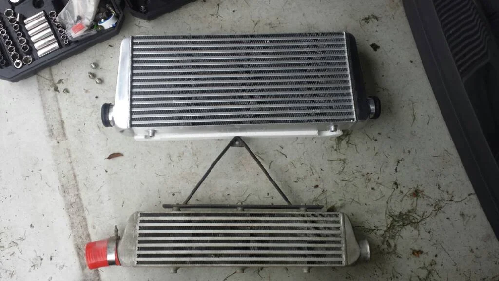

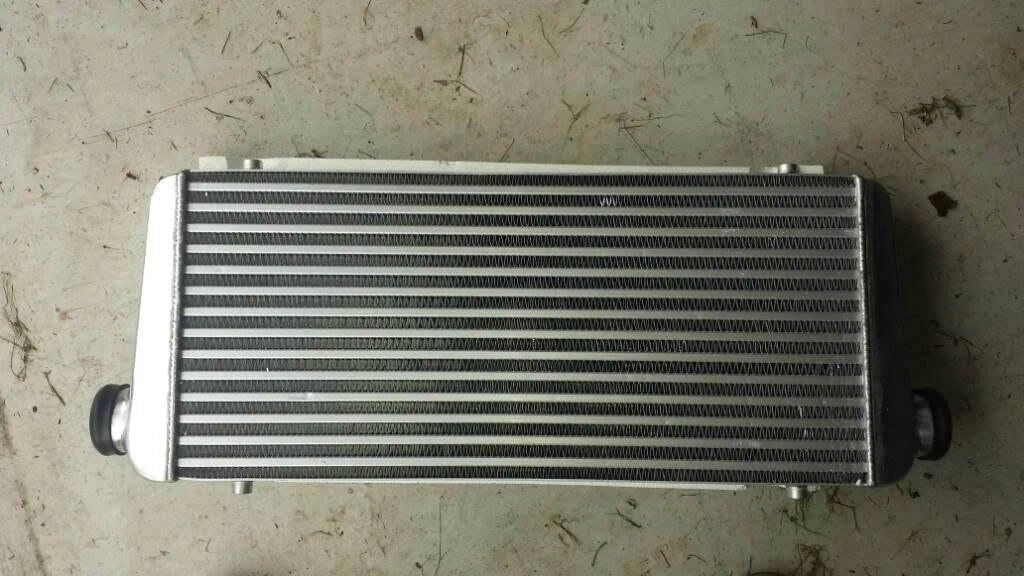

This came in.
Old Vs new
The new one was a bit wider which made the install harder.

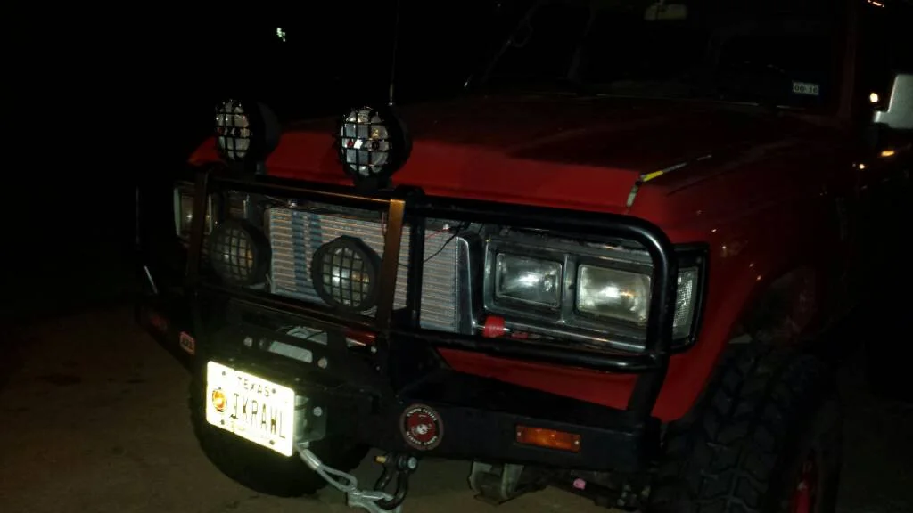

Finally got it on there.there's no way to reuse the old grill, but I like the way it looks right now. I might commission trail tailor to build a custom grill that sticks forward a bit.
Drove it around a bit. The EGTs are the same while accelerating, but lower while cruising which allows me to give it more boost.
I was surprised how hot the turbo side of the intercooler gets and how cool the other side is. I need to order some silicone boots so I can fit the pipes better and line up everything.
it looks like you have an inch or so of backwards room? Or is that space for the AC condenser?
Looks good. Did you bolt it down or is it just supported by the silicone elbows?
right now it's just the silicone elbows. I need to pass by edwin's shop so I can get him to fab up a bracket to bolt it down. The thing is my other car is down and I need to be in Ft Worth for drill tonight. You think it can make it?
That looks like it fits damn near perfect.
It was a bit larger than the old intercooler, so I had to cut a bit more to get the pipes to line up better. The signal lights aren't as lined up but that's because I need a 90 degree silicone elbow but used a straight one for now.
There's a condenser line there, but I can probably move it back a bit once the 90 degree elbow comes in.
