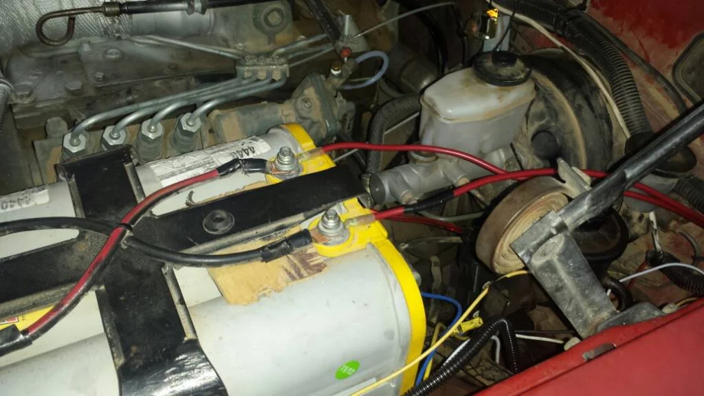

Remind me this weekend and I'll show you how my fridge and solar tie into my rear fuse panel. Super simple but it was a pain running 4 gauge wire from the battery. I hate electrical but I'm getting more tolerant of how long it takes to do it right as I get older.
Nothing major, it's been raining non stop. Managed to find an 8 gauge wire long enough to cut in half and run to the back of the truck. I installed an 1600 watt inverter over the sub woofer (it's velcroed on ). Too bad I don't have a fridge but at least this way I can run simple appliances when camping.
I have to hide the wires better, but it's functional.
