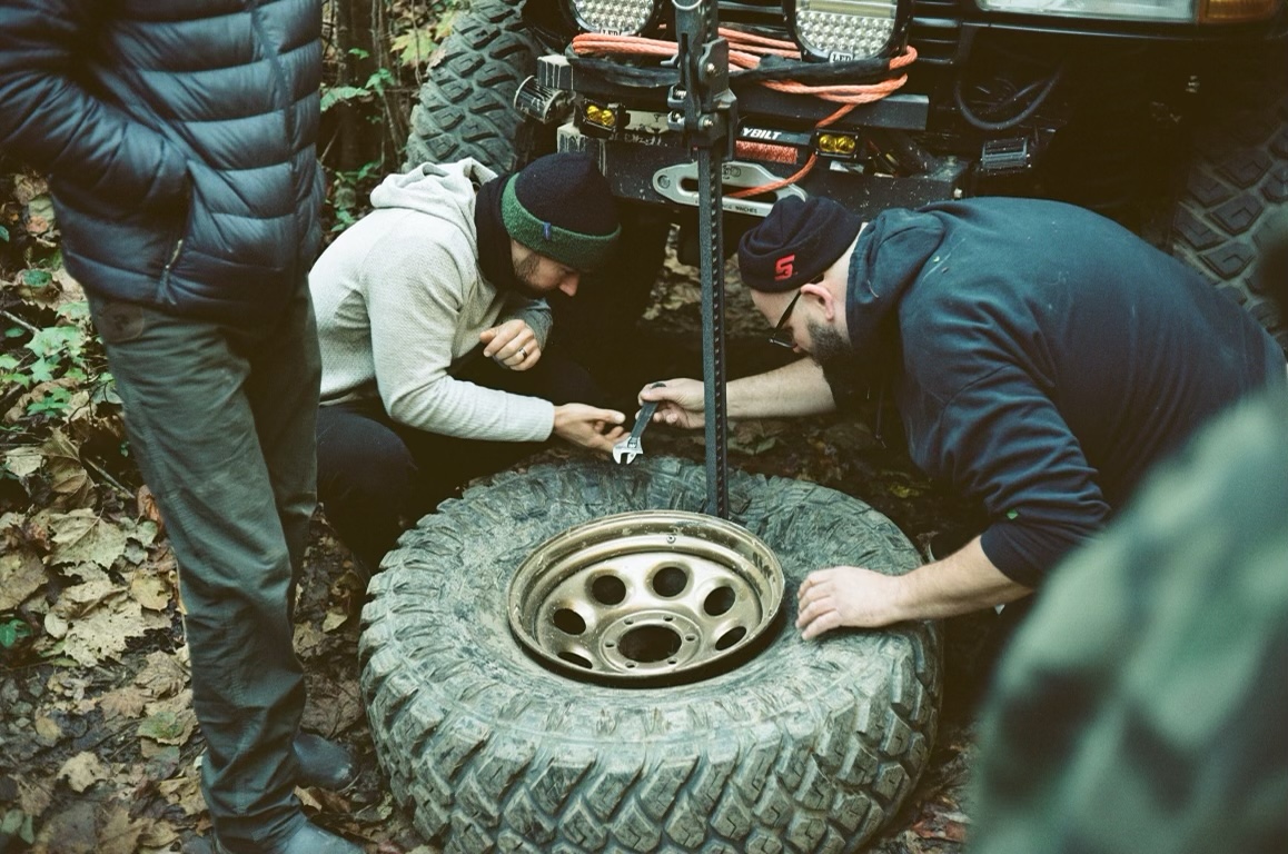

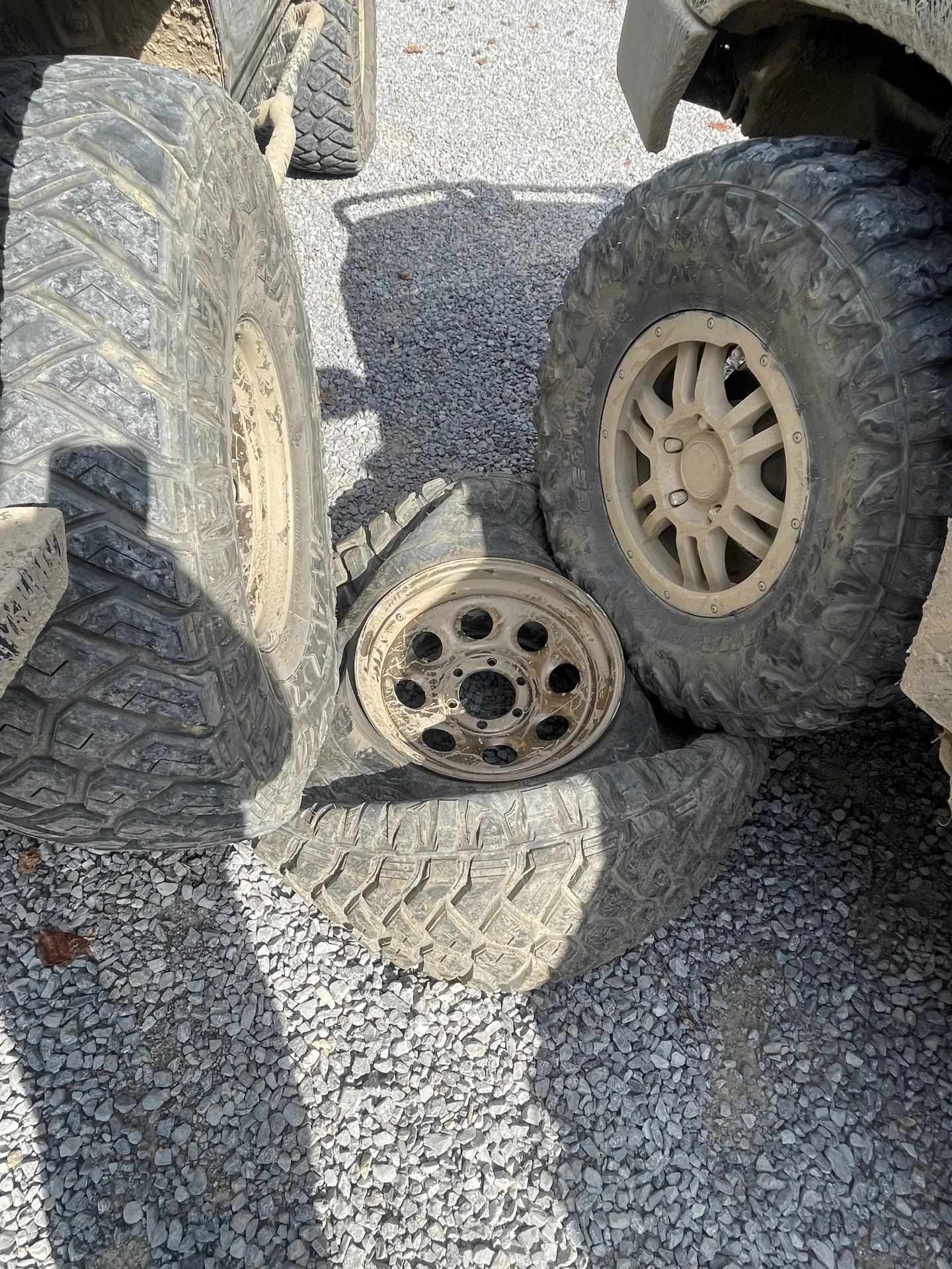

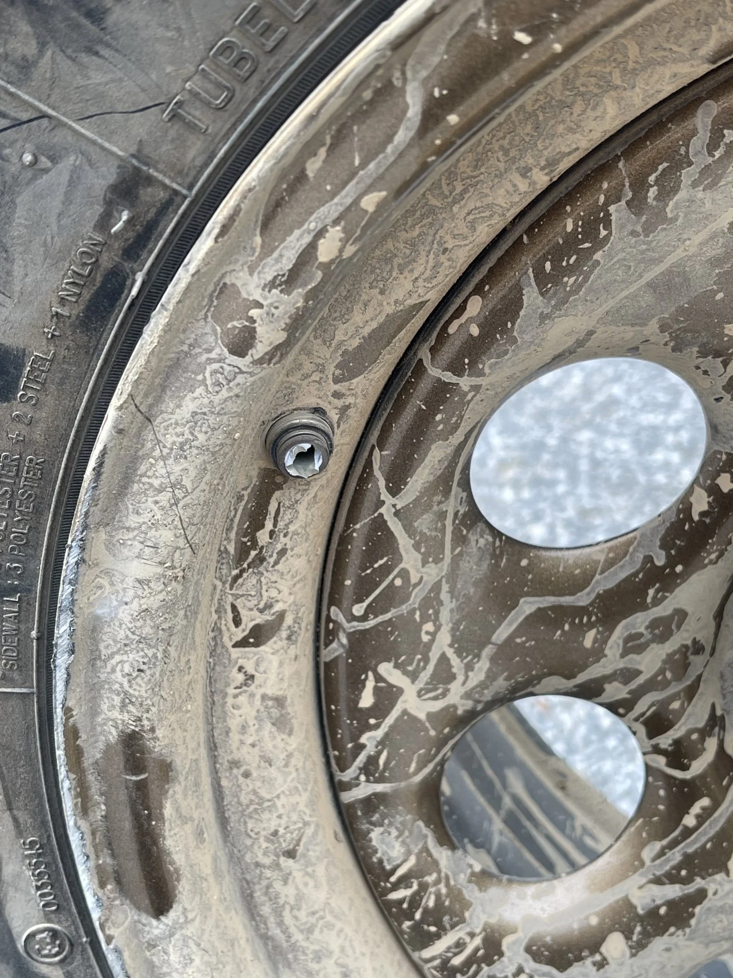

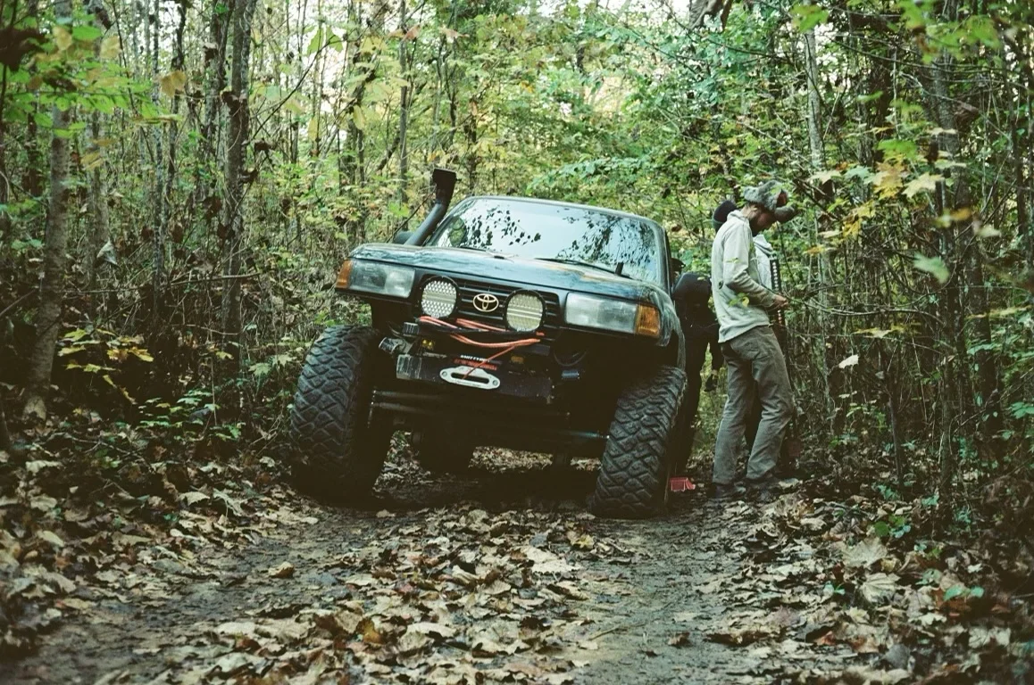

I found the limit of my fancy valves stems by way of breaking two of them off the truck 1 minute on trail 30 at Windrock.. i was hanging with a bunch of 100series guys for the day and they helped me swap my spare on and dismount a tire to replace the valve with a spare. Someone snapped some photos.. @MongooseGA and @patchagan on deck! Then GA and i did the other wheel back at the cabin so i had a spare ready to go again haha

I always run rubber valve stems. They don't break off.
You can still clip rubber stems off ... ask me how I know :rolleyes:
Agreed though, rubber stems a lot more resilient. I've mashed enough rigid stems to change them out immediately if I buy rims with them already installed. Rock rings on beadlocks don't even protect them. All you need is a decent size pebble rolling around inside your rock ring and you'll take a "protected" rigid stem out.
YMMV I do tend to drive like an a******.
You can ask the tire shop for the rubber stems they use with load range E tires that run higher pressures like on HD pick-ups. Those valve stems are considerably thicker walled nd should tougher.

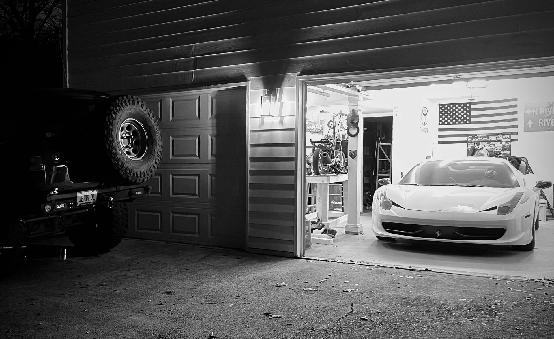

Wait, did you secure an Italian stallion for your stable?
