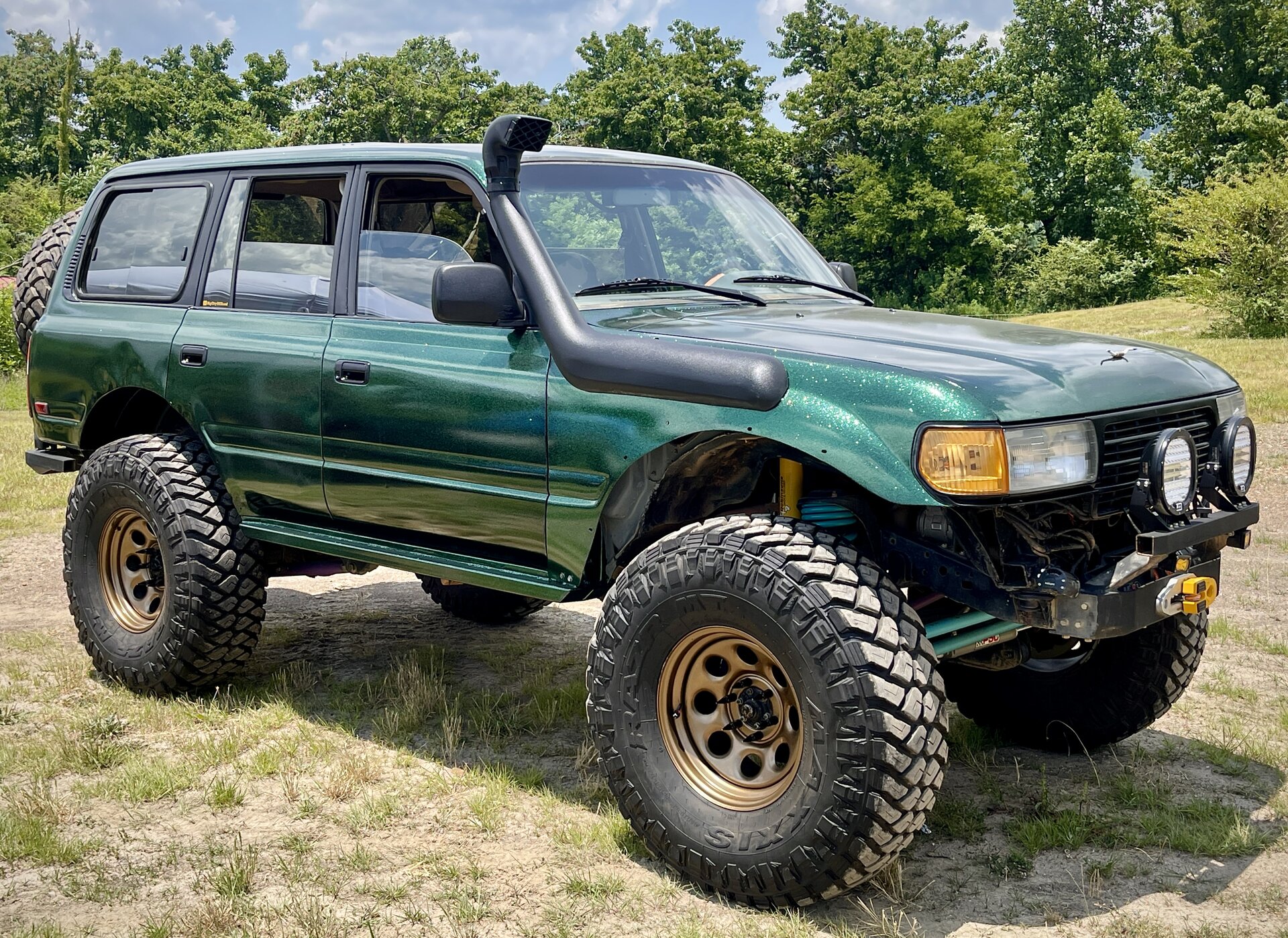

Howdy fellas, Ryan here. Ive been into Toyotas for a long time, i finally got me an 80, my first land cruiser. i bought this truck Feb 2nd 2019. I paid a reasonable price for it, drove it 65 miles to the shop, and pulled the engine out. 287k.... i know these trucks pretty well so i dove in deep right away. its a 1995 incase anyone is wondering. the name came quickly to this truck, on the one and only drive ive had in it so far, i could try to explain it but it wouldnt make sense, but its green so you get that much, im sure. im not much into forums, so this will probably be a pic heavy "build thread"
